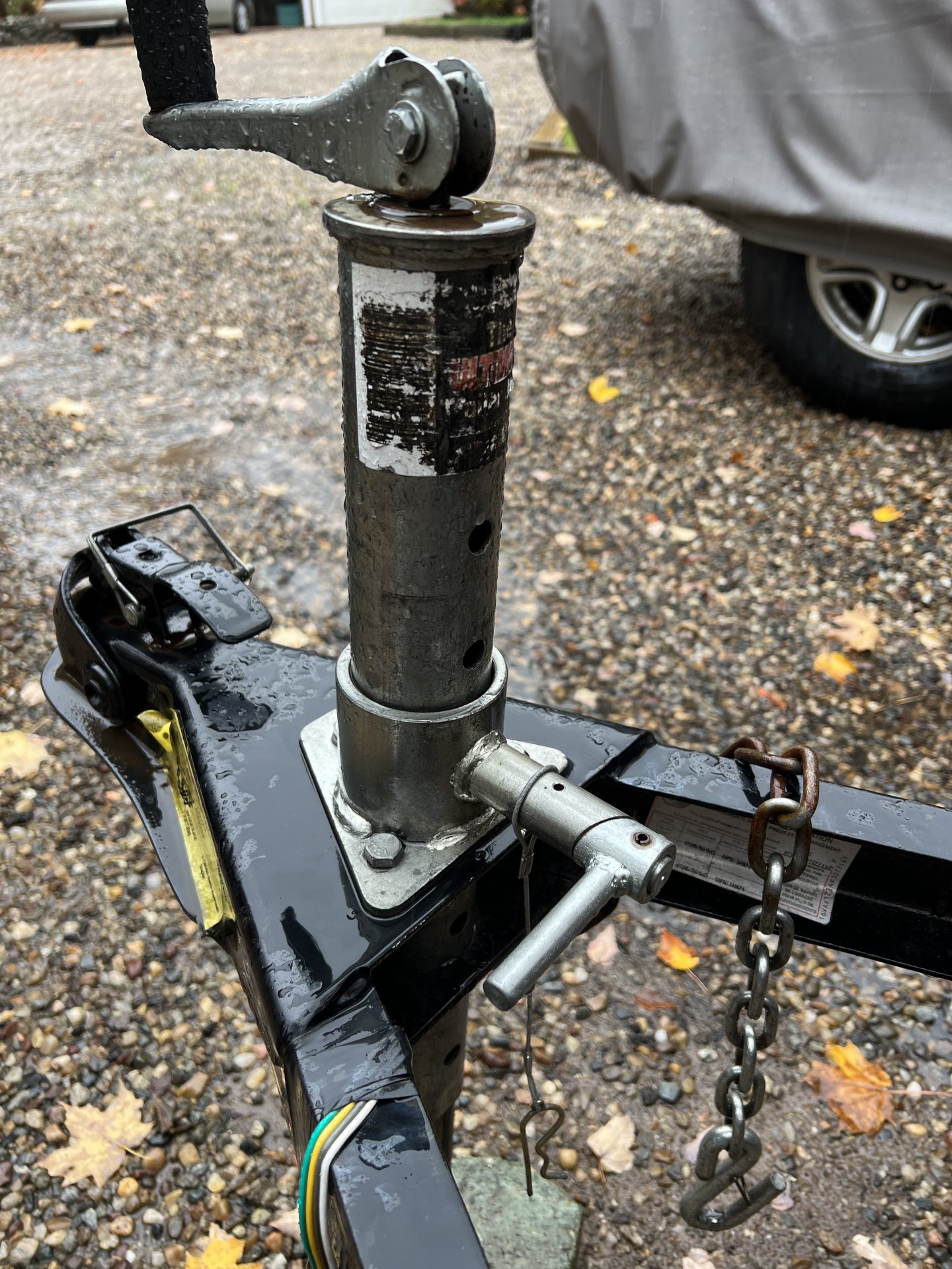

As promised, removable trailer jack. It just pulls out. I got this at Tractor Supply.
