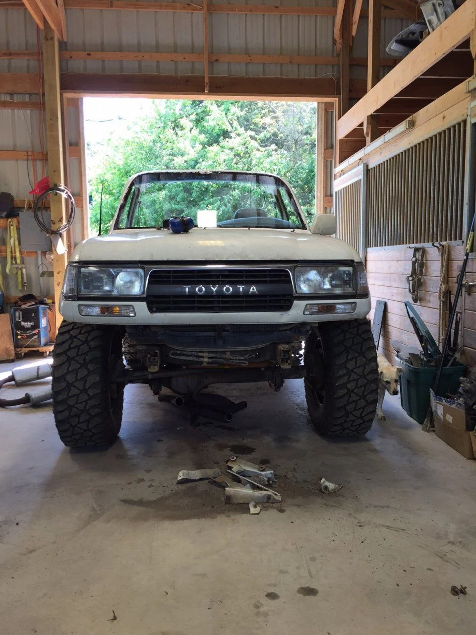

Today I removed the PAIR valve and stuck the o2 sensors in the leftover holes. What a sweet mod. After messing around trying to remove the O2 sensors for about 2 hours I finally gave up and just cut both pipes so I could work on the bench rather than on my back. Hopefully next time I have to change an o2 sensor the nuts will be nuts rather than piles of rust.

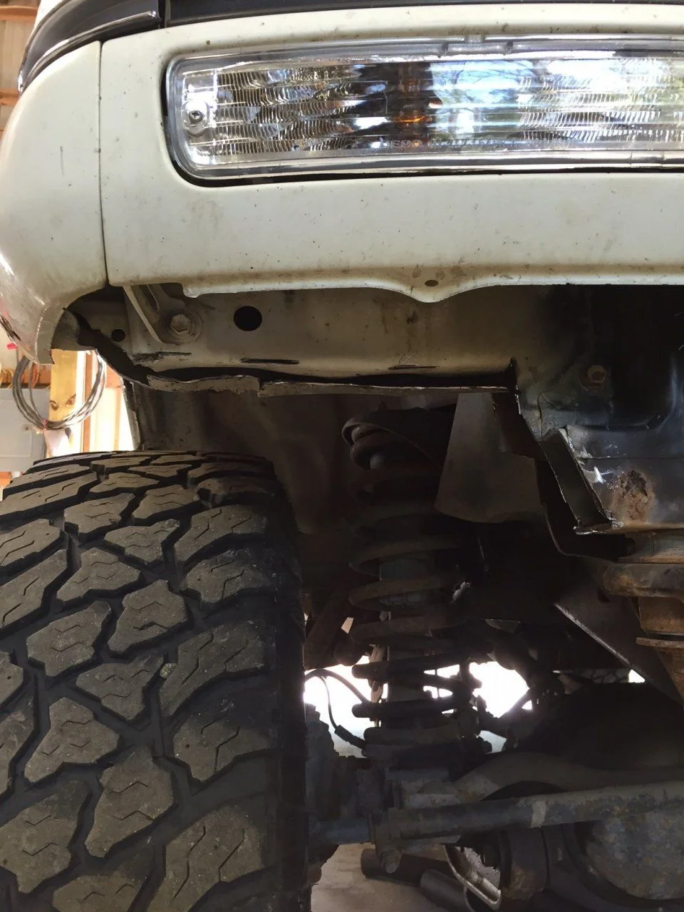

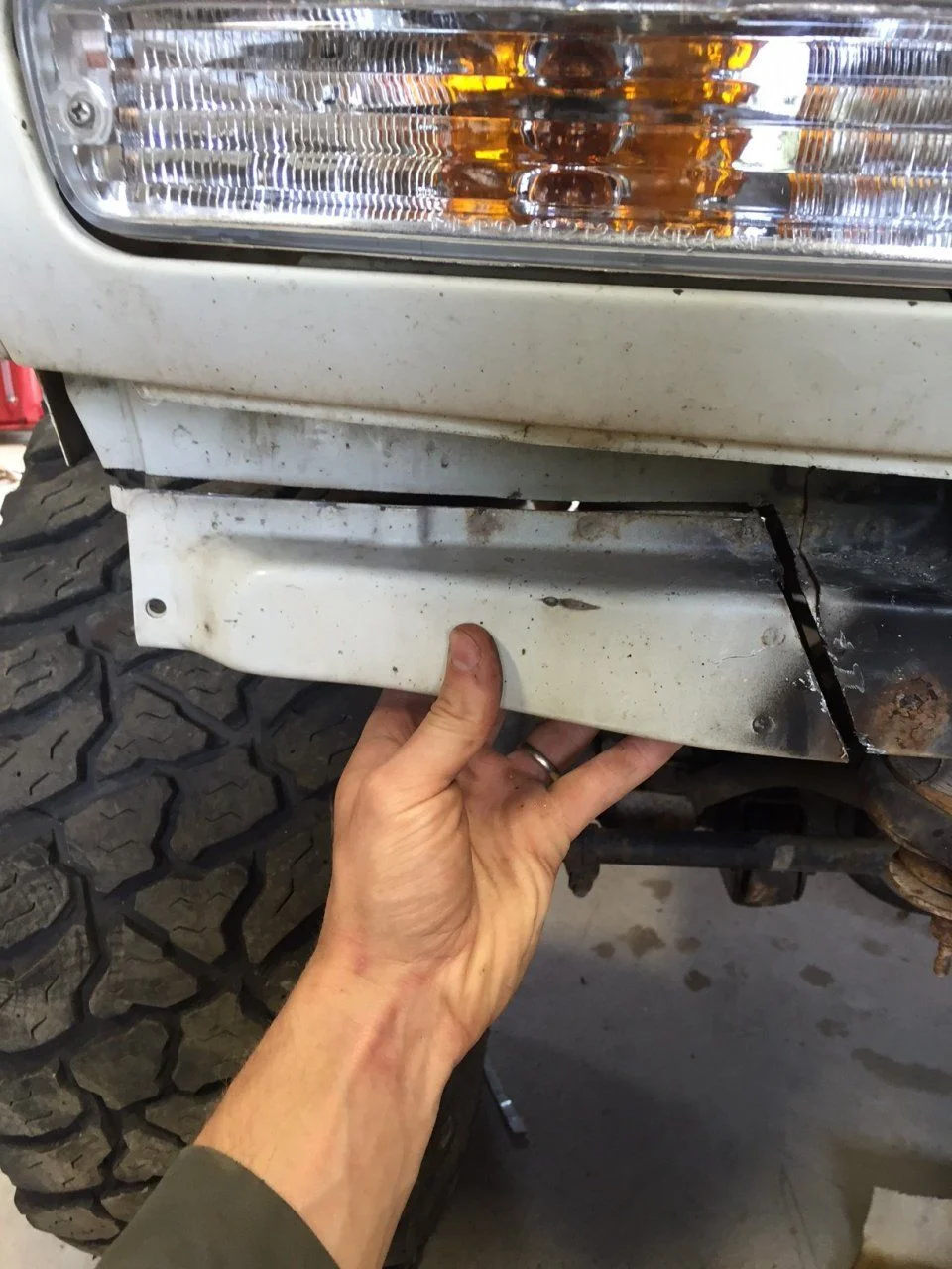

I also got to work trimming up the front end a bit.
Nipped.
Tucked. A little fine tuning. Some tack welds or a couple bolts and weld in s bit of sheet metal and it should be sealed up decent enough.
Both sides. I think one of the new trail gear winch plates and a stubby bumper will work nicely.
When you cut out all this crap, i see you only bent the inner guard back over to cap it? You didnt feel the need to weld/bolt it back together...
I ask because i want to do it to mine to but im worried as i have a battery with a steel tray and an airbox bolted to the inner guards
No, personally I didn't feel the need. I don't drive that much. I figure at the rate that I put miles on this vehicle it will outlast me. If I drove a lot I would look at building inner fenders. Plenty of other folks have filled in all the gaps, but I'm lazy.
