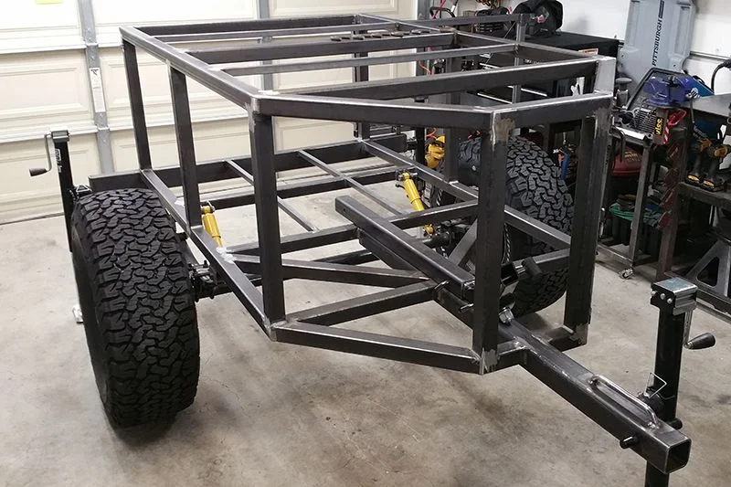

Just found this thread, late to the party :)

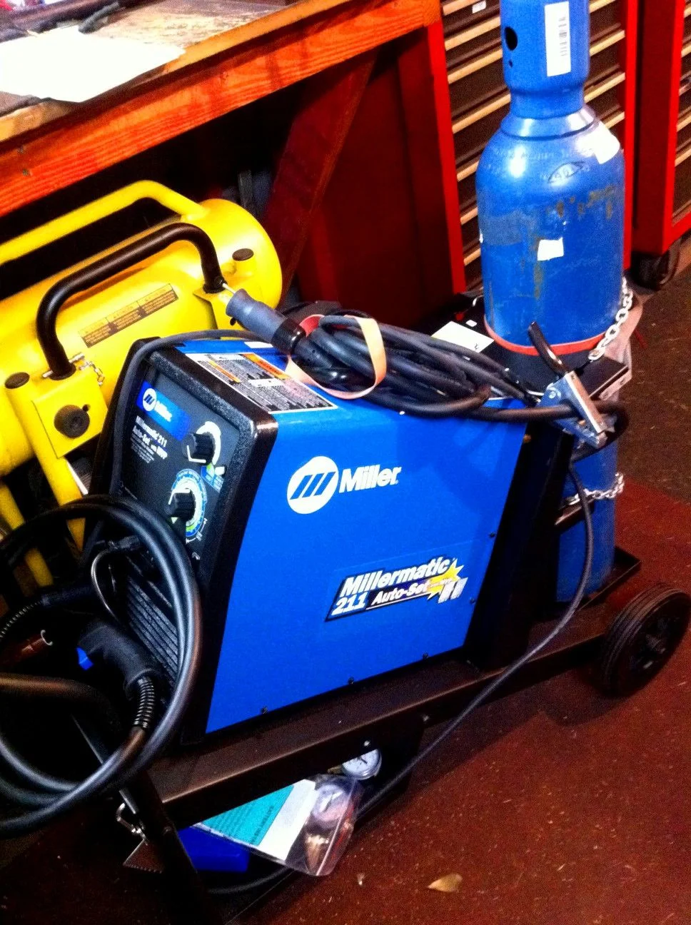

Machine make/model: Miller 211 on 240V
Wire/gas: INEFIL .030 ER70S-6, C25
Experience level: Home hobbyist
Bead pic:
Current project:

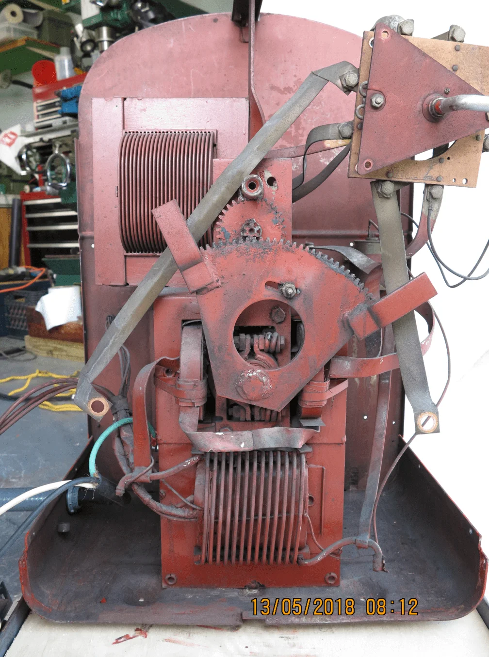

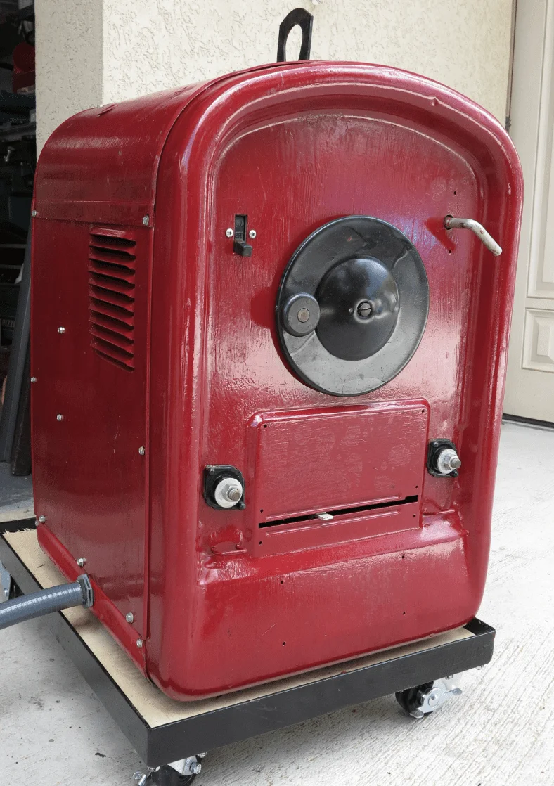

While I am not a welder, I have been gluing pieces of meal together with molten metal for about 30 years using a Lincoln 225AC buzz box. I finally decided to get something better in another welder with DC capabilities. I tried to get a Lincoln AC225/DC125 buzz box of eBay but the seller would not deliver. For a couple more dollars, I got an old 300AC/300DC Lincoln tombstone welder made in 1986. It was tested by the seller and confirmed to be working so I bought it.
Before starting the unit, I took it apart and cleaned all the dust that was in it - and there was a lot. Lubed the gears and made it presentable again.
Even though it has been used, everything was in good condition and functioning once it was put back together.
Looking forward to many years of using this machine.
Front view without cover

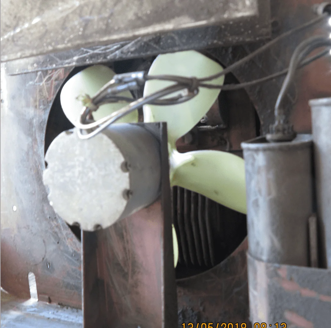

A view of the cooling fan after it had been removed and washed. It was almost black with dust. Evidence of the dust is still there in the image and I did do a better cleanup with a stiff bristle brush and a plastic scraper.
The final view with the covers on and a new 20' paint job
New amp and polarity indicator plates have been ordered. I also made some 1 gauge cables to replace the old ones.
The test welds in AC were much nicer than what I was used to from the AC buzz box.

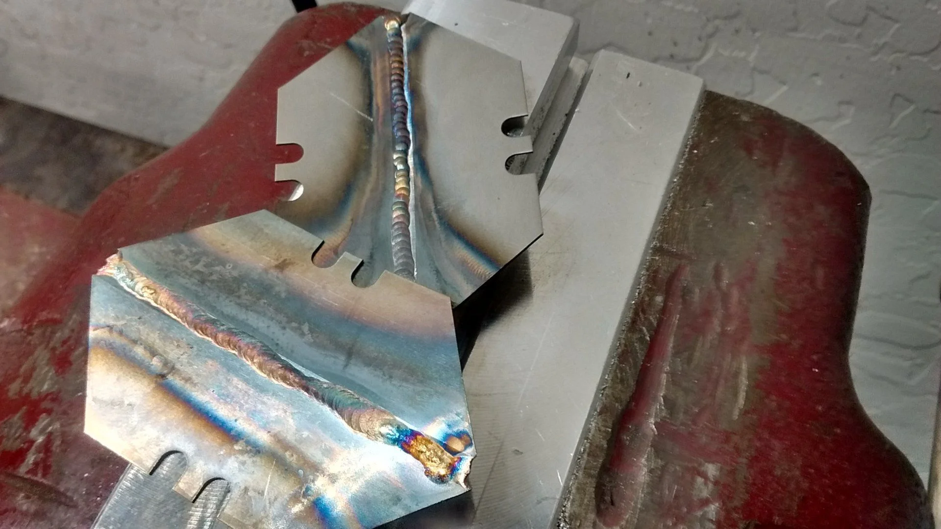

I don't weld for a living anymore but I've been working on this party trick a little in my spare time. Not great yet, but coming along. Good cheap practice.

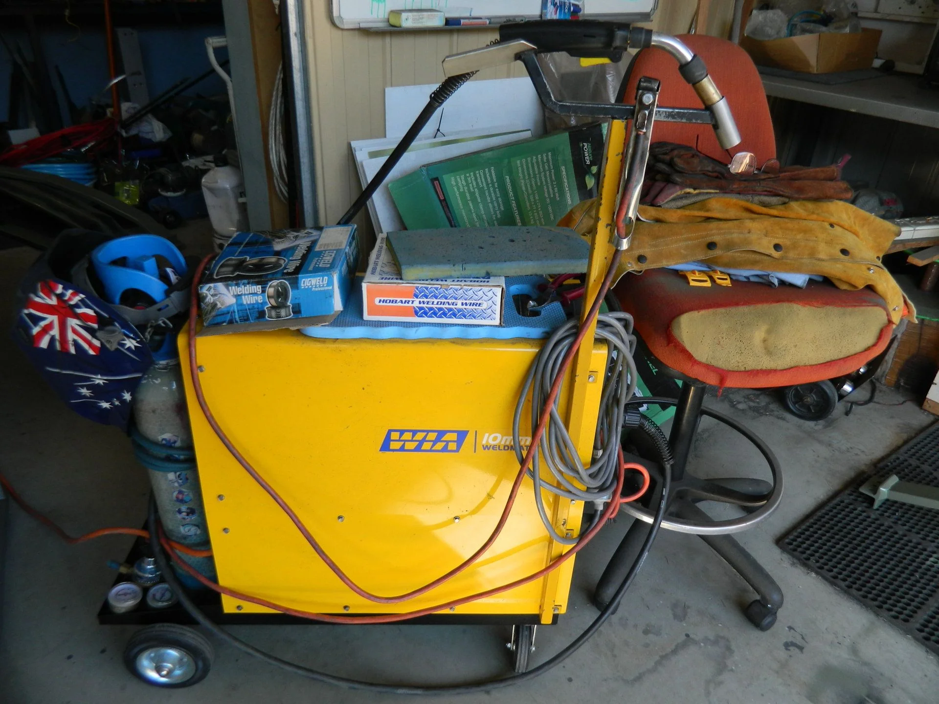

G'Day Fella's,
Here are some images of my main welding equipment.
A WIA (Australian Made) 200Amp MIG welder.

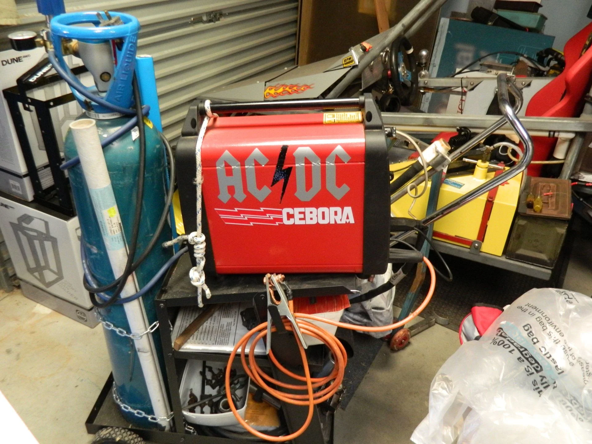

And a Cebora (Italian Made) ??? Amp TIG welder.
The AC/DC transfer on the side, is my addition............ ROCK&ROLL!
These do every thing I want to do and if they don't, the jobs to big for me.

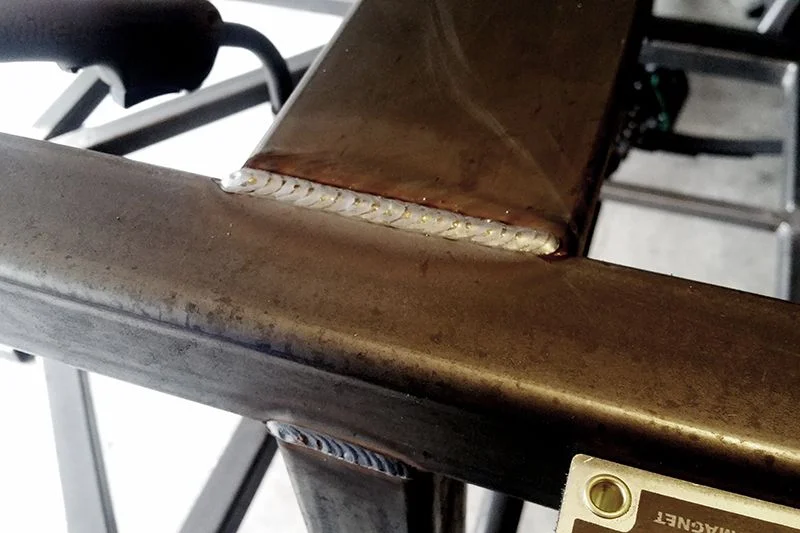

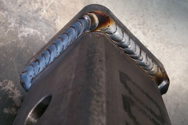

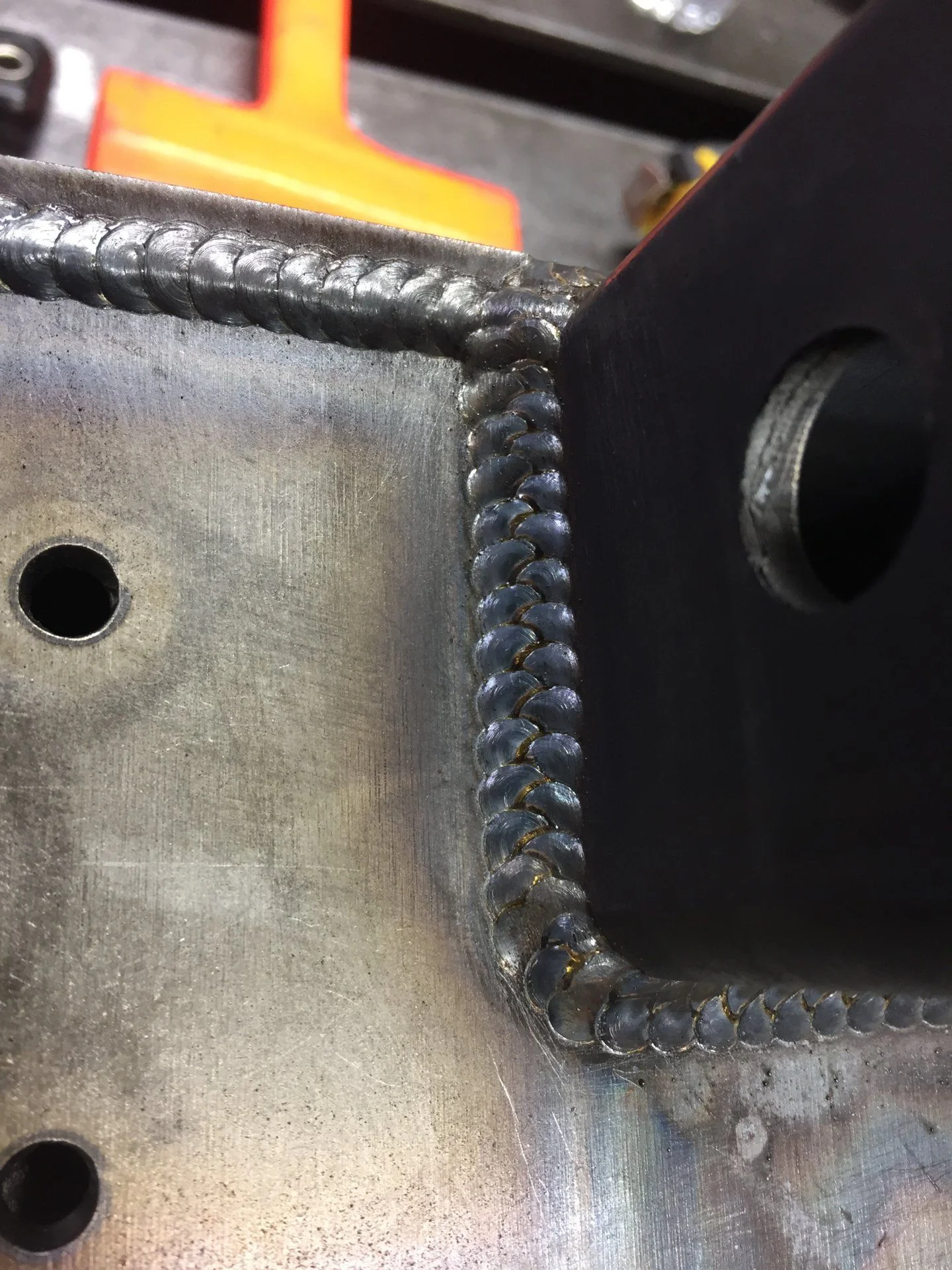

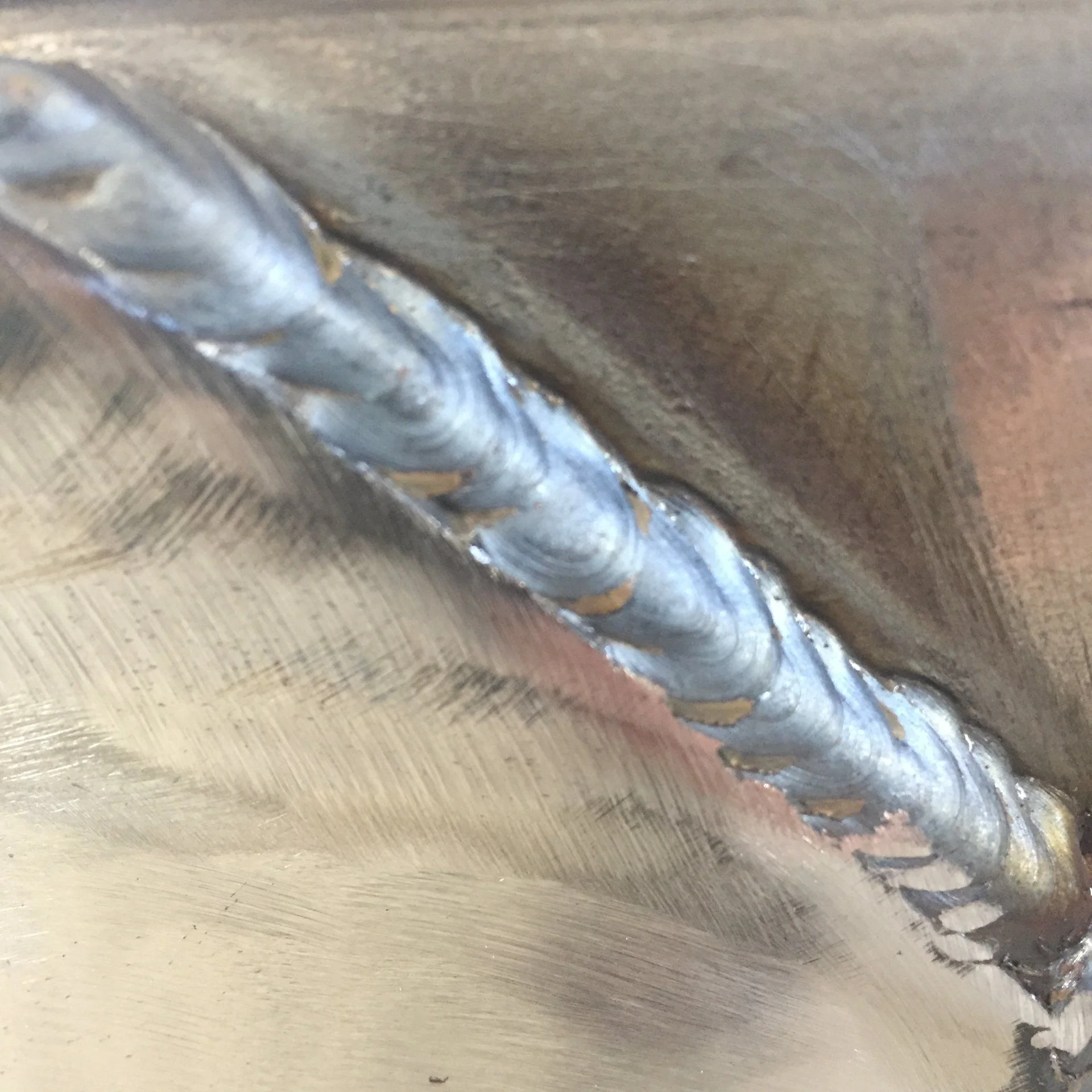

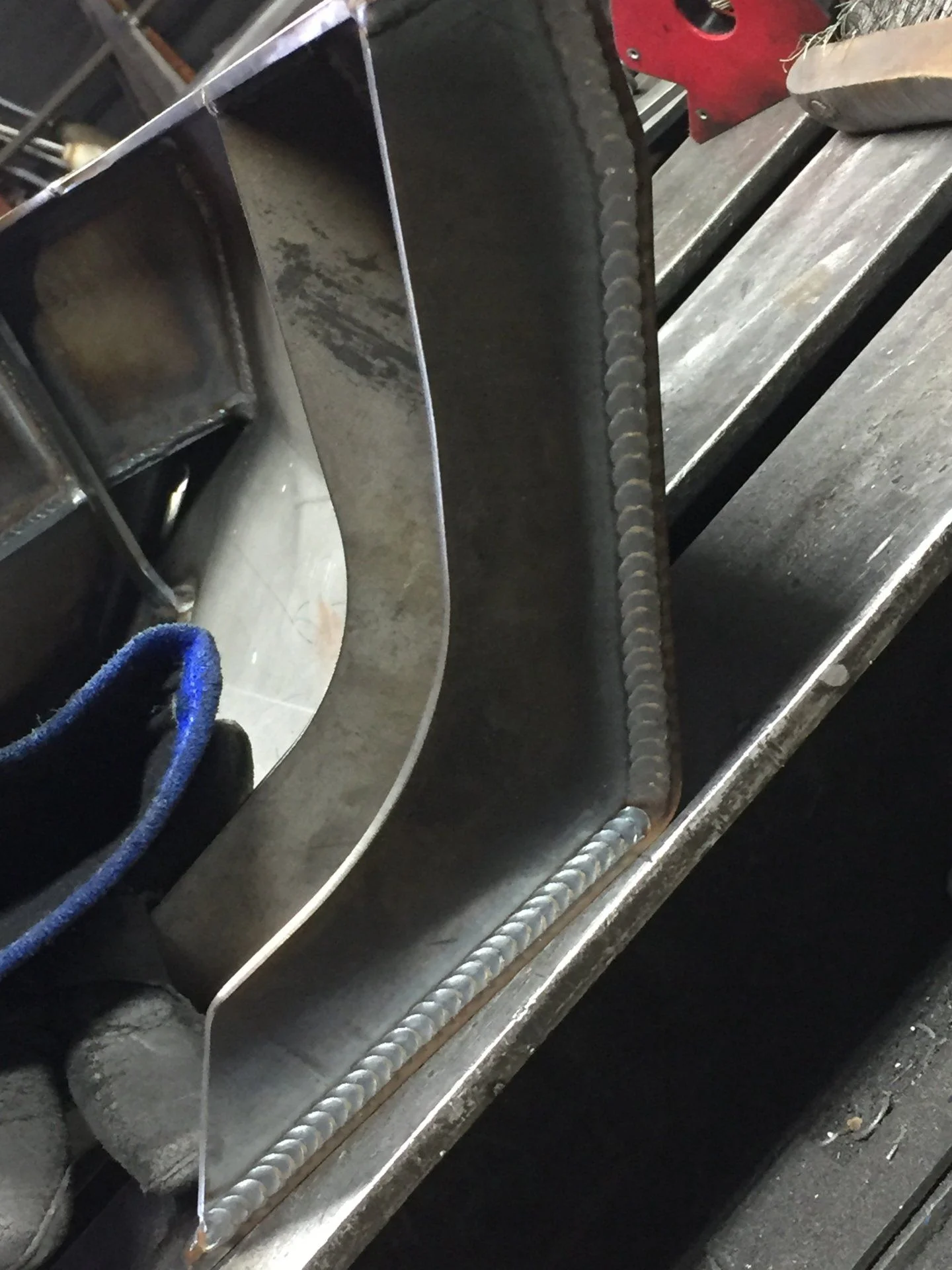

Constructive criticism please, pointers. Trying to improve, new to MIG welding. I had what I think is excessive splatter, I test my welds by cutting sectioning and polish to look for lack of penetration. I weld some ¼" at a 45˚ angle, an open corner/edge without gusset then beat it with an 8 pound sledge. Bent it over but the weld held firm.
1st pic is a scab plate on a frame, hard to tell in the pic
2nd is the top of the scab where it meets the frame. I didn't quite meet the edge and some undercut?
Toes of the welds, too cold, too hot? Heat affected zone looked good to me, but thats why I'm asking the pros out there
Looks like you're pulling the puddle. Try pulling the puddle, it'll lay in better.
The Miller weld calculator app is great for getting mig settings close. It's not perfect, but it's a good place to start.
:lol: Whoops. Meant to say try pushing.
IMO you're building up too much filler across the middle, that's why it's stood up like that, for the top pic anyway. Could be the wire speed is too fast, you're spending too much time crossing the center in your weave pattern, or you're just going too slow.
Bottom pic looks good from a speed perspective, I'd just focus on your consistency. Try to make the weld bead edges straight as an arrow as you weave back and forth.

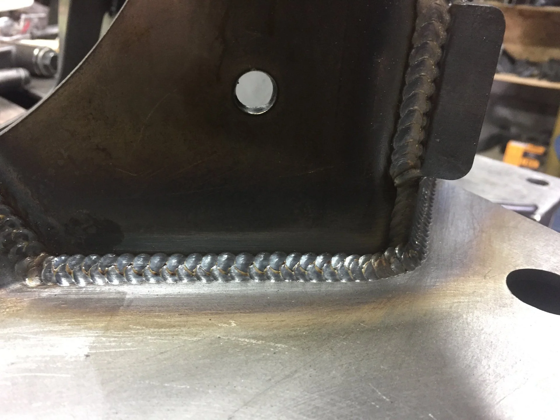

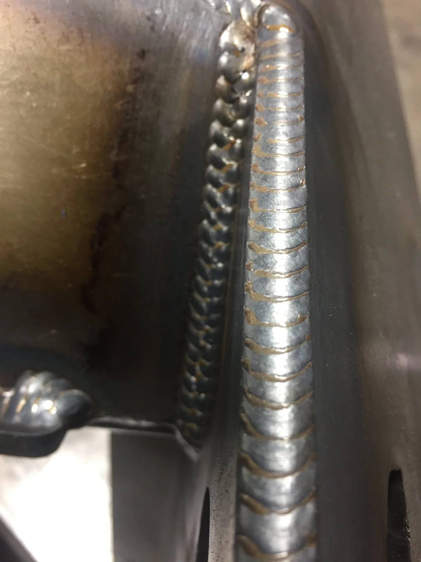

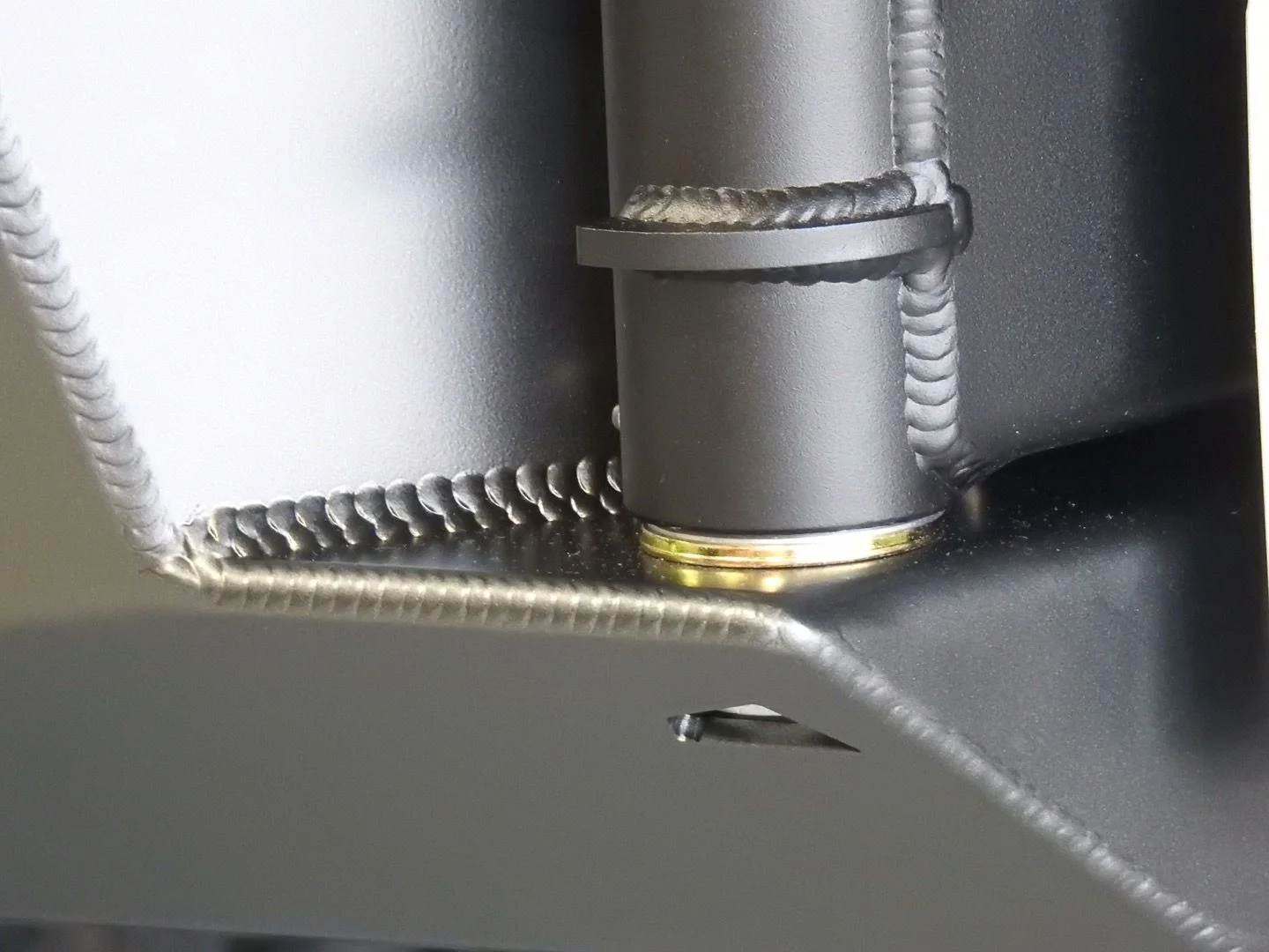

Getting to play around with a prototype miller machine! Can't say much about it yet but i plan to replace my 2 Lincoln 256 with 2 of these when released.
Crazy smooth and stable arch
All these were done with 0.35 c25.
Typically I would have to run 0.30 to get a good weave but I'm able to do everything on 0.35 now.
