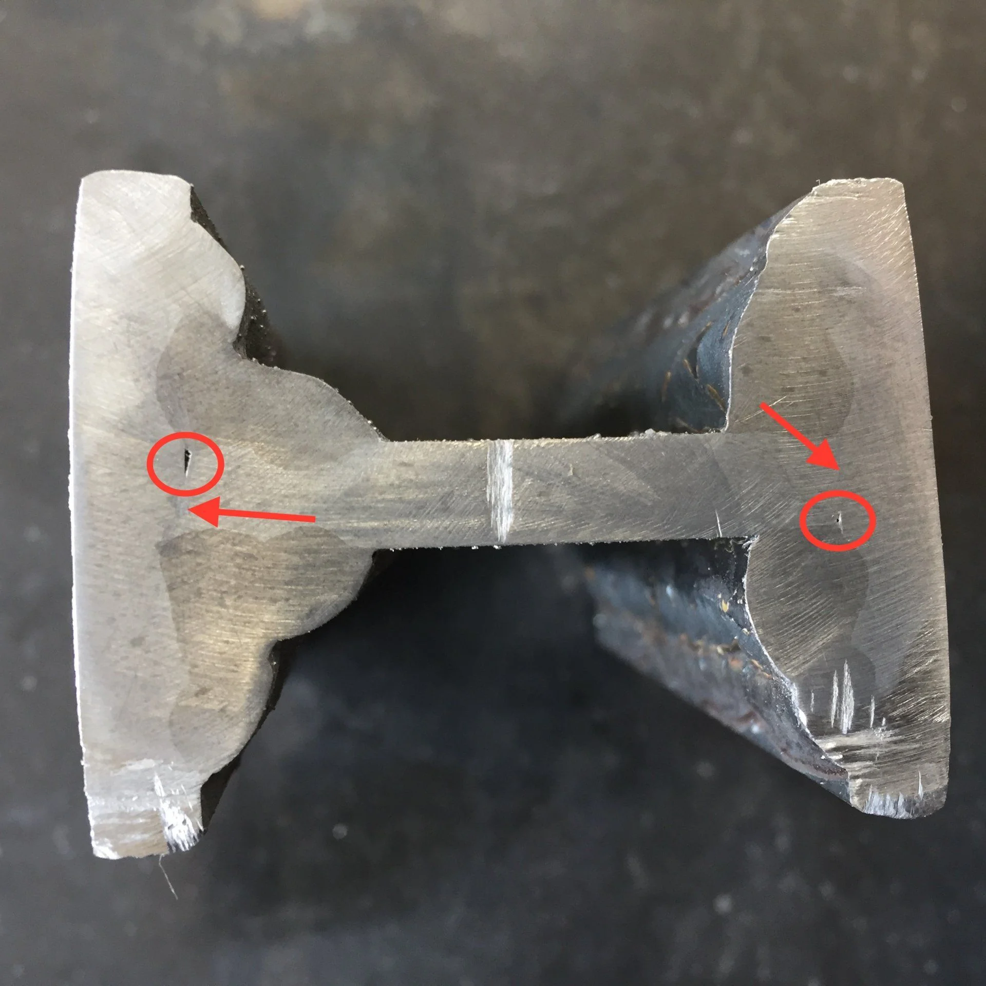

Sectioned these welds, polished and some Naval Jelly. 50%! 2 good roots, 2 bad. Just goes to show that I need to focus more on the root pass, probably not worry about much weave at all, just nail that leading edge of the puddle, and not move through too fast. Although no pic of the HAZ, I think it's looking a lot better too.
What I'm wondering about is the joints indicated by arrows. I haven't seen any welds on Youtube or elsewhere, which has that area being penetrated. Even on Jody's videos. So as long as weld beads are thick as base metal, and fuse the root well, then that's ok?
I could also turn up the voltage and wfs. I just used the auto set, but it allows adjustment up and down from what the machine suggests. I'll try another one hotter.
And no, I didn't bother finishing all the multiple passes, just wanted to check the roots mostly

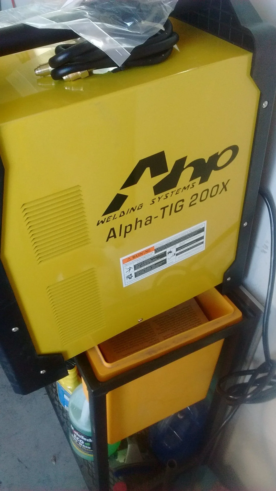

I have an AHP. It has been pretty good, though I did have to warranty it once.
I'd suggest getting a Weldcraft CK-9 style torch with their superflex hose and a gas lens kit.
Have fun!
The latest version comes with a flex head torch and a flex hose. It's not as nice as a super flex, but still very nice. I'm definitely going to stick with the 17 size torch for now. May build a water cooler and upgrade to a 20 down the road.

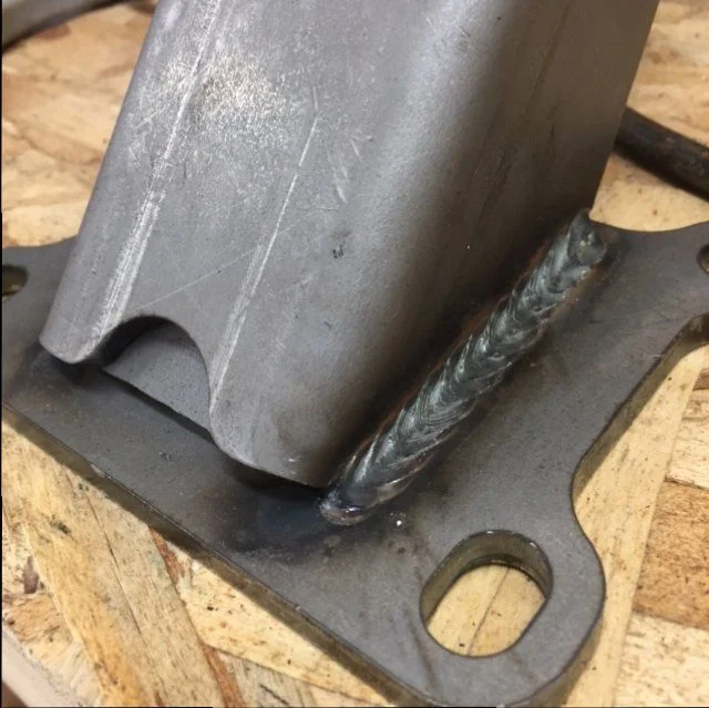

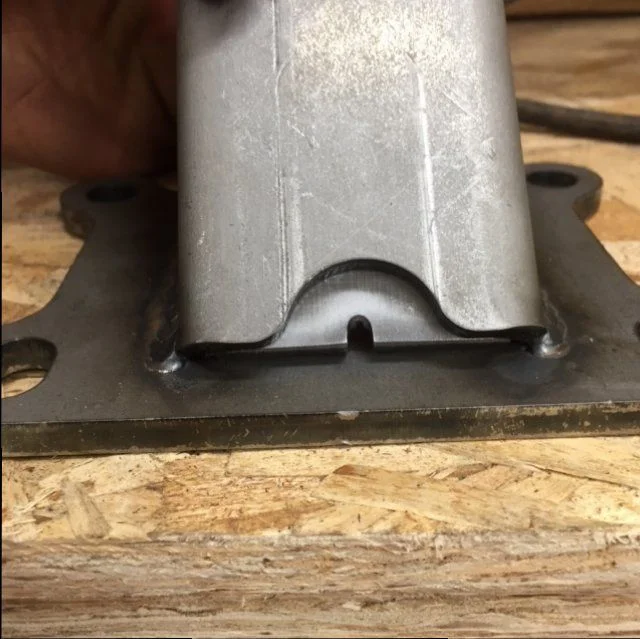

I'm wondering if any of you guys have an opinion on this. I've got AA engine mounts for mounting my Vortec. There are just the two welds on each side as shown in pic. Seems to me I'd like a little more. I was thinking of adding in the piece I made, as shown in the pic, and weld up that end a little bit. The notch is keep a water drain. Overkill? Good idea? Just seems a bit light on their welds.
I'm sure they're fine. But , I would want more.
Those looks like "MIG like Tig" welds that are fashionable among self taught operators. If you did that in welding class, the instructor would slap you upside the head and say "quit screwing around". Besides the travel speed being too high, the operator is whipping ahead of the puddle to lay an overlapping puddle that looks like a Tig weld when the operator is dipping too slowly. They problably have a lack of fusion at the root of the trailing edge of each puddle he jumped in to. The throat also looks thin. It couldn't hurt to grind them out and lay in a proper bead.
Single pass is plenty sufficient for that gauge material assuming proper wire feed rate, torch speed and amperage. That's plenty of weld to hold the two parts of the assembly together. I wouldn't worry about it.
If anybody is looking for a how-to pic for laying beads that will produce cracks in a timely fashion, look no further. Always, always, wrap your corners.

I wouldn't lay that extra plate in the bottom and weld it - That's where the water and crud are supposed to be able to drain out IMHO.
