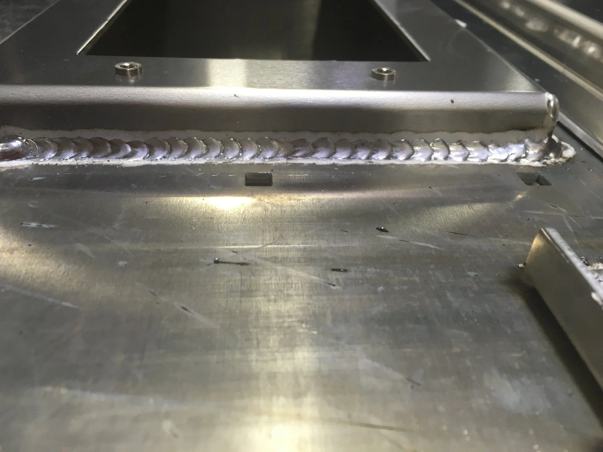

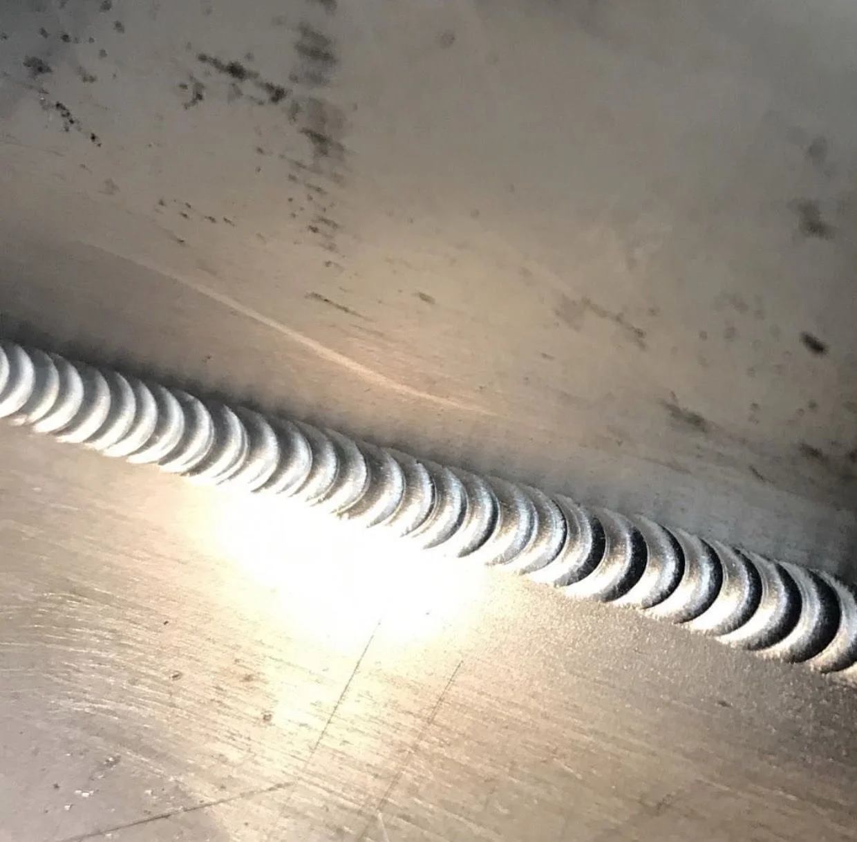

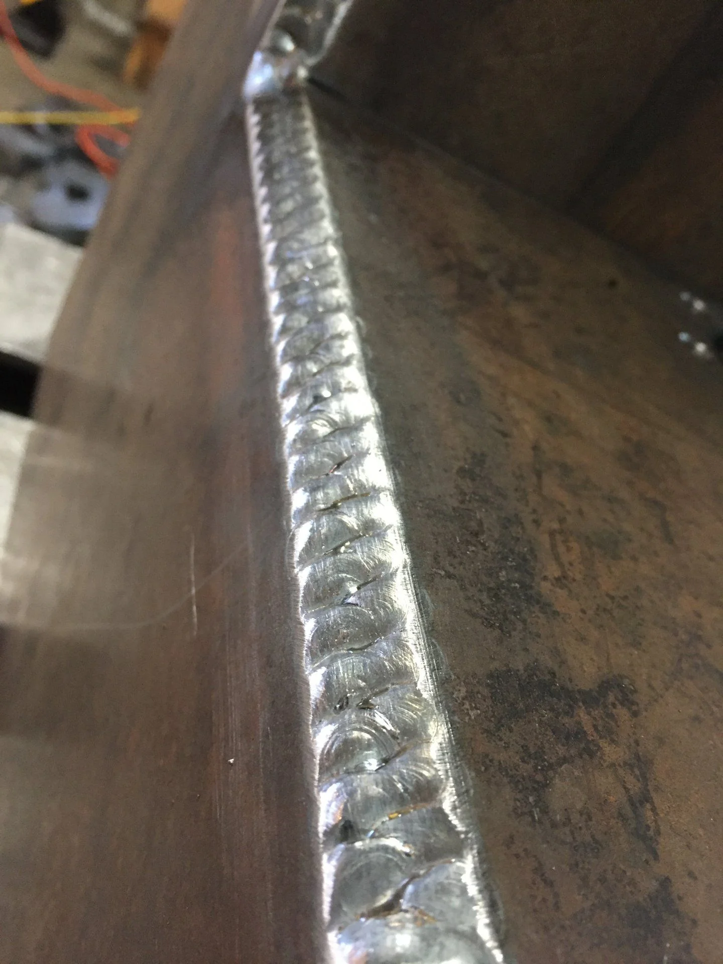

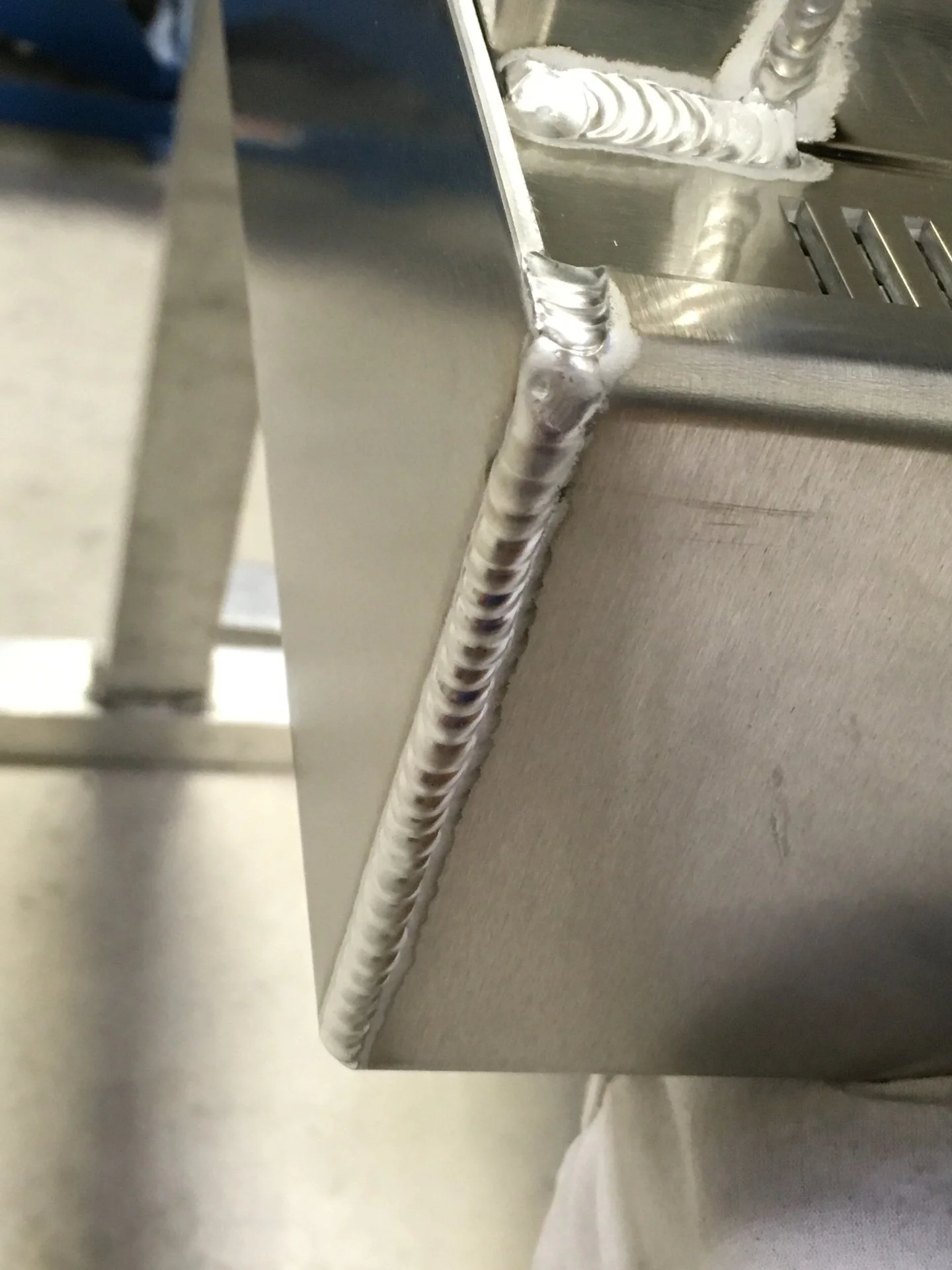

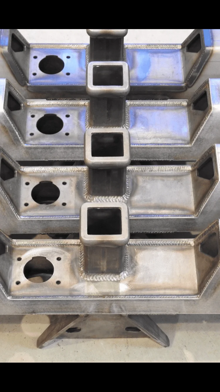

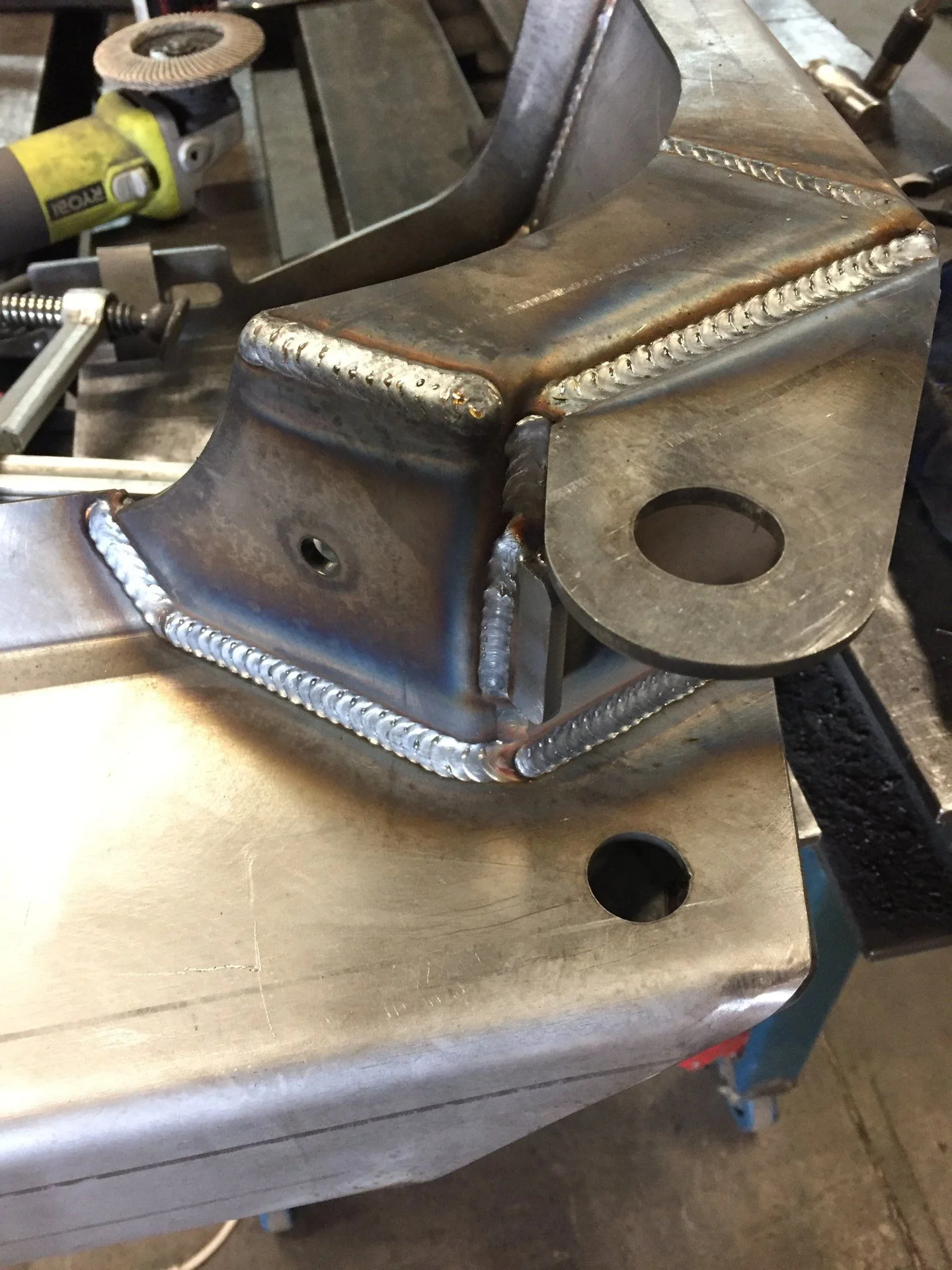

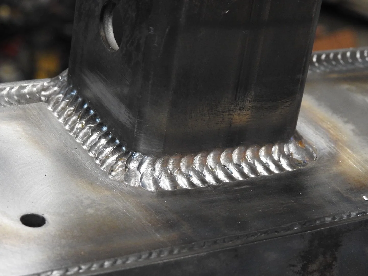

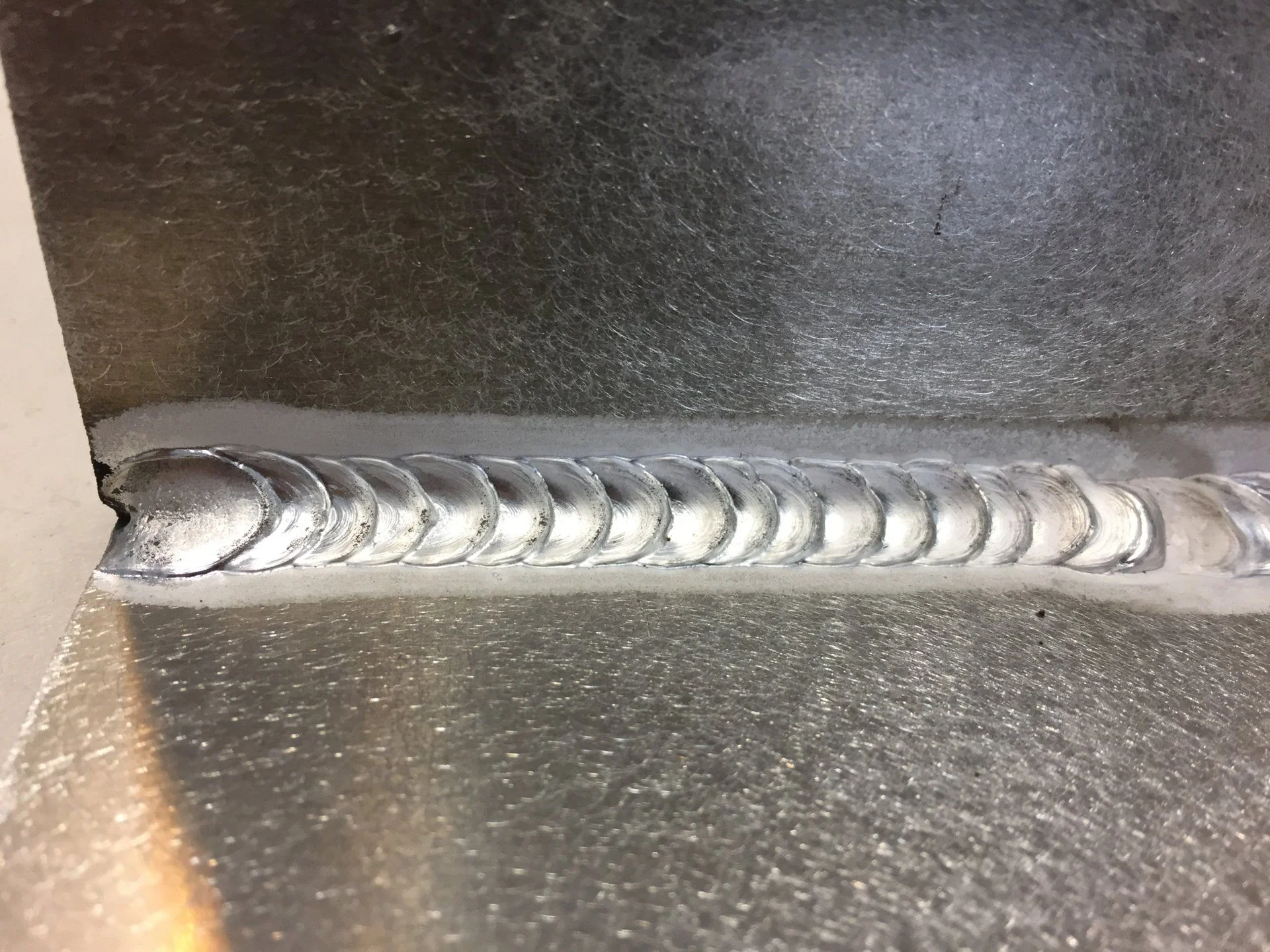

Here are a few pics of some mig on the last batch of bumpers and a 3/8"
Open corner weave.
Dude! Those welds!! Send me a reject, I'll put it in my living room to admire! :)
Nice looking work ben, and this comes from a guy that looks at and though welds for a living............
Are you you running a pulser set up for penetration, running that cool for aesthetics, or are you just doing a long pause on your weave to soak it in.
Thanks!
Running cool, slow with 0.30 and a long pause on the aesthetic welds, all joints are welded inside and out, a hotter weld setting is used on the insides with 0.35.
I also weld the inside first to pre heat the piece for the outer welds.
It actually quite surprising how good the penetration can be with the colder settings if you crank down the wire speed accordingly. I definitely wouldnt recommend cold settings for the beginner as to get a sound weld there are many factors that have to be taken into consideration.

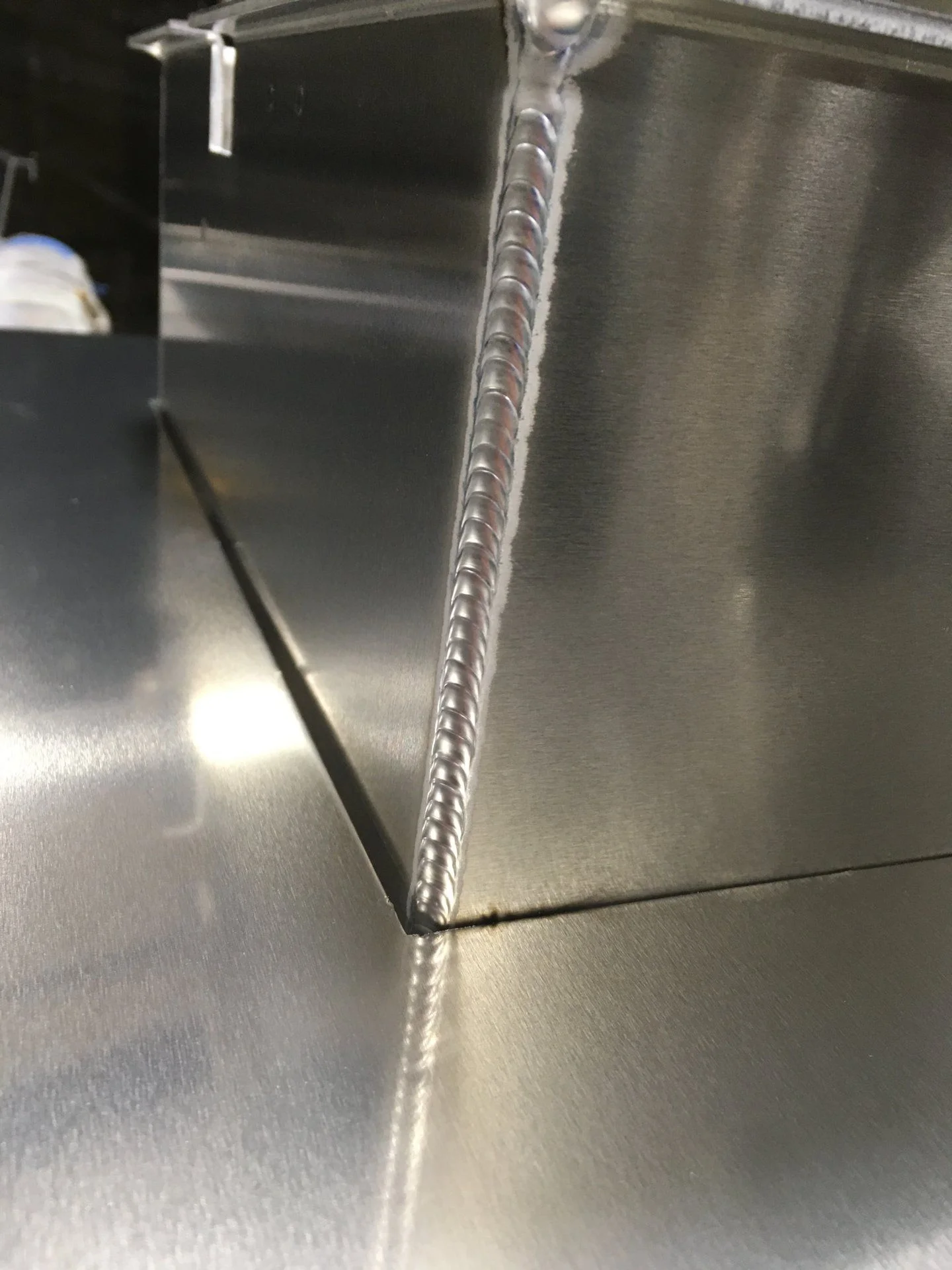

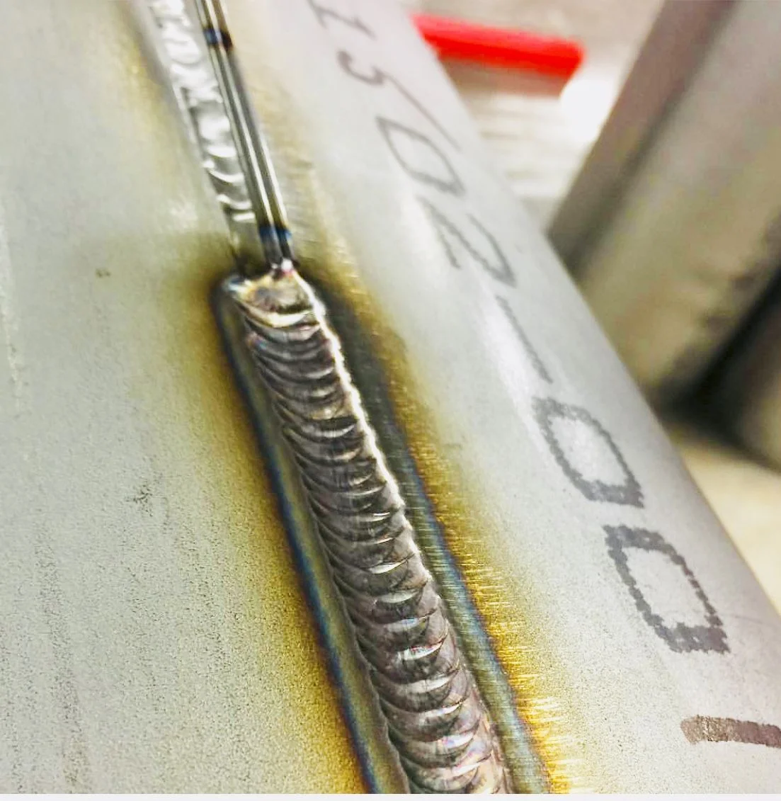

This is picture I actually used a different technique, since the other side of the joint is visible and can’t have any penetration, so it’s welded super cold just to be water-tight. Wire speed way down, and haul. Aluminum MIG just doesn’t seem to go around corners very well.

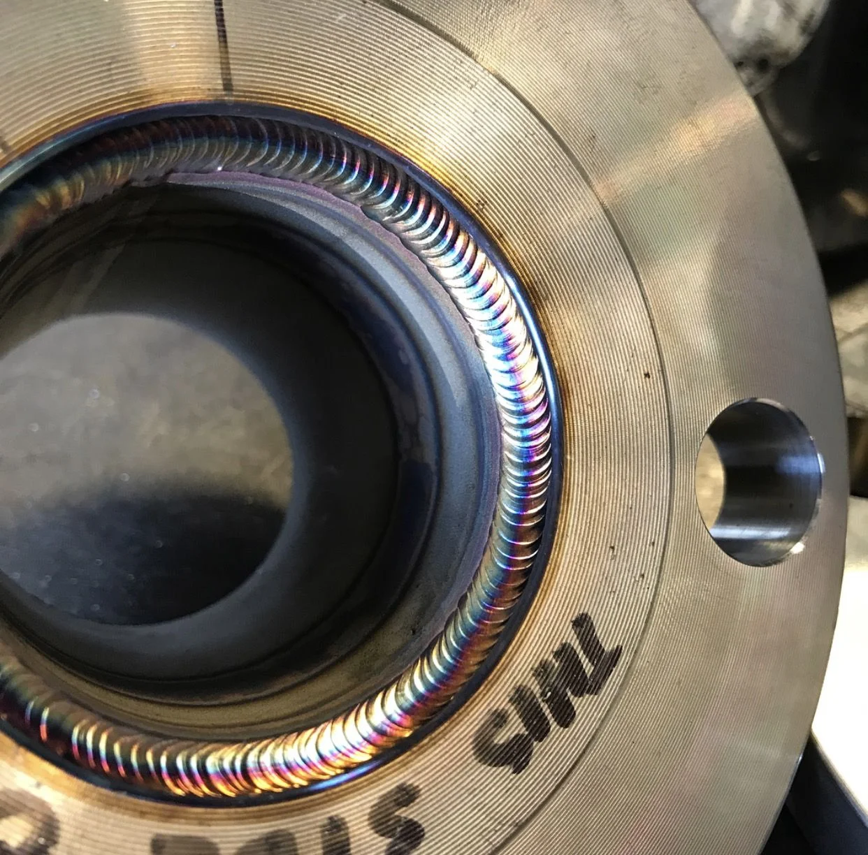

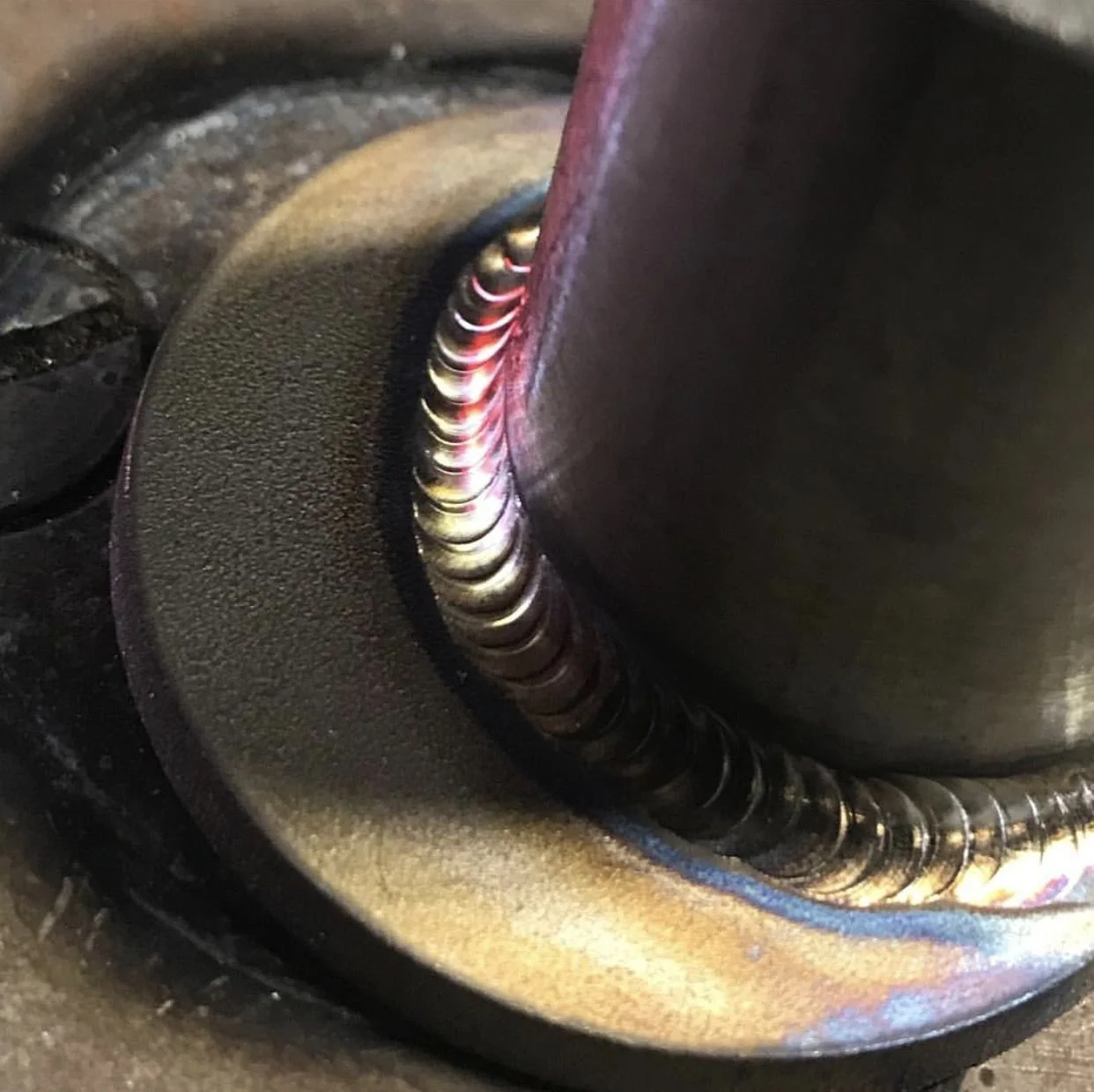

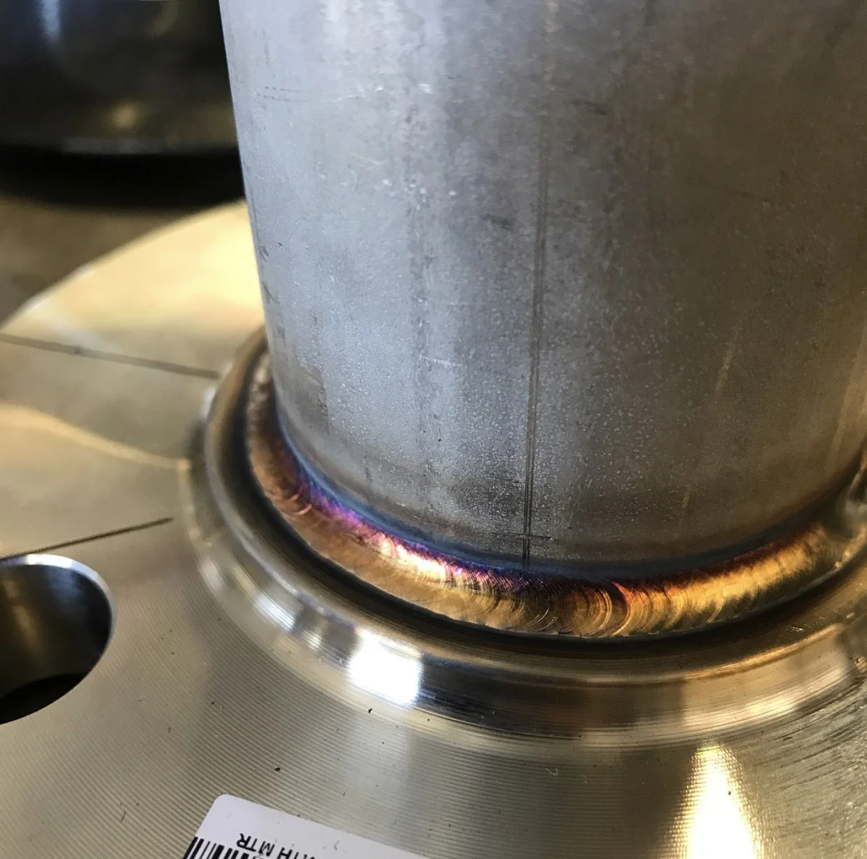

I did a lot of outside corners with the TIG, Lincoln Precision TIG 275:
