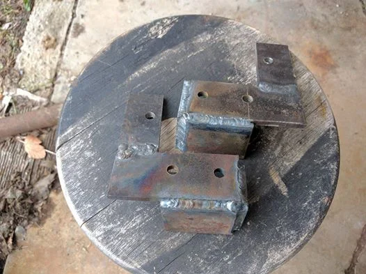

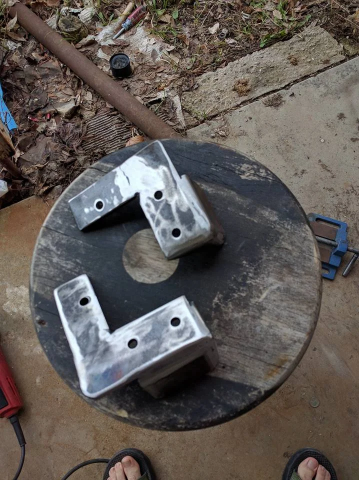

This was my first weld in probably 8 months due to my new job and moving out of my shop. Exhaust for my chopper
Inside of the stainless tube
Nice welds, and I love the bike! That is pretty heavy stainless, what's that for?
Yeah, its for my bike. Its .065" wall but the reflection off the bevel may make it look greater. Between the .430" exhaust flanges and the tubing you could crane the bike up from the exhaust if the heads wouldn't break. I could have gone thinner but I wanted to get this exhaust under my belt first before I did a thinner wall 316 SS set I have in mind. The previous post you can also see I was trying to get my purge dialed in as I was having trouble until I got another tank and flowmeter and made some purge plugs.

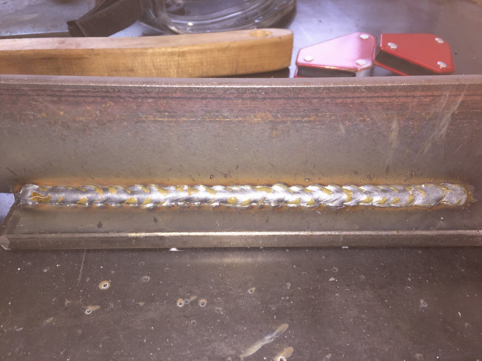

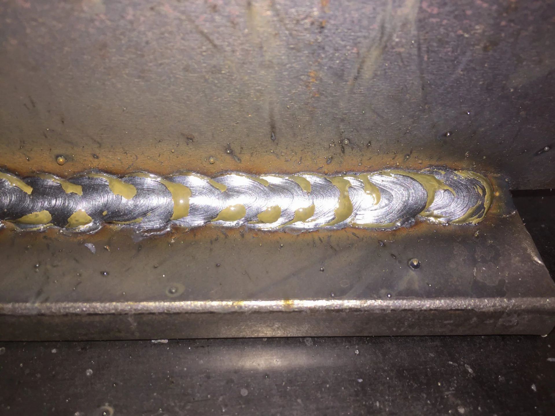

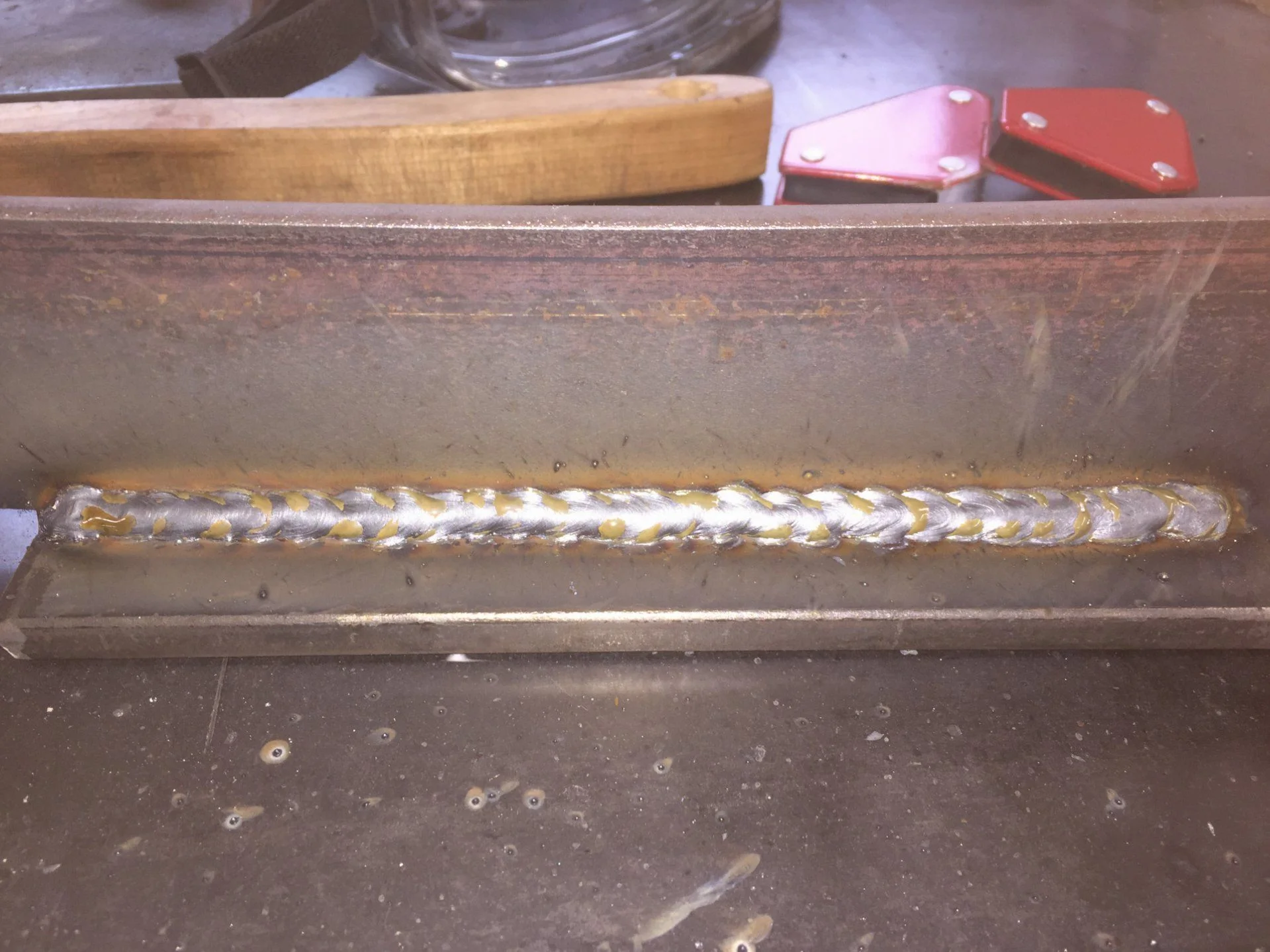

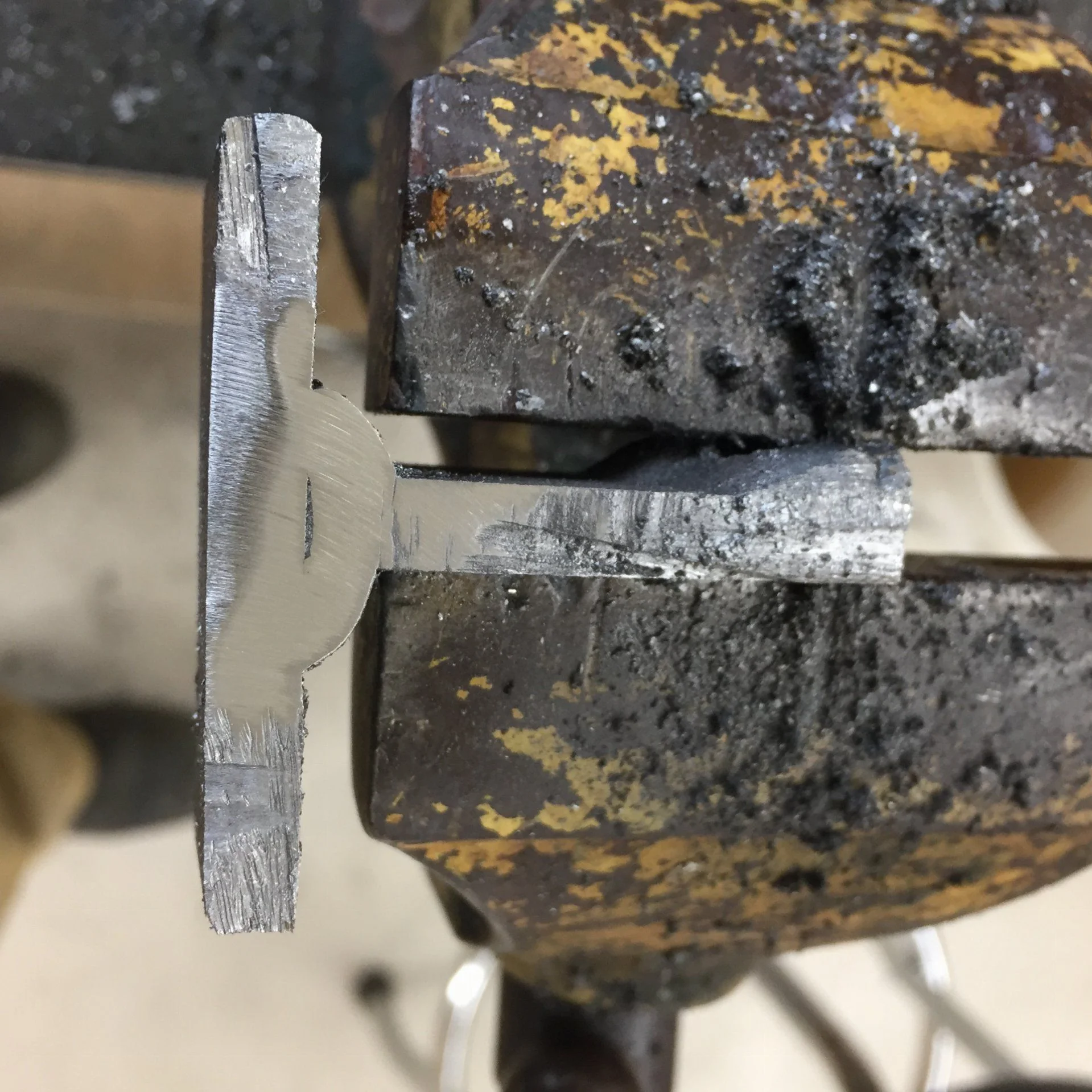

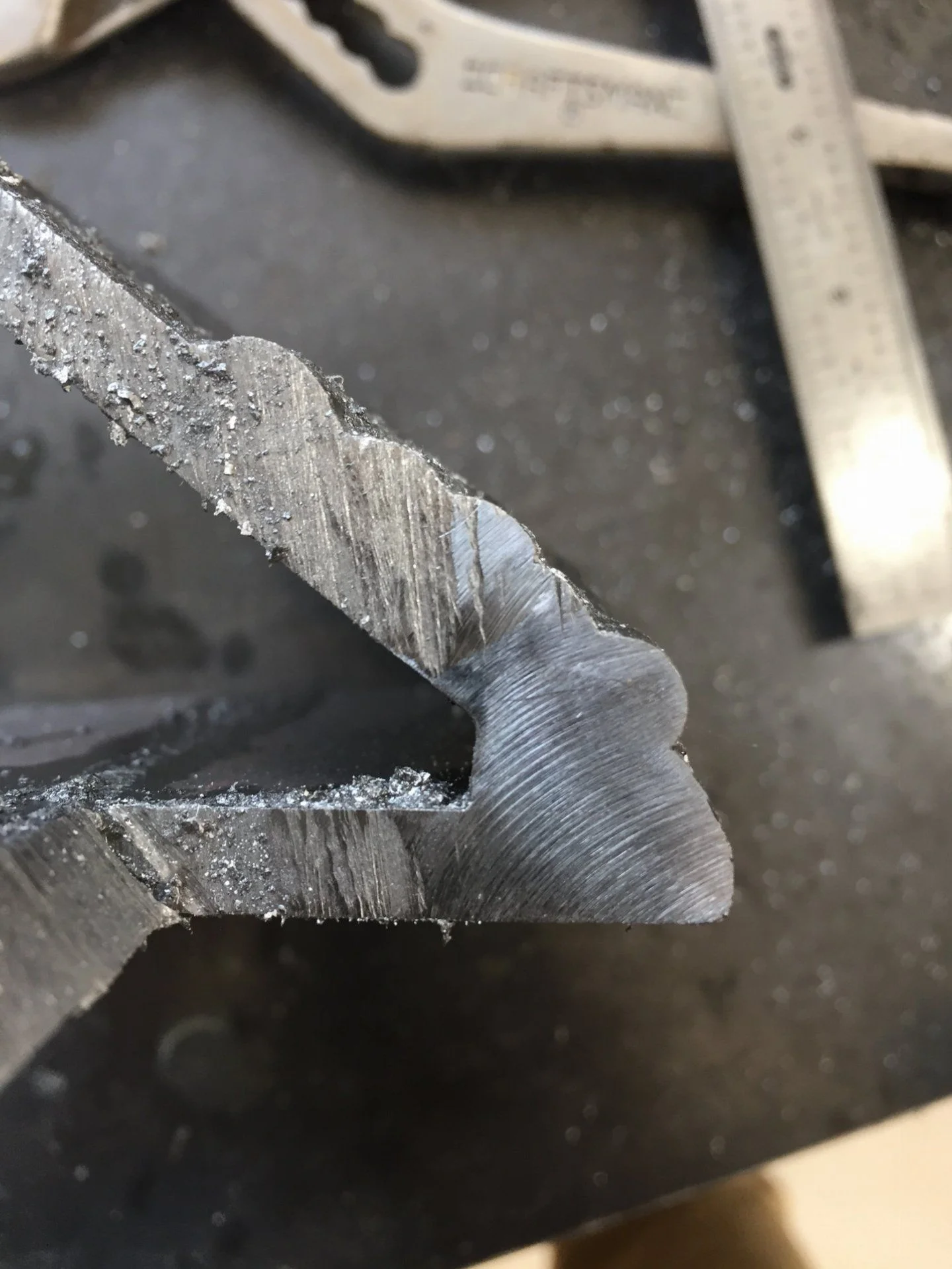

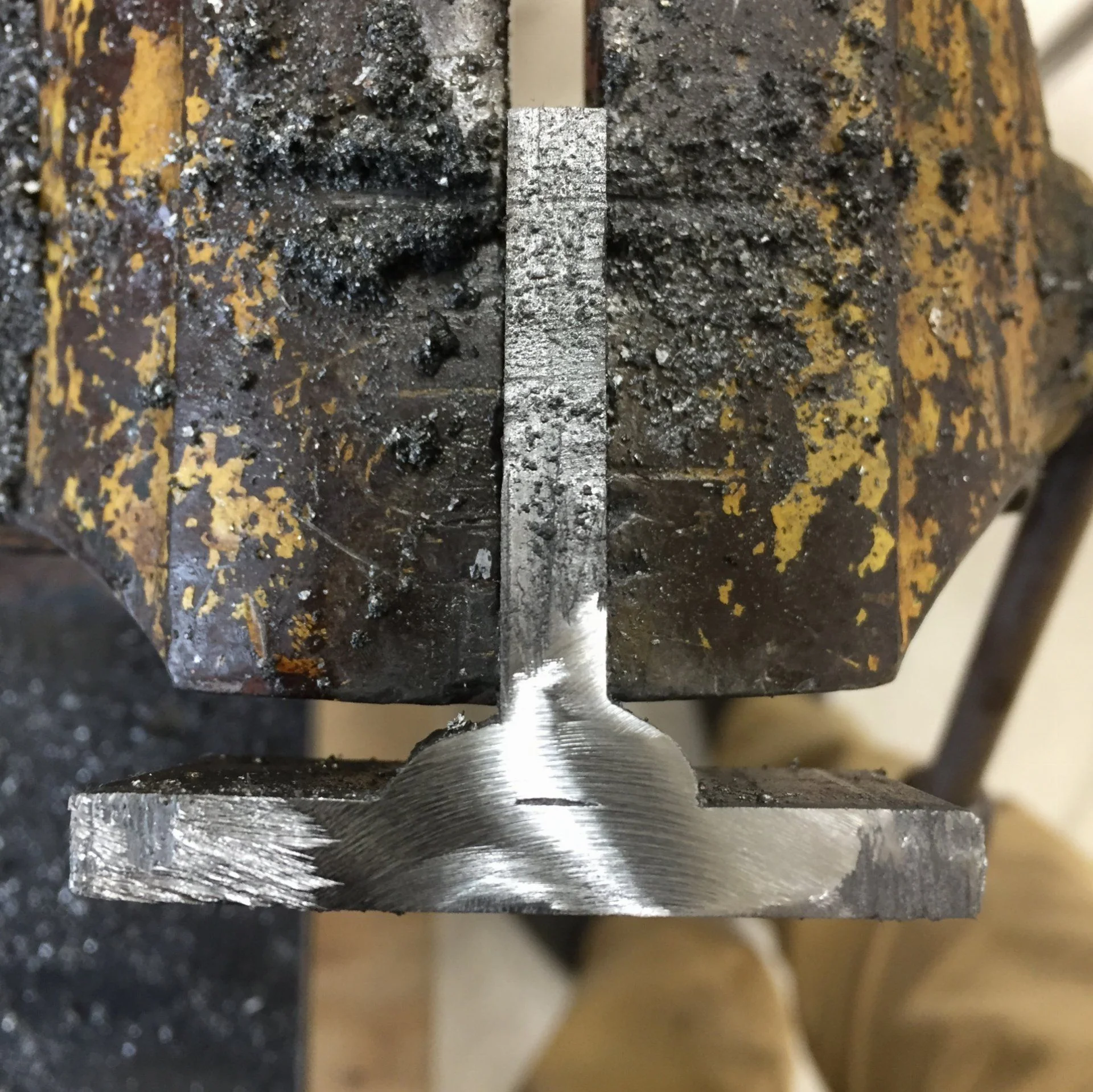

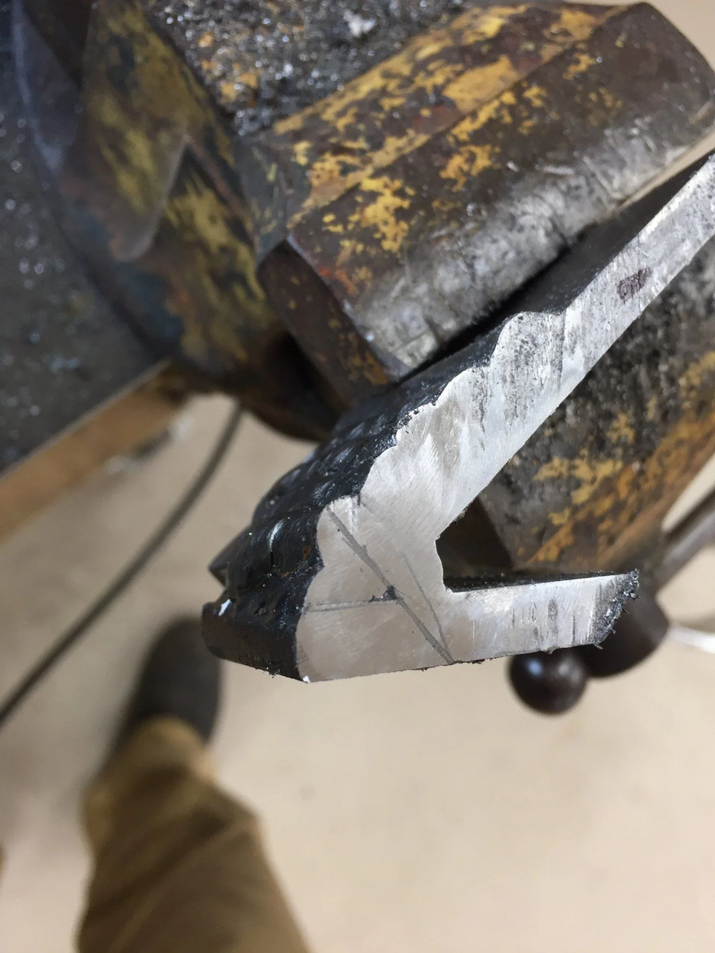

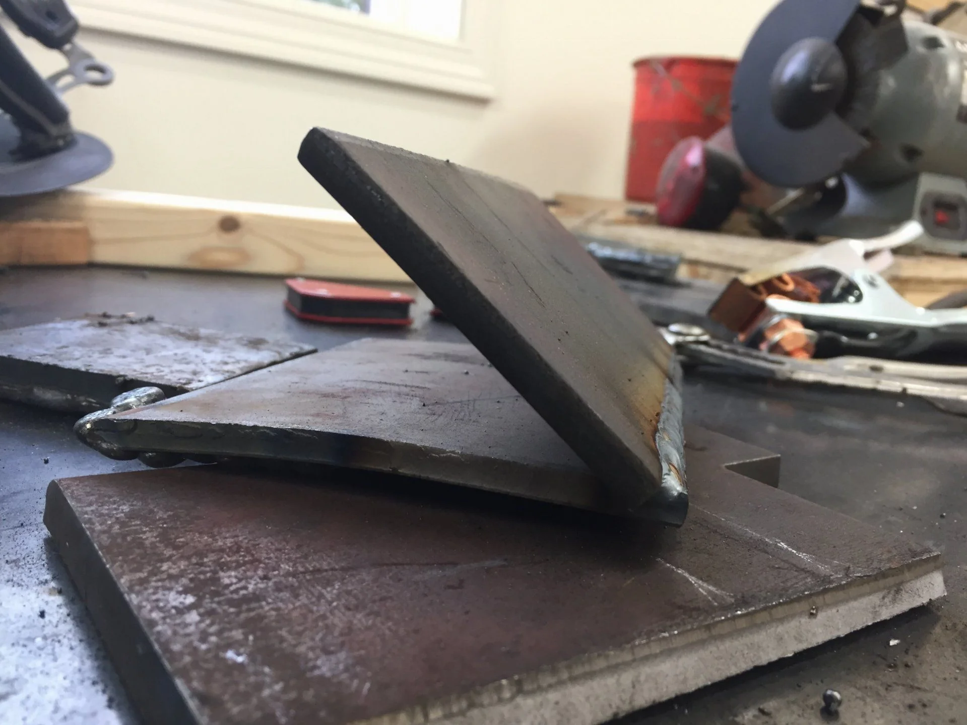

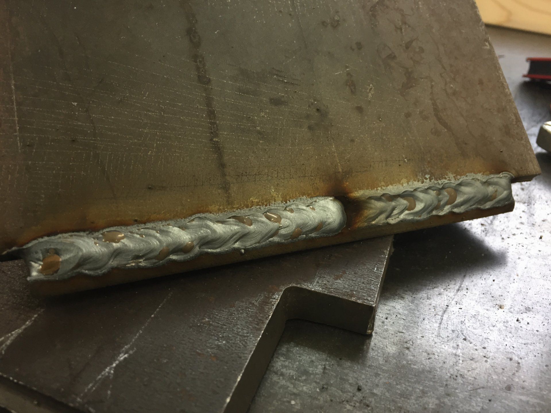

A long time since any activity on this thread. I was looking for some feedback on MIG. Posting a few pics, maybe I'll get some comments. A newbie MIG guy. Trying to get good enough for my SOA
A long time since any activity on this thread. I was looking for some feedback on MIG. Posting a few pics, maybe I'll get some comments. A newbie MIG guy. Trying to get good enough for my SOAView attachment 1405904 View attachment 1405904 View attachment 1405906View attachment 1405905 View attachment 1405905

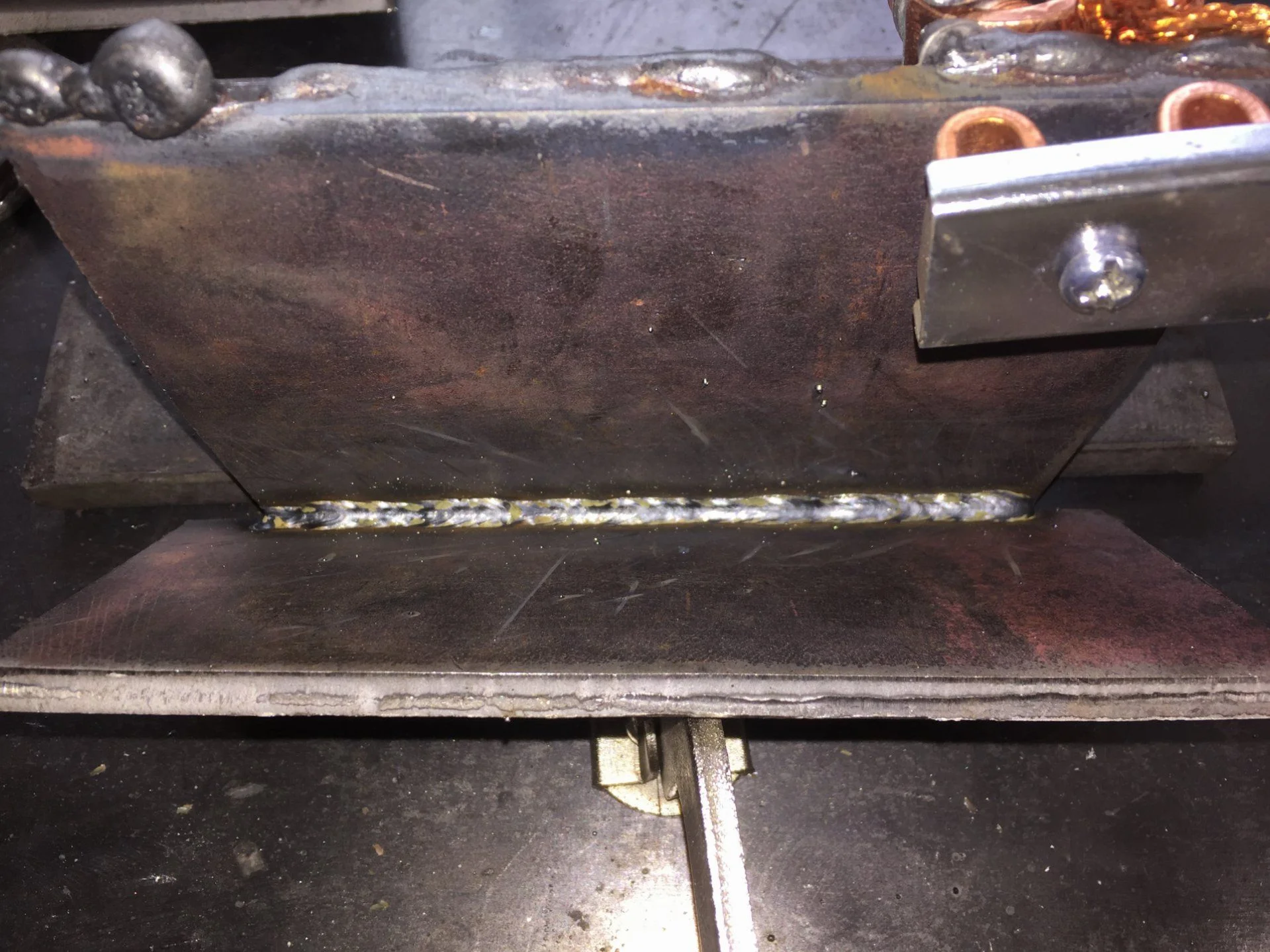

I beat on this thing with an 8 lb. sledge before I did the inside angle weld. Held great, but would I trust my life on it?:hmm:
The only real way to tell is to cut the weld, then polish and etch it to see what the penetration looks like.
Looking at the exterior of the weld, it looks like you didn't have enough wire speed for the speed at which you were moving the torch. Your heat affected zone is pretty thin for the metal thickness. Get another couple pieces of test metal and run another bead, but slower.
Thanks, I'll try that, I'll see if I can do it within a couple hours, otherwise, I've got to go out of town for a while, in which case it'll be 10 days. Now that you mention it, I looked up some pics showing the heat affected zone, I totally agree, looks like there almost isn't much zone at all.
you may want to say how thick and how many amps
Do you have etching solution?
Penetration doesn't look good from these pictures.
I agree, penetration not good. I've got some naval jelly I hear works for this. I'll try that for a better look. Right now I'm thinking pausing more on the front of the puddle, keeping the arc there longer and not so much side to side weaving
Yup, naval jelly should work, just make sure to sand the edges smooth before etching to allow the lines to stand out more.
Pausing more on the front of the puddle should allow the puddle to wick more into the root as well as penetrate more. It'll slow you down which will help as well.
Really appreciating the input/feedback, thanks:clap:
