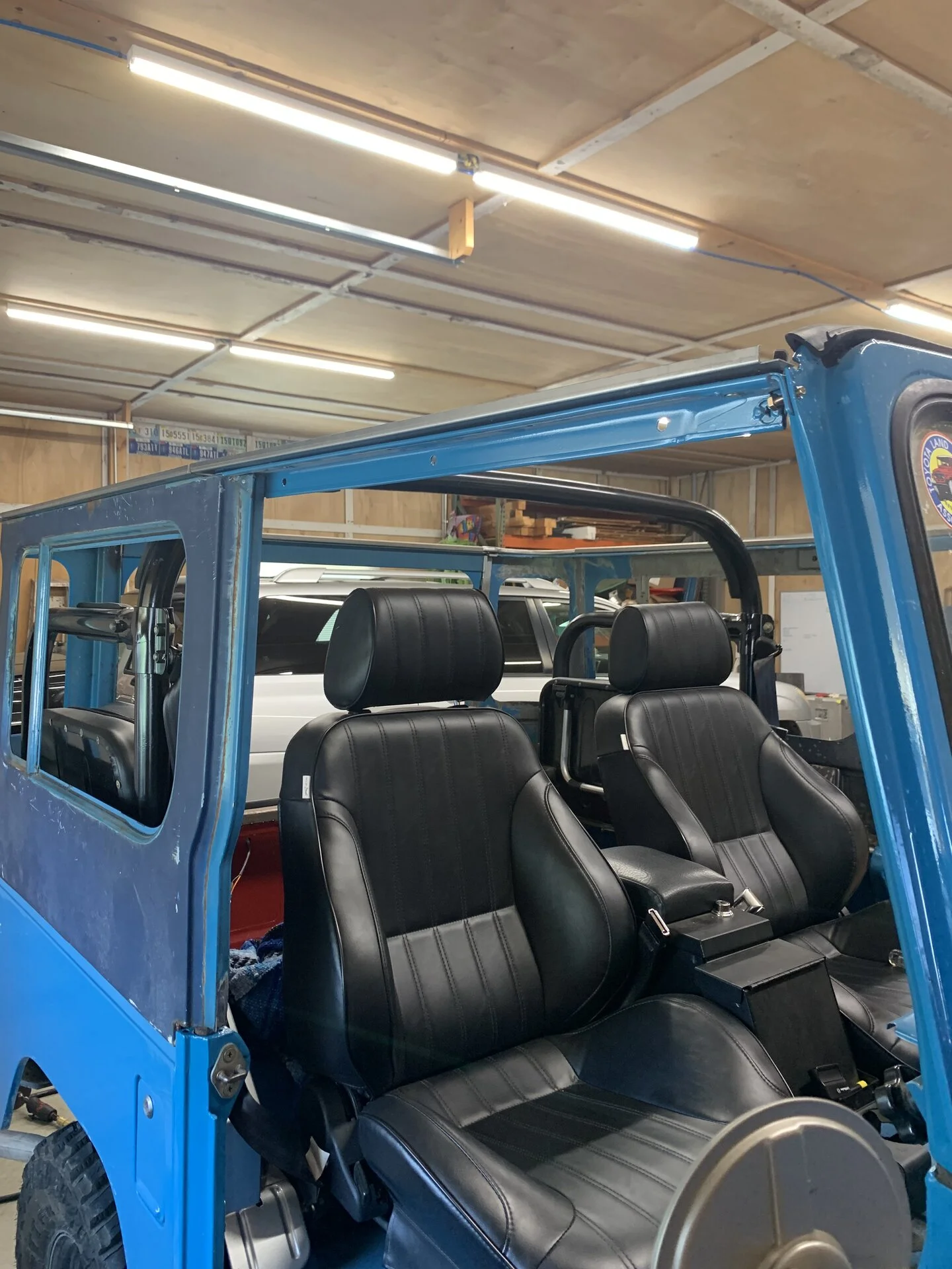

working on the passenger side hard top side

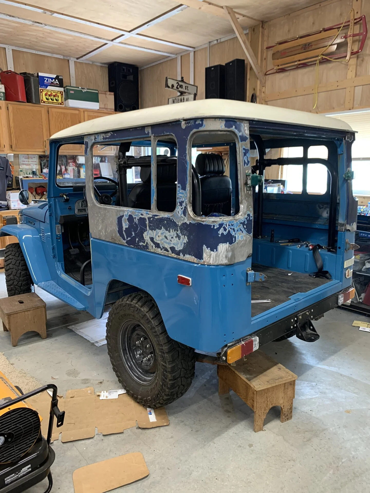

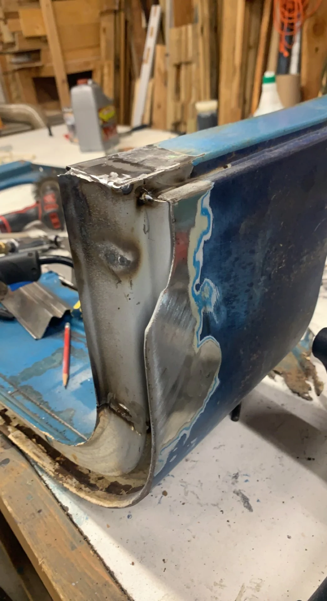

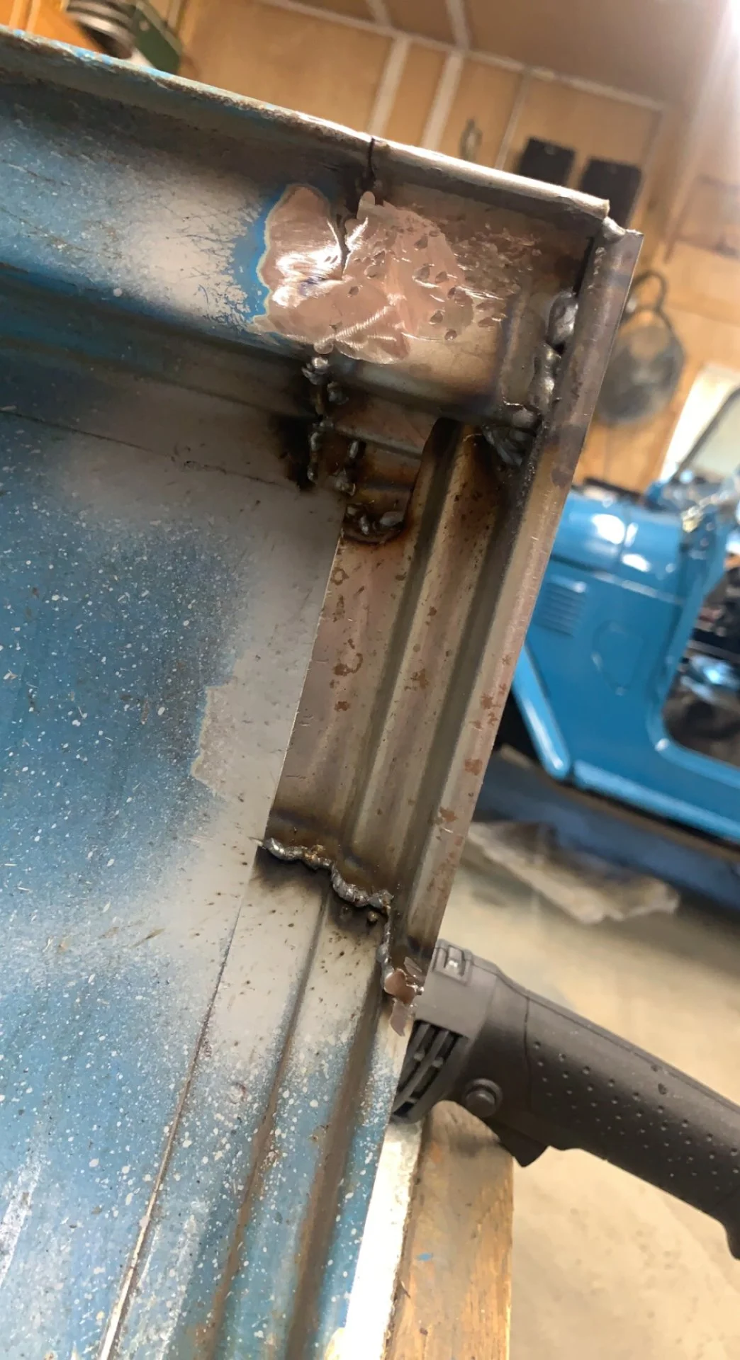

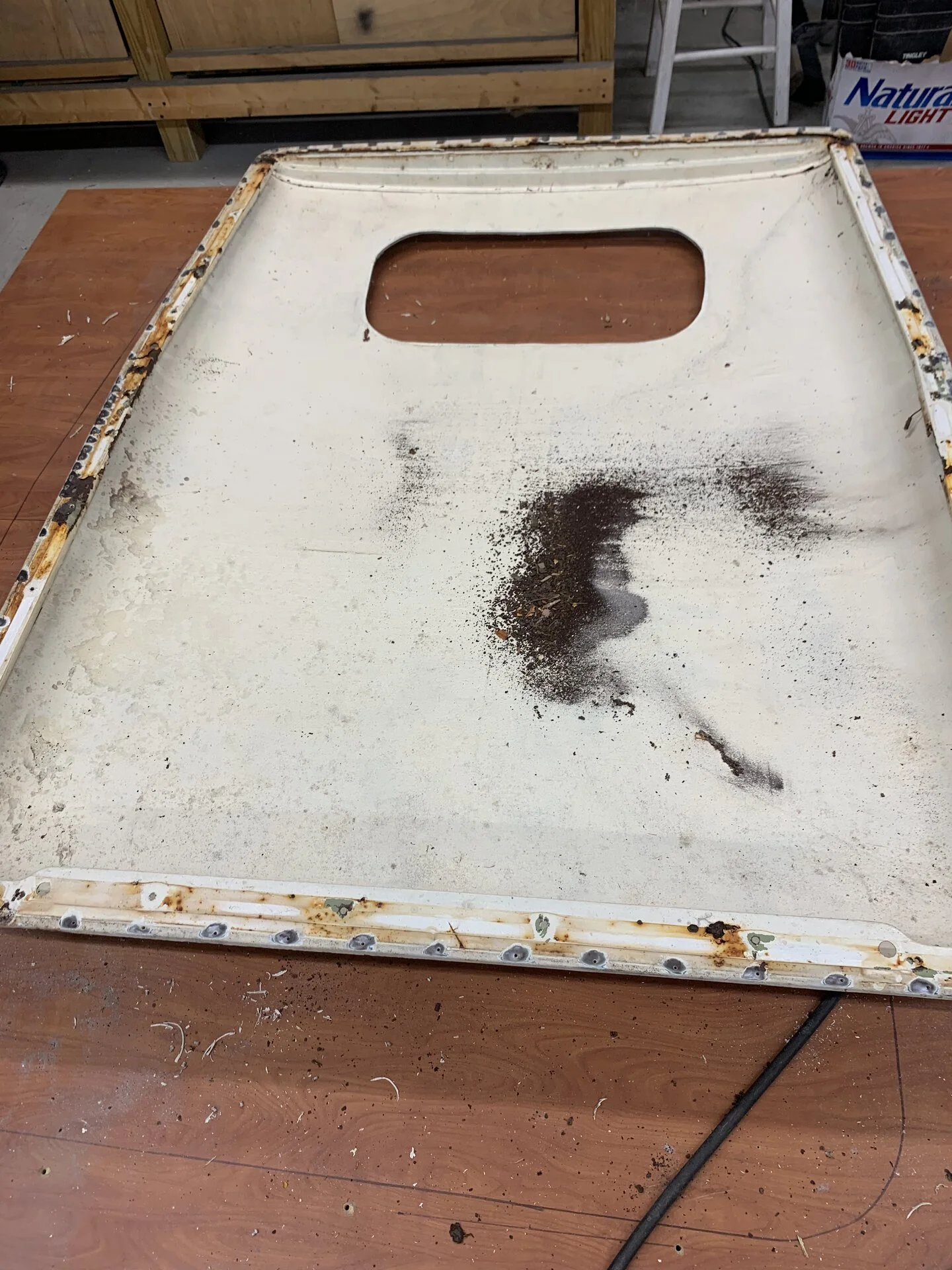

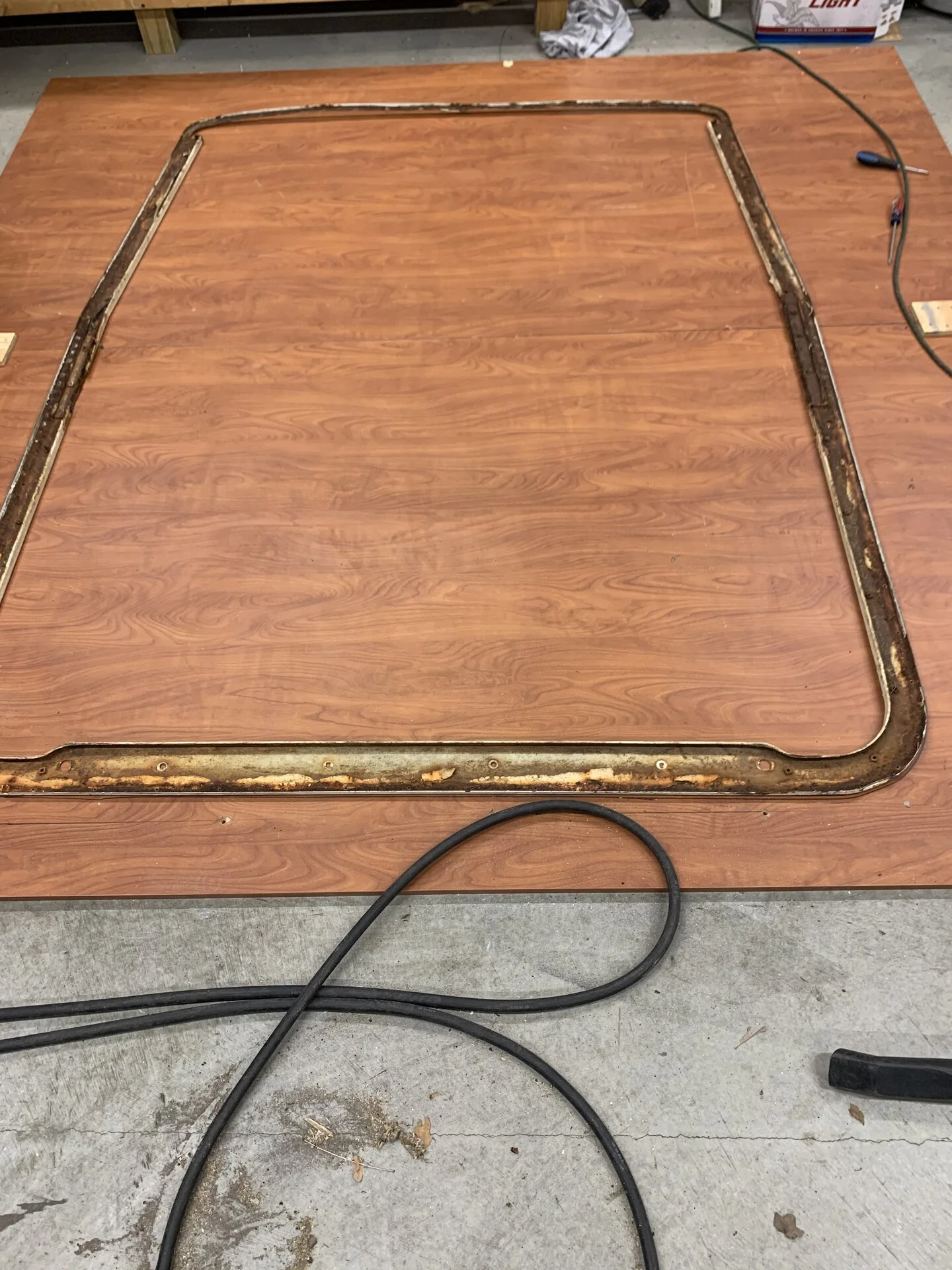

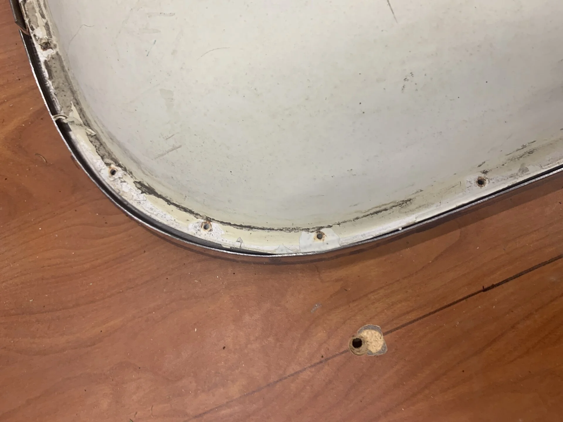

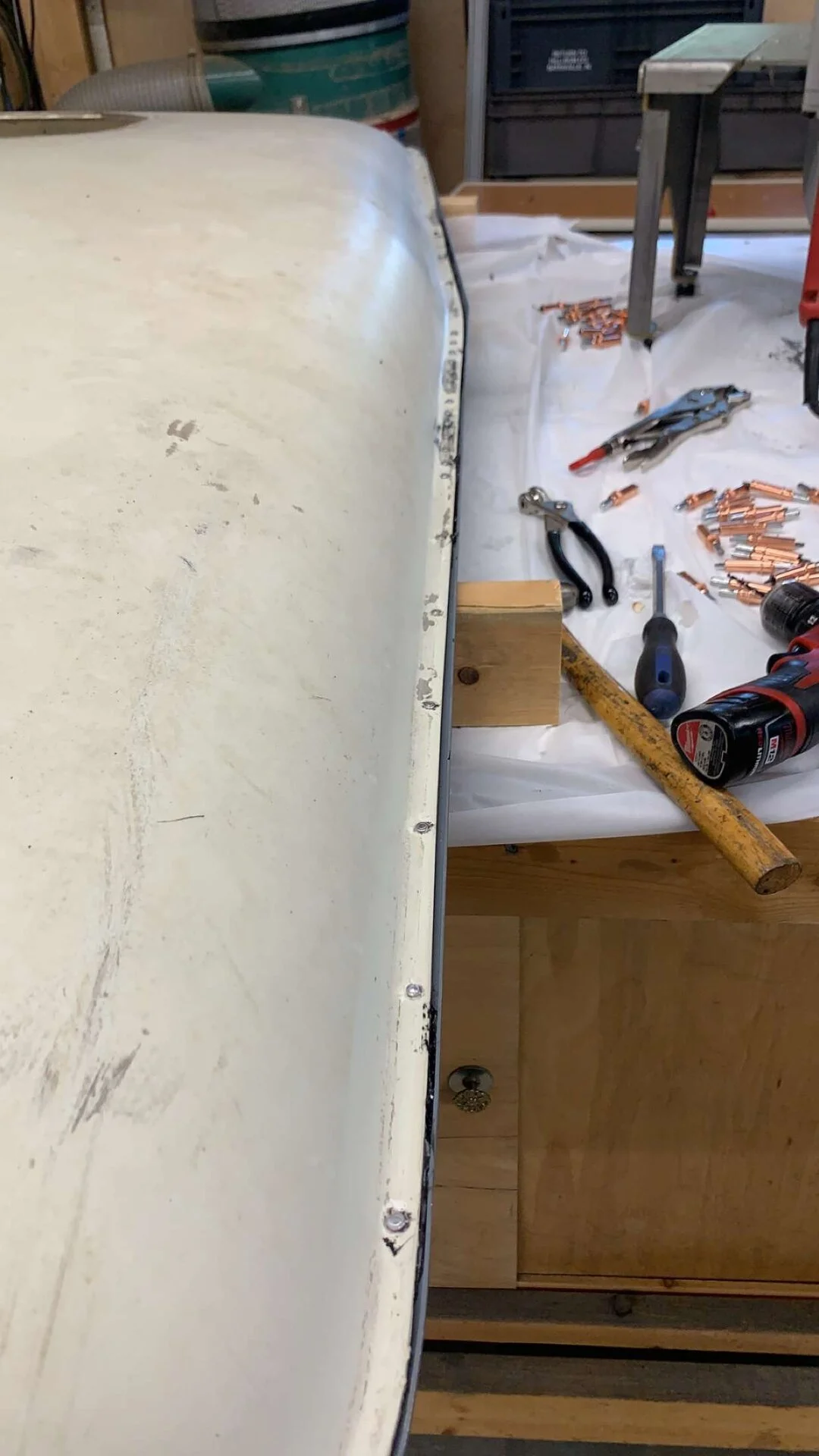

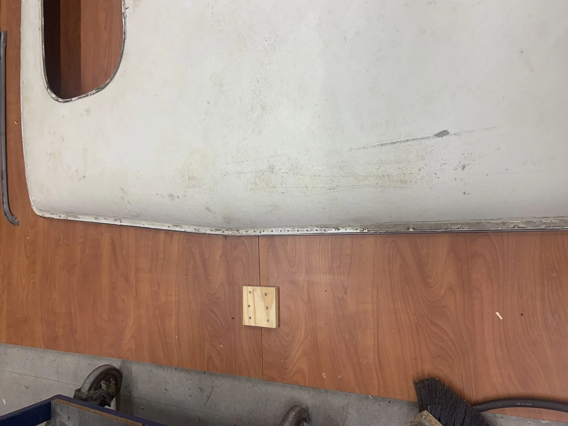

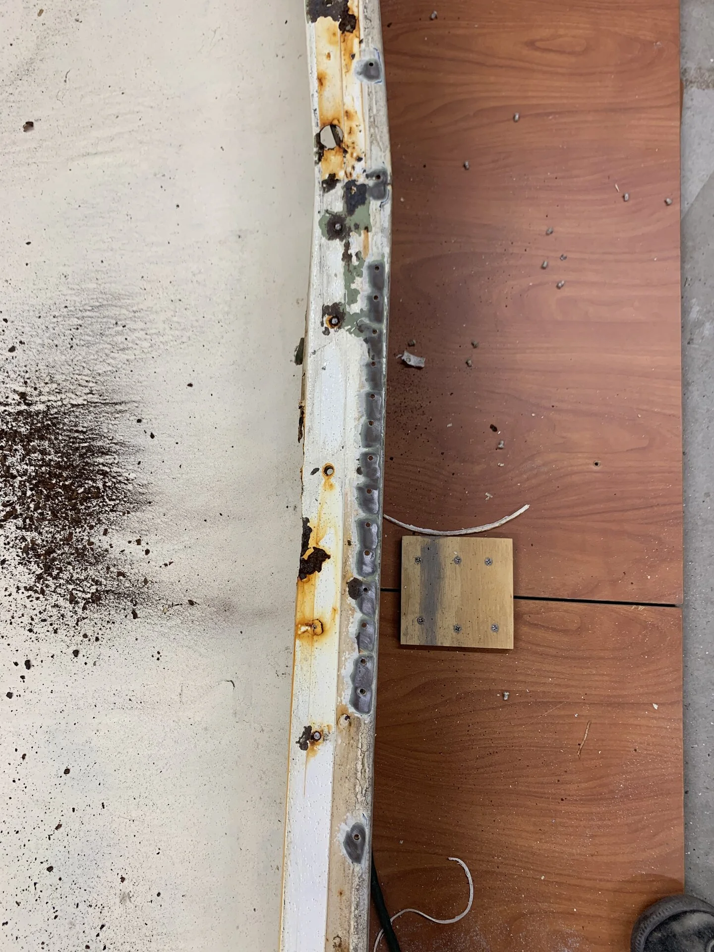

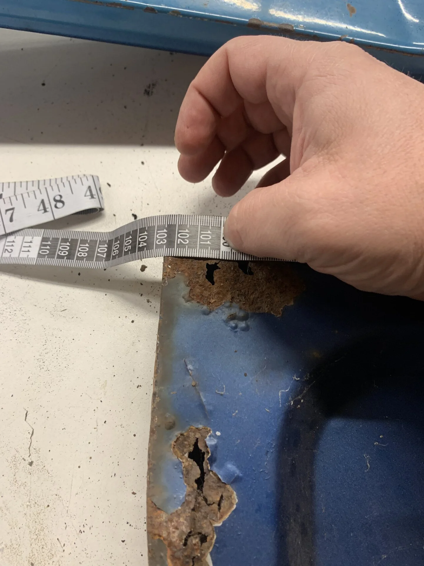

well got the caulking scraped out. sanded and punched out a number of rivets. weird thing is around where the pillar of the hard top comes up at the door jam there were a bunch of rivets like one every inch…. the rest of it had them on what seem to be the normal spacing 4 inches apart approximately.

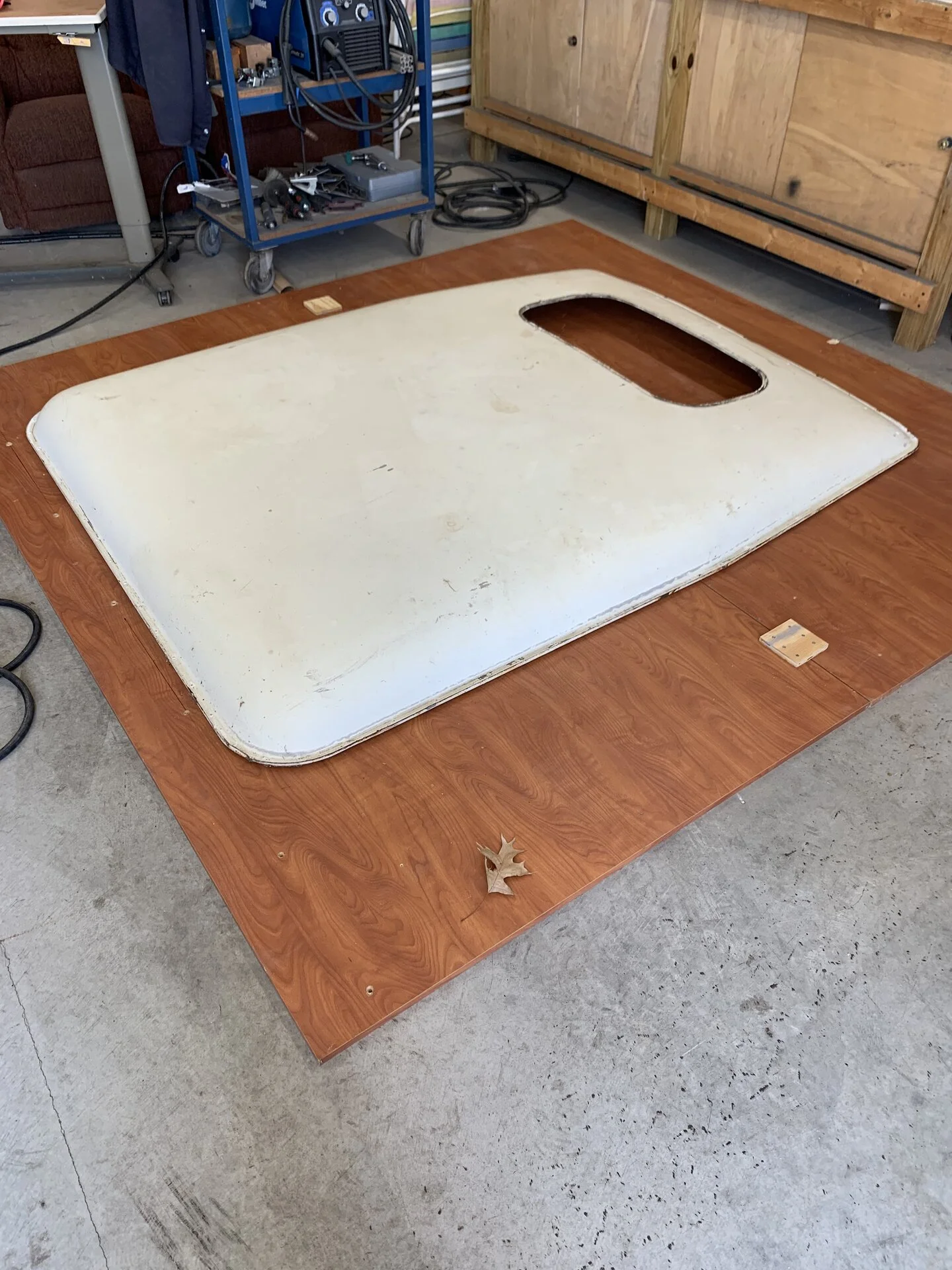

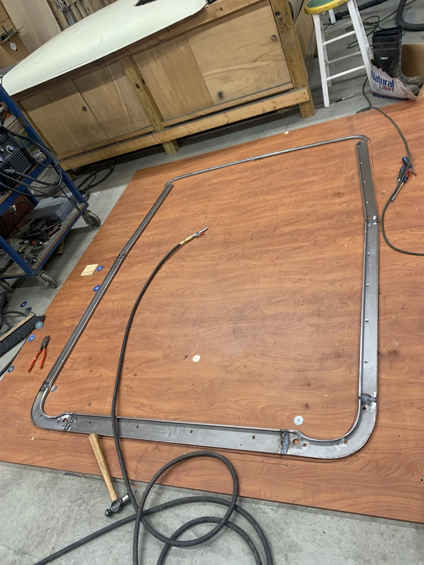

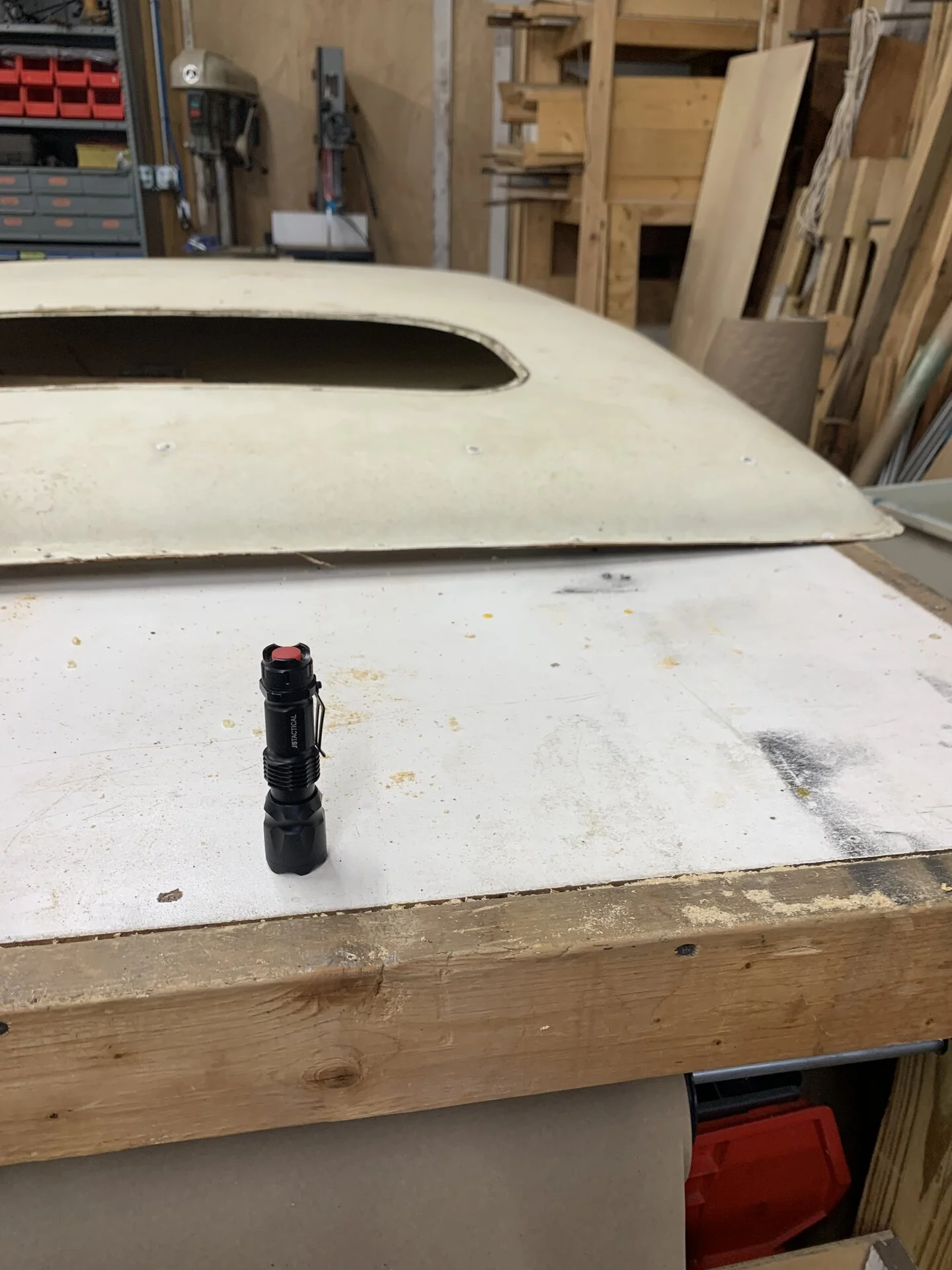

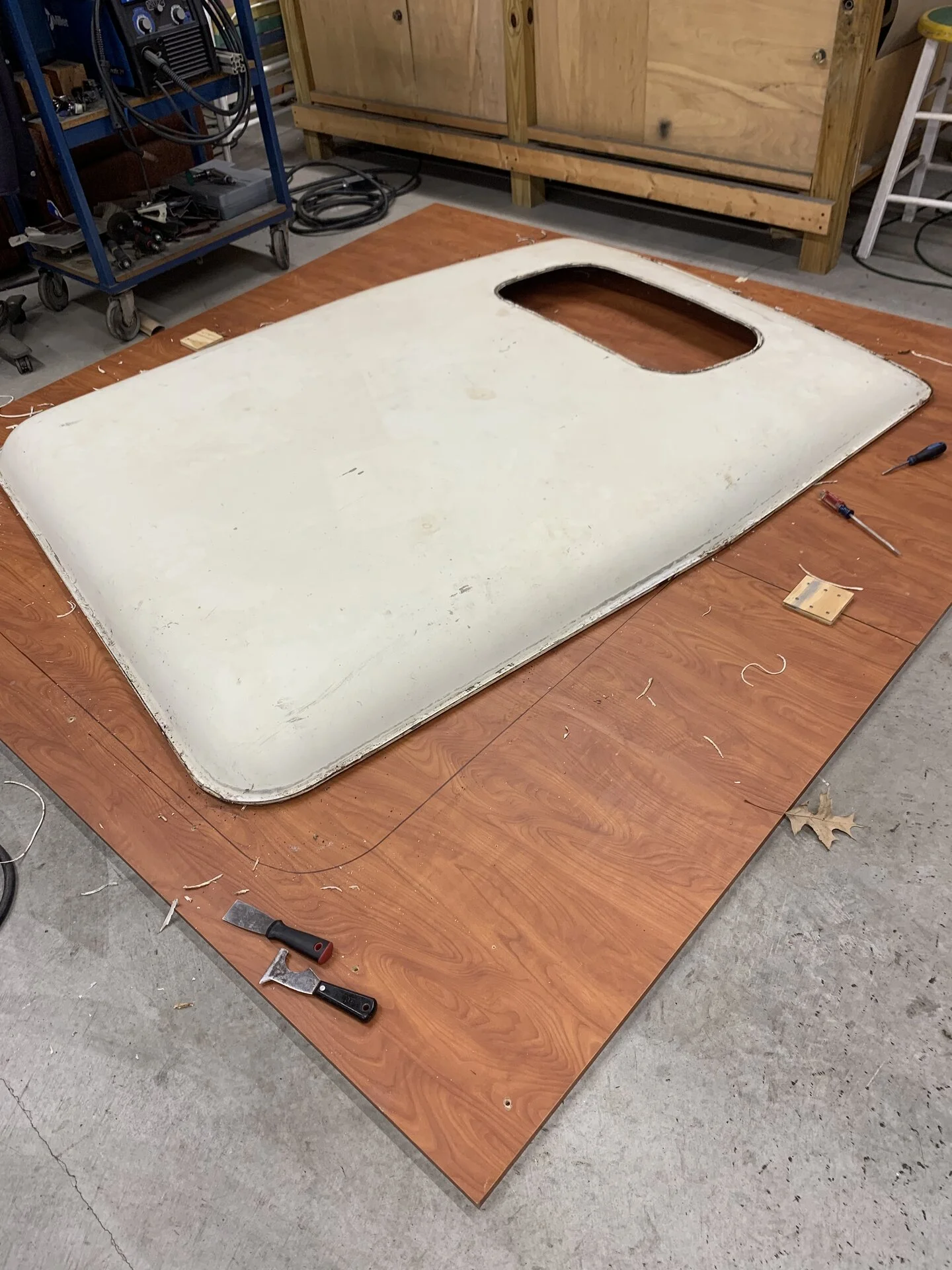

the pile of rust in the top after knocking out all the rivets. Second is the well riveted part above the door jam. Third is the rusty old frame gonna mark some reference holes. Then comes the new metal from CCOT. Fourth picture is front of the cap. Is this curvature normal? i’m wondering if sitting off of the forty for close to 8 or so years has cause warp age?

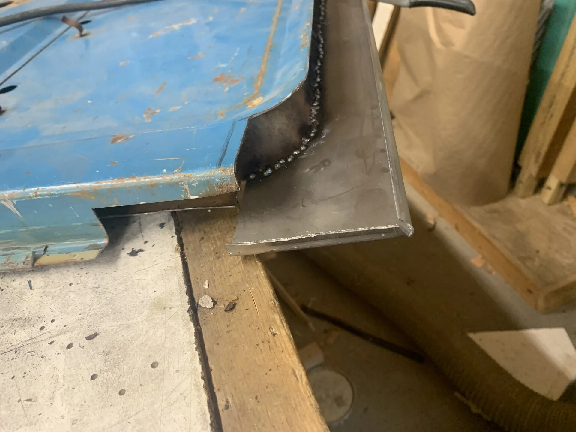

Some dry fitting of the new metal. Waiting on a pair of the L brackets that bolt the windshield and door header together.Then try the fiberglass cap on to be sure. Then tack it together and pull it off and finish weld it up

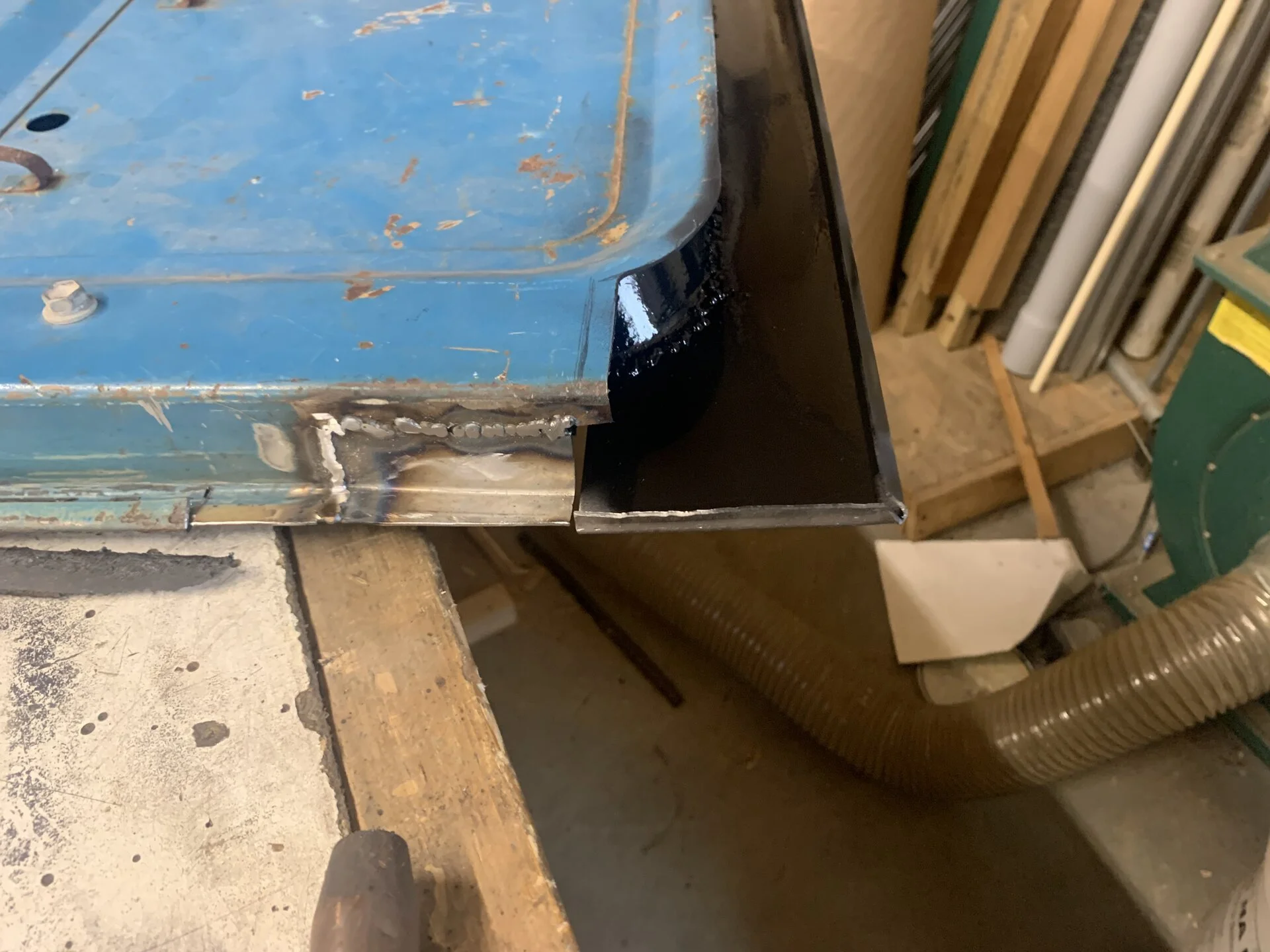

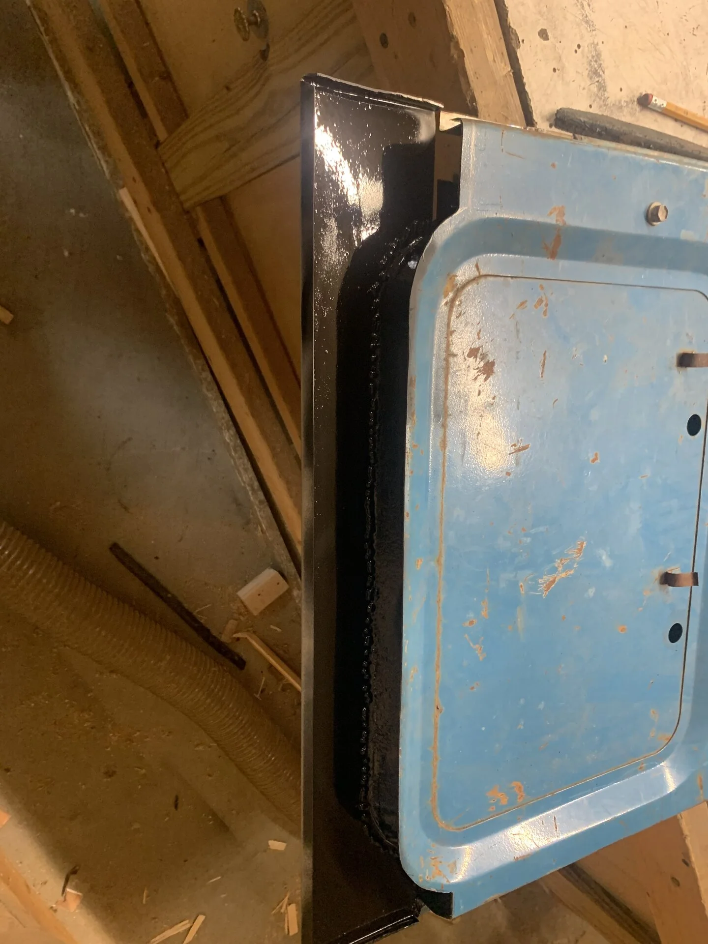

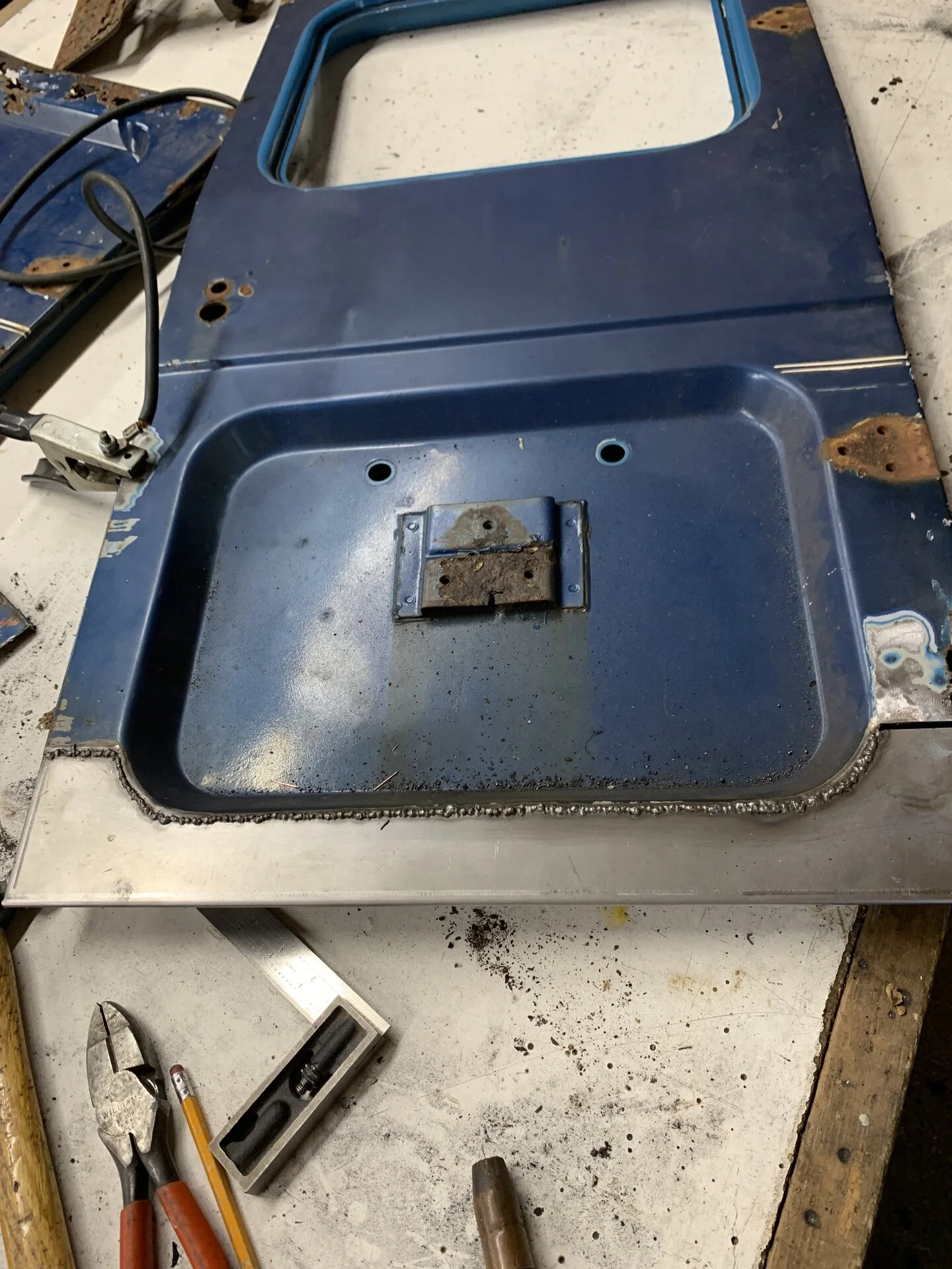

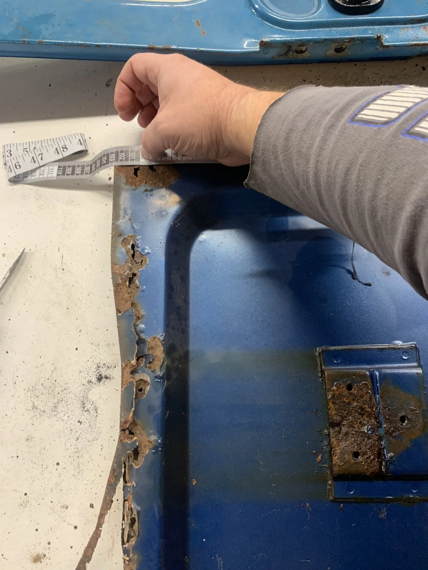

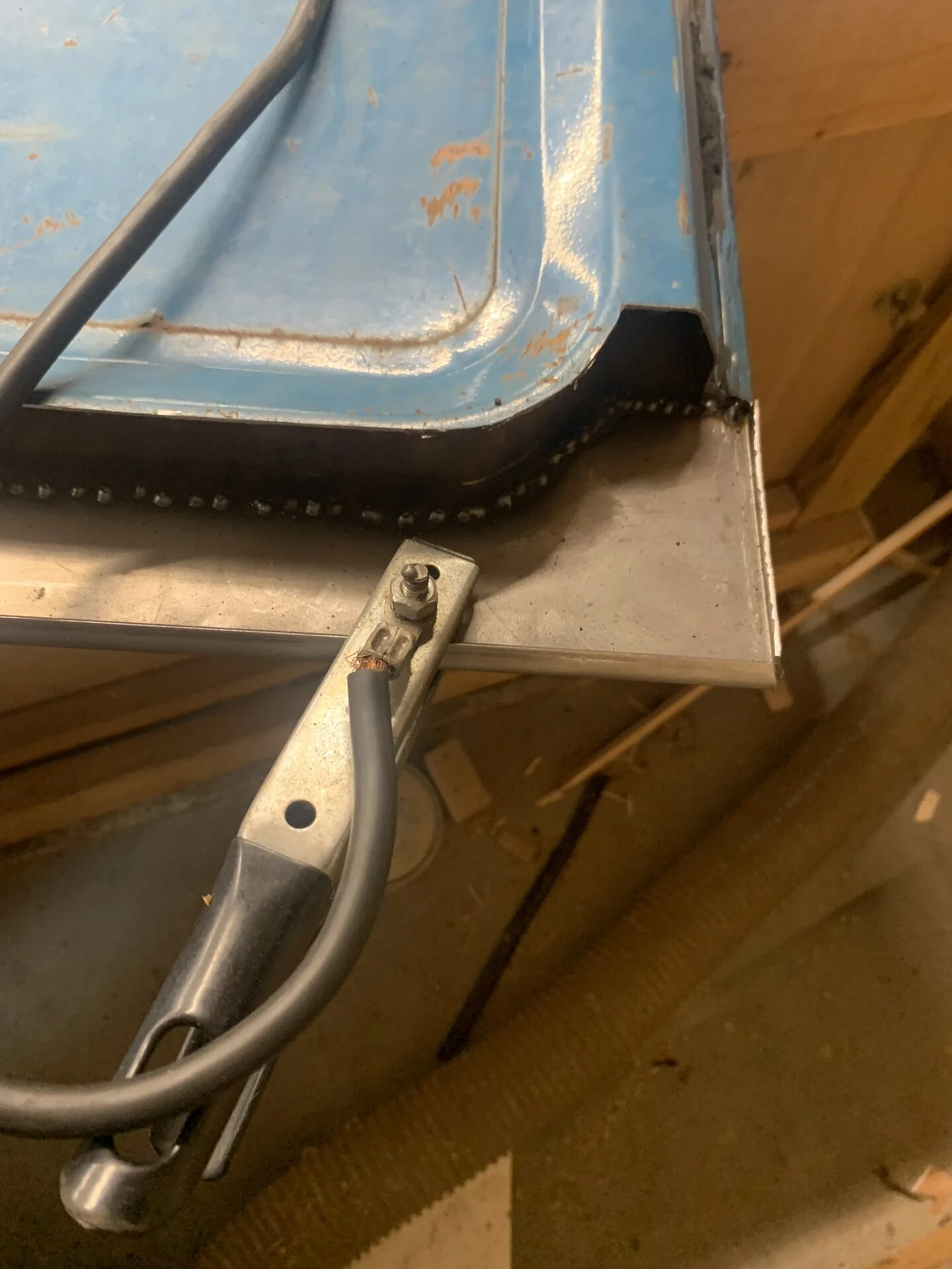

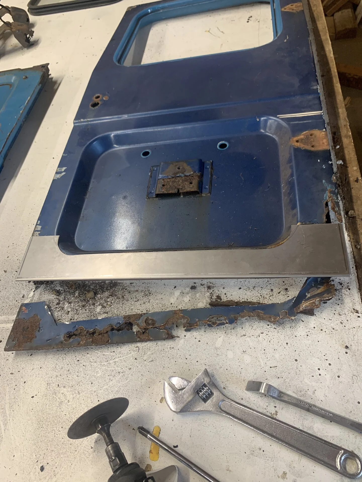

Are those patches RealSteal or did you make them?
The bottom sections are real steel. They fit pretty good so far, granted this is the first door of four that i have patches for. I will continue to give my opinion and thoughts on these panels moving forward. The sections about the standard real steel patch in my own making.

I have RS door patches for my front doors (have only done the DS) and they fit pretty well. I’ll need to do the ambi doors eventually and figured it was a given that I’d get RS for those as well.

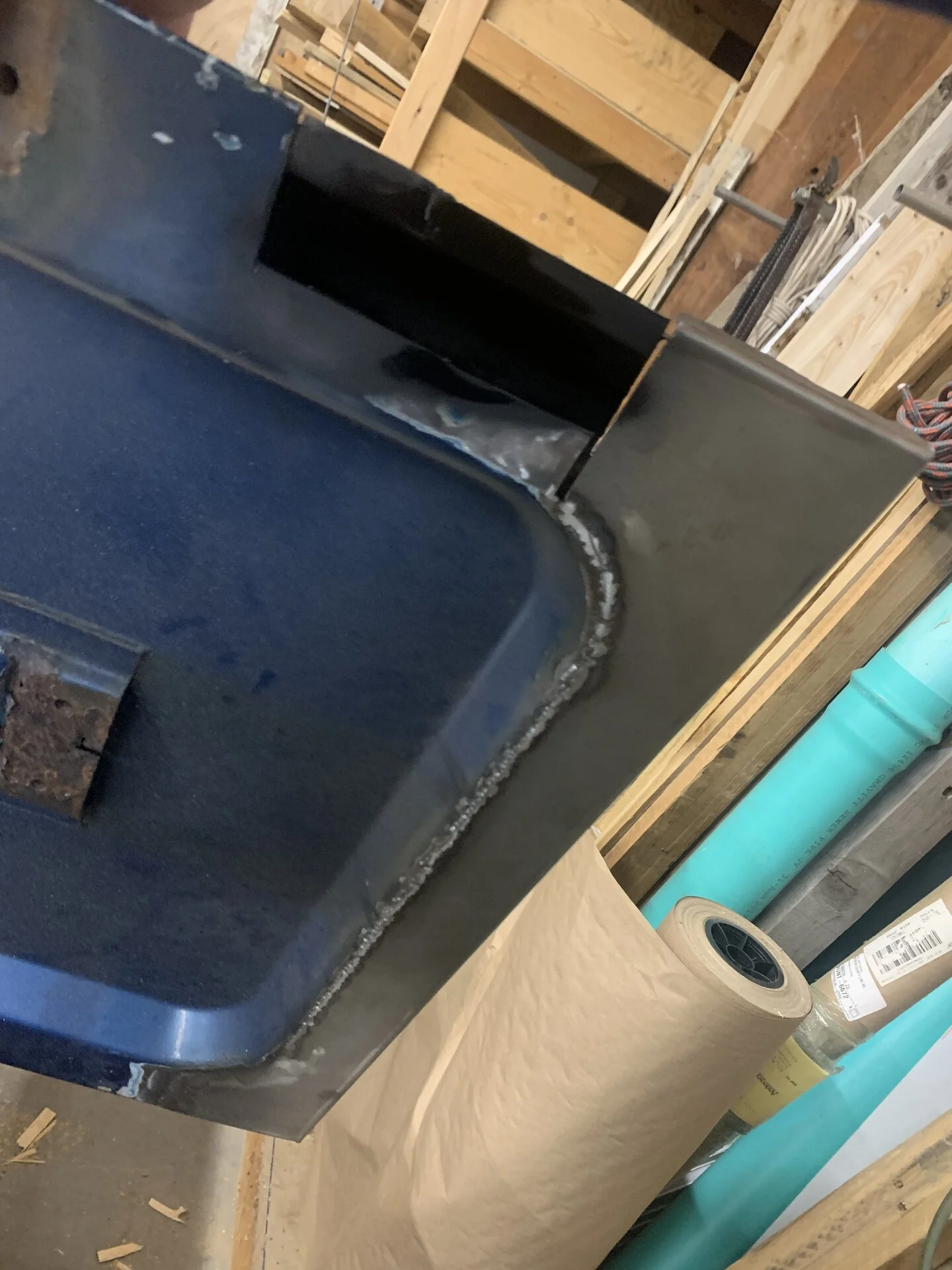

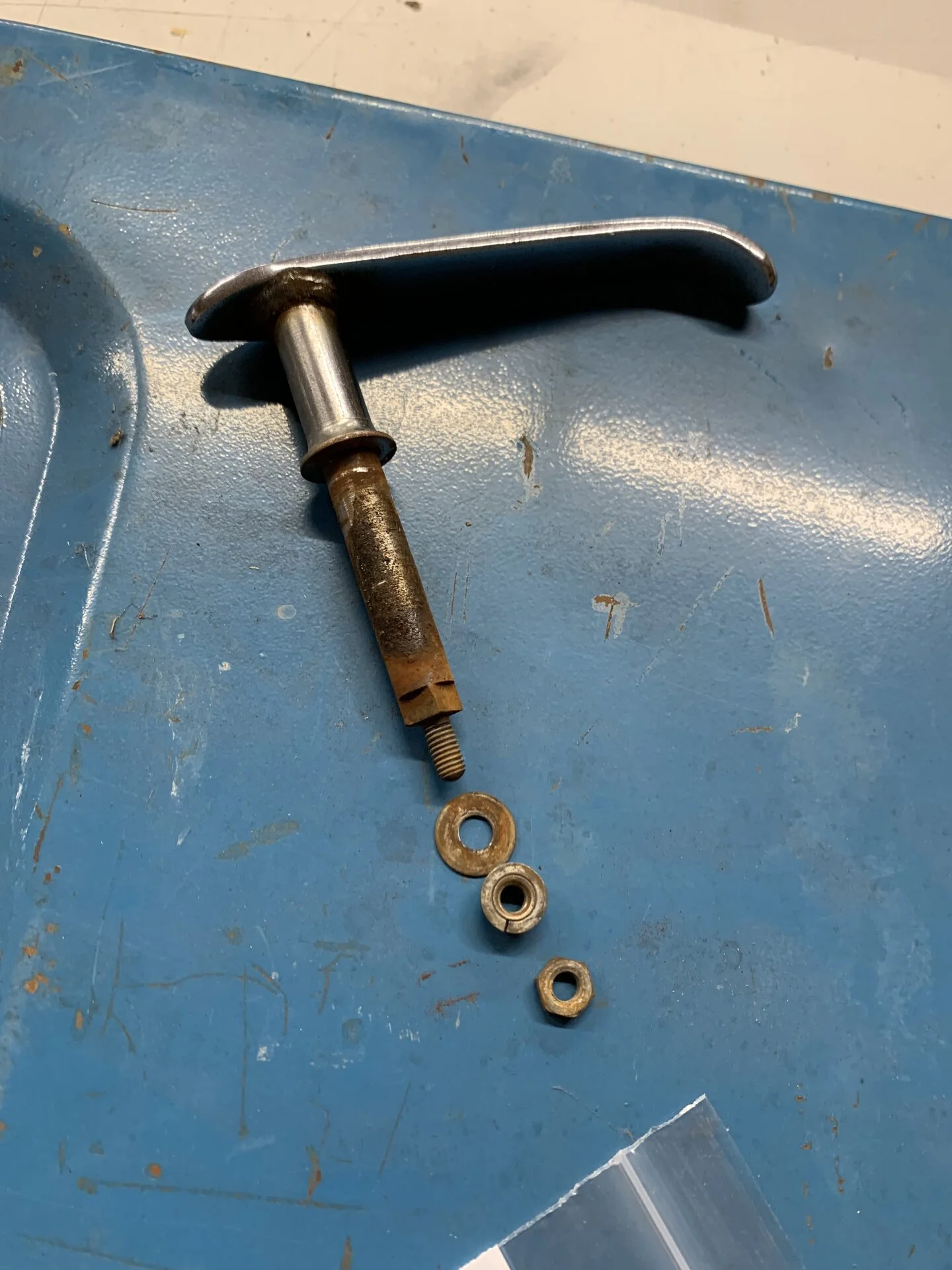

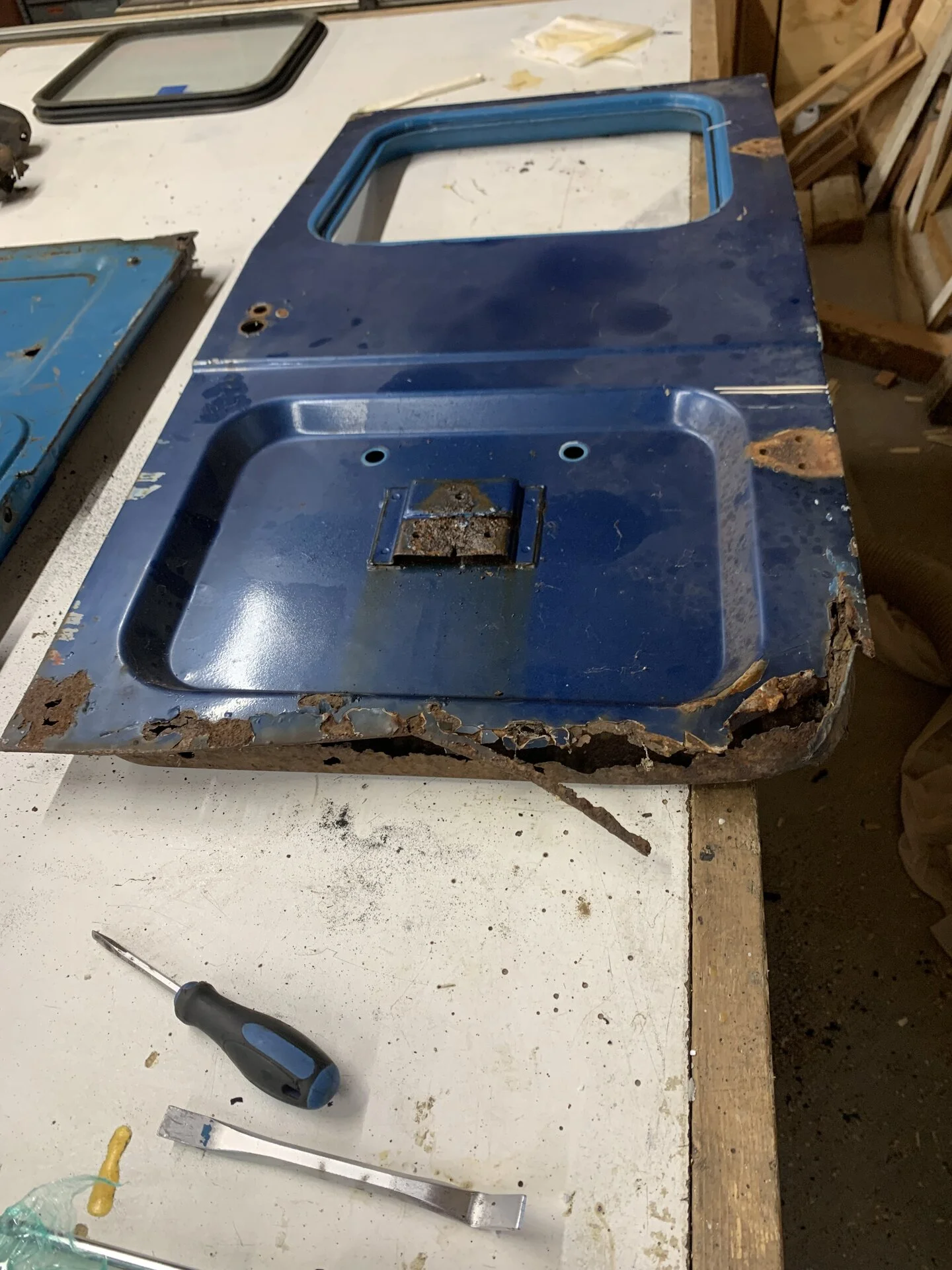

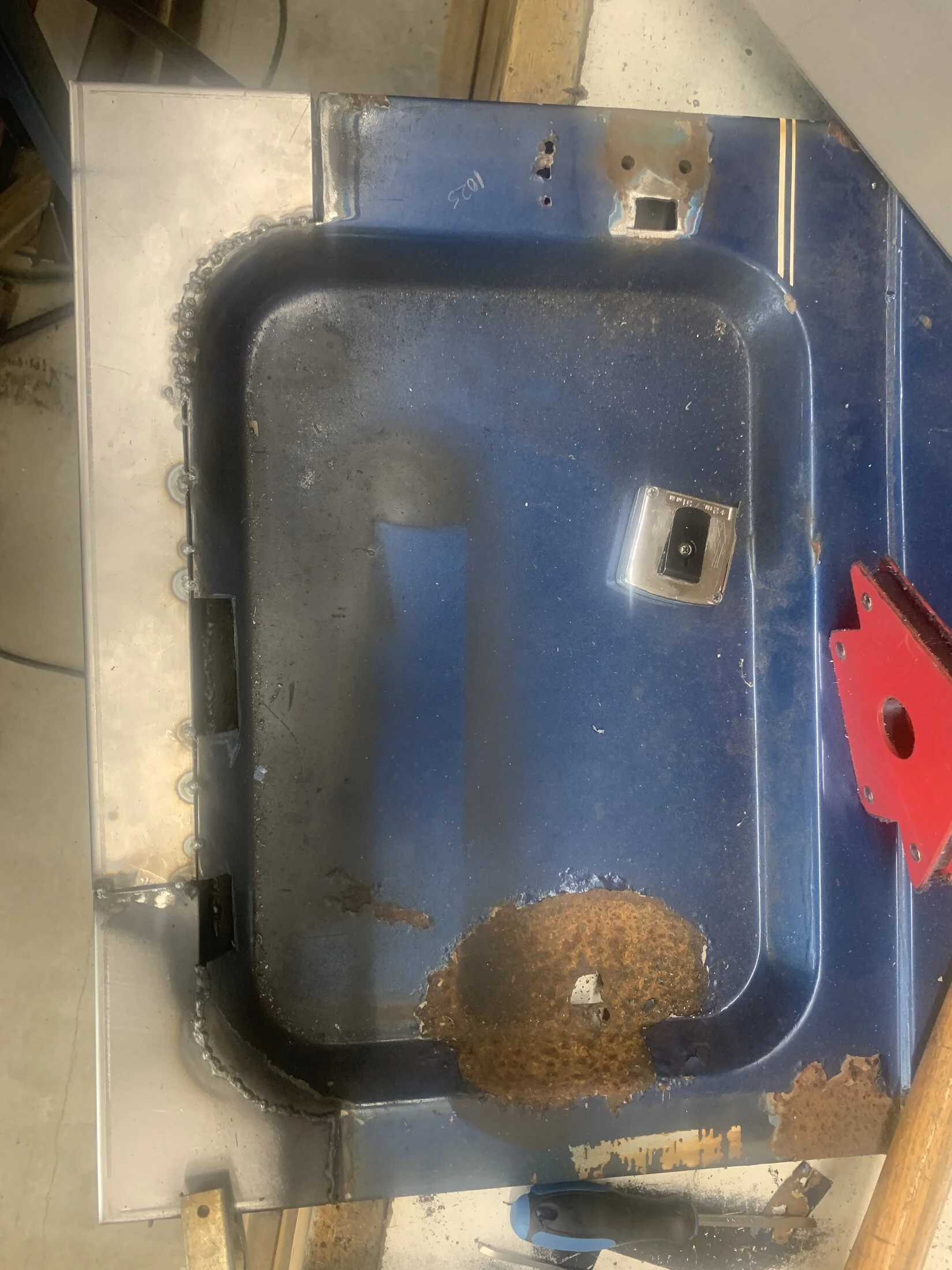

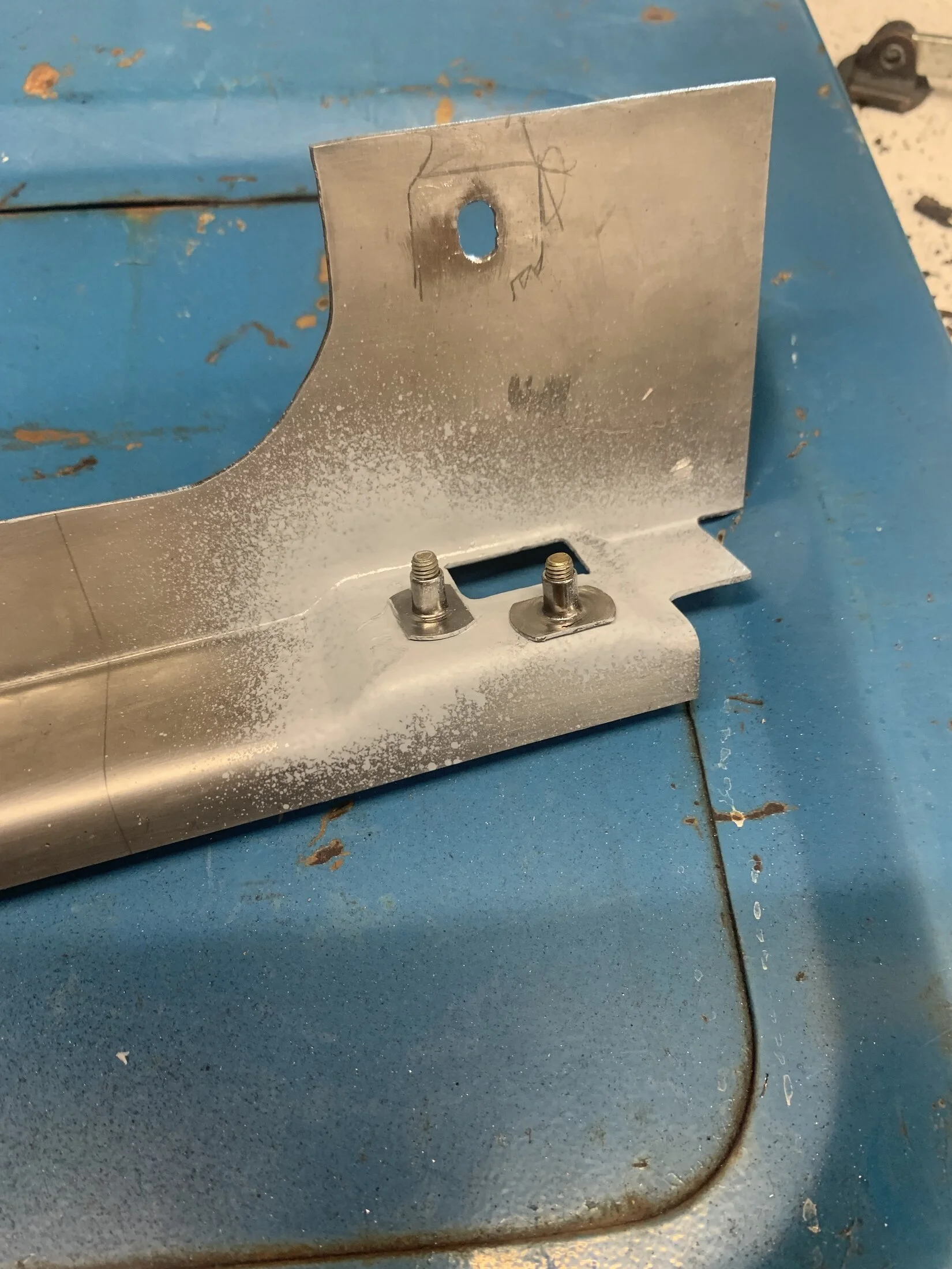

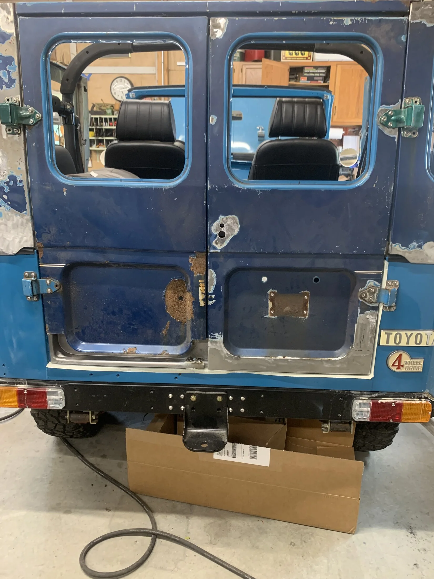

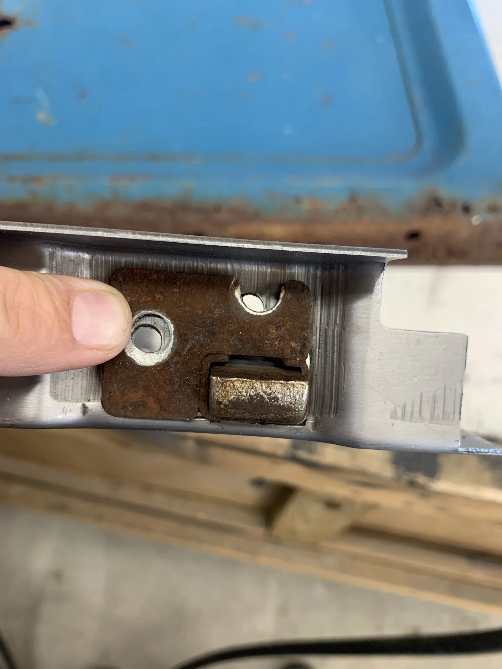

Lots of stuff here to add. The hole location and weldnut size did not match my 77’s drivers side latch on bottom patch panel. Ordered some weld nuts from Mcmaster cart. The hole to secure the inner part of the latch had to be added to. Also had to cut out one of the hinge bolt holes cause it was stripped out. noticed that there is two layers of metal and a weld nut. This door is garbage but gonna see it thru. Like said before this is not a concourse restoration it’s more of a rusteration. Must people would have parted this thing and not thought twice.
