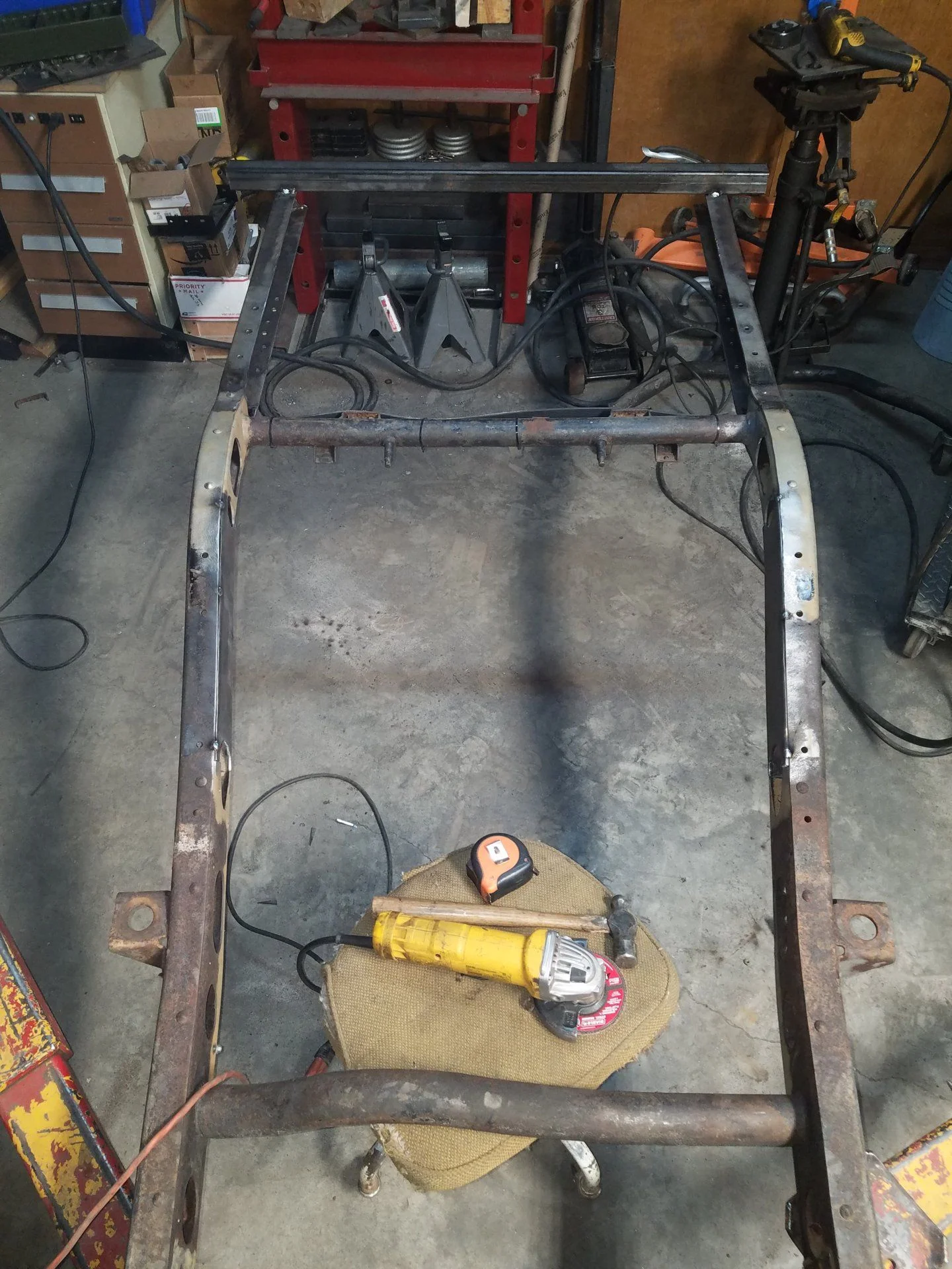

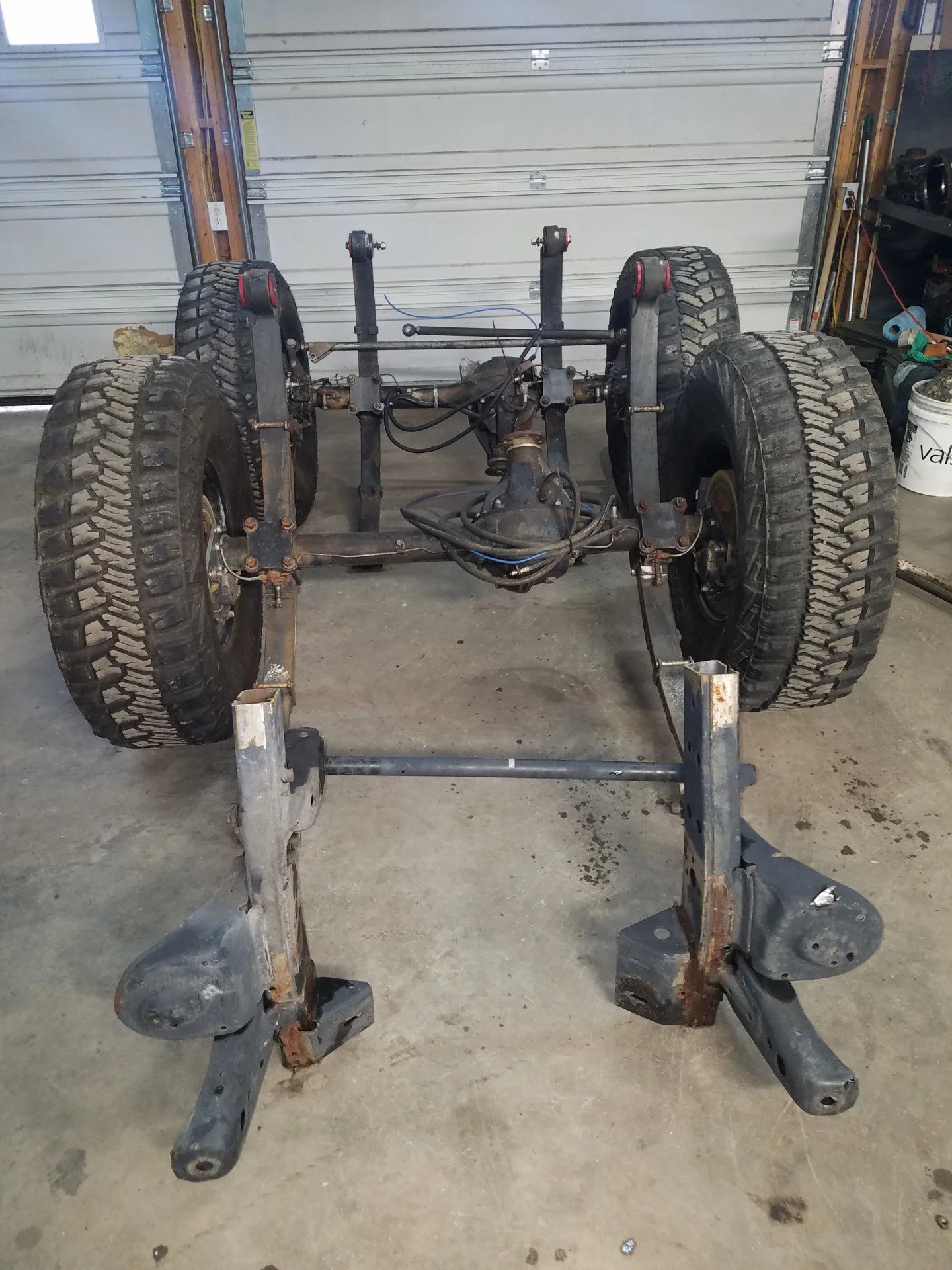

Removed the axles, springs, and spring brackets tonight. I started cutting the 80 suspension frame brackets off too. The cutting and grinding continues.

Things have slowed down a little. I am still waiting for some flap discs to finish removing welds on the frame and prep suspension brackets.

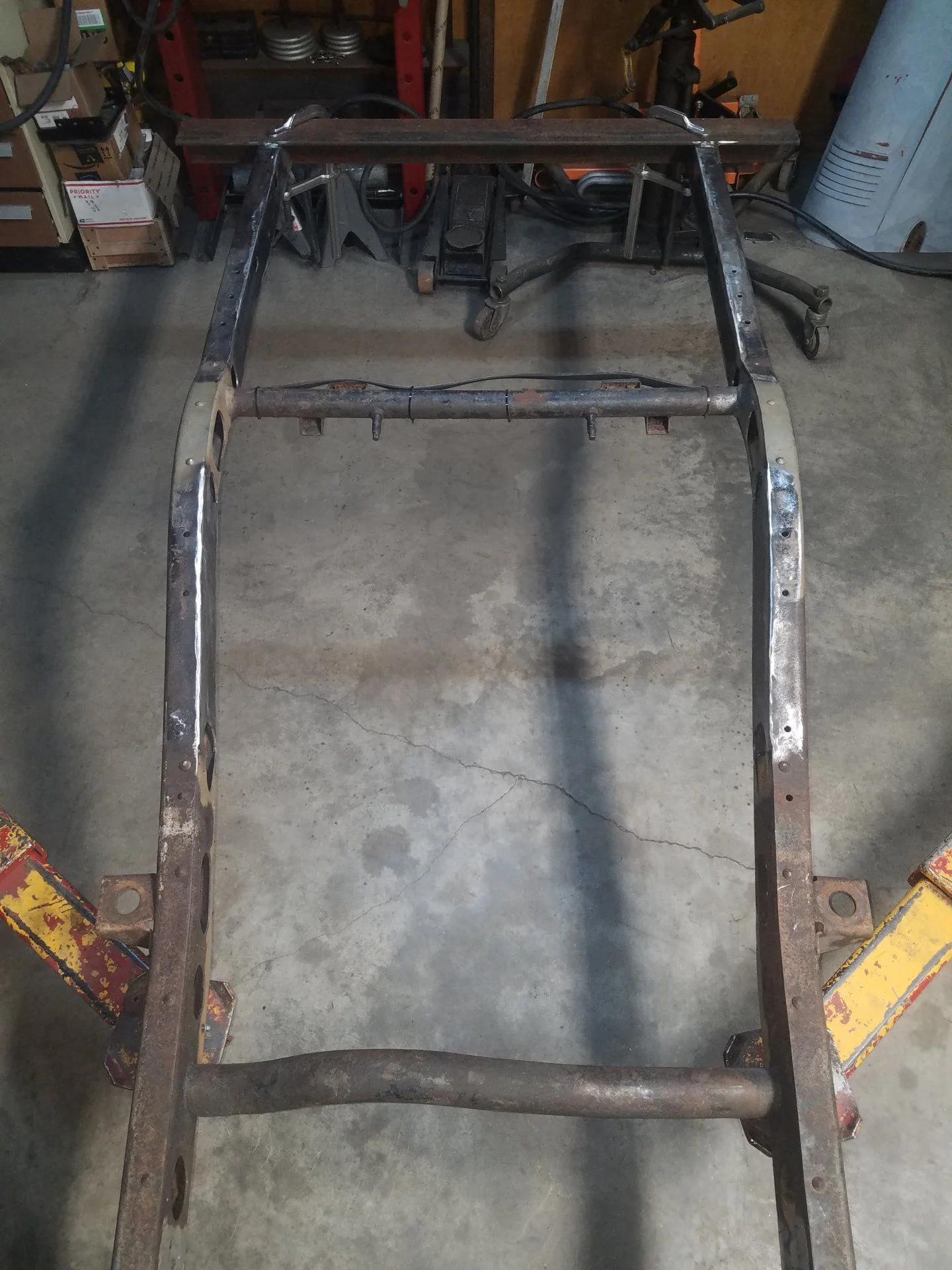

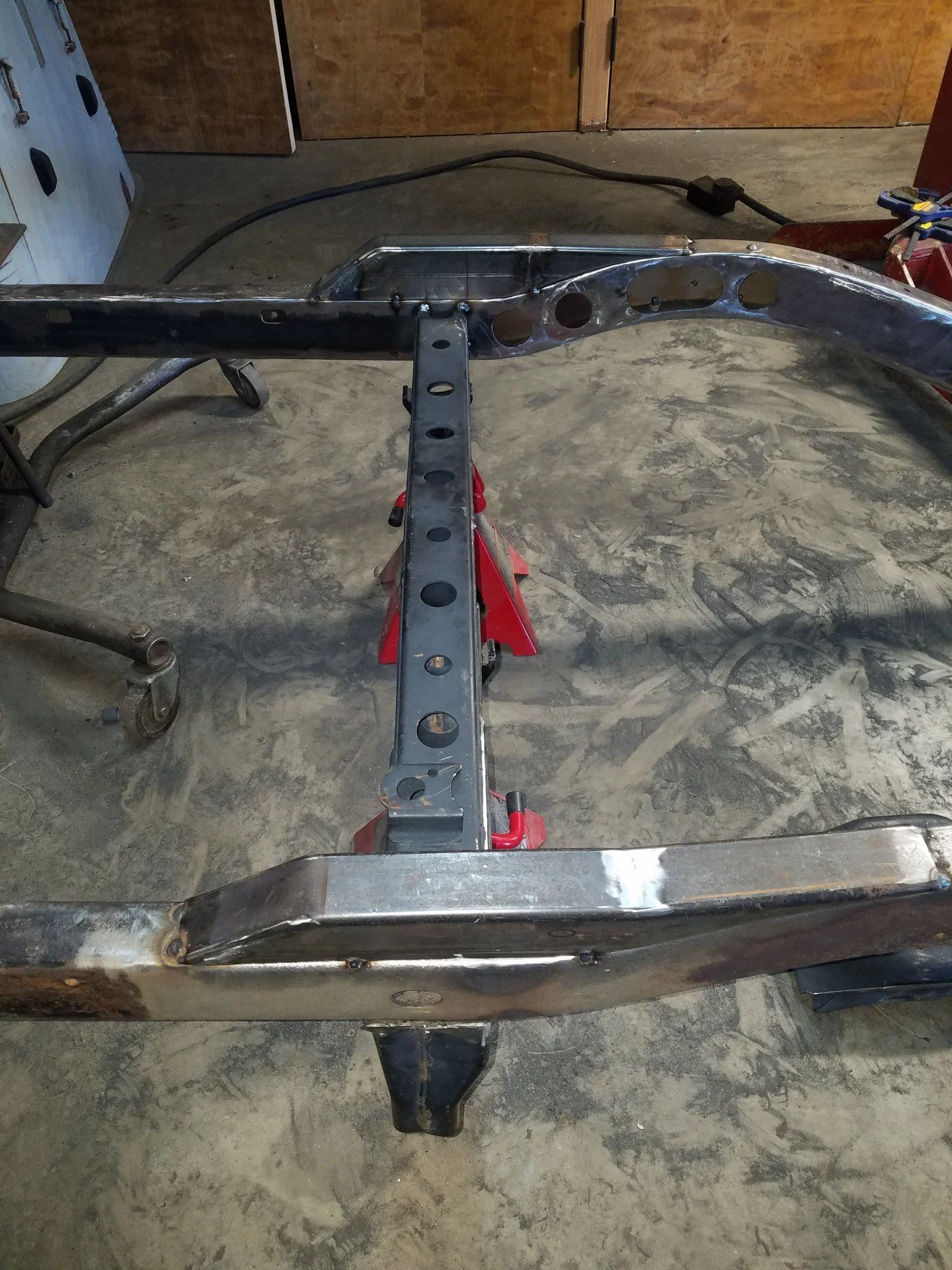

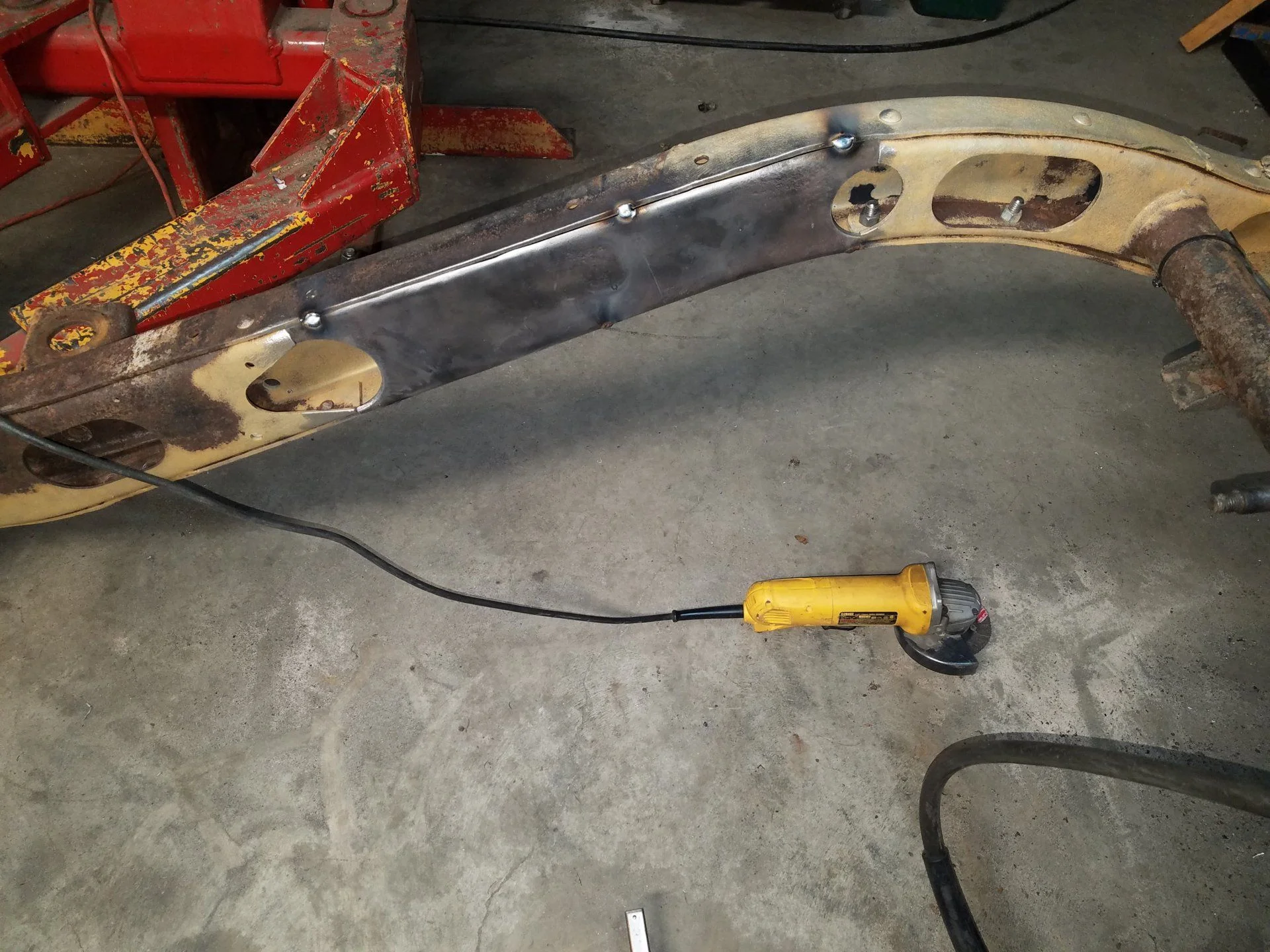

I did make some plates to box part of the rear frame. I used a hole saw to cut halve circles to provide some stock looking transition between the inner frame and the plate.

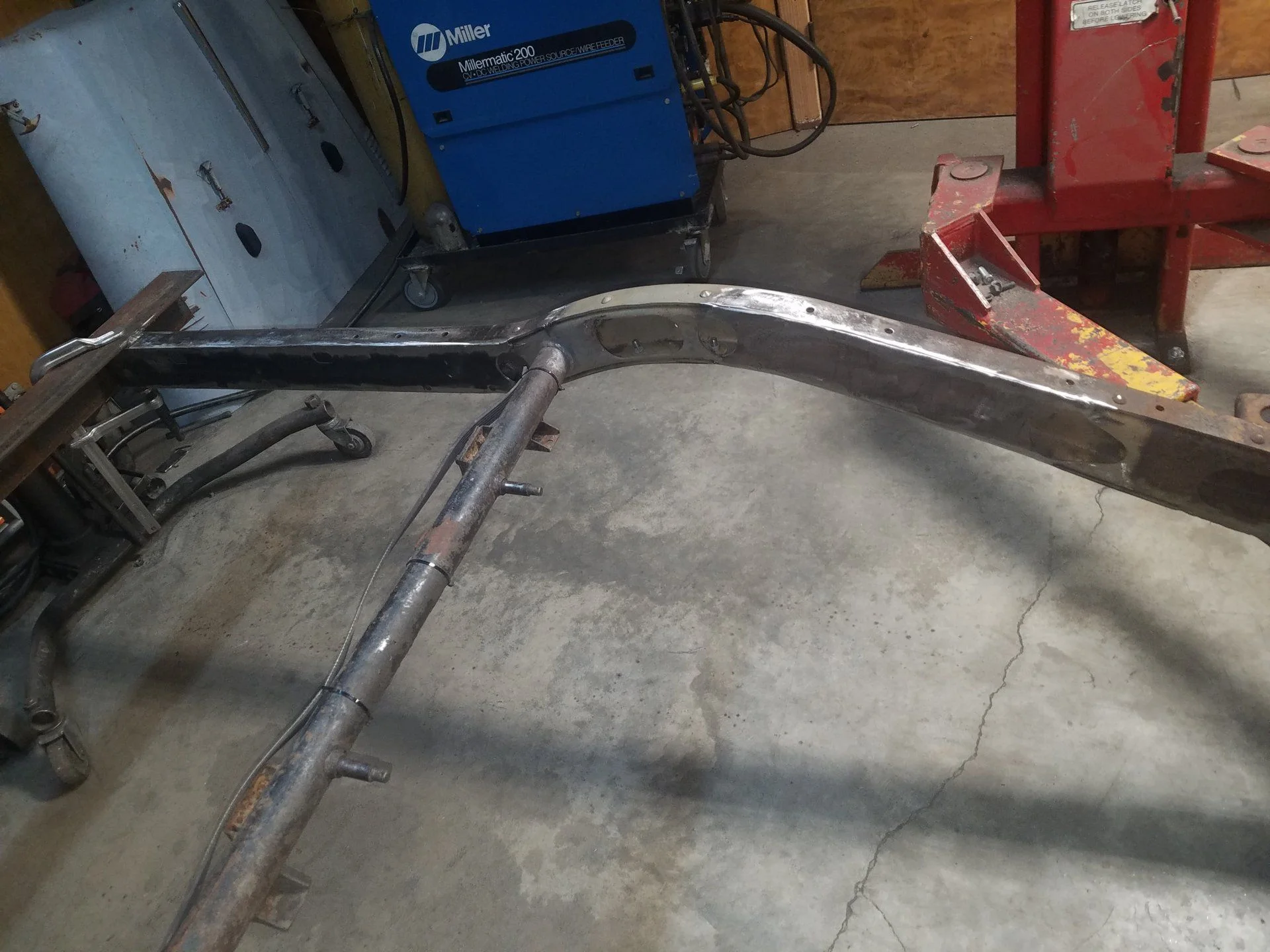

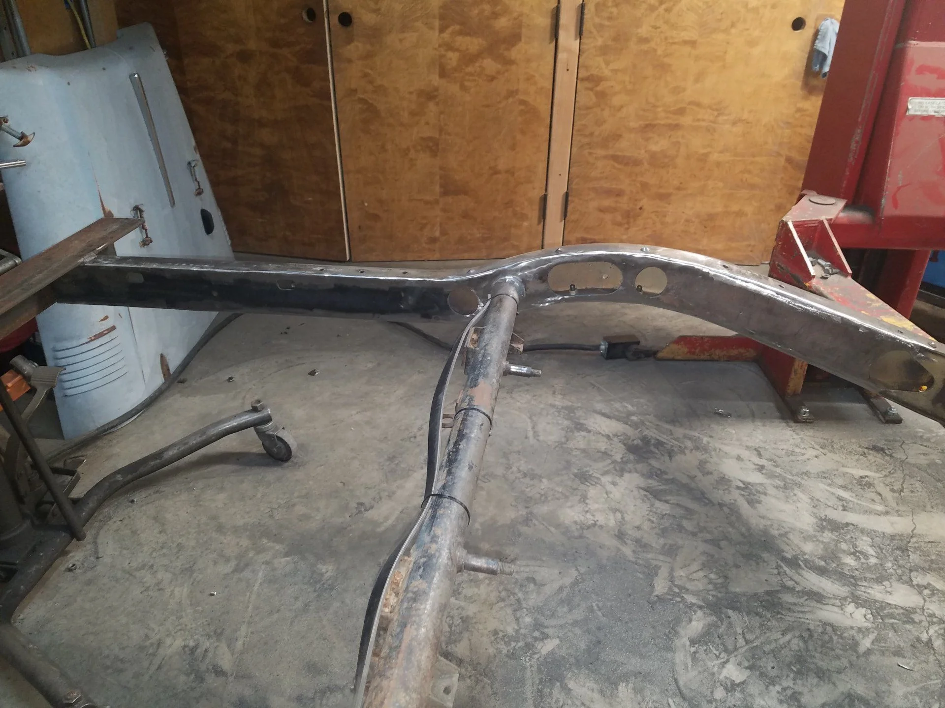

I plan to move the rear axle back about 7 inches. This places it right under the shock mount tube. l will remove it when I get to that part. The problem is the 45 frame continually widens as it goes back, the 37s will hit the frame if moved back 7 inches.

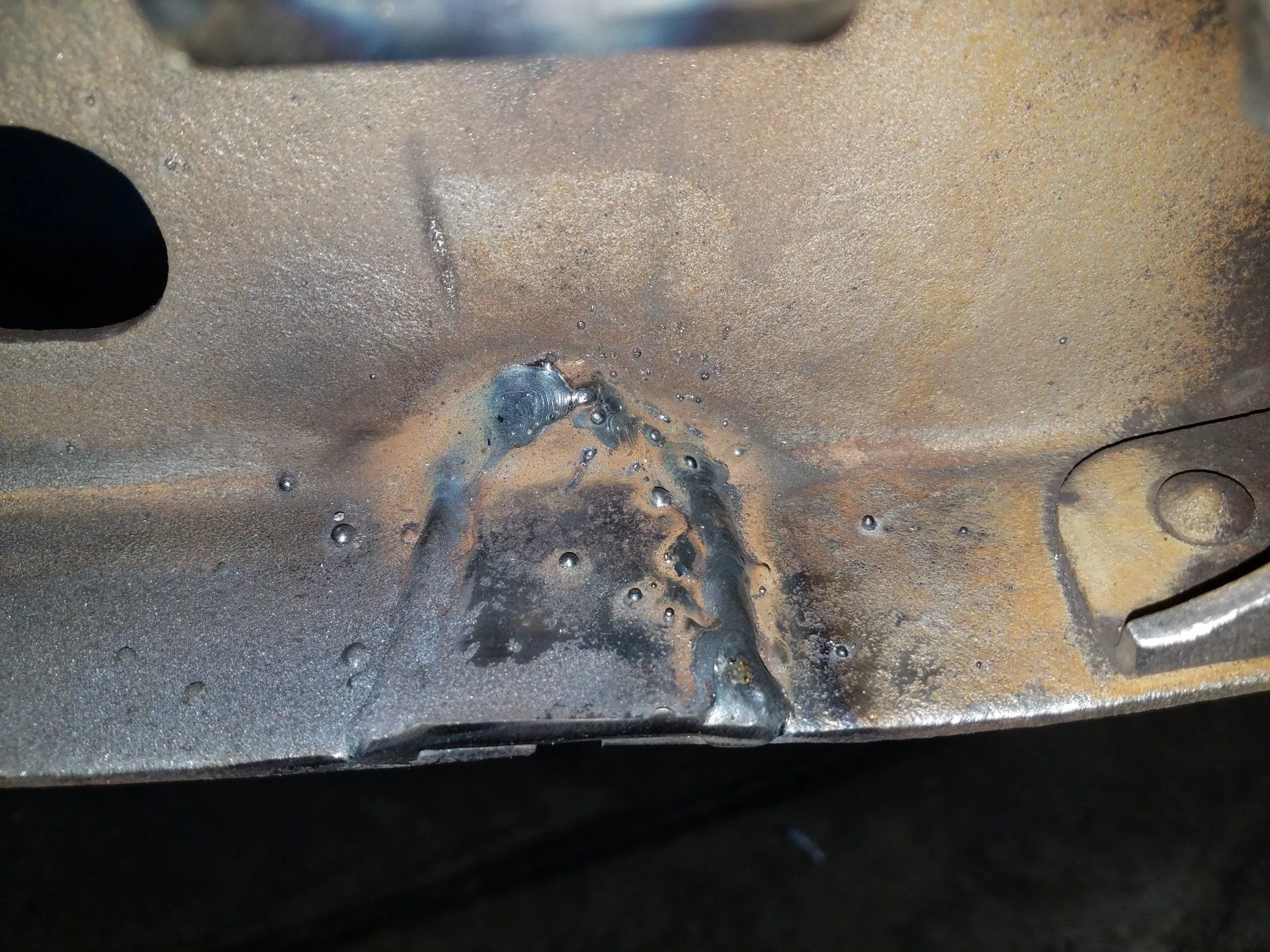

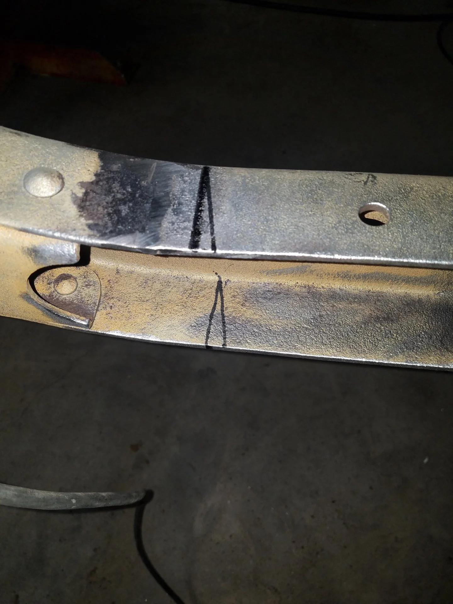

I decided to cut a tiny wedge out of the horizontal sections of the frame rail just after the shock mount tube. I then pulled the two ends in so they went strait back rather than angle out. It worked well and I added some small plates to span the widges I cut.
There should be room for the 37s now.

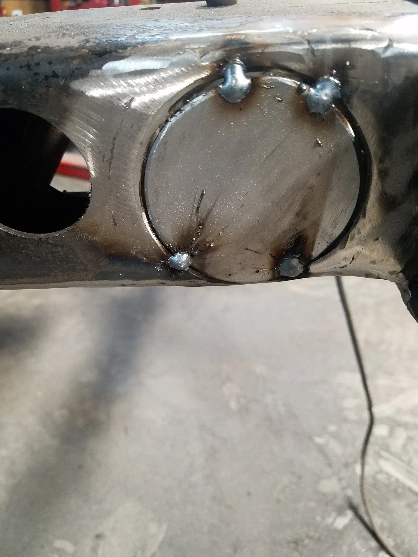

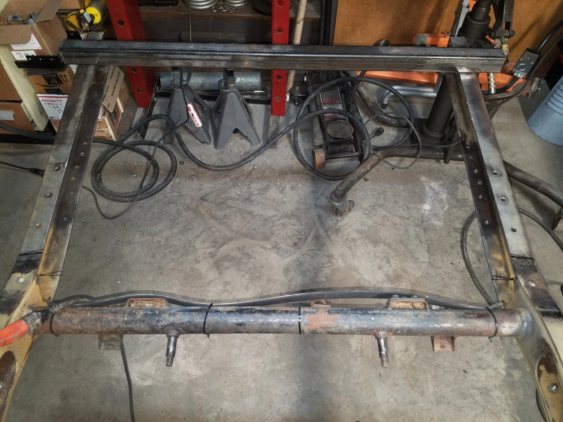

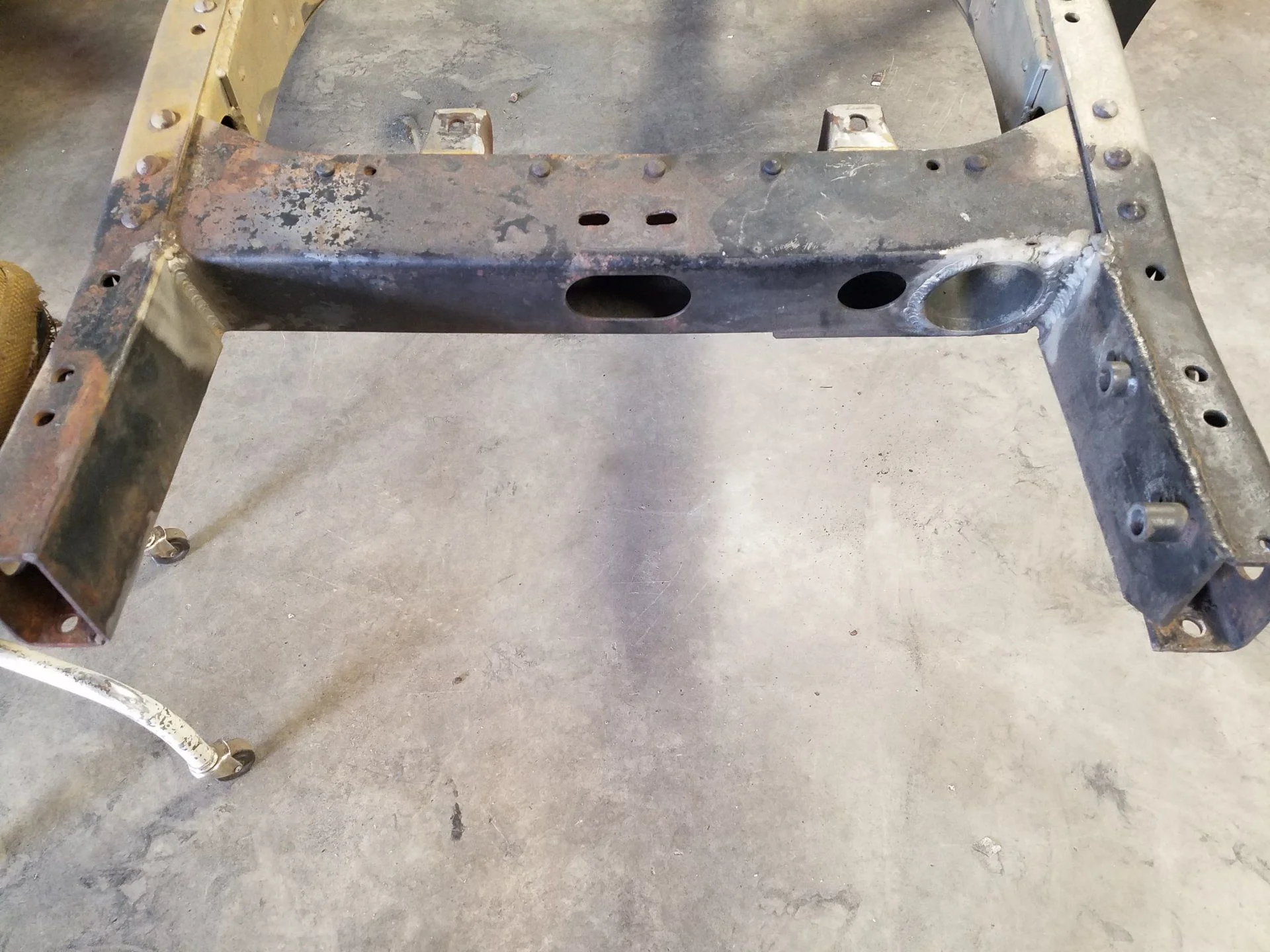

I am looking at the front crossmember which has been modified by a PO to fit a gm style power steering box. I am going with a 80 PS box. Trying to return it to stock looking would be a tough.
I am considering cleaning up the pass through and using it to run the winch cables through. I could also just clean it up some and leave it alone. It bothers me though since it be so visible.
Maybe the PS cooler lines could run through.
Thoughts? How do I make good use of this? I don't really want to cut the crossmember out and replace it, not off the table though.

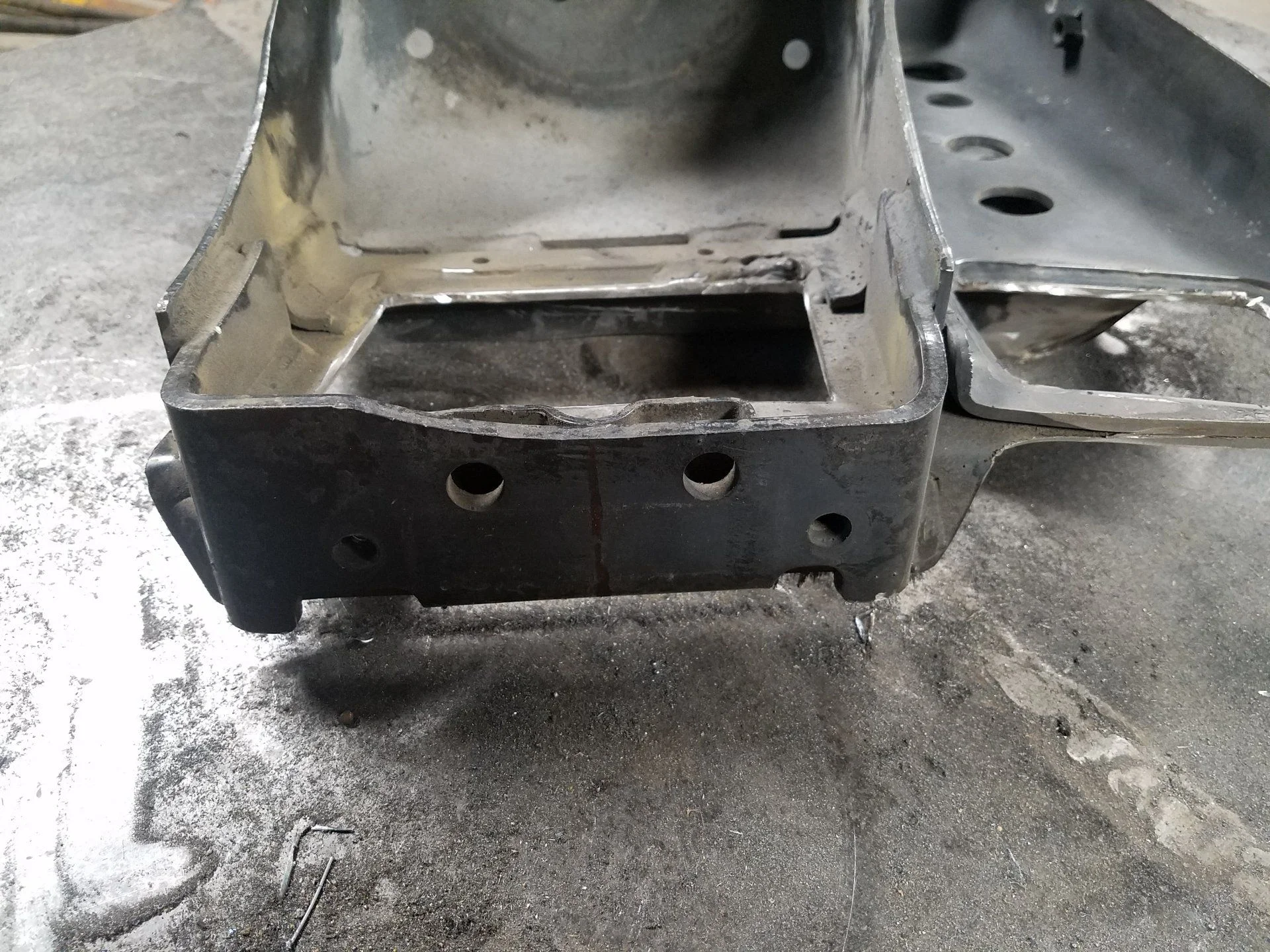

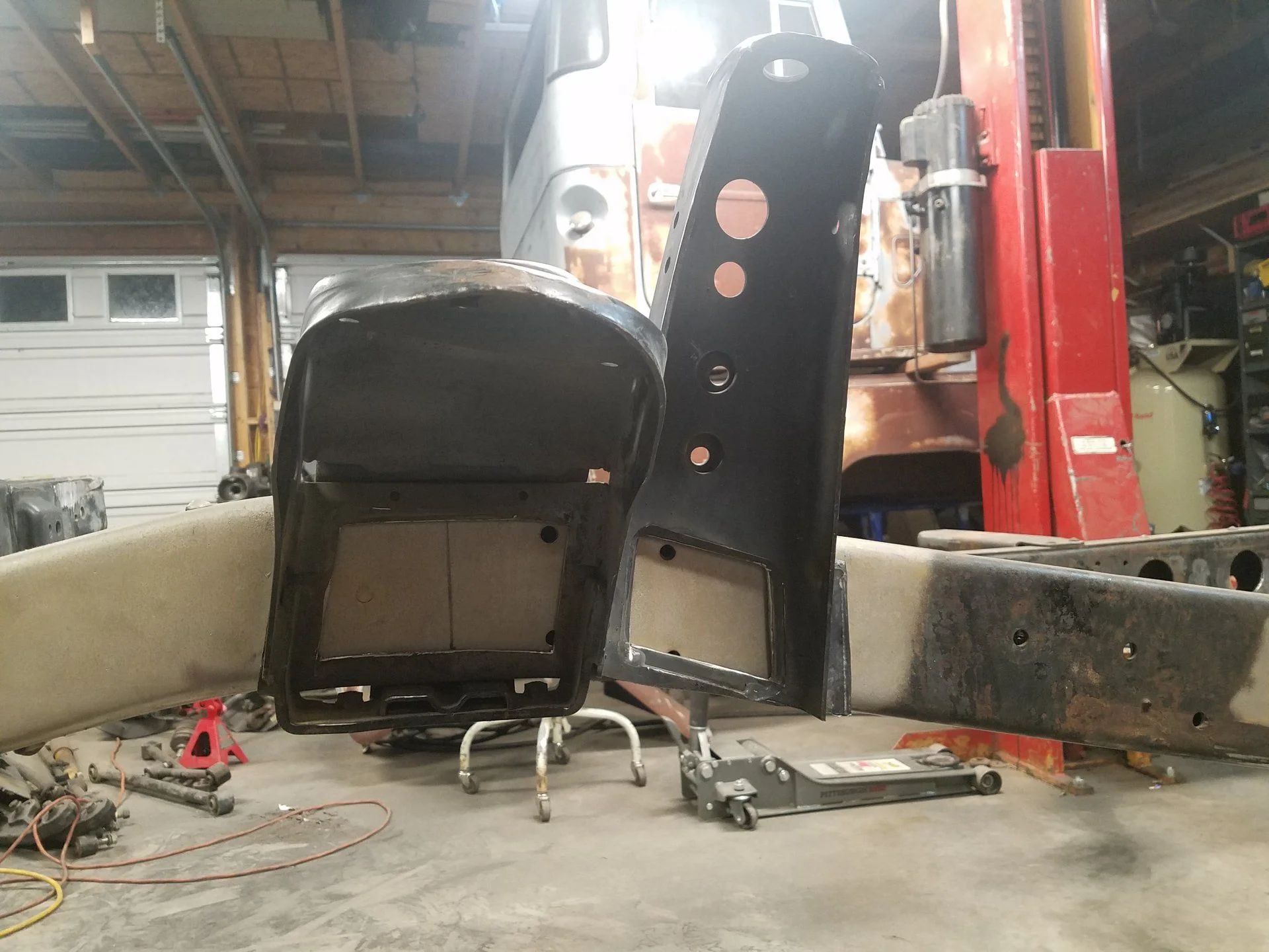

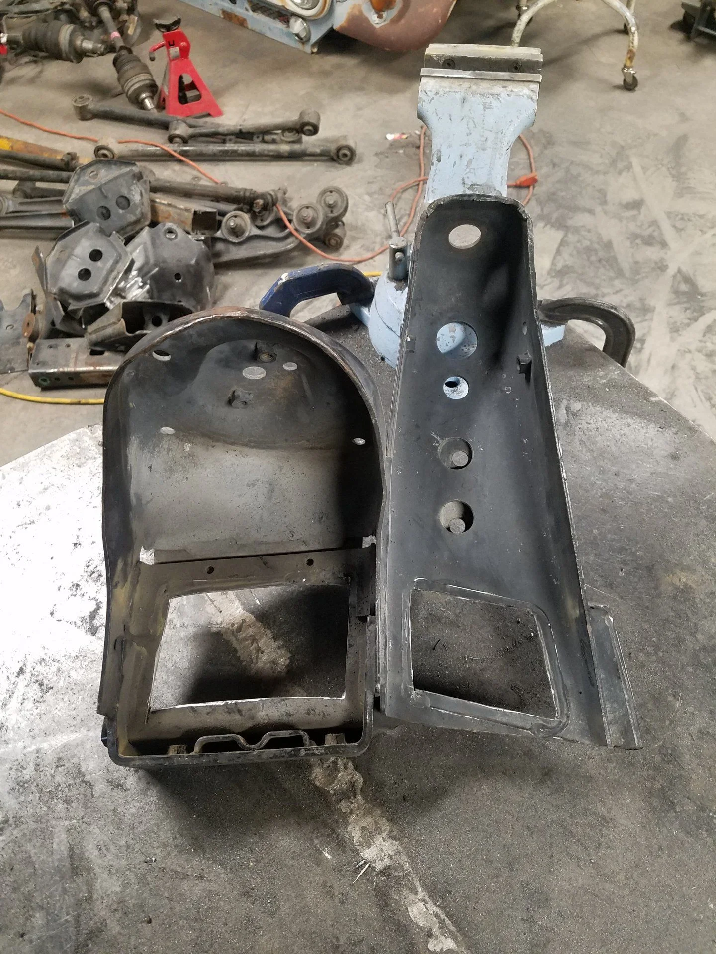

I cut plates out of the 80 series frame that donated the suspension brackets to box the rear frame section.
Then cut some more plates off that were in the way of where the mounting for the steering box.
If you're only concerned with aesthetics weld a circular shaped piece of plate in the hole on the front side. Once it's painted it will barely be noticeable. No harm in leaving the welded in tube or need to return to stock.
This is what I am learning torwards at the moment.
I'm not familiar with the 80s. Isn't the Saginaw hole on the 45 frame where the center arm needs to bolt?
It is where the center arm would bolt in but I don't need the center arm to run the 80 box. No worries there.
Made a little more peogress, I went back and welded the shock support tube frame plate, so now the entire rear frame is box welded.

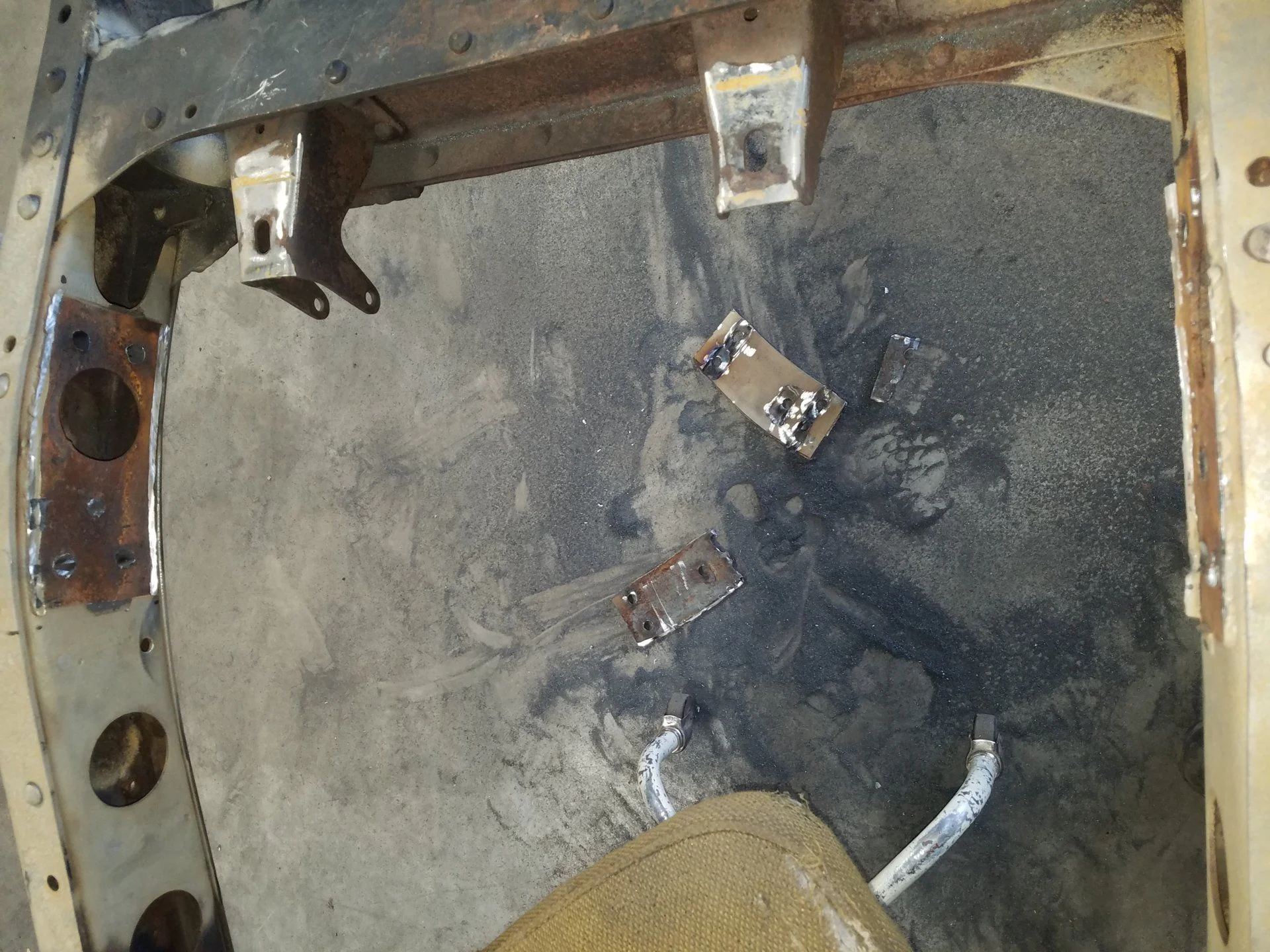

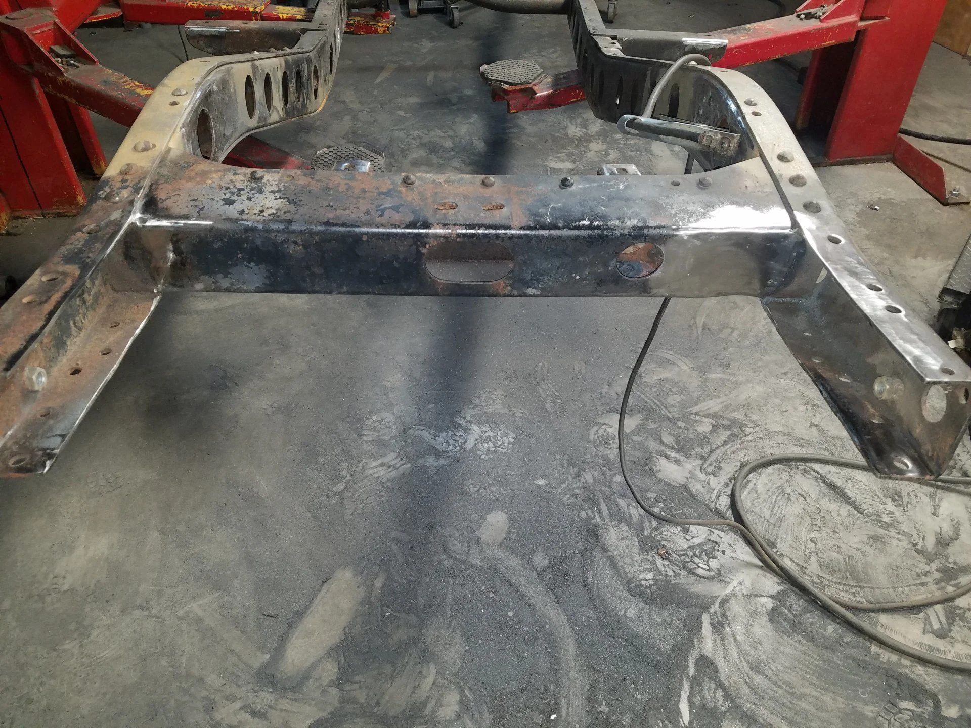

I started cleaning up the front crossmember and frame horns. No pictures of that yet.
I finished cleaning up the front crossmember and removed the frame horn plates too. I went with what @samc2447 suggested and cut a circle plate to fill the hole left from the saginaw conversion. Welded it up and feel like it turned out well enough. I am going to go with it.
I will add some new support plates to the inside frame horns but I am going to do it differently than what was there.

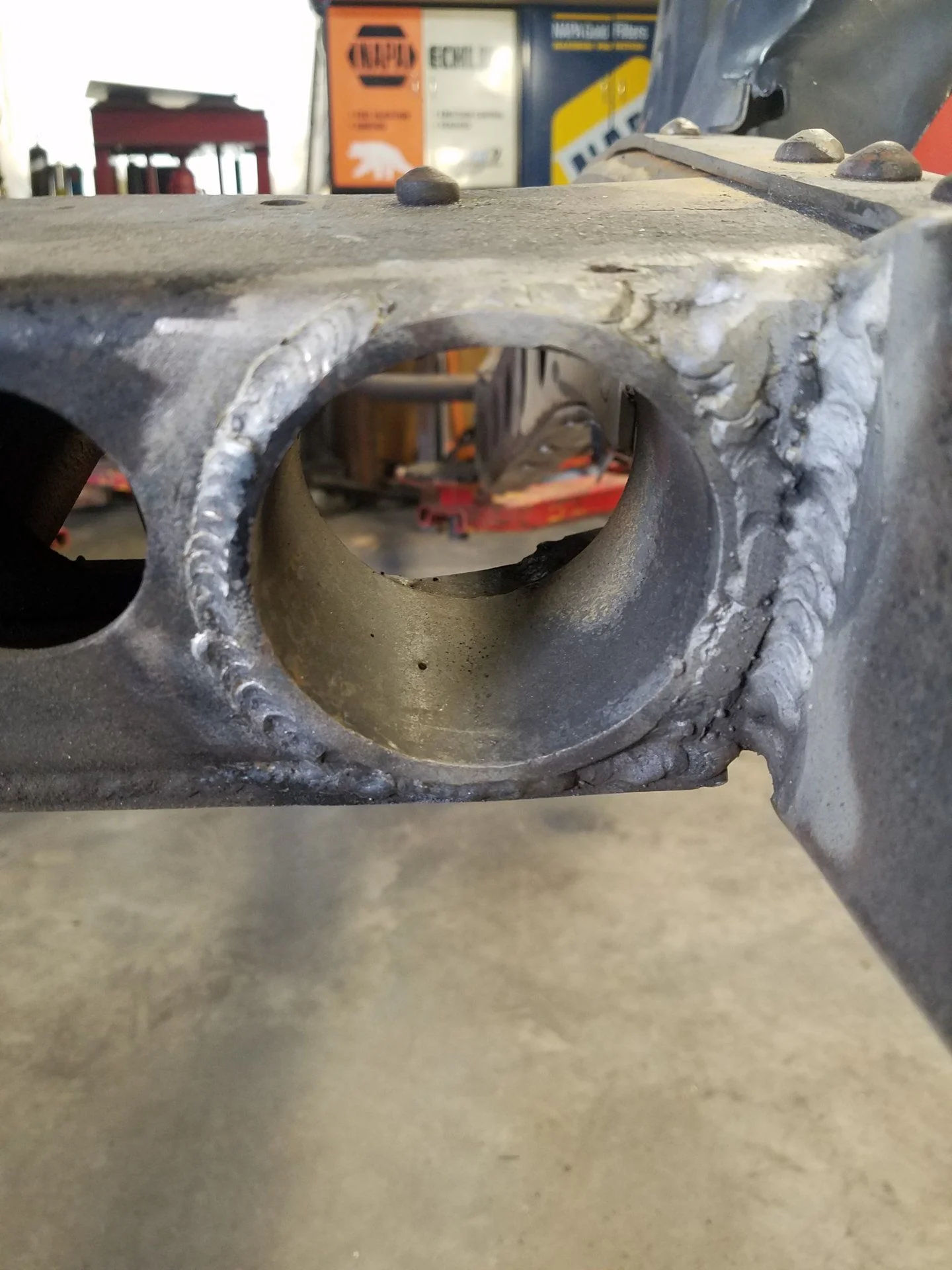

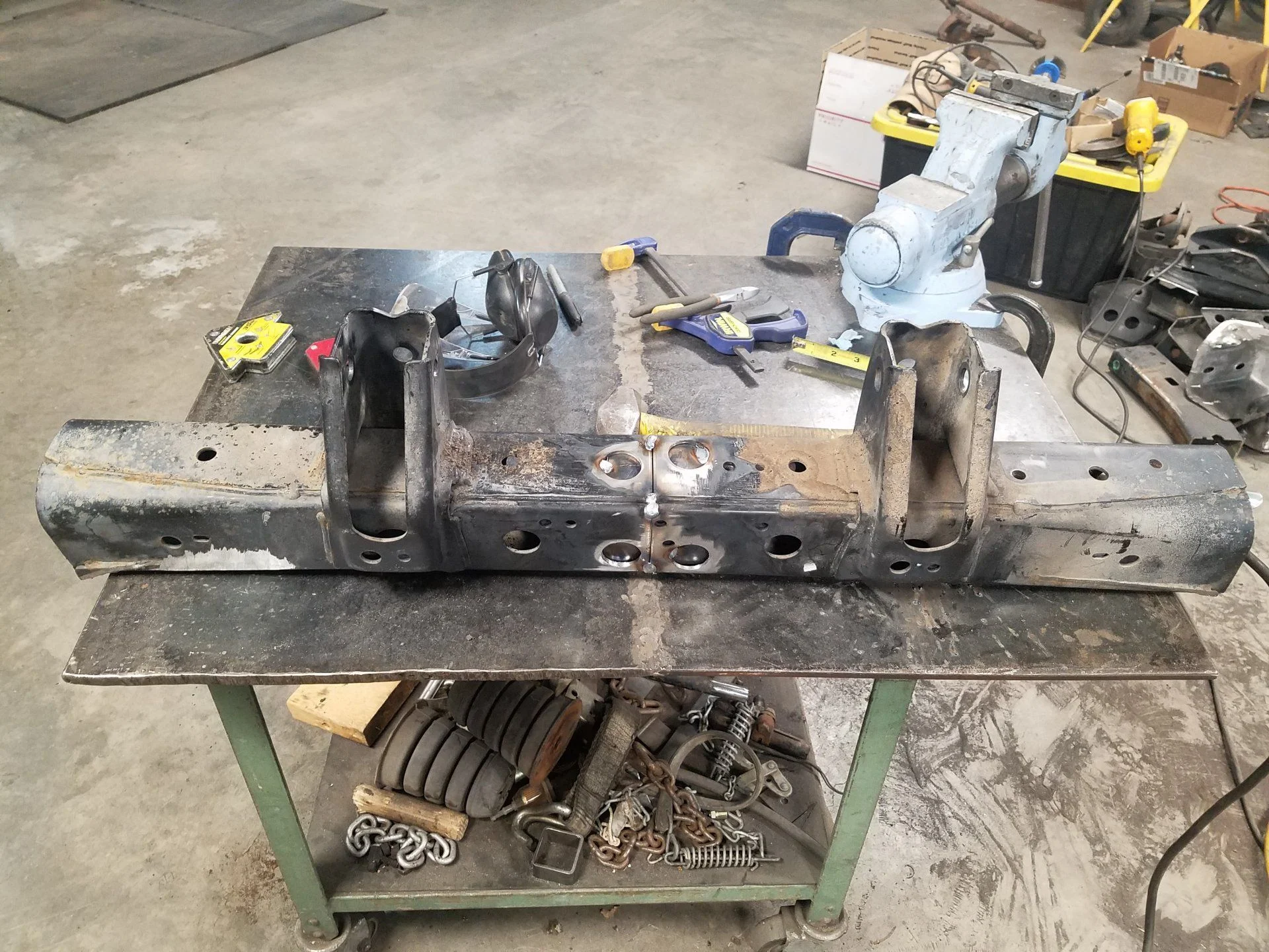

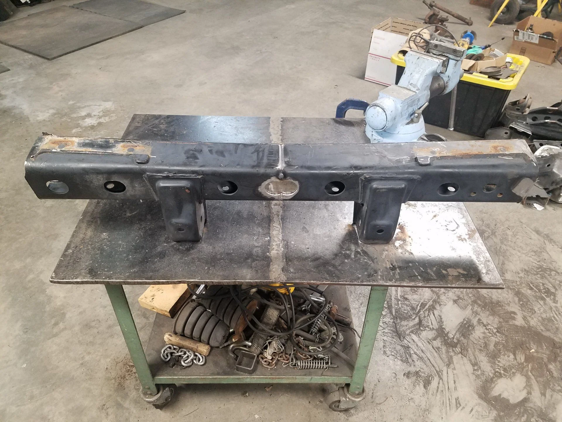

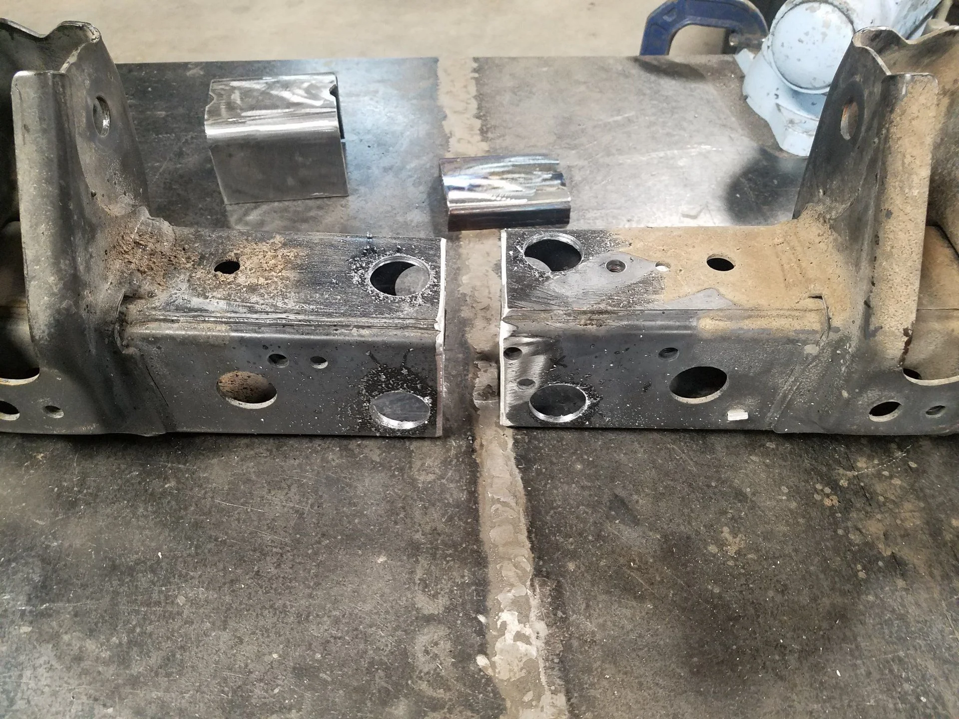

I hope to get a chance to fill my welding gas next week, so figured I would try to use up what I have working on the rear upper control arm crossmember. I needed to narrow it in the center 4 inches to match the axle control arm mounts.

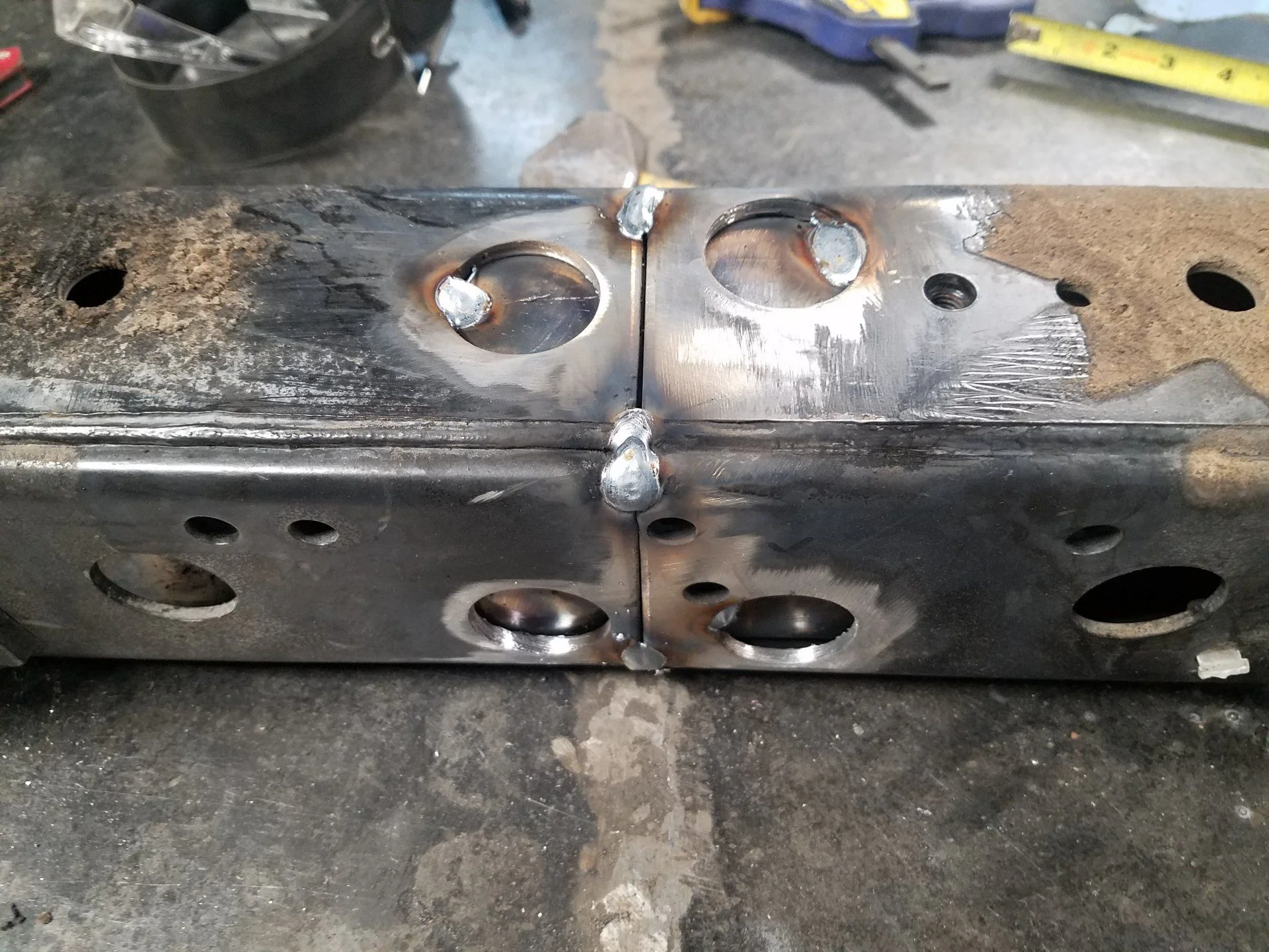

The 4 inch section I cut out was repurposed as a sleeve inside the crossmember to bridge the cut. I had to narrow it both directions to make it fit inside, it worked out well. I also drilled two more 1 1/4 in holes on each side of the cut, so I could weld more to the sleeve.
I was lucky I got enough good tack welds on it before I ran out of wire. I knew the gas was low but I didn't realize the wire was low. I thought I had another role but is was fluxcore and I don't like using it.
This is as far as I got.
I started playing more with the placement of the front spring and shock mounts. I intentionally left part of the frame attached to the brackets because it wraps over and under the frame at the spring mount. I expect it will provid a little more support to the frame and help align the brackets on each side.
My brackets came from a later 80 as they have the bump stop mounts attached under the spring mount. I left them on again to provide support and I used them to aling the bumpstop centers on the frame and brackets to get close to the expected stock 45 axle position. The brackets are placed perfectly to allow for the right amout of room to mount the 80 power steering box.

I have been considering welding the front of the frame along the seem for the inner and outer frame. Several of the rivets have been cut or removed on the front half and I think it is needed to maintain strength. I have also been thinking of welding the front crossmember at the frame on the top and bottom. I like the stock look of it though, so I really don't want to remove it. I will be adding the steering support attached to the panhard bracket from the 80 which will add more support to the front of the frame.
