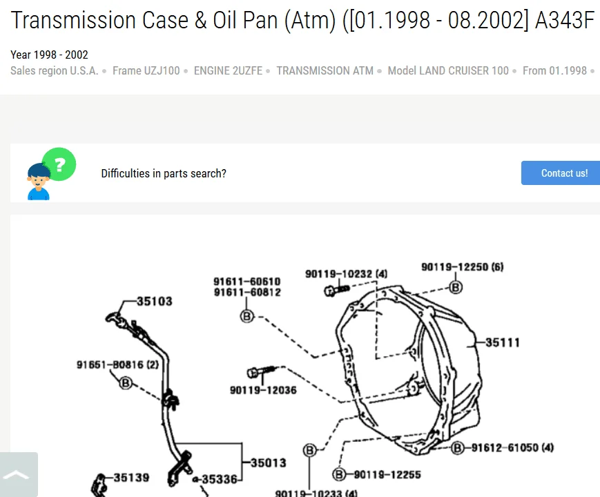

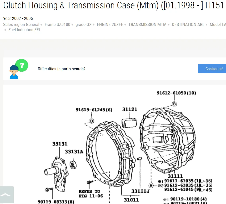

This may be a stupid question, but does the H151f with the stock 2UZ bell-housing really just bolt up to the US domestic 2UZ? I was looking at the parts diagrams from the link you shared, which, to be fair, may not be that accurate just looking at the pictures, but the bell-housing engine side bolt pattern for the two transmissions (A343f v H151f) definitely look significantly different:
Nevermind on the last post, I alleviated my doubts by feeling around underneath my truck. I think they just have the wrong diagram for the year because the >2002 vehicle diagrams have the correct bell housing as well.
I appreciate all of your help. I found a decent lead on an 80 series H151f with a tcase, so I'm going to go that route to save on any adaptability headaches. I'll post a link to the build thread once I get started.
