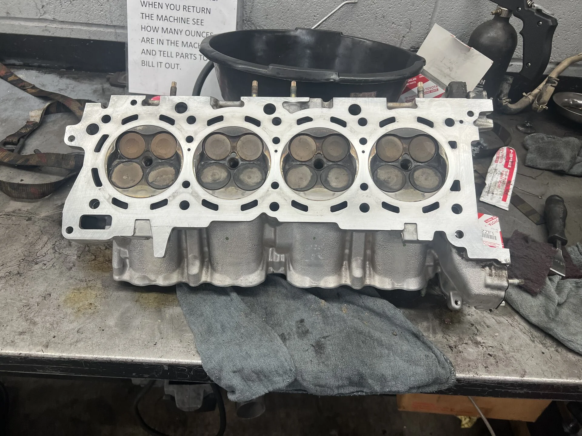

Upon tear down the old head gasket did show a small passage where the gasket deteriorated and allowed coolant to slip by, nothing else abnormal that that. Total timeline from drop off to pickup was 6 weeks as it took 3 weeks for the heads to be reconditioned at a nearby machine shop. The heads were reconditioned with valves and seat grinding and the heads were milled flat. While everything was tore apart I opted to purchase and install a new Radiator, Water Pump, Starter, Belts, Intake Cam Phaser Gears and Exhaust Cam Phaser gears. The Cam phaser gear replacements came at the recommendation of the Toyota Master Tech. Timing Chains and tensioners were inspected, the master tech did not seem concerned with reusing them.

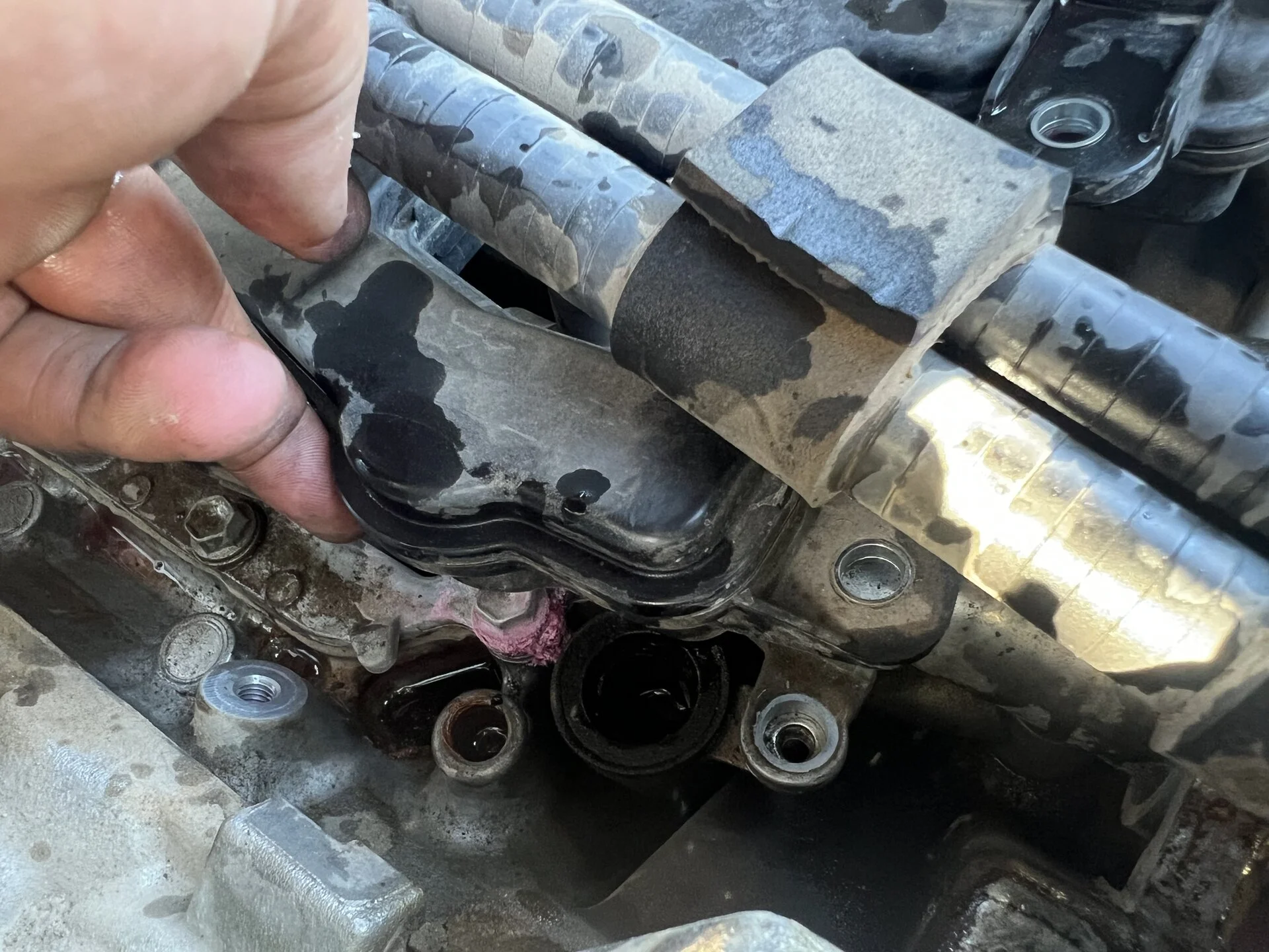

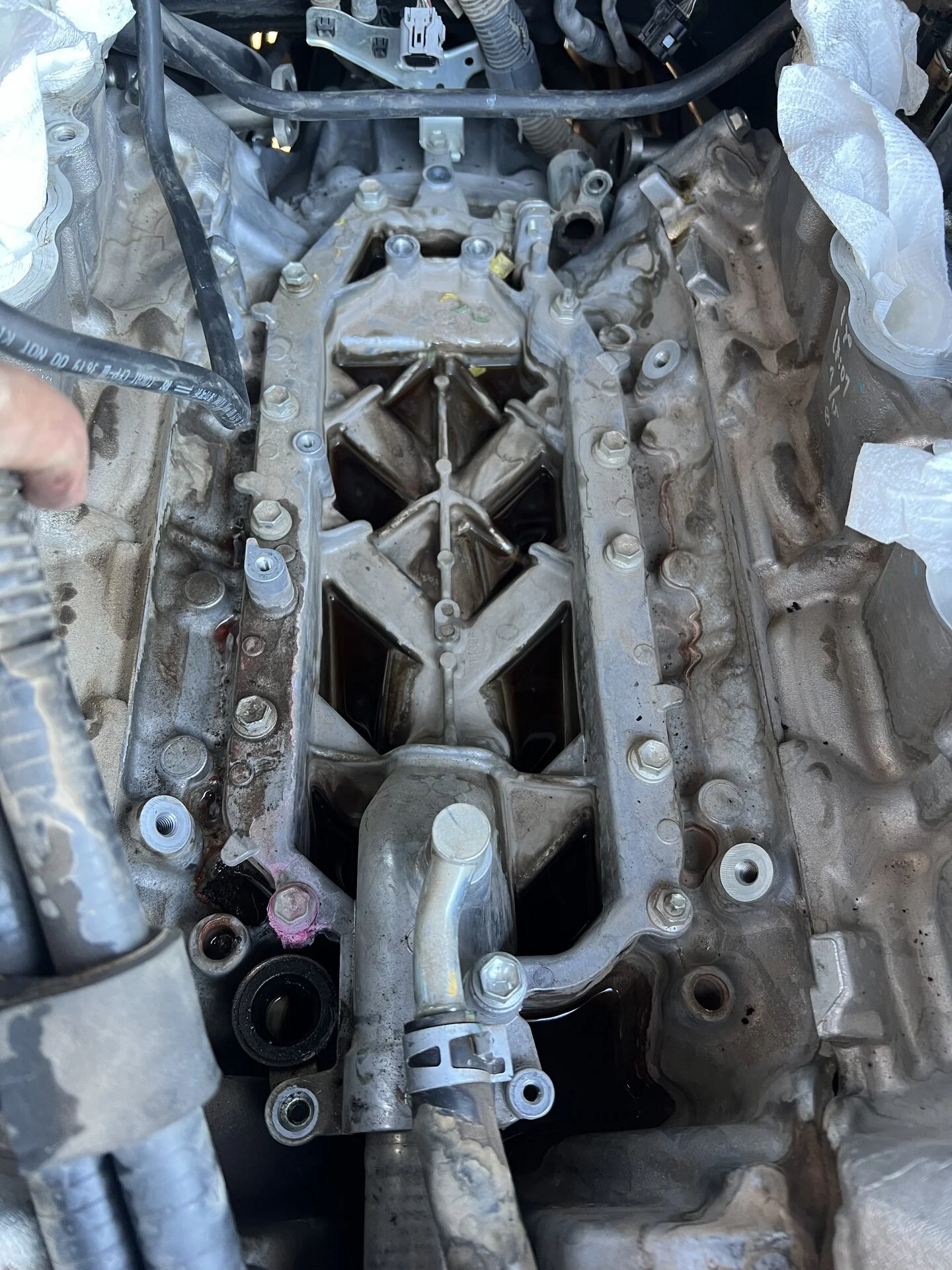

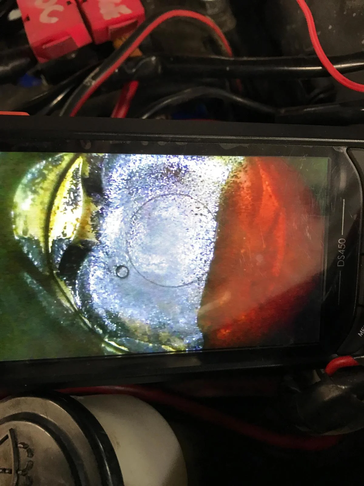

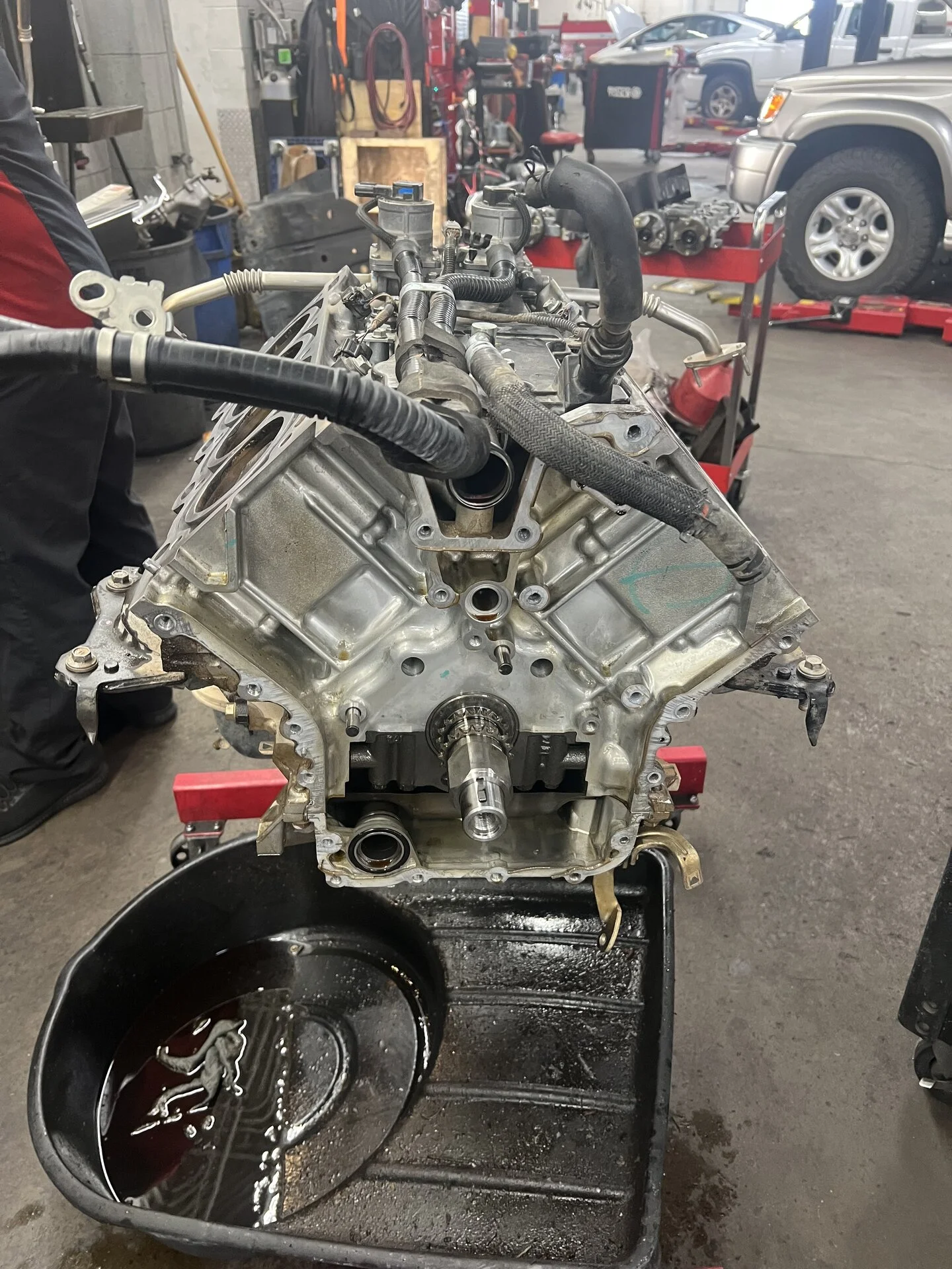

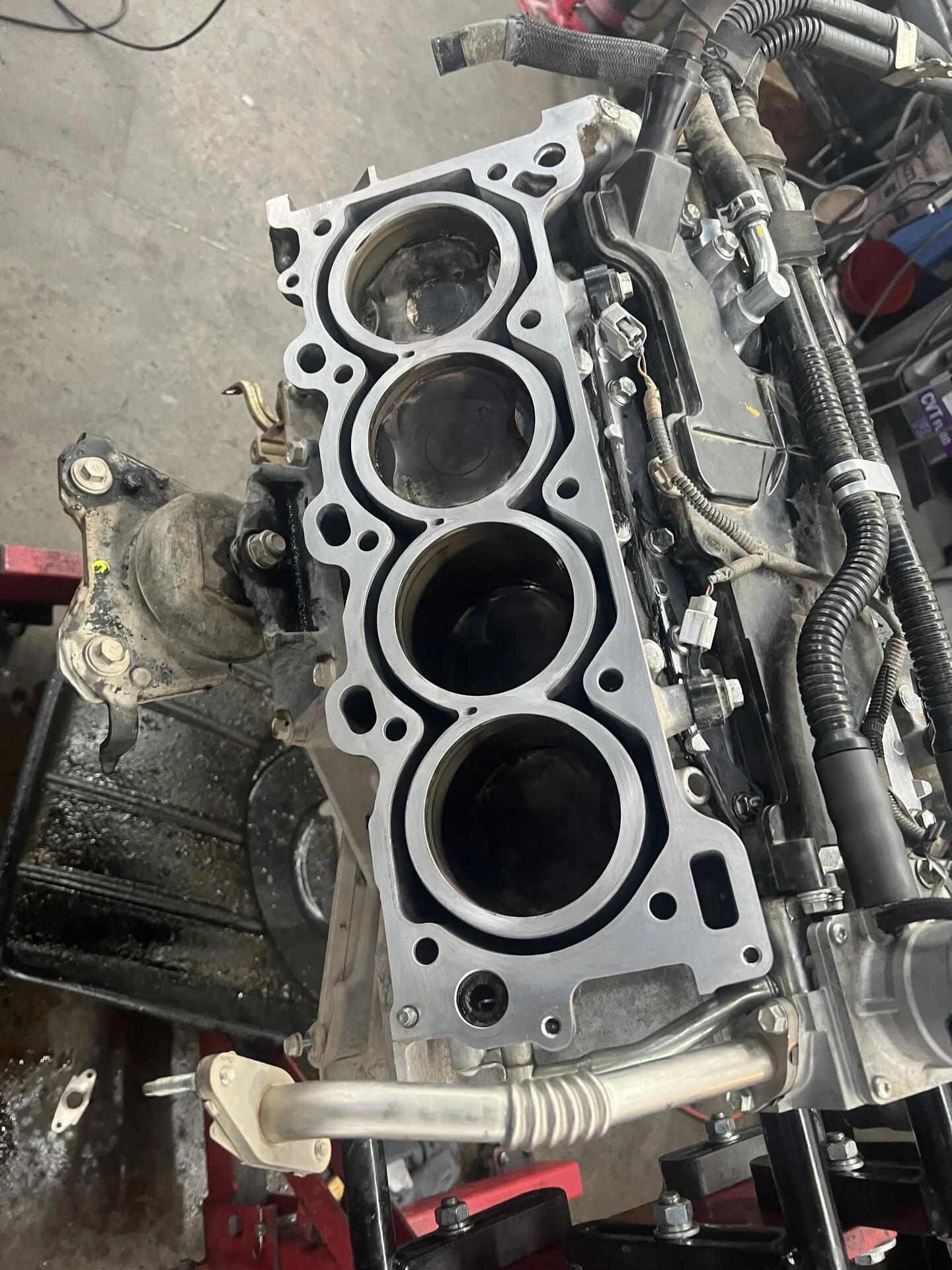

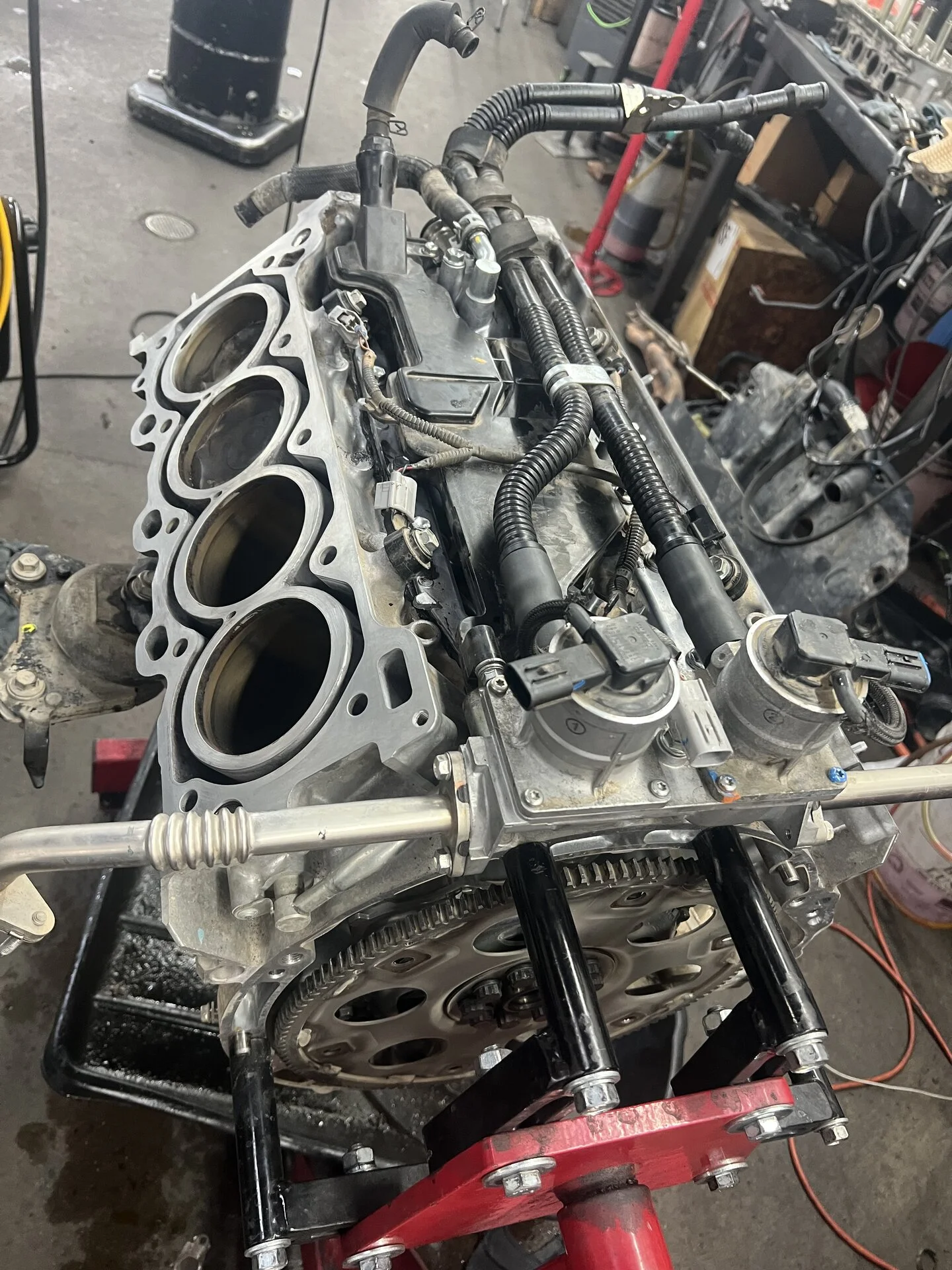

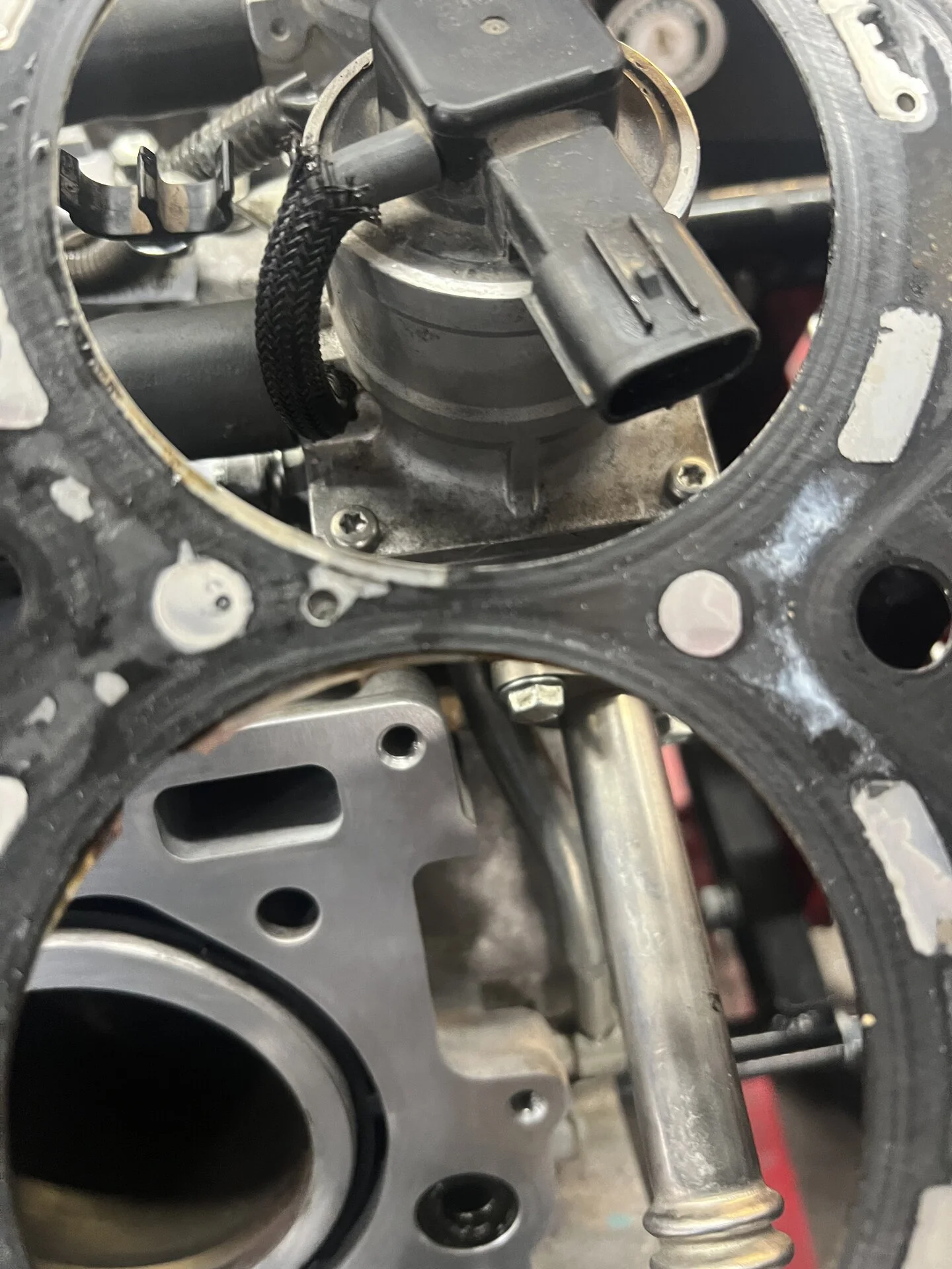

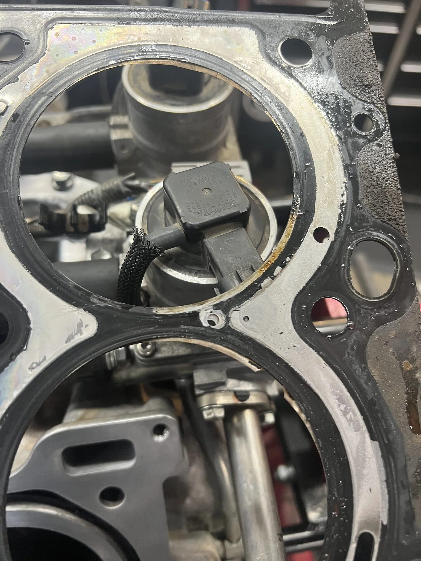

I had P0301 during my road trip. Made it home by checking coolant level frequently and keeping a close eye on temp. Upon investigation, I repaired valley plate, replace all plugs and coils. Took to dealer for coolant pressure test and camera in bore no1 showed coolant. Head gasket failed. Motor is apart right now. Block and heads are in spec. Glad it was not wrapped. I will get truck back next week. I asked for reseal motor, front and rear main seals, water pump, valve steam gaskets, fan clutch, and thermostat stat. Radiator, Starter and alternator was replaced not to long ago.
Hear some pics.
I am replacing both motor mounts and transfer case mount. New O2 and air fuel ratio sensor will be installed. Rig has 146k on odometer. More pics.

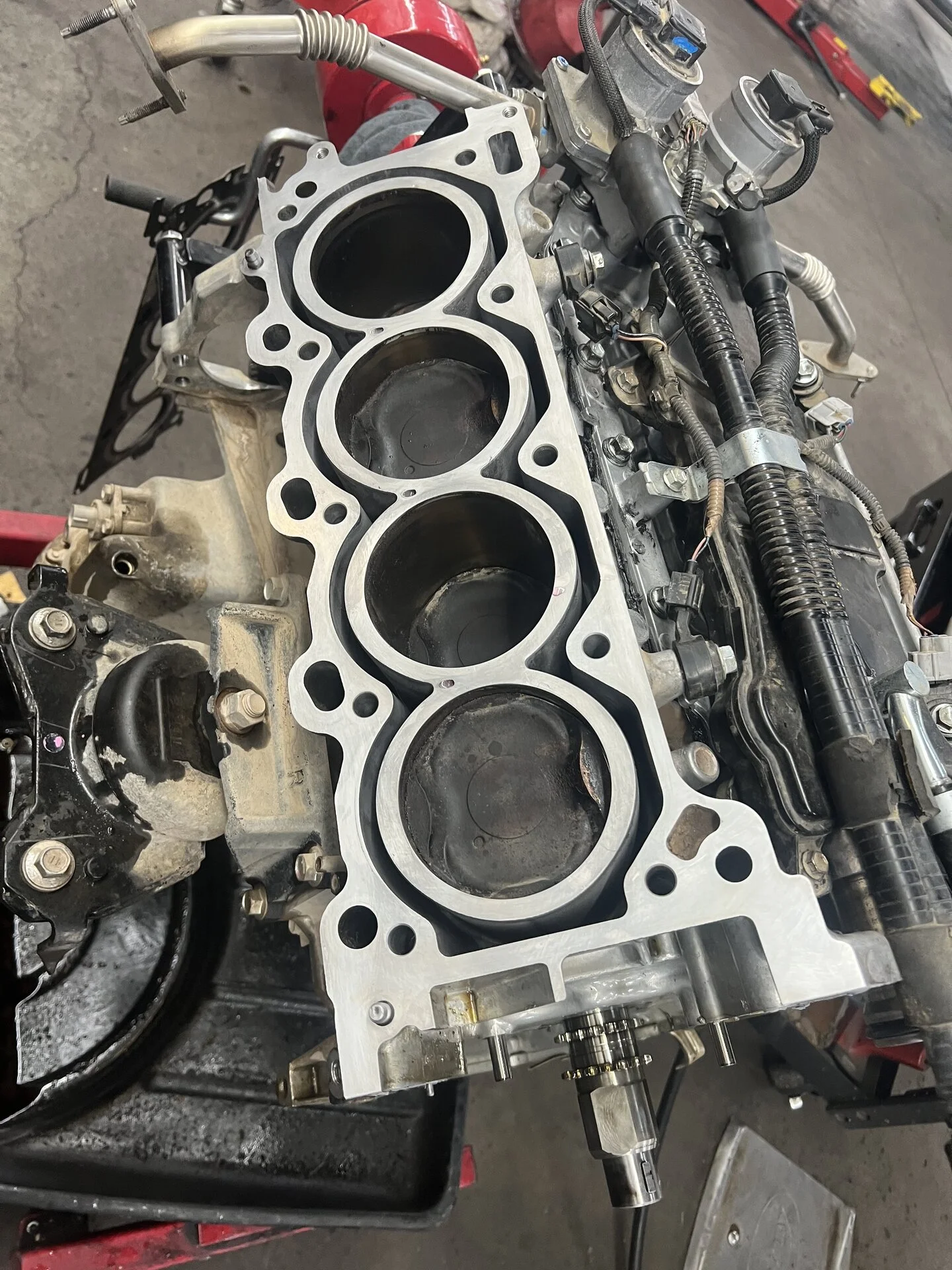

The head gasket failure you show in your photos is very similar to what I saw when I was shown my old head gasket, deterioration of the head gasket between the cylinder wall and small coolant passage hole. I would say we had the same head gasket failure, just a different cylinder #.
