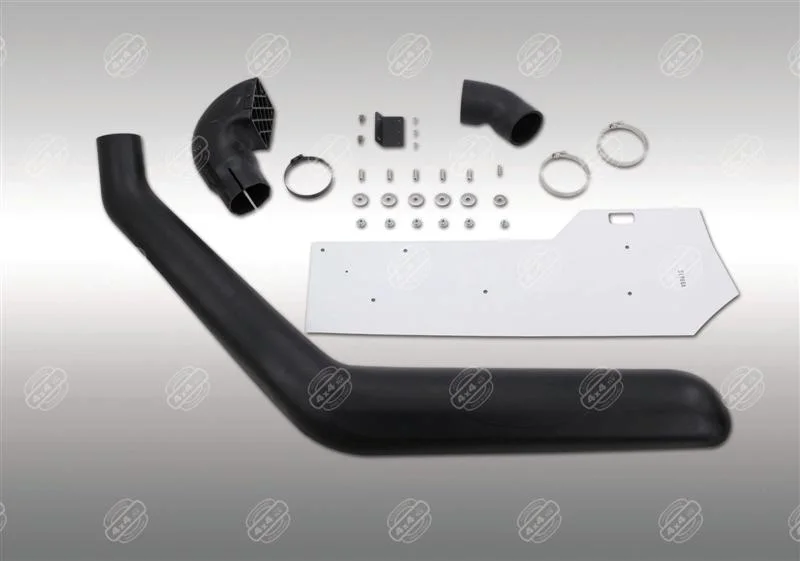

The $ 30.88 Snorkel !
No it isn't going to kill your family but something as vital as an air inlet to your engine is something to think about.
If the plastic cracks, warps or just doesn't line up right and causes a vacuum leak you could kill your 6k engine very fast if you do water crossings.
Now if you want a snorkle just for show then i'd say jump on in and don't look back.

i have bought one of those snorkels from this company, you better save your money for some thing else...
i also thout that it's just "plastic tubing" ,it's not !!!
what they sell is crap, the plastic is very low quality,it's painted black insted of using black plastic,they glue the 2 parts of the tube very pure (i allready got it broken) .
don't touch it.

ok, now we're talking. Real and useful feedback rather than conjecture. If the function is really not there, the low cost becomes a moot point.
