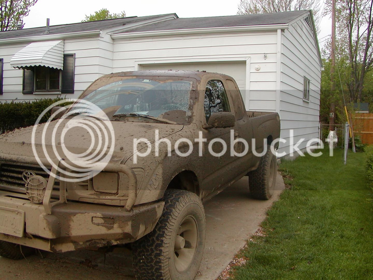

This is about as deep as you can go with a 60 sittin on 4 inch lift and 33's.I actually had mud on the filter(weber).Been nice to have a snorkel then.(pic posted before)
