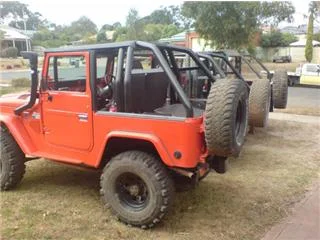

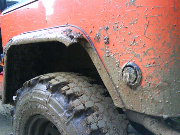

It has a filler point in the rear quarter panel - no need to drop the tank. Best to recess the filler point so it doesn't get hit when wheeling & use a flexible hose between the filler point and the tank.
