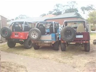

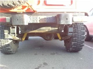

G'day, The Blue & the Orange FJ40's both run duel fuel with tanks under slung at rear (quite common here).
The Blue one has no bash plate and does make occasional contact with the terrain but so far there hasn't been any huge explosions! The Orange one (mine) has a bash plate and had the tank lifted when a 2" body lift was fitted and thus far hasn't hit anything solid. So underneath is fine but better if you have a body lift.
My local Mechanic obtained & fitted the Fuel gauge to the tank - all I have to do is read the little lights - lots of green = you're go to go, Red = you're walking home. I know of a couple of 80 series running Duel fuel and they use the same gauge for both types.
One other thing if you go underneath, make sure the tank is heat shielded if the exhaust runs near it.
