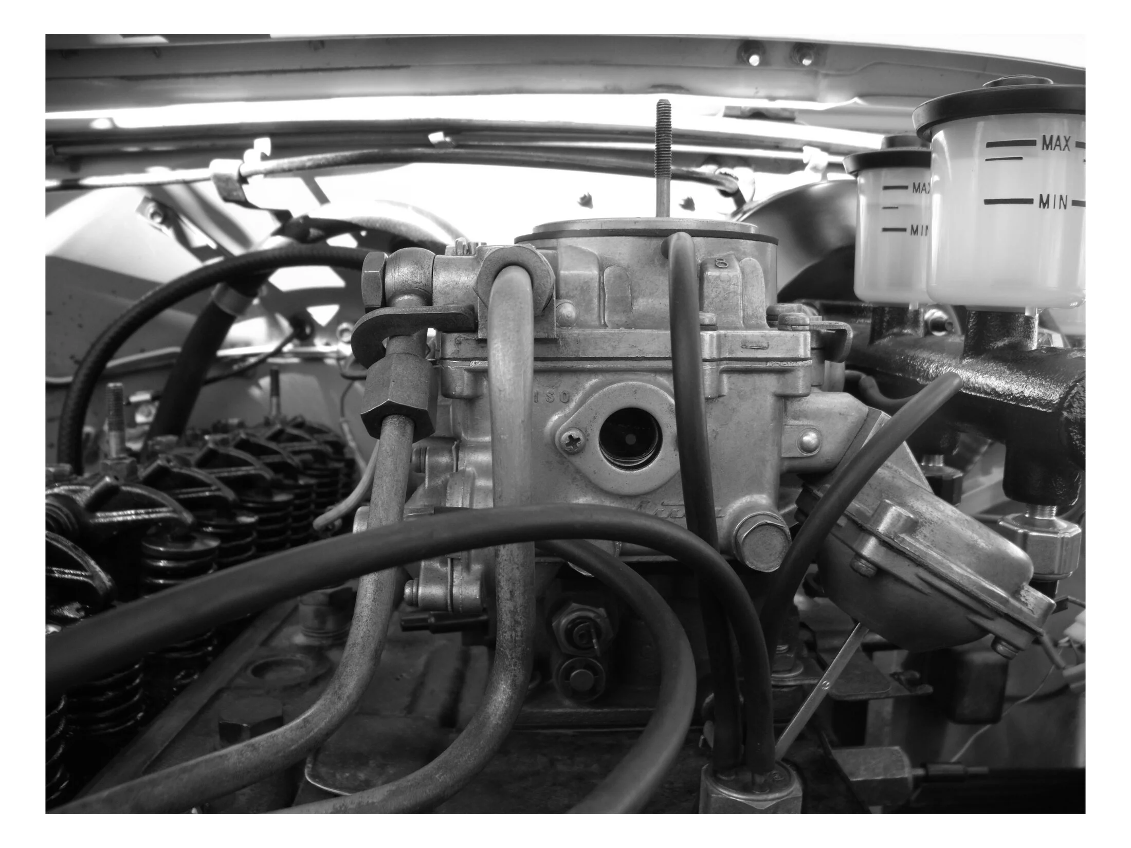

I'm borrowing knowledge here. But, a '75 USA carb is the ultimate Aisan carb. Why, because the accelerator pump is not enough to keep the driver from leaning-out the engine in some situations. Yes, the '75 'smogerator' is the choice carb in this situation.
On a factory '75 USA carb there is an Auxiliary Accelerator Pump, and a Power Valve controlled by the emissions switching valve. So, in theory, the carb could enrich itself two ways. The power valve will enrich the main circuit, Venturis, providing more emulsified fuel via vacuum-actuated demand. The auxiliary accelerator pump adds to the non-emulsified charge, the accelerator's squirt in the primary barrel. Traditionally, the two barbs on the carb would be routed to manifold vacuum, and I'm silently crediting all the innovators on Mud who shared this with me. However, I'd follow a Nissan-vacuum-spaghetti trick that I learned, insert an orifice in the vac line - like a Weber carb main jet, so you can fine-tune just how much throttle pedal stomp it takes to enrich your souped-up, cammed-up, bored-out 2F. Start small and drill the jet to fine-tuen it for how much manifold vacumm loss you get from stomping on the gas. I'd cut-out the auxililary accelerator pump enrichment during cold water temps with a thermostatic vac switch probed into the thermostat housing. This engine does poor with liquid fuel when it is cold, and it isn't like the '76 or later carbs had this feature, avoid the carbon deposit and oil contamination with liquid fuel if you can. However, it would be ideal when the engine is at regular running temps.

My carb's boggy at low RPMs. Here's a pic from Mud, where's the aux pump?

Tell me about it, mine's boggy at low rpm's. An aux accellerator pump carb is the fix?
I think it was Weber idle jets, not main jets, that will attenuate a vacuum signal when inserted into a usual vac line.
The Auxiliary Accelerator Pump feature is cast on 2F carb bowls, but only a few have holes drilled, and a diaphragm housing on it.
