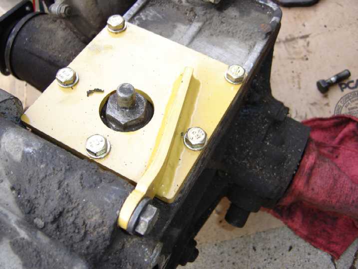

first pic, is this bling enough
second anyone have 22mm nut?

That is an AA adapter, right?
Give them a hollar, and tell them you need a COUPLE of those nuts...IIRC they are a nylock nut...
You KNOW it is 22mm?
Can you measure the thread pitch?
I might be able to come up with something if I have the diameter and pitch of thread...
Good luck!
-Steve
the nut i got with my kit from AA was a nylon lock nut. AA says it is just a standard nut 7/8 -16 nylon locknut that can be found on most jeep transmissions ,just used a flat washer and nylon locknut , torqued to 75 ft. lbs ?? thats what my instructions sheet say's
Poser said:
Jim-
Good luck!
-Steve
i'm pretty sure it's a 22, when i went to my trusty true value in towm,
they had a guage, the threads went thru a 22mm hole.
i'll ave to measure and get the pitch tonight or later, i just want to get this mounted up.
i'm soooo close to bolt'n up to the bell housing,i gotta cut some more floor pan out under the gas tank :eek:
and yes,that is a AA adapter
thanx steve
