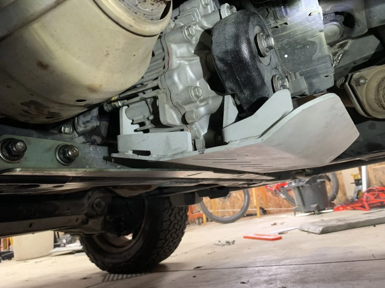

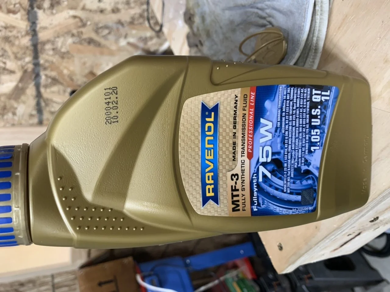

Changed out the transfer case fluid today. Strangely I had about 1/2 quart of fluid come out of the fill hole. 200 was level, if anything it was a little bit nose forward. Replaced the fluid with Ravenol 75W. 90% of the job was taking off the ARB plates. It was a good opportunity to put anti-seize on everything.
I still can't believe ARB made that transfer skid weight bearing on the transfer case. That is a great pic!
Stock TC same issue, something like 13 bolts to get the damper, skid and heat shield off.

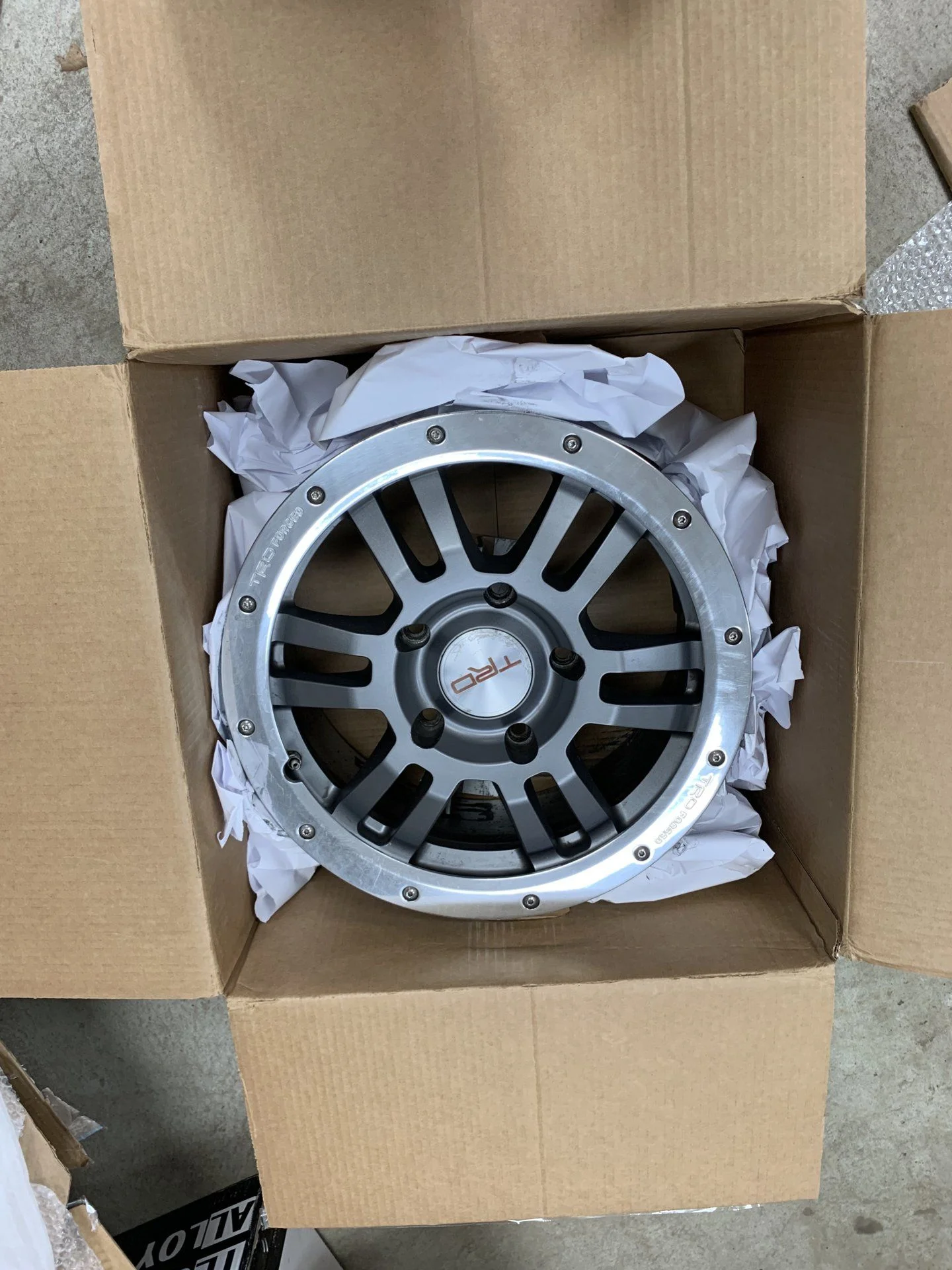

While I'm waiting for parts I'm starting to think about tires for the Rock Warriors I picked up.
I have the Ridge Grapplers on my 80 and like them, but I'm also considering BFG ATs. Still haven't decided if I'm going to go 285/75 or 285/70. The current set up on the 200 is 1.25" spacers with 285/55s on tundra 20s. Doesn't look bad but not my cup of tea.
Each of the wheels has a TPMS sensor, but no idea if they work or not. I'm thinking with covid-19 tire shops might be closed and if they're not I'd prefer to just drop the wheels off and pick them up. I'm not too familiar with TPMS. Can I add the new sensors to the system myself?

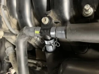

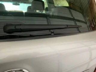

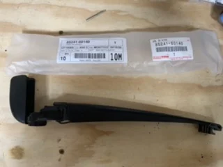

New rear wiper arm and ventilation tee today.

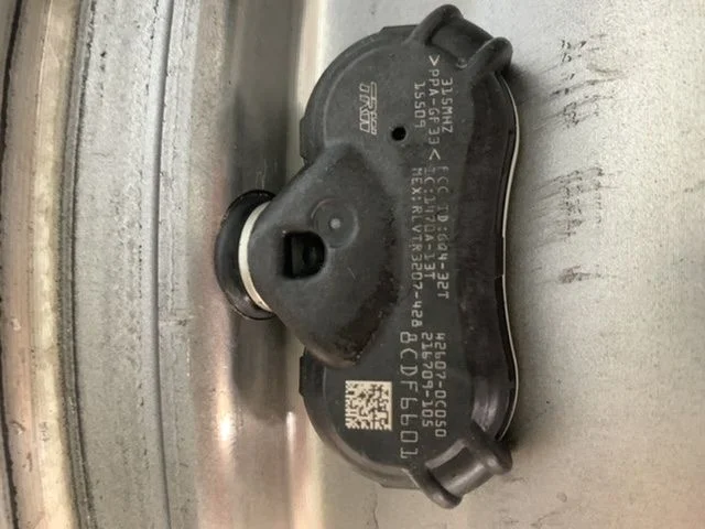

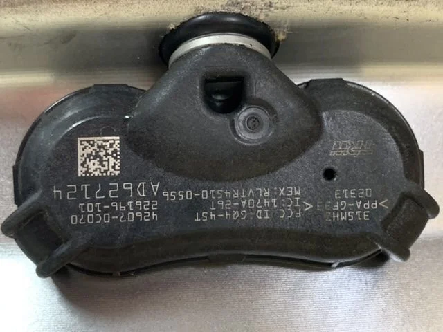

IF they are Tundra Sensors, they will not work. Not sure if you know what vehicle they were last on or not.

Looks like I have the tundra sensors. 42607-0c070 and 42607-0c050.

Unless you know the history of the wheels, you'd want to replace sensors anyway. Here's a good write up on TPMS. Here in the Lansing area, tire shops are an essential business and are open. Some have limited hours and are restricting business to damage/flat repair and worn tire replacement. I assume it's the same over your way.
Excellent info thank you. Looks like I need to pick up 5 new sensors.

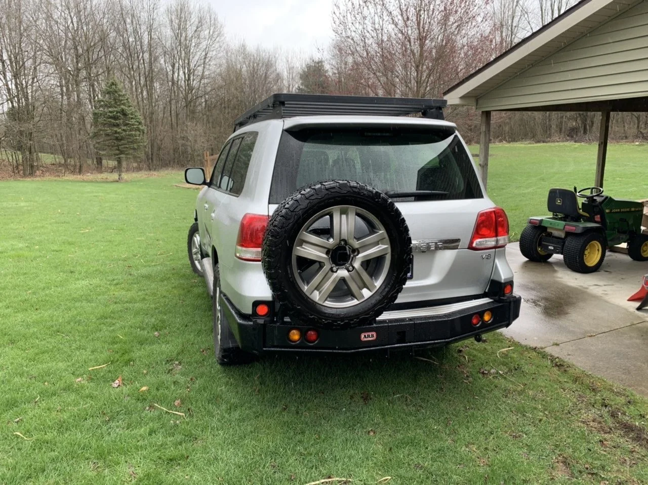

Put the ARB tire swing out on today. This turned out to be a much bigger chore than I thought. The amount of tweaking needed is really annoying compared to say my Slee rear bumper. There's a lower bolt on the swing out receiver (not the latch) that is virtually impossible to fasten with the bumper already installed.
Nice! Did u happen to get pics by any chance of the assy process?
Didn’t know adding the swing out secondarily was possible, pretty cool
I didn't but can take any pics that you might need.

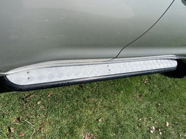

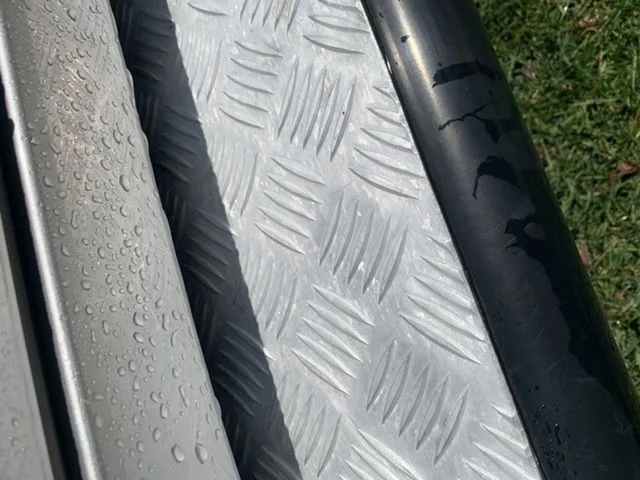

I used phosphoric acid to clean up the diamond plating on the ARB steps. They look brand new. Not my metal tech sliders, but they are what hey are. Wish I took before pics.
It is a bit curious. The skid looks to be more bombproof than the TC case itself. And likely stronger than the structural components the TC is mounted to. From a systems design perspective, I'd rather the skid be the sacrificial component, deforming and taking some energy out of a hit. Or like your suggesting, mounted to transfer energy to the main structural components rather than to the TC.
