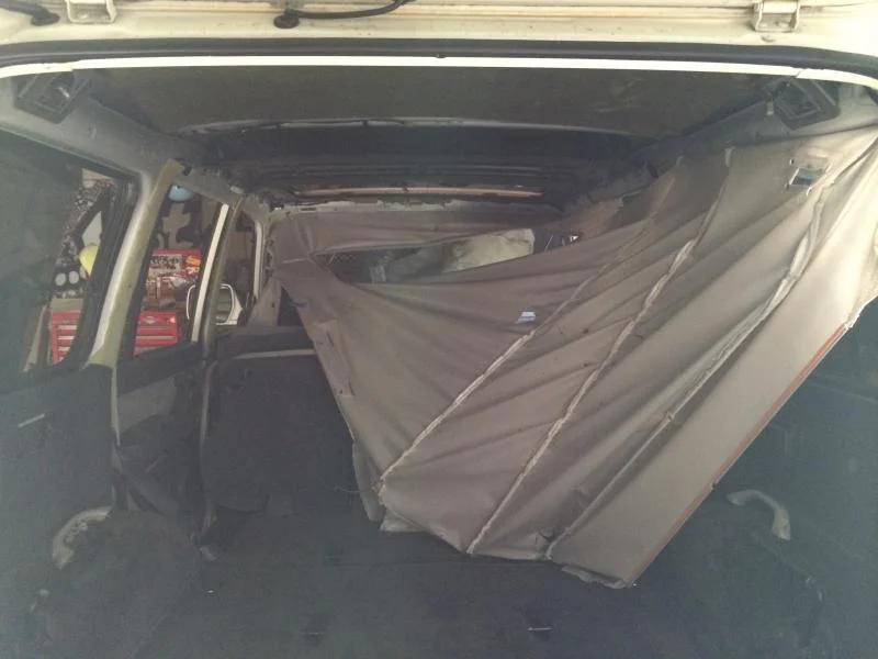

I would recommend headliner removal. It is as easy as an oil change on a difficulty scale and is a one man job. Once removed you have access to all four drain tubes and can inspect the drain pan for cracks. It's also advisable to clear the tubes by flushing in the direction of flow otherwise all the gunk just sits in the sunroof drain tray until the next rain comes and clogs the tubes again. It's a good opportunity to shampoo the headliner once it's out too. It's not a good time shampooing with it installed. Ask me how I know

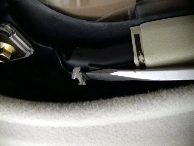

It sounds like i can remove the interior trim and then access the sunroof bolts from the inside. Remove 4 bolts and pop out the glass. Then i can try to fix the seal. But everyoine says the trim parts are very delicate and break very easily. Can someone tell me what way to pull them off with out breaking them? Do they get pulled down to the floor direction or back or how? Is there clips like the body panels?
The molding is very likely to break no matter how you approach it IME as the plastic gets very brittle and the clips are very snug. The ideal tool would have a wide flat blade like the screwdriver in the photo but with a thinner shaft, it is all done by feel however as the tool has to slide under the molding while it is still attached. The photo of the left front sunroof corner is staged to show where the clip is located after it broke. To lever the clips out you twist the screwdriver. Once the side molding is removed there are three nuts on each side (with shims) which attach the glass to the sunroof mechanism.

I recently attacked this task, I removed the entire diver side of the headliner & was able to remove it with a helper. I left the front window, pillars & passenger side attached. Its not the worst thing to do however its a pain at the rear window rubber & those clips. A few putty knives and a screwdriver and your all over it. Good Luck...
