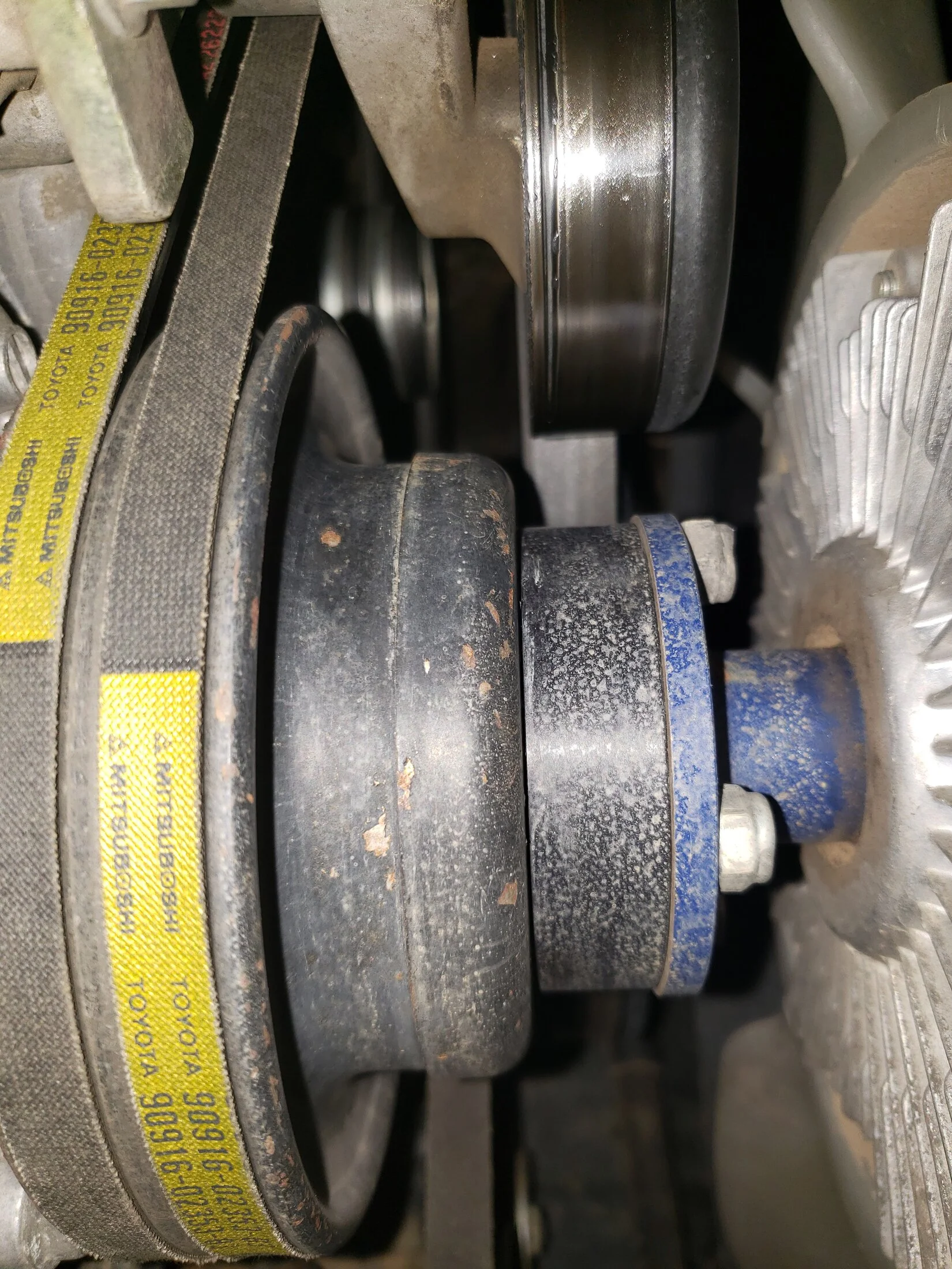

I'm not upset, but I see why you think I might have been. It seemed like we were at the point where things go down the toilet, but the several posts about pulling over and revving the engine confirmed that this is all pretty typical (or at least thats what I determined). I'm grateful for the help I've received to get there.
I wouldn't be surprised if I had an upgraded SC pulley without knowing it - I've already stumbled upon more than one upgrade I didn't know i had. Ill measure tonight.
I missed that you have a SC. Since you have a blue clutch you likely also have a ringed fan.
You might consider my SC orange fan clutch and going back to the stock fan. Big improvement.
I don't have the ringed fan. I actually found a post by the PO where he went back to the stock fan, and I was scratching my head as to why, especially after having read page after page of posts about how the ringed fan prevents radiator destruction with the SC.
Can you point me to the answer to this, and to the benefit of the orange hub? PM is fine, if you prefer.

The TRD supercharger originally had a ?3/4”? spacer on the water pump for the fan clutch to mount on. Because of this they subbed in a smaller ringed fan to guard against damaging the radiators.
Running hot was the norm at that time.
I came up with modifying another Toyota clutch that was slightly taller than the blue clutch but cleared the SC belt which meant that there was no need for the spacer and enough room for the return of the stock fan.
Once people saw my solution they started experimenting with copying the idea by stacking washers and other means.
Because you have a blue clutch on there with a stock fan something has been done to make things fit. Anything from mounting the fan clutch on the factory spacer which puts the fan very close to the radiator to stacks of washers or something else.
Post a top view of the water pump clutch interface as well as the fan to clutch interface.
My SC pulley is 88mm. Pics of fan clutch attached (I don't know if I got what you need - tough spot to photograph).
If I remember correctly, the 3FE fan works with the original S/C spacer; looks stock-ish but is not. The stock 1FZ fan is larger in diameter, but needs a different spacing to not conflict with either the S/C belt, or the radiator. Our S/C’d ’93 has a custom spacer made by the late Tools R Us to accommodate the stock 1FZ fan, a blue clutch with ~30k oil, the water pump overdrive pulley, and a TYC radiator with foam around it. It lives in Phoenix, has mostly trail duty (well, except for this summer, due to multiple fires and the resulting land closures; it passed the emissions test in June and has been sitting ever since), and 90F ambient isn’t hot.
I thick chase truck is right. There is a spacer on your truck so the stock fan won’t fit. I had actually forgot about some using the 3fe fans. Those were better than the ringed fan but not as good as the stock fan.
The 3FE fan has some short fins on the motor side of the fan blades, probably to help direct air flow towards the motor, instead of air moving radially off the fan blades and thereby back into the fan shroud. I can't tell from your pic, though. I've heard a fan blade from a 4Runner - don't know what model - can also be fitted, never seen one though.
