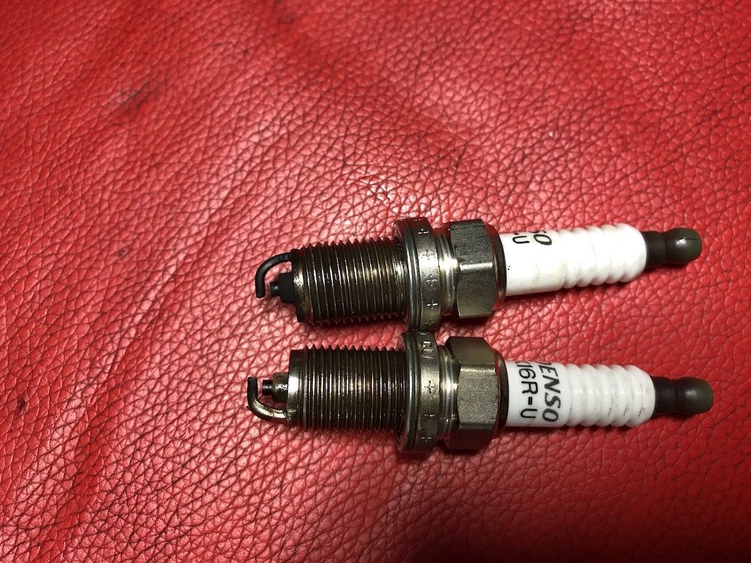

Well, I pulled the plugs and wires again. #3 shows no signs of combustion and had a small amount of oil on it. These have maybe 50 miles on them. #3 is the bottom one. You can see how white the tip is compared to the carbon on #4. I confirmed with my spark plug tester that there is spark. Closer but still unsolved..... I am thinking it's the injector, will test that in the next day or two.
