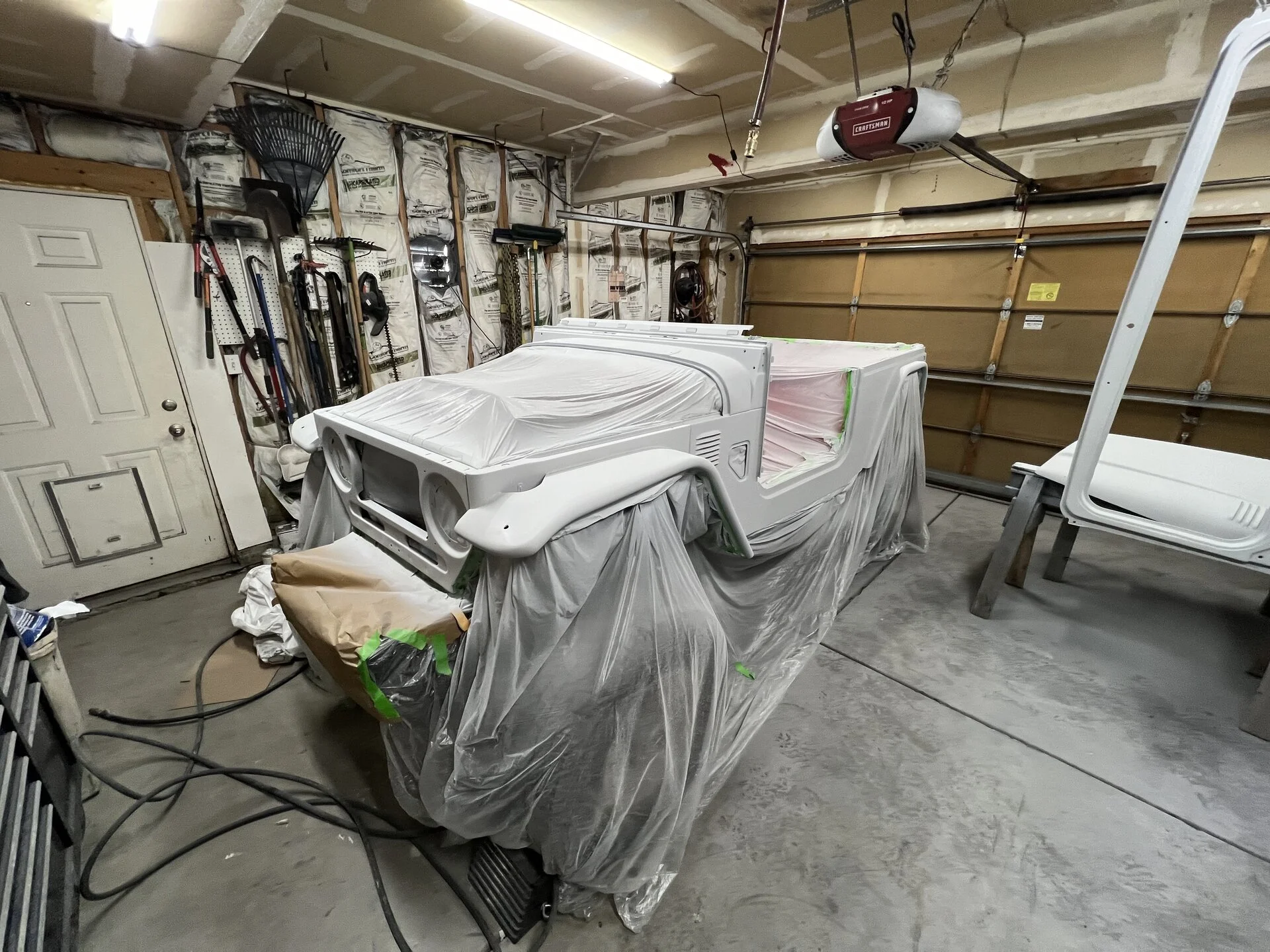

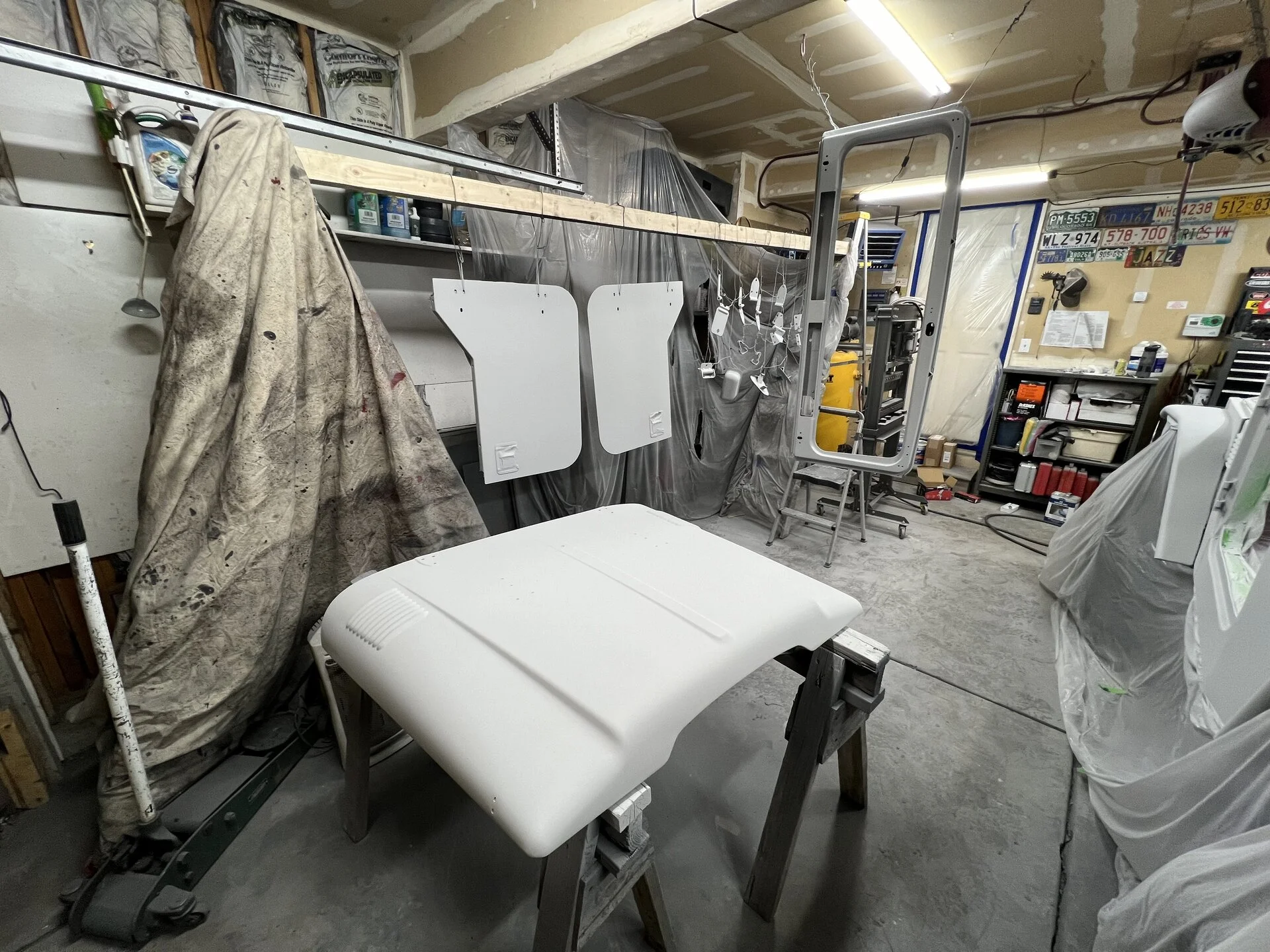

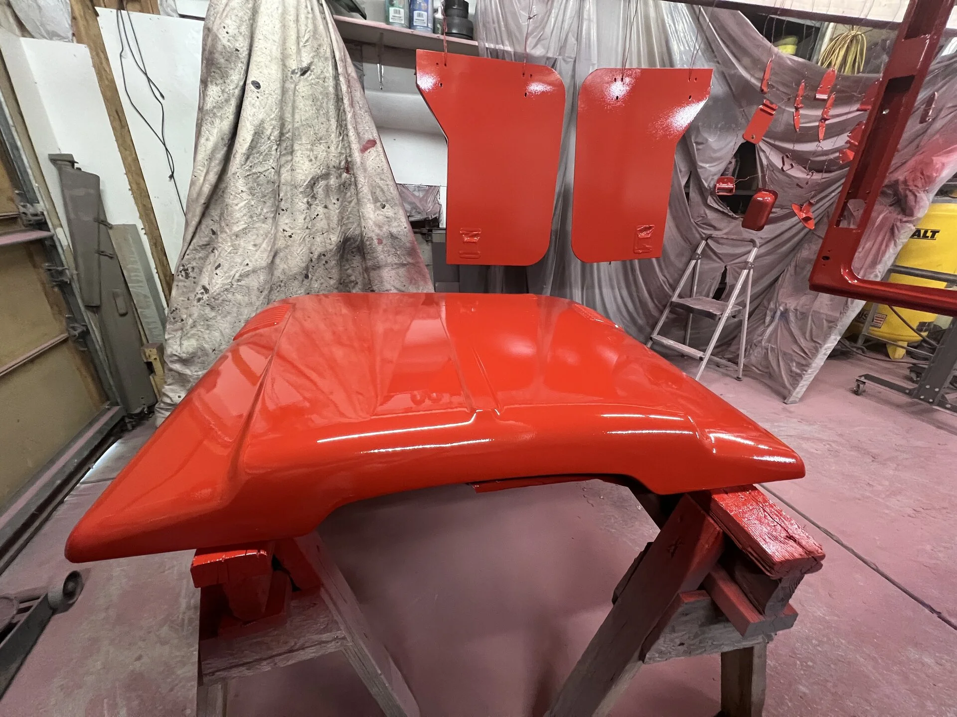

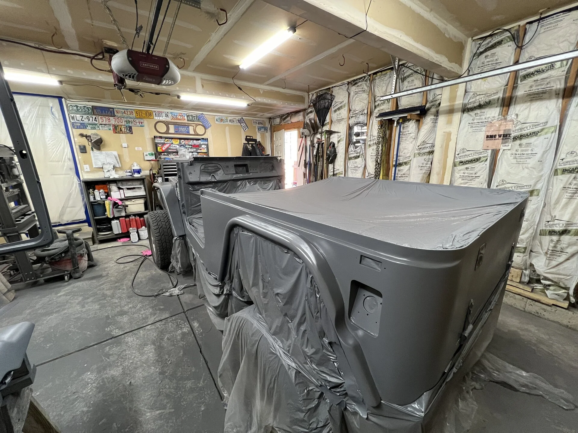

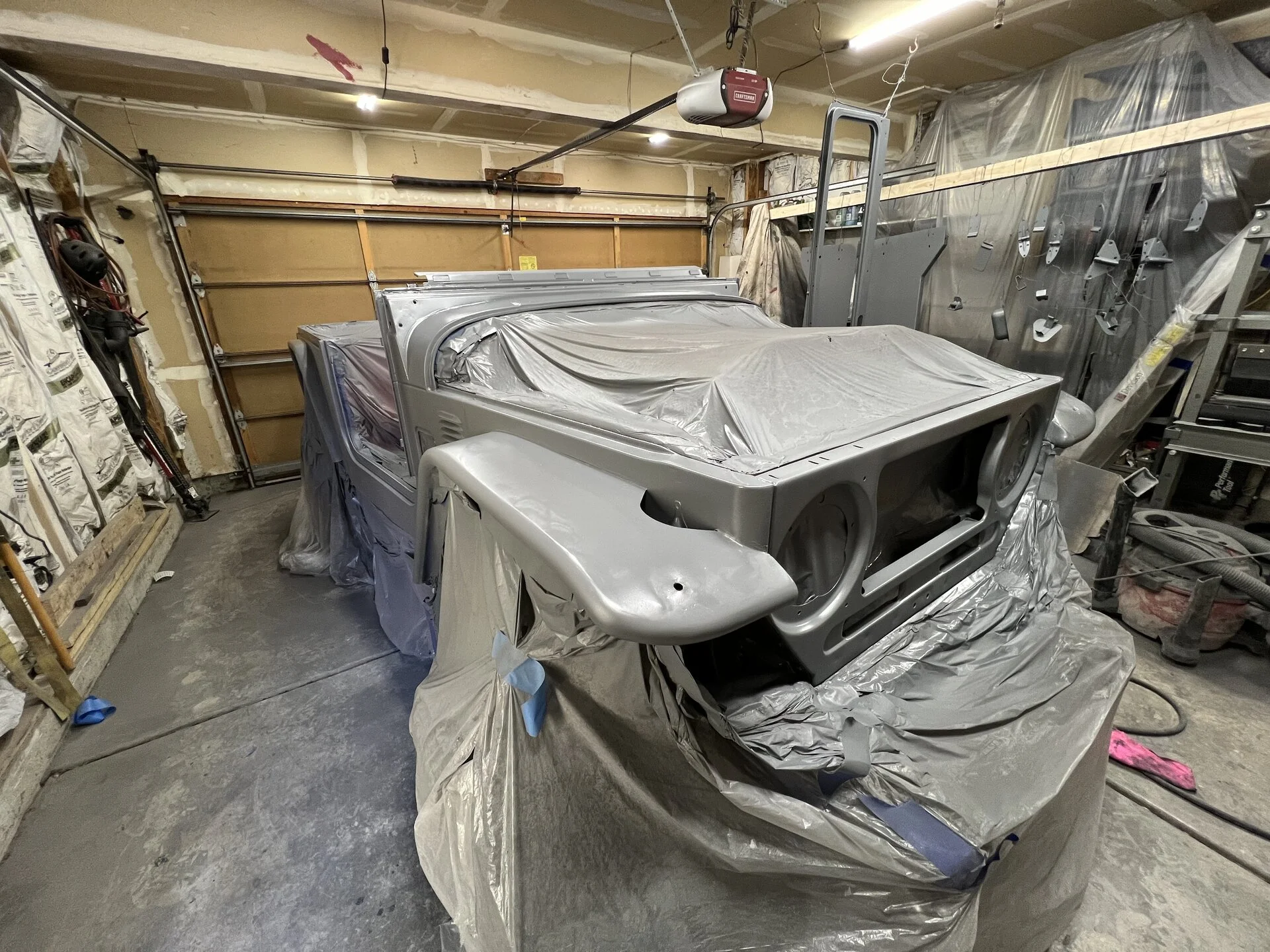

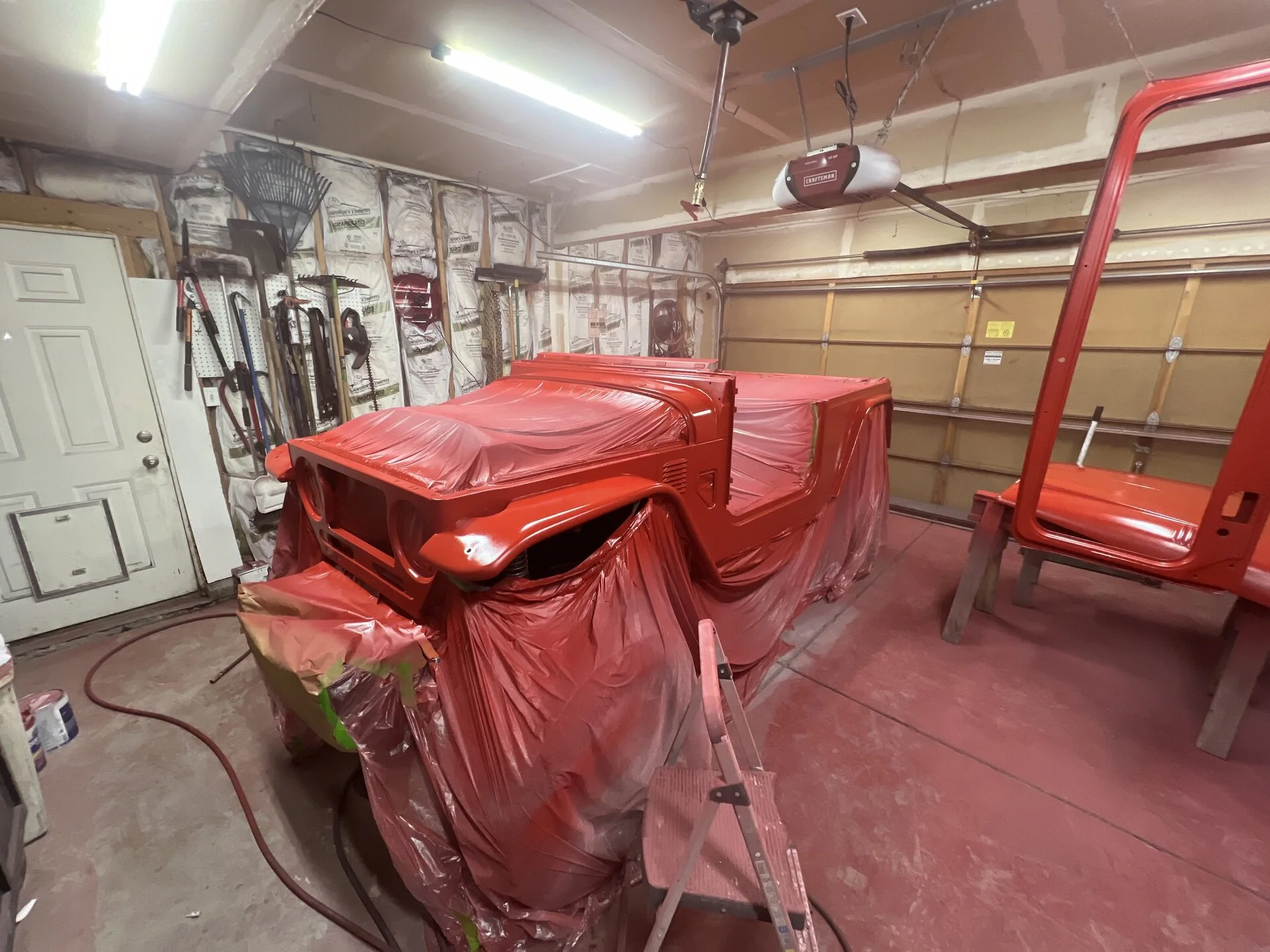

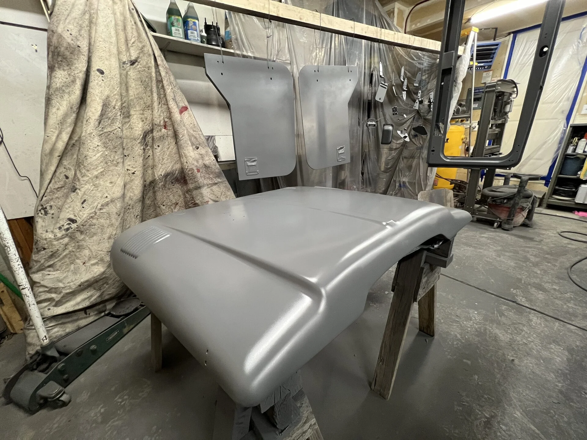

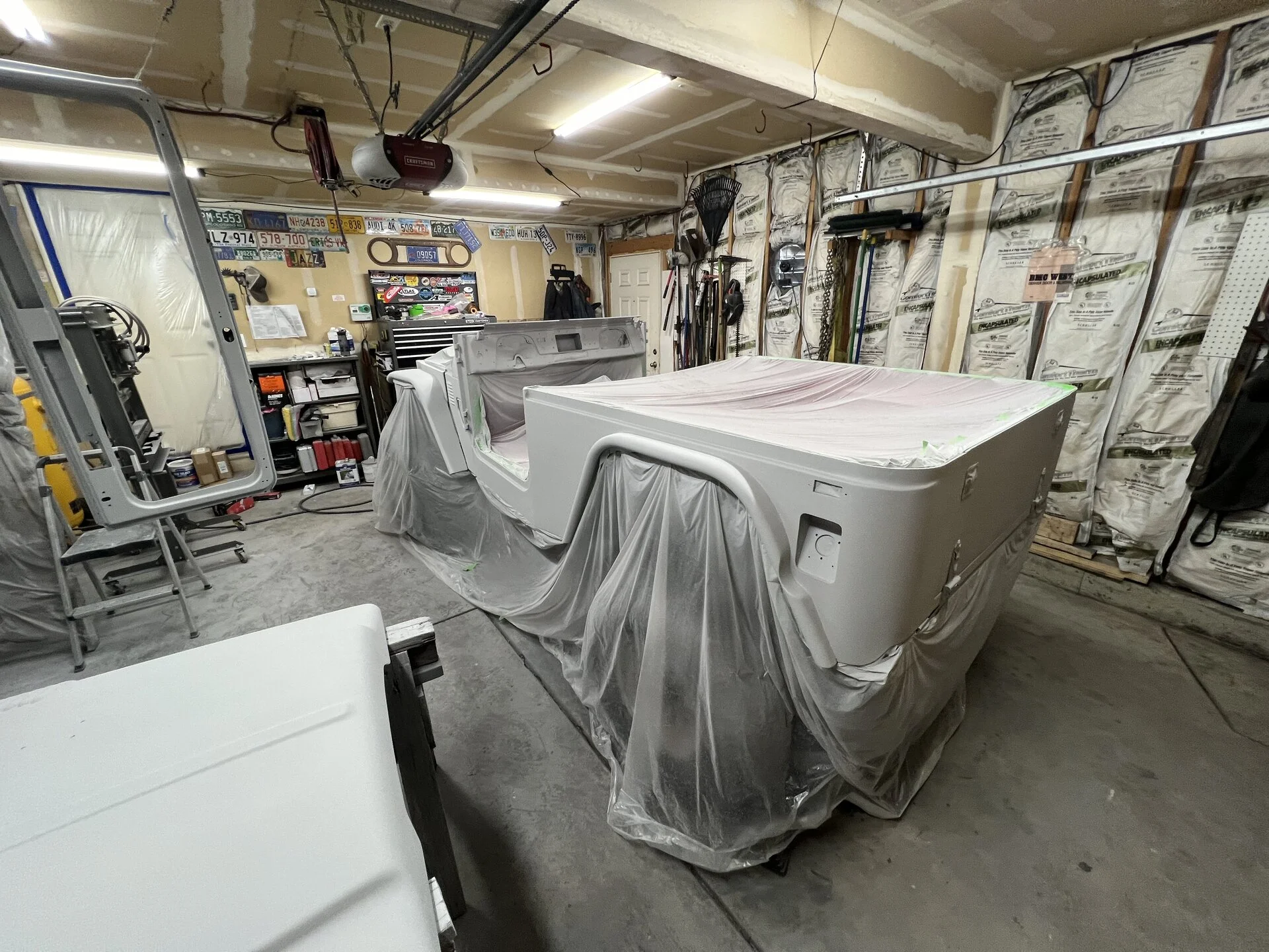

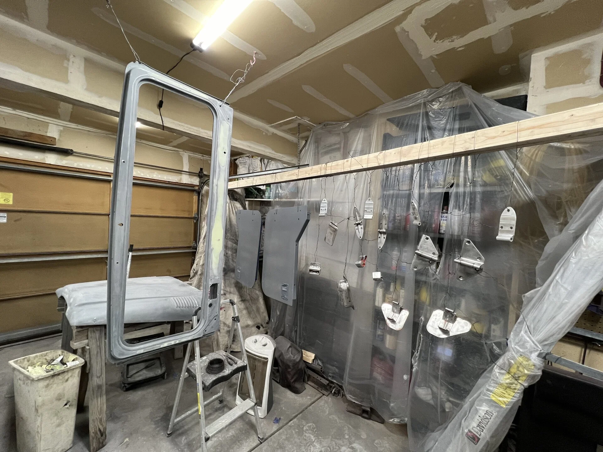

I don’t know what kind of tree you were thinking but this is what I came up with.

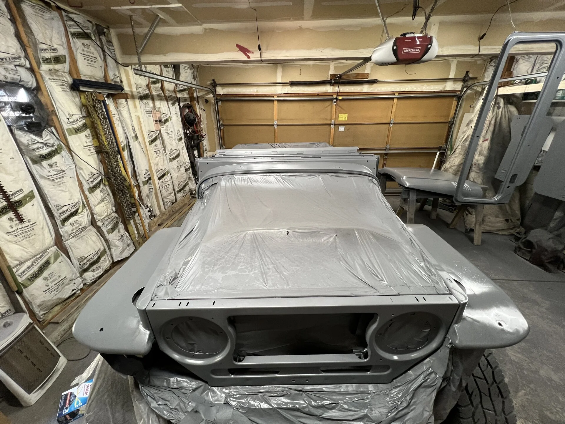

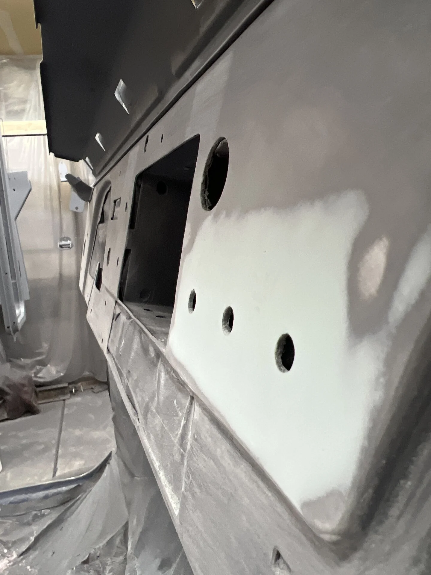

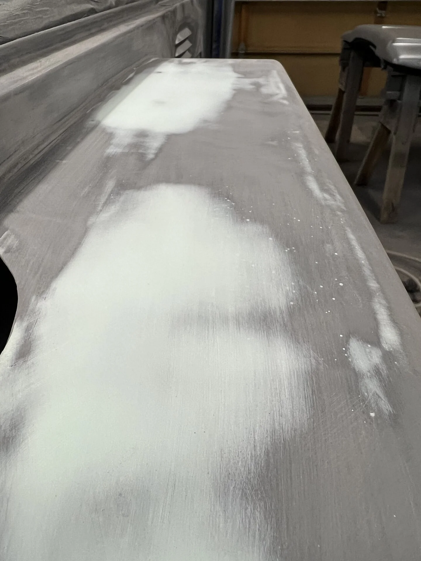

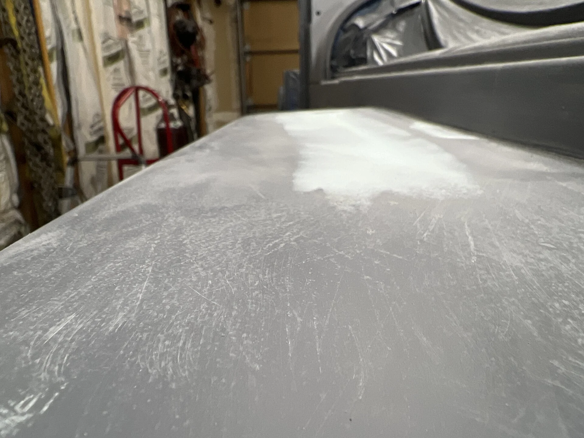

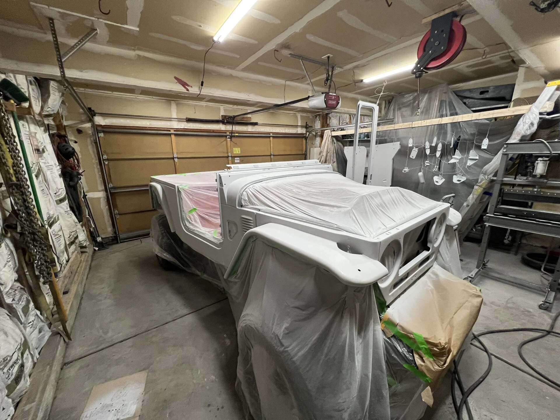

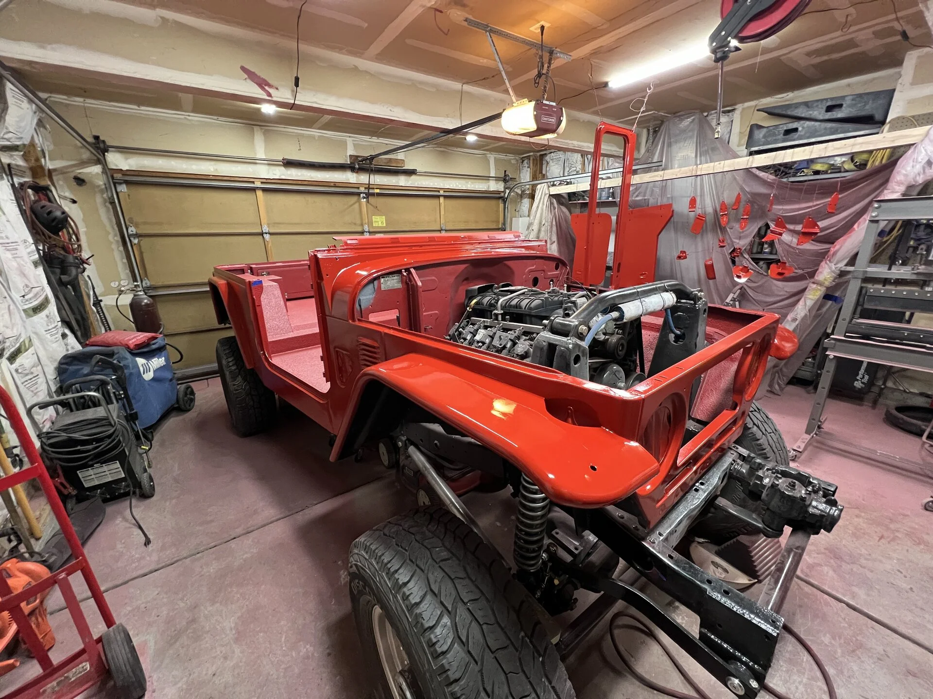

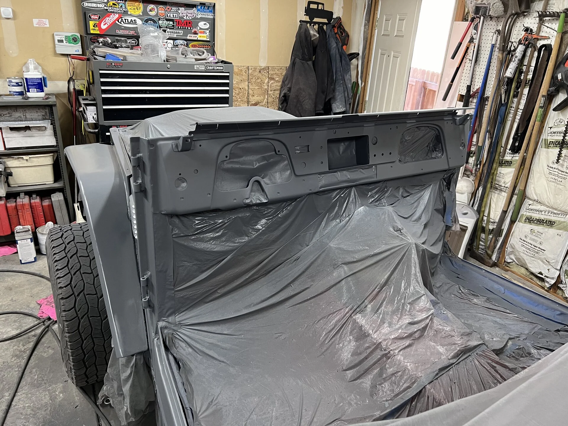

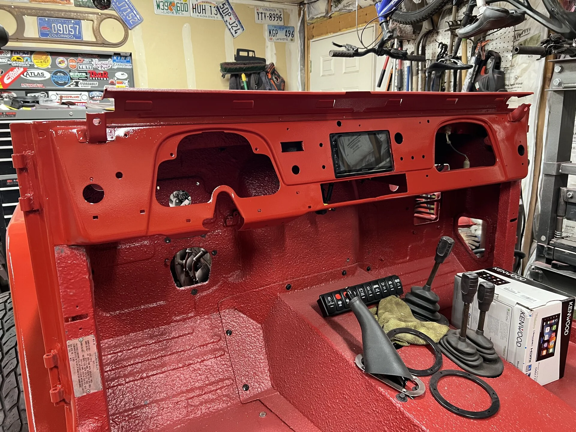

if anyone is watching this for tips I’d recommend doing your own research. Ha. I am putting new plastic down as the primer was flaking off of the old plastic. Next time I’d paint first, then texture last.

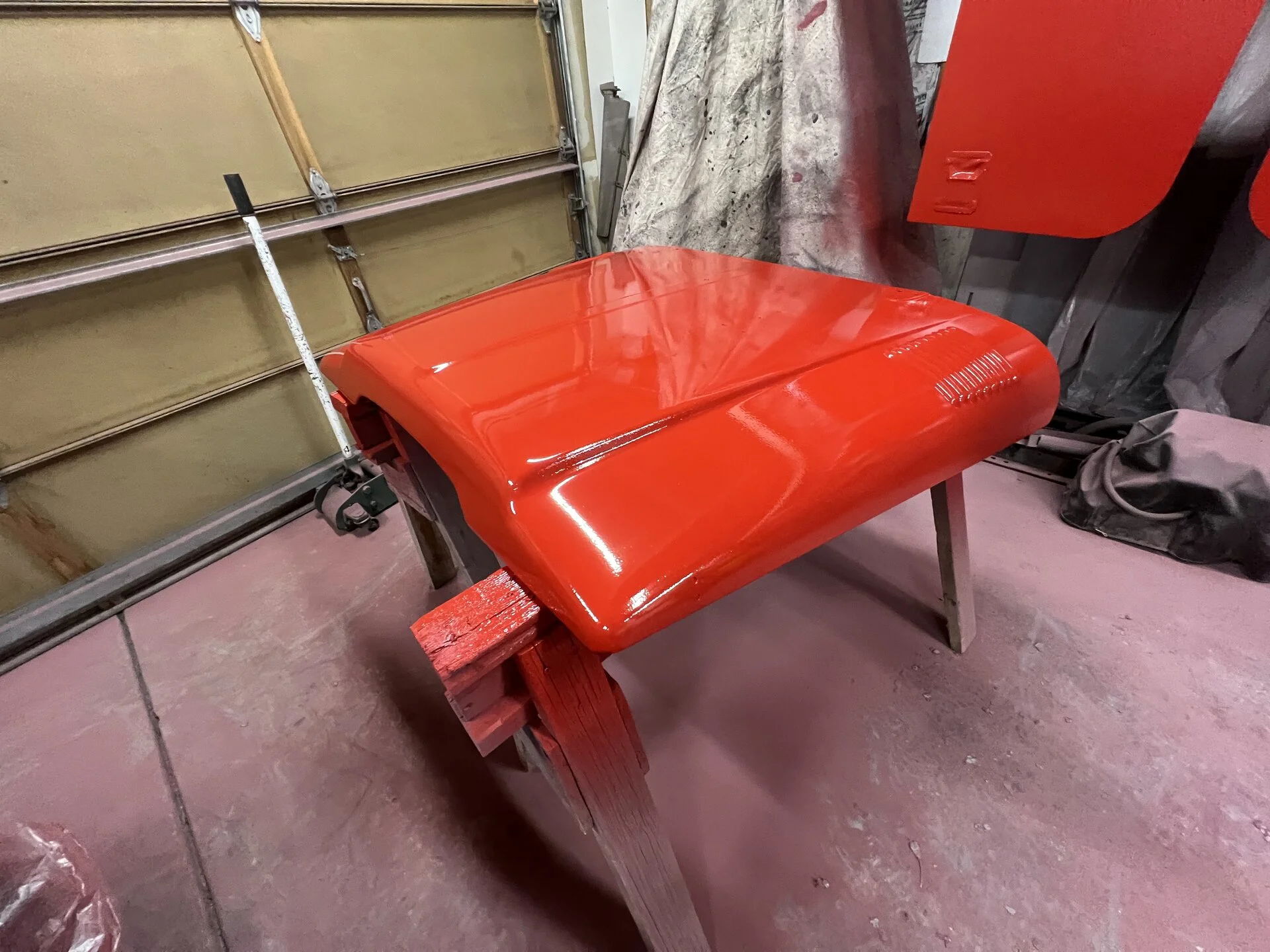

No big deal though. I’ll tape this and call it a day. Paint tomorrow.
