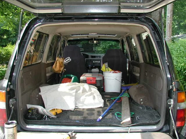

Currently, I carry a Pelican 650 case with tools and gear in it. I like this solution better than drawers because I still have room for a full size cooler next to it, and I can take the case and cooler out to sleep in the truck if I need to. It is easy to strap down, water tight and holds lots of stuff.
Is this the case you use?
http://tinypic.com/view/?pic=raaicw
I should have said a 1650 case, not a 650. If you look around you can find one without any foam in to for under $200, just google Pelican 1650. Here is a link that shows all the different models: http://www.pelican-cases.com/cases.html
I will try to remember to get a pic of it in the back of the 80 tomorrow to give an idea of size.

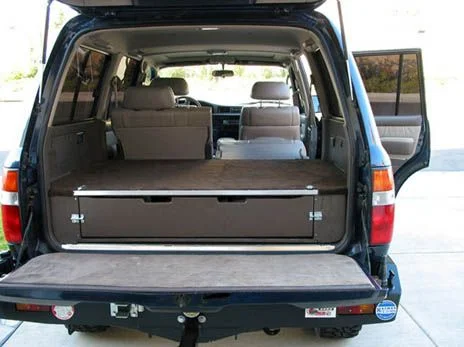

From a Post from rockclmbr

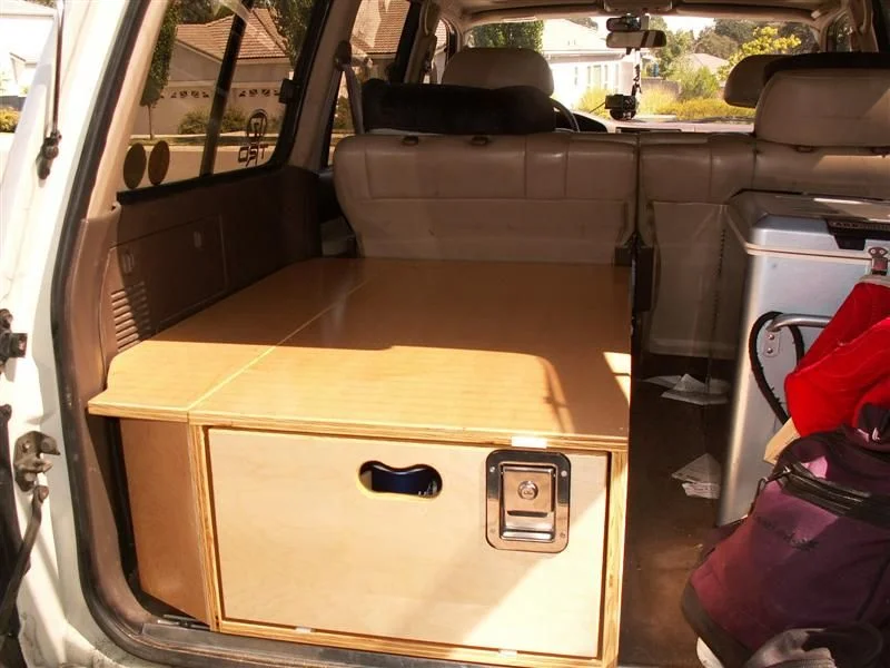

Here is my set-up which has saved me hours of loading/unpacking during trips! I'll give credit to Jim Brantley for the base design. I made a few minor additions that I thought was needed:
1) Fold-up flaps to make the entire platform flat ( this is a must if you have a dog in the back)
2) Cotter Pin setup (not shown) to index the drawer and keep it open when on a slanted hill. This also keeps the drawer from rolling out too far or closing.
3) Hand holds to open and close drawer without pinching fingers :eek:
Things I wish I added:
- top hatch for getting to gear that is inacessible when the back is stuck up against a tree or rock!
attachment.php

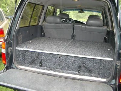

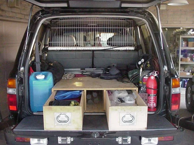

reffugs Outback Drawer System
attachment.php

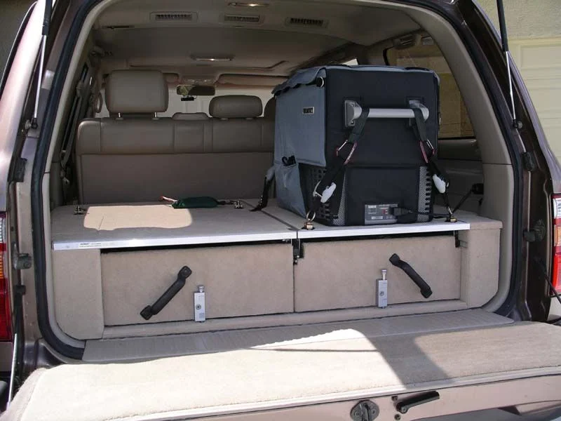

Here is a Teaser shot of NorcalDougs system that can be found in this thread

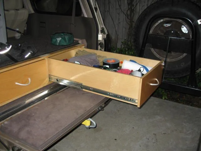

Spressomon's African Outback setup that can be found in the same thread as Norcaldougs, but specifically here

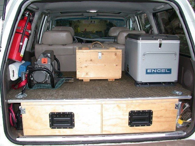

Maddbaggins low cost storage solution that can be found here

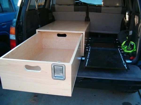

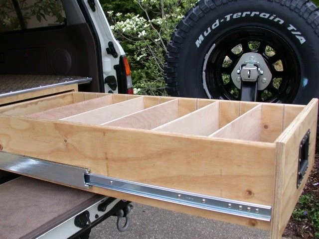

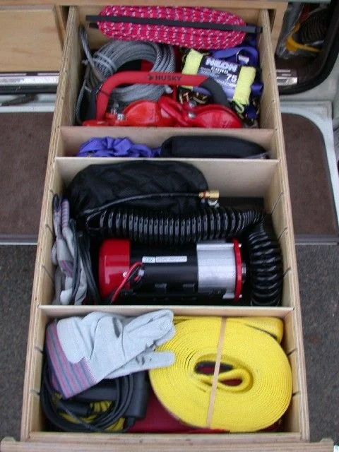

Here is my drawer system. Constructed of 3/4" no-void plywood covered in rubber-backed carpet. Drawer slides are heavy duty full-extension units. More details in my ROTW (link on the signature line).
Cargo Drawers
Drawers taken from Jim Brantley Prismojim
3/4" Baltic Birch plywood - heavy
durable waterproof finish
construction blind dado and glue no screws
all wood cut by CNC router no cuts made by human hands
Accuride 36" slides 300 lb capacity each side
window cam latches
rubber truck bed mat cut to fit each drawer
J-Tracks on each side of the box to tie down the fridge and stuff
