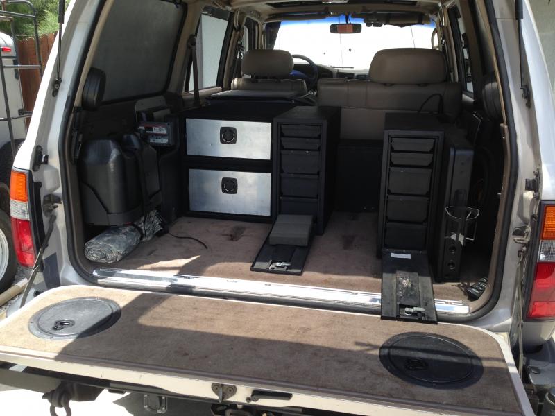

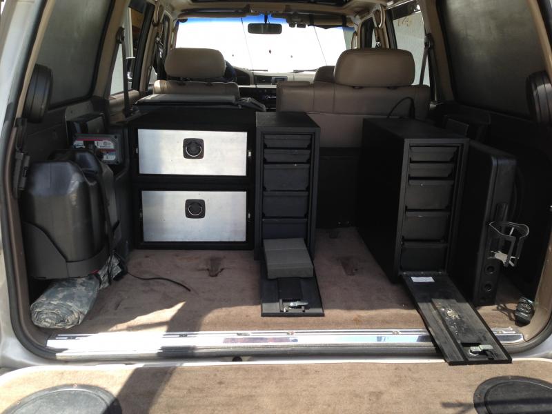

here is my rear storage for my 80...
By trapper50cal at 2011-02-13
By trapper50cal at 2011-02-05
WagonGear
and a Hanna Cargo Carrier that I fineggelled out of Corbet.

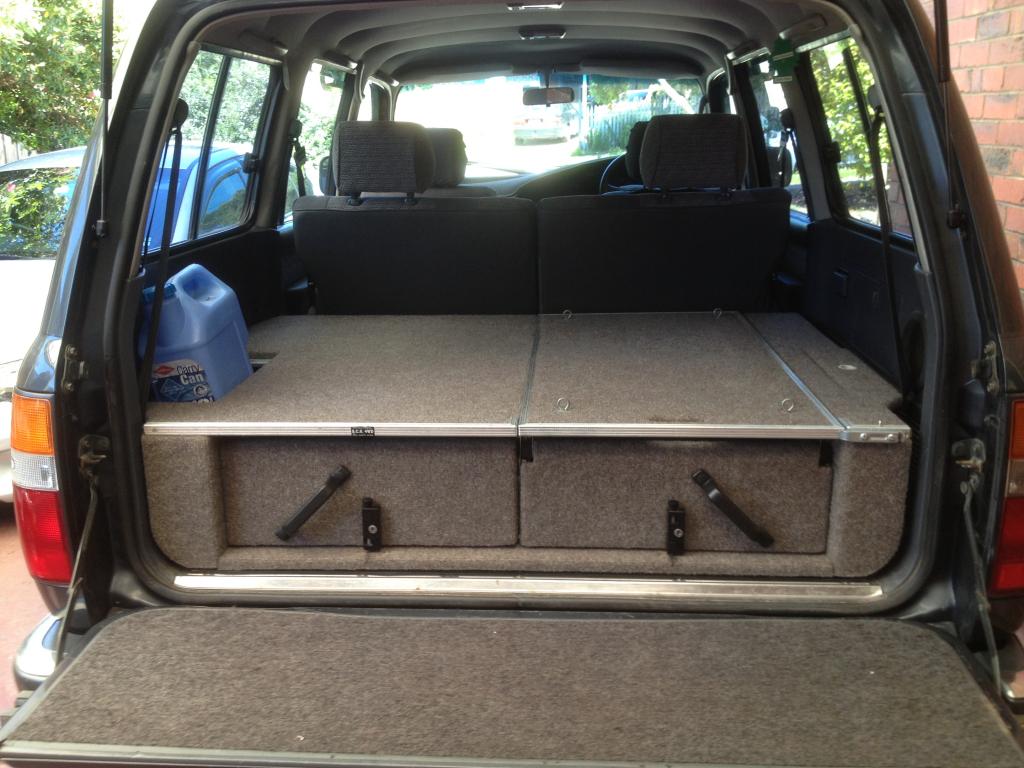

So I had some free time this weekend and decided to tackle my drawrs. I built it out of 5/8 Ply using PL and 1" brad nails.
:cheers:
Well done! And welcome to MUD! Just need a few more posts to get your picture image increased.
I really considered the top side access to the drawers when I did mine, but I don't have your skills with wood and decided that I would have better results if I kept it simple.

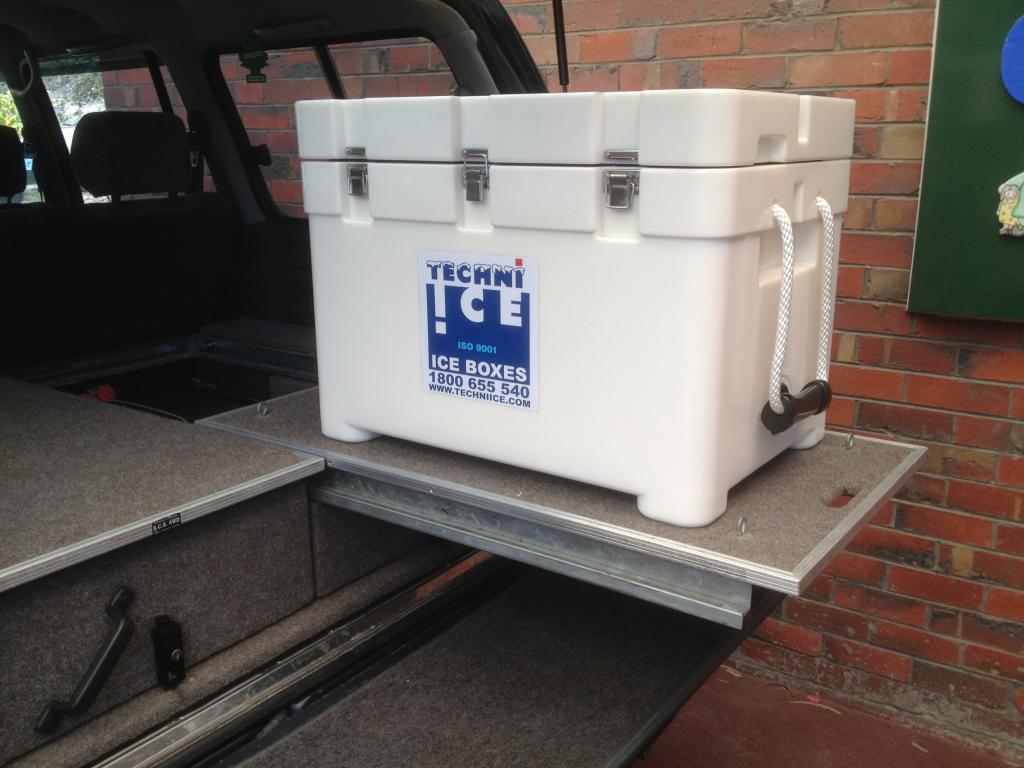

Here's my Outback drawer setup I got for a good price second hand - they are the old style (was in a 100 series so the sides are not exact but OK)
good to know 100 series drawers will fit in 80 series! will the second row of seats still close with the drawers in?
edit: scratch that last question because i see the second row up, i need to not ask things at 6am...
great idea the top access, why don't you hinge them from the centre so you can reach in thru the side windows?
didn't even cross my mind. good idea for the next time. my hinges are under the carpet now so no changing them without peeling it up. i figure i could get to it from the middle row if i really need in there.
It is a long reach to get to the center of your boxes through the side windows so it probably wouldn't be of much use anyway. For me it is enough of a reach to get in the side boxes from the windows.
Another question, which might be answered in your other pictures that I can't access from work, is how you secure the top access hatches? Seems like you would want something to keep those closed if something were to happen. Even a strap run across them might be enough it you have the tie downs for it and still easy to open.
Or even worse, not being able to.....
+1. Happened to a buddy of mine. He needed some recovery gear that was in the drawer, but was in a position that he couldn't open the rear hatch. Highly recommend top access or keep critical recovery gear in another easily accessible location.
