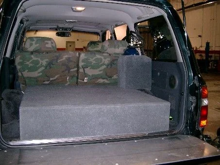

Ghetto version
Mine is made from 1/2 inch plywood and is covered in a carpet material that I sourced from our dashmat vendor. It is bolted to the floor utilizing the third row striker mounting holes. The slide-outs are Rubbermaid storage boxes with wheels on the bottom and are designed to slide under beds. The box is designed so that .30 and .50 caliber ammo cans can also be slid in....:D
Junk said:
Derek, That's an awesome write up. Out of curiosity, how long has it been on the net? Never seen it before.
I think I've posted it up here before maybe in another thread (I think I posted on CDan's Powertank thread). Most of the hits are from members of various 80sCool lists. Glad you guys enjoyed it!
.30 cal cans for the 5.56mm NATO, and .50 cal cans for the 7.62mm NATO, that's my distribution. Unfortunately, no .30-06 Springfield, as my Garand has been converted to the superior .30 cal round that's still actually in use by first world militaries... :D
lx450landcruiser said:
thats really cool.
quick question when u fold down your middl row is the hight of the box the same as the seat? or is it higher?
It's higher. I needed it tall enough to fit some of the stuff I put in there, which made it a bit too tall to line up with the seats (but not by much). My plan was to either throw a pillow or folded-up blanket on top of the seat back to make up the difference, or build another cargo box of the same height that would sit in front, where the second row seat would normally reside. For now I use the blanket method...

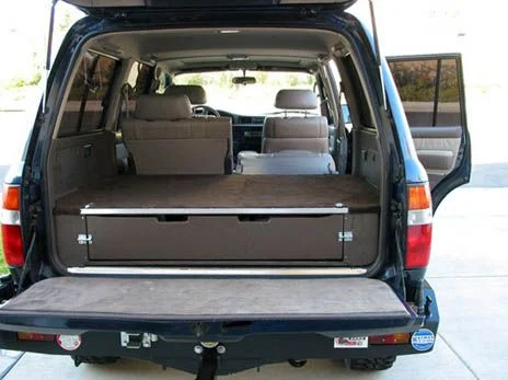

Custom Drawers
Here is my set-up which has saved me hours of loading/unpacking during trips! I'll give credit to Jim Brantley for the base design. I made a few minor additions that I thought was needed:
1) Fold-up flaps to make the entire platform flat ( this is a must if you have a dog in the back)
2) Cotter Pin setup (not shown) to index the drawer and keep it open when on a slanted hill. This also keeps the drawer from rolling out too far or closing.
3) Hand holds to open and close drawer without pinching fingers :eek:
Things I wish I added:
- top hatch for getting to gear that is inacessible when the back is stuck up against a tree or rock!
Derek by far has the best write-up. I used the same drawer slides everyone else uses, holds 500lbs, can't go wrong with that....
- Jasper

Hey Rockclimber,
When the wings of your drawer are folded down, what have you used to support them. Isee the pieces in back but, what about behind the second row seat? Also do you have a writeup? Aperfectly level surface is what I want to go with.
Buck
Jasper,
Please post more pictures if possible.
-B-
Buckru said:
Hey Rockclimber,
Buck
Just guessing, but it looks like the tops of the wheel wells are level w/ the bottom of the wings, so the wings probably rest on the wheel wells and that rear crossmember. Again, just guessing.
