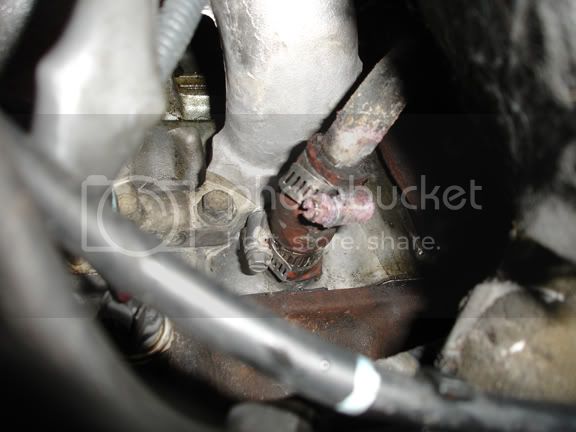

Silicone PHH kit w/ Constant Torque Clamps
Firewall Heater Hose (FHH) Gates Green Strip Kit w/Breeze sleeved clamps Water Pump

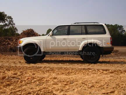

Poser shot

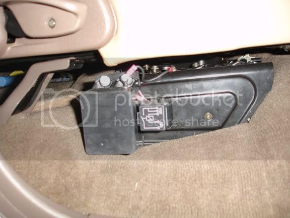

Painless fuse block under passenger seat per Slee
7 circuits, 4 ign switched 3 constant hot
