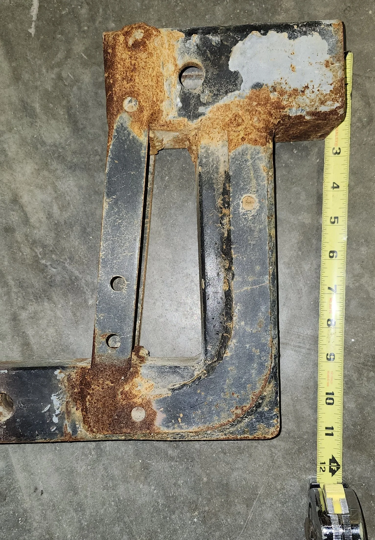

Yes I like the Pac Mule, it's a robust product, for sure. I got the one that fits a 200 series. I don't know if they still make them. I welded up my own adaptor so it would ride higher, yet still be able to drop the tailgate.

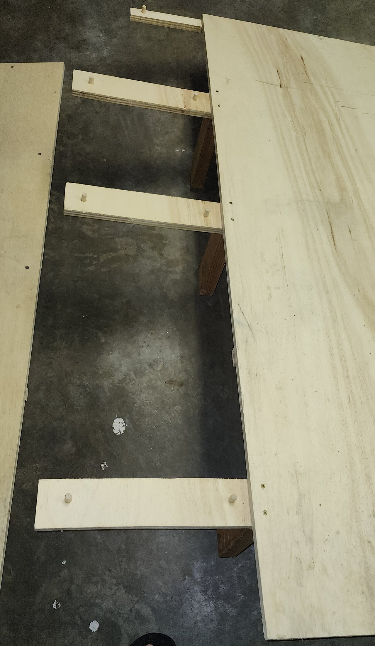

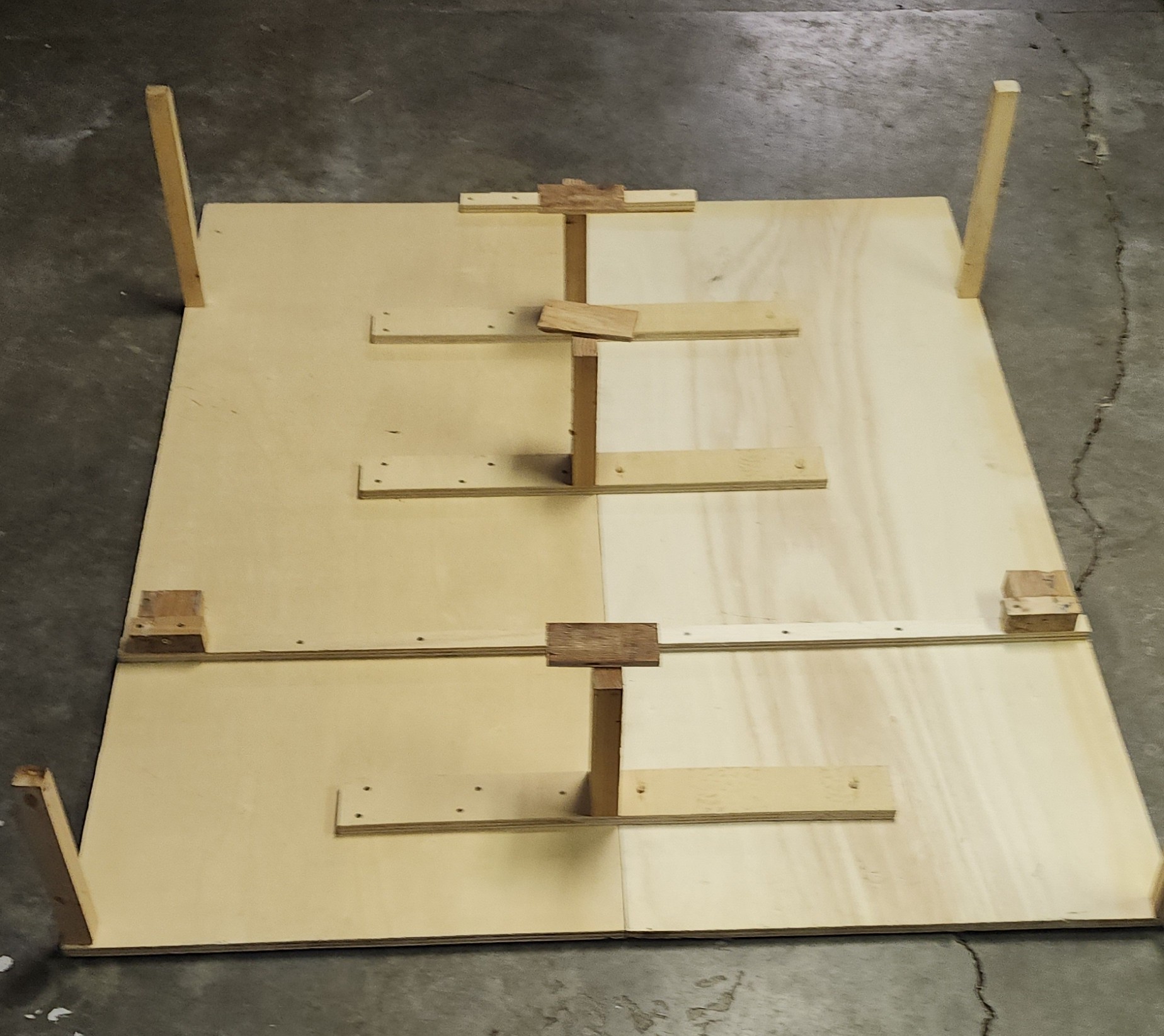

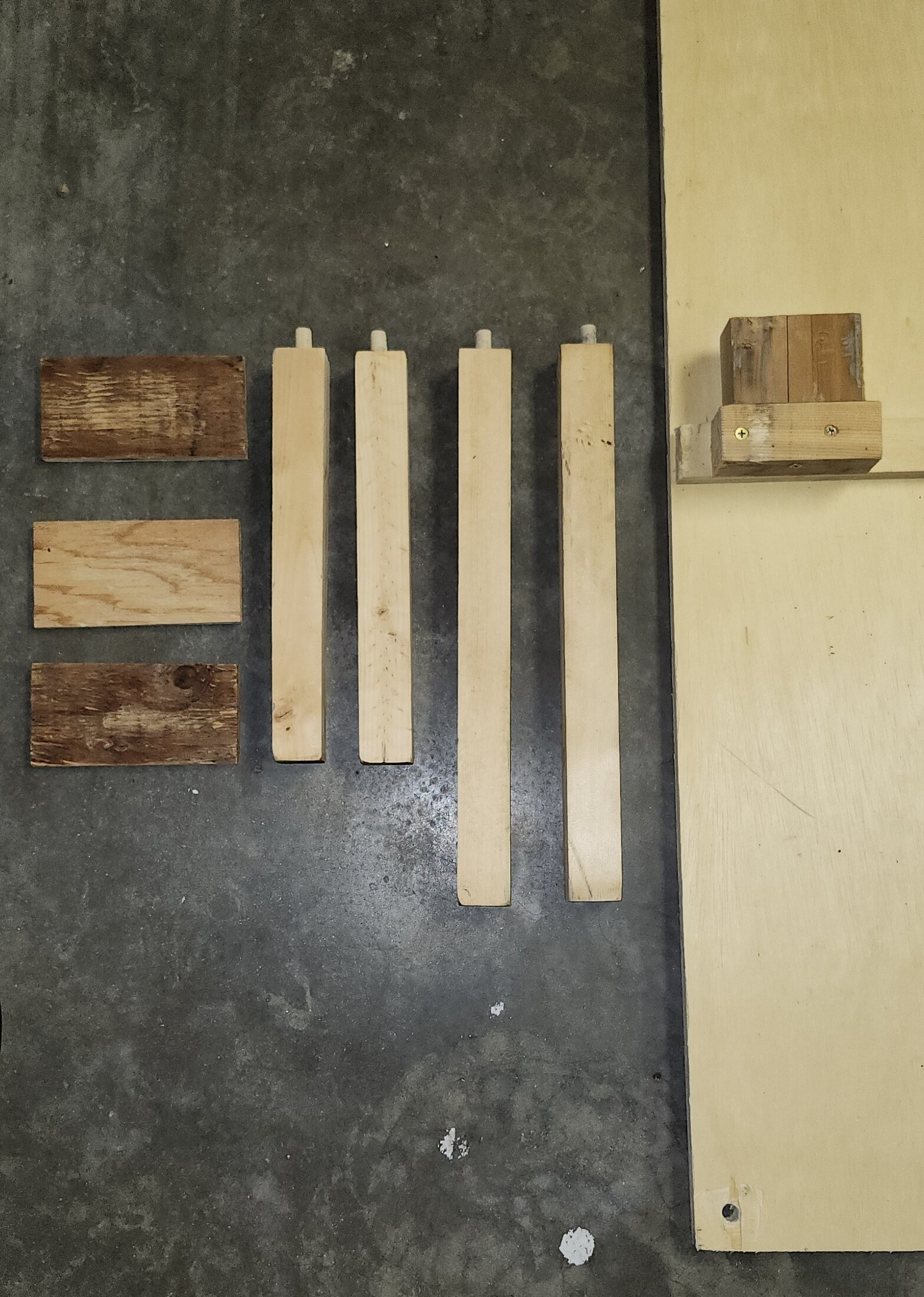

I made a 2 piece platform so I could install it and still be as large as possible: I used 3/4" plywood, I forgot what they call it, but, it's the finish type, and strong. (not cheap).
the two pieces are 68.5" x 27.5" The rear legs are 11" and the front ones sit on the steps in the passenger area, they are 14.75"
it's tricky to see in the photos, but each side has a wood piece that sits on the rear seat bracket in such a way to both hold up the side and keep it from wanting to slide forward.
I know the photo of trailer hitch to Pac Mule adaptor is rusty. I'll wire brush it, and paint it one of these days.

View attachment 3871304View attachment 3871305View attachment 3871306View attachment 3871307
Appreciate the pictures, this may be the route I end up going. Will probably end up with an overhead rack or drawer system eventually and just do like @SoTexCruiserDoc said and just break down my pumps and autos for hunting around the house.
