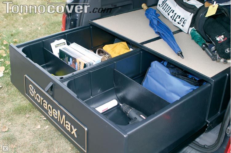

wow, those look very nice for $195
I was looking at those, but a max weight of 150lbs on top or crack.
I betcha ifya put something solid (3/4" plywood cut to fit) on top to distribute the weight it would take more to crack?!? Still I'd rather have the super sweet Outback Drawer stuff slee sells, that's the real deal but $$$.
