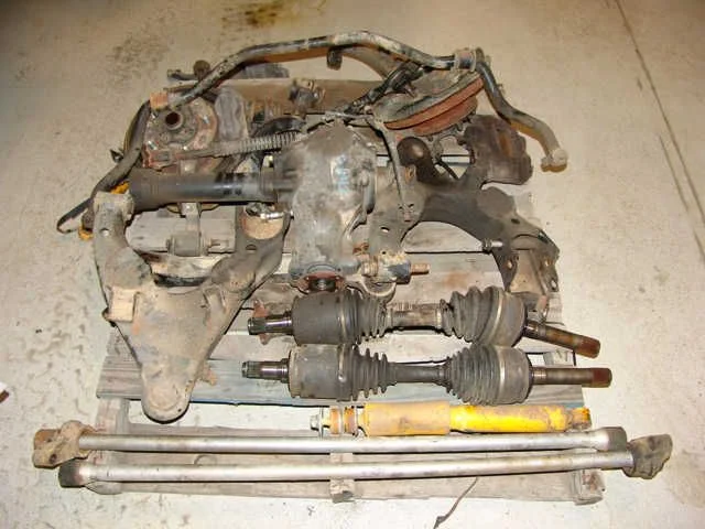

For those reading this, John and us had a conversation about this off-air so he know what he is getting in to. I am not advocating installing a part time kit to mask vibration issues, I am advocating it as a fix for a vibration that I can not diagnose without having the truck. If the truck drives great at 6" of lift without a front driveshaft, then we know we can install a part time kit and achieve the same results. I am not saying this is the correct way to go, but this is John's choice.
We do have this bunch of parts available to install if John sends his truck up here. It will make it drve just like a 100 series :D
Awesome "upgrade"!:D
