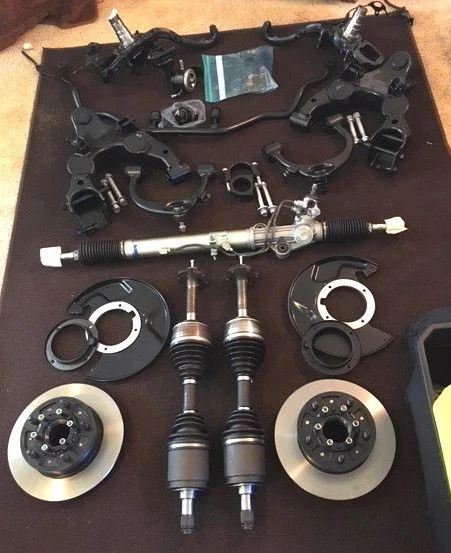

Yep, DIY if you have the time and are able.
Just did mine recently. (front end work)
