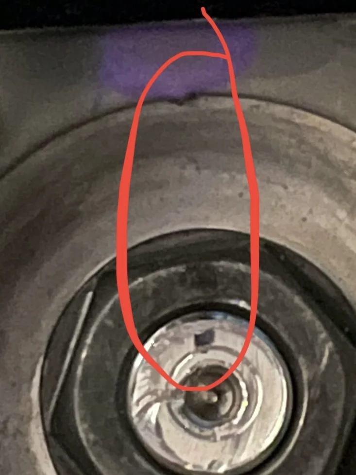

I installed the all leather wheel today and I swear the splines are not identical to the OEM wheel. I made my center mark and installed it, it seemed too far to the right when driving. So I came home and moved it one spline over and now it seems to be too far to the left. I needed an alignment before I did this so that muddies the water to be sure. The steering wheel locking at an angle also complicate things.
I will say that removing the wheel is extremely easy and can be done in 5 minutes flat and that’s using a steering wheel puller.
Now I just need to decide if I leave it as is and get the alignment or move it again…
The wheel is truly an upgrade over the wood one, no doubt.
The black mark on the post lines up with the one on the nut and the small point on the purple spot. I think I just need to leave it be and get the alignment.
That’s very interesting. Mine lined up to a T and is straight up and down while going down the road.
Likely an alignment will get this fixed.
I may put the old on one just for reference. I don’t drive it enough to really know exactly how it was before I yanked the original wheel, it’s been a week or more. I figured marking it would be enough but once the wheel moved to lock I had a feeling I was going to have trouble.
