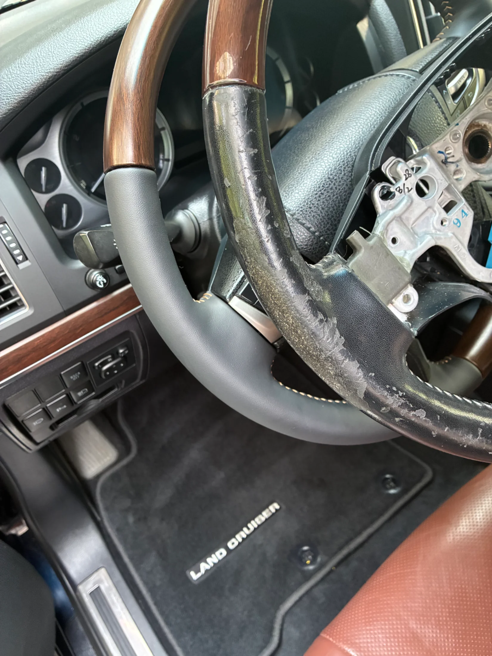

Maybe you’re right on the color change over time. The leather feels completely different (in a good way). So does the “wood”. Here’s the comparison. Look how trashed the old wheel is…I also don’t use lotion or sanitizer regularly.
Yep. The leather is the same color in the new one. Just don't have that patina yet. Same for the wood. Your old one looks like a perfect example of sanitizer/lotion use, seeing how much it is "chewed". If you are the only owner and never used any, I would say you got a really bad batch. The bronze stitching looks great with the terra interior.

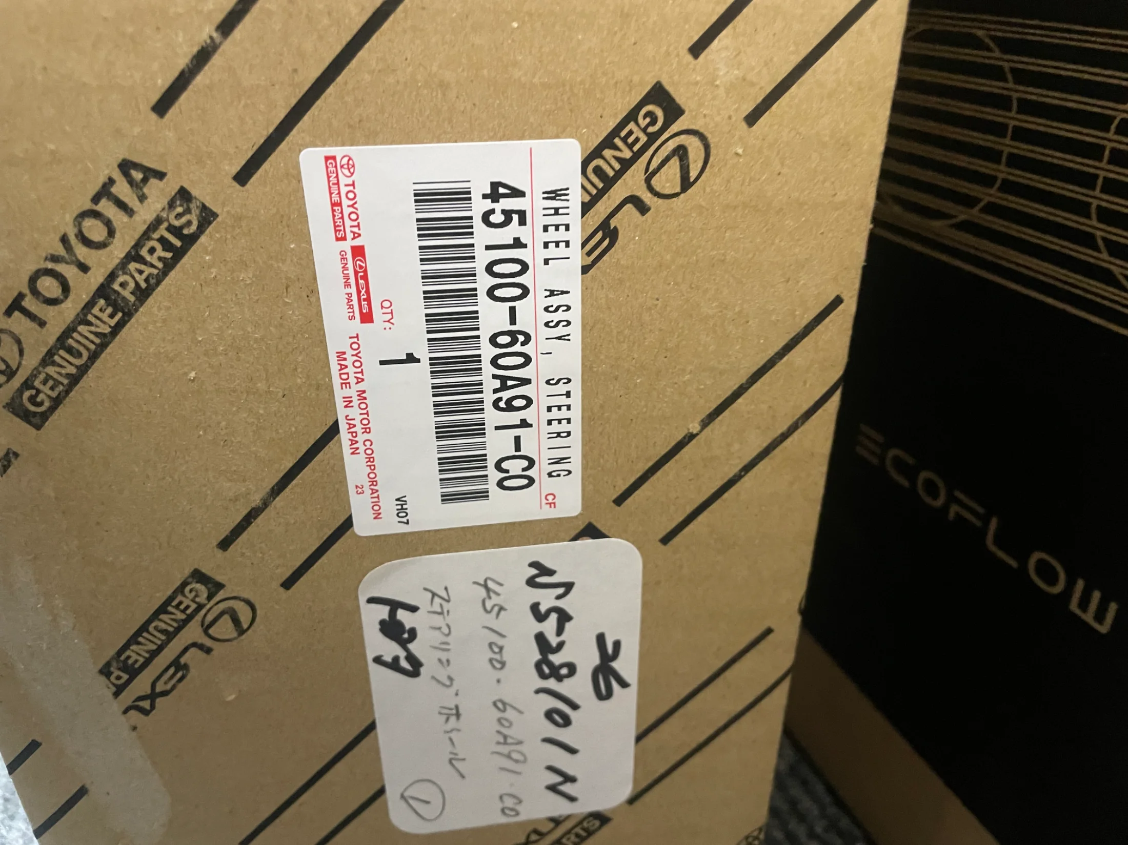

The 45100-60760-C3 is the replacement wheel that comes with the fake wood and the heater (what was sold stock in the States)
The one in the original post (45100-60A91-C0) is the heated wheel, but it’a fully leather wrapped (no wood)
Edit: Oh wait - it looks like the (45100-60A91-C0) is discontinued. You actually found the replacement version which is now (45100-60A90-C0). Thanks for doing that.
It says black and grey, but it’s black leather with grey stitching. :)
