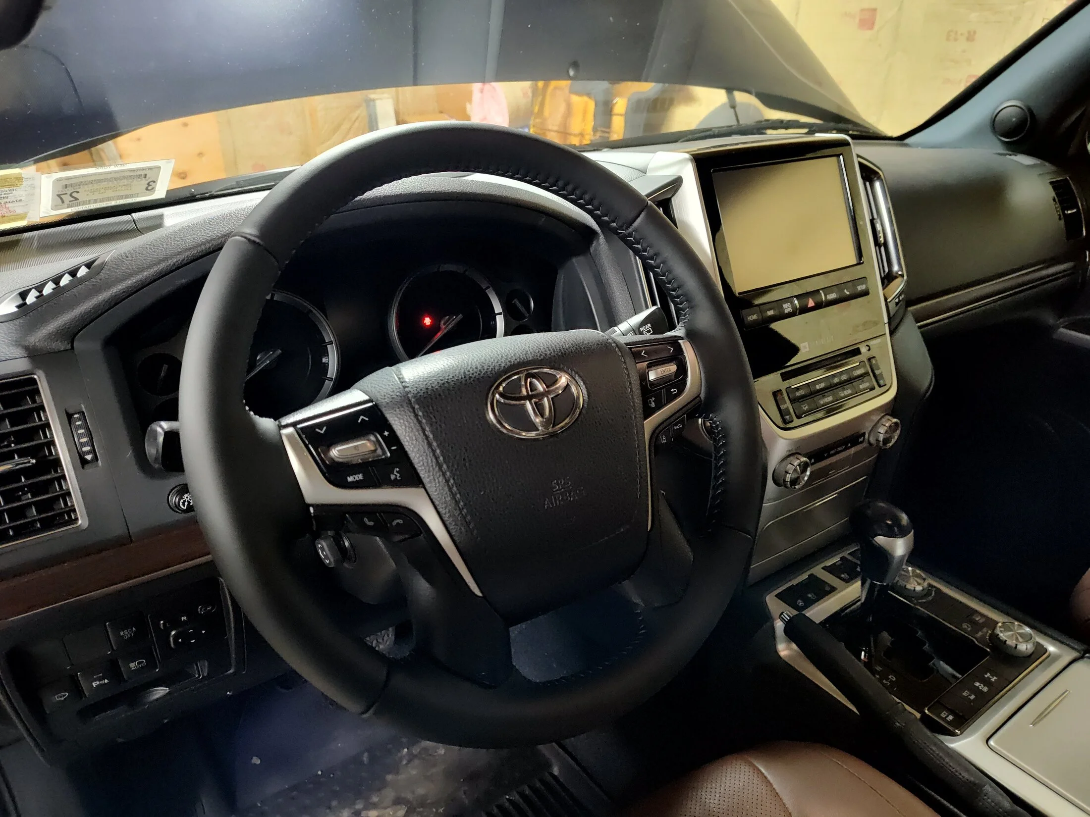

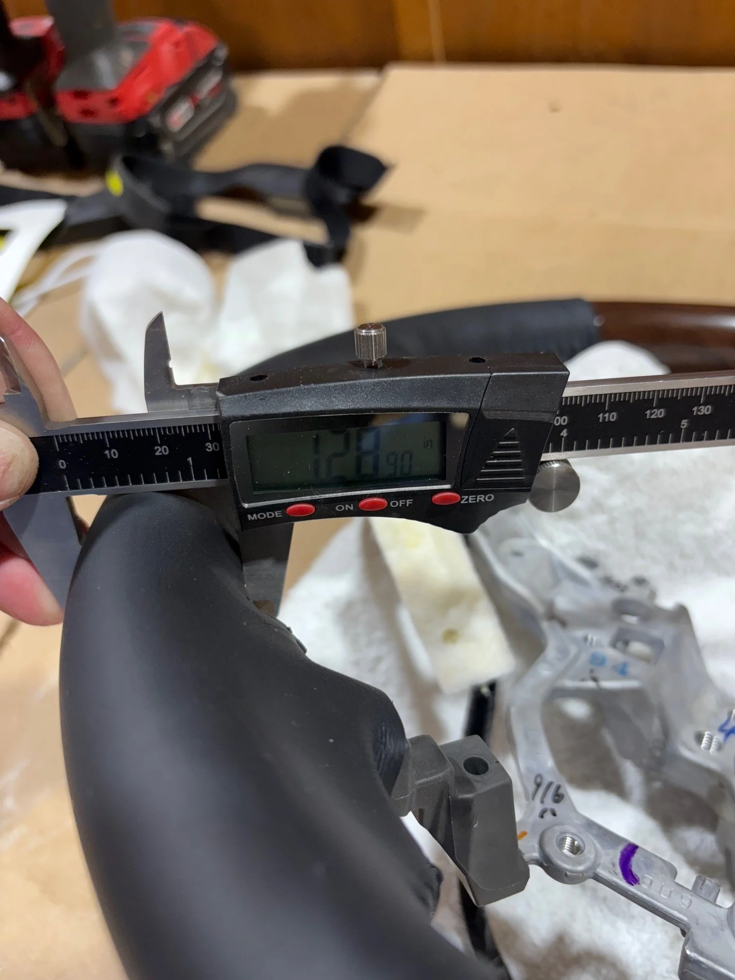

I received my steering wheel back from Craft Customs yesterday. As mentioned earlier, they are not able to remove the OEM leather without removing the heating element in/under the OEM leather. My options were to have Craft Customs remove the OEM leather and replace with new, thus losing the heat function, or have Craft Customs wrap new leather over the OEM leather and retain the heat function. I chose the latter.
Below are before and after photos of my steering wheel. I didn't measure the OEM leather thickness as I didn't realize it couldn't be removed without removing the heat function until after I had shipped my wheel. The heat function still works and the heat is noticeable through the additional layer of leather. It's tough to compare the effectiveness of the heat as all I have to compare to is using the steering wheel heat several months ago. I don't like the leather "lips" where the leather meets the wood.

I see what you mean in regards to the lips at the wood trim, that would pester me as well.
Other than that, what are your thoughts on the quality of the leather compared to the wheel when it was stock? Having just installed the full leather OEM wheel replacing the OEM HE wheel I feel like it was a upgrade in quality and feel over the wood trimmed HE wheel.

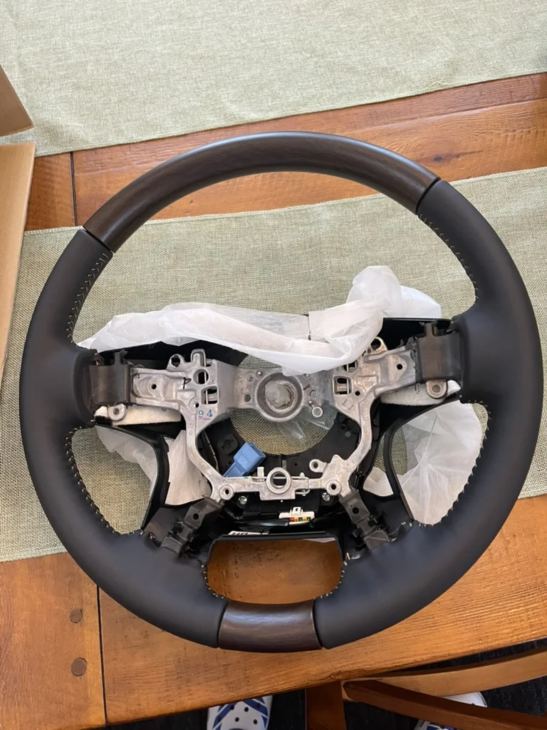

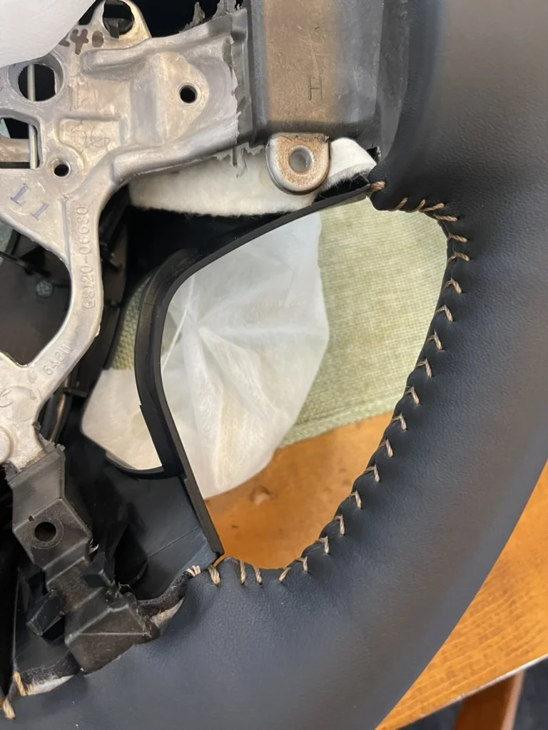

OK, HE guys. I followed @dnh1 advice (thanks a bunch man) and emailed Lincoln. Let me tell you, the guy is awesome and help me a ton. We were finally able to pinpoint the part number for the OEM Heritage Edition Wheel with the bronze stitching. Pasting a picture below of the number and of the wheel I received today. It is so nice, that I am now questioning if I should install it or abuse mine a bit more (since it is not that bad) and wait a couple more years. Now, note that when you plug that PN in the system, it will say "black and ivory" in the description. That threw me off, but when Lincoln sent me a pic of the actual wheel, it was the right one. If anyone wants to buy too, I suggest sending him an email and confirming the right PN with a pic. Good luck on the hunt.
View attachment 3885929View attachment 3885931View attachment 3885932View attachment 3885934
God that looks good.
