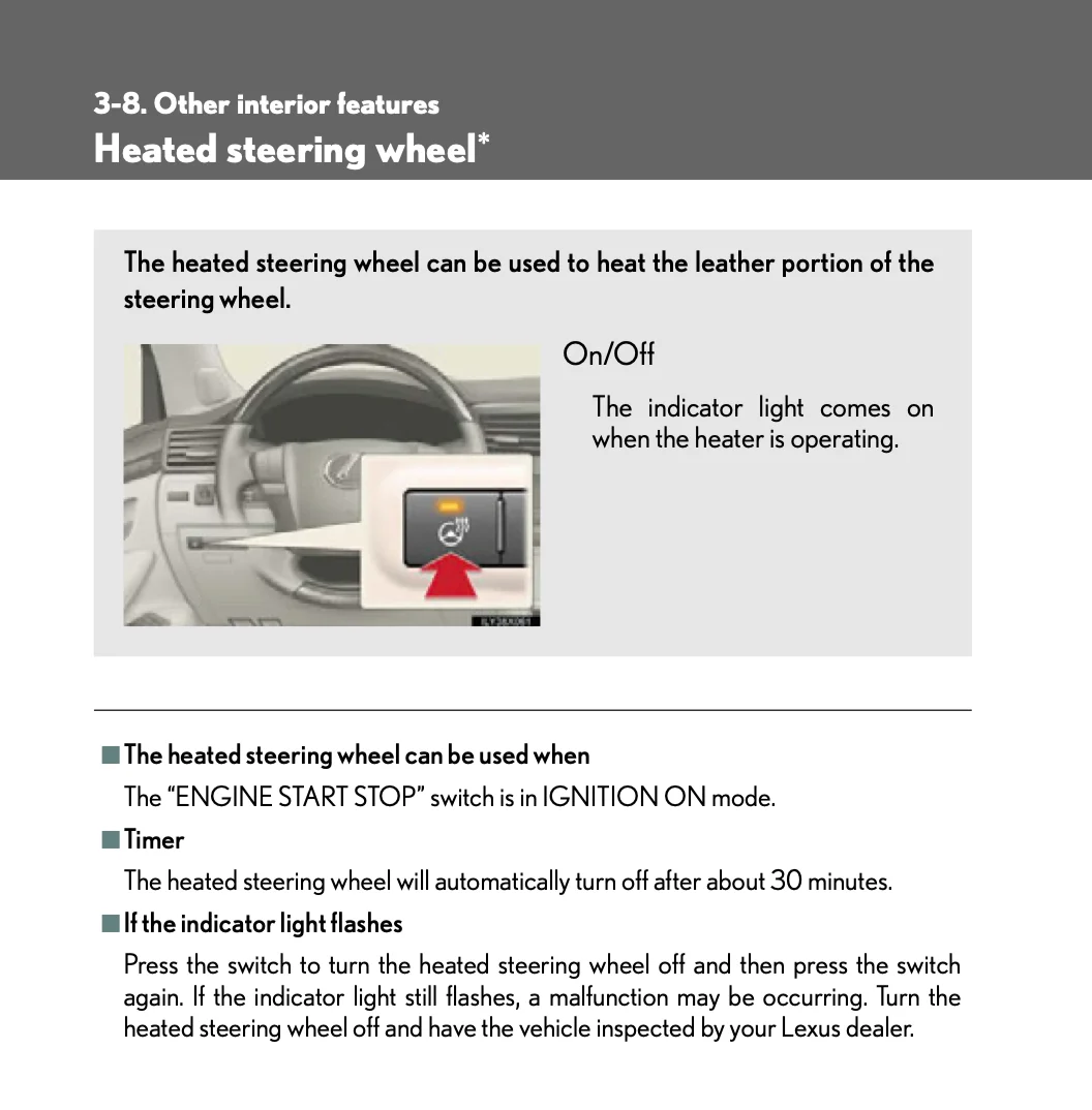

Ah thats a relief. It was bugging me that I perceived something as non-functional. Although, I don't see it in the PDF version of the manual.
I may be wrong, but I remember it from somewhere... Can anyone else confirm?
