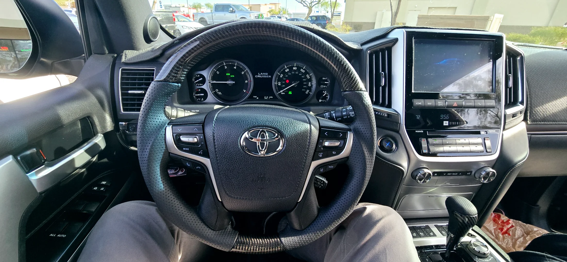

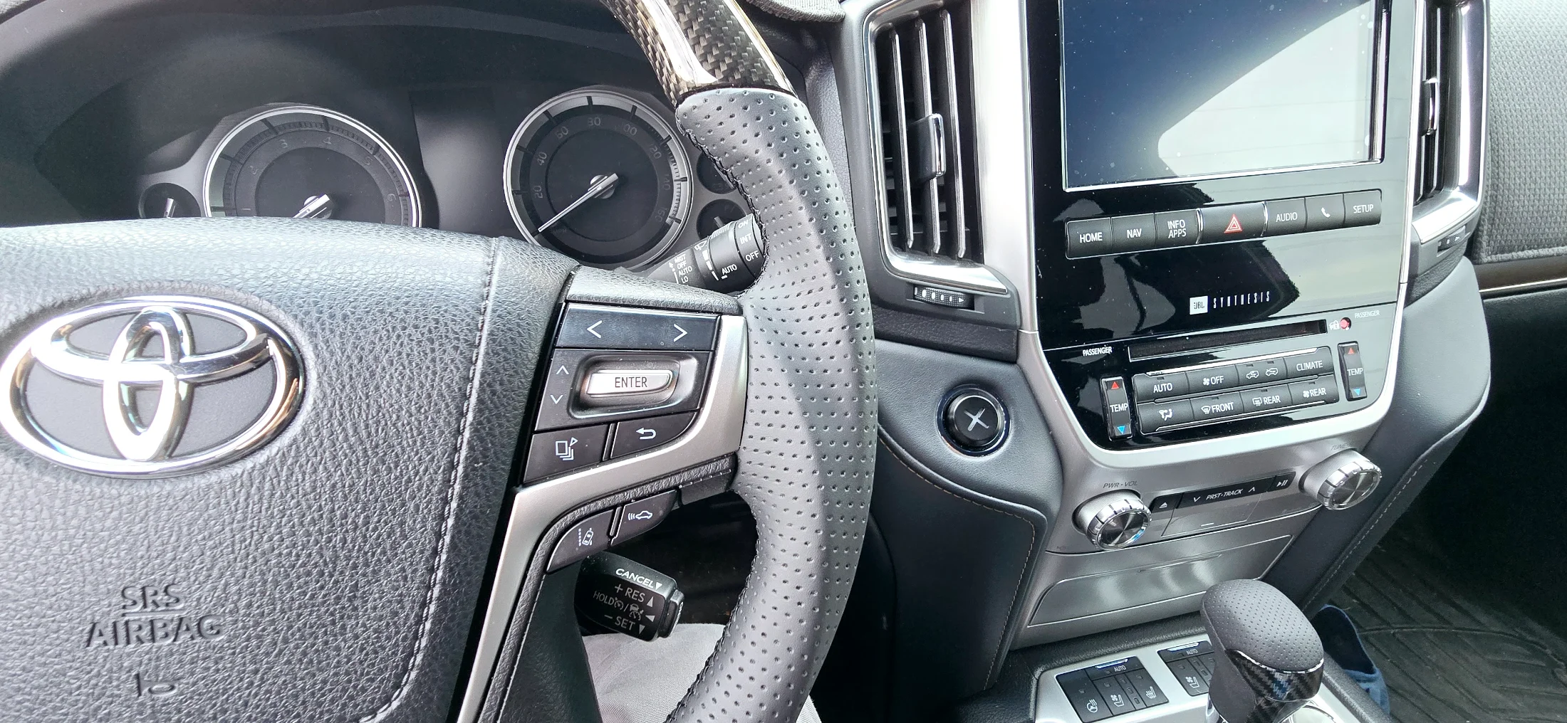

My 2020HE factory steering wheel looked near new when I changed it out at around 50,000 miles. I only did that because I wanted a new sportier look with carbon fiber. I sourced a Japanaese manufactured steering wheel thru a Japanese aftermarket vendor. No heating element, but I very rarely used the feature on the factory wheel.

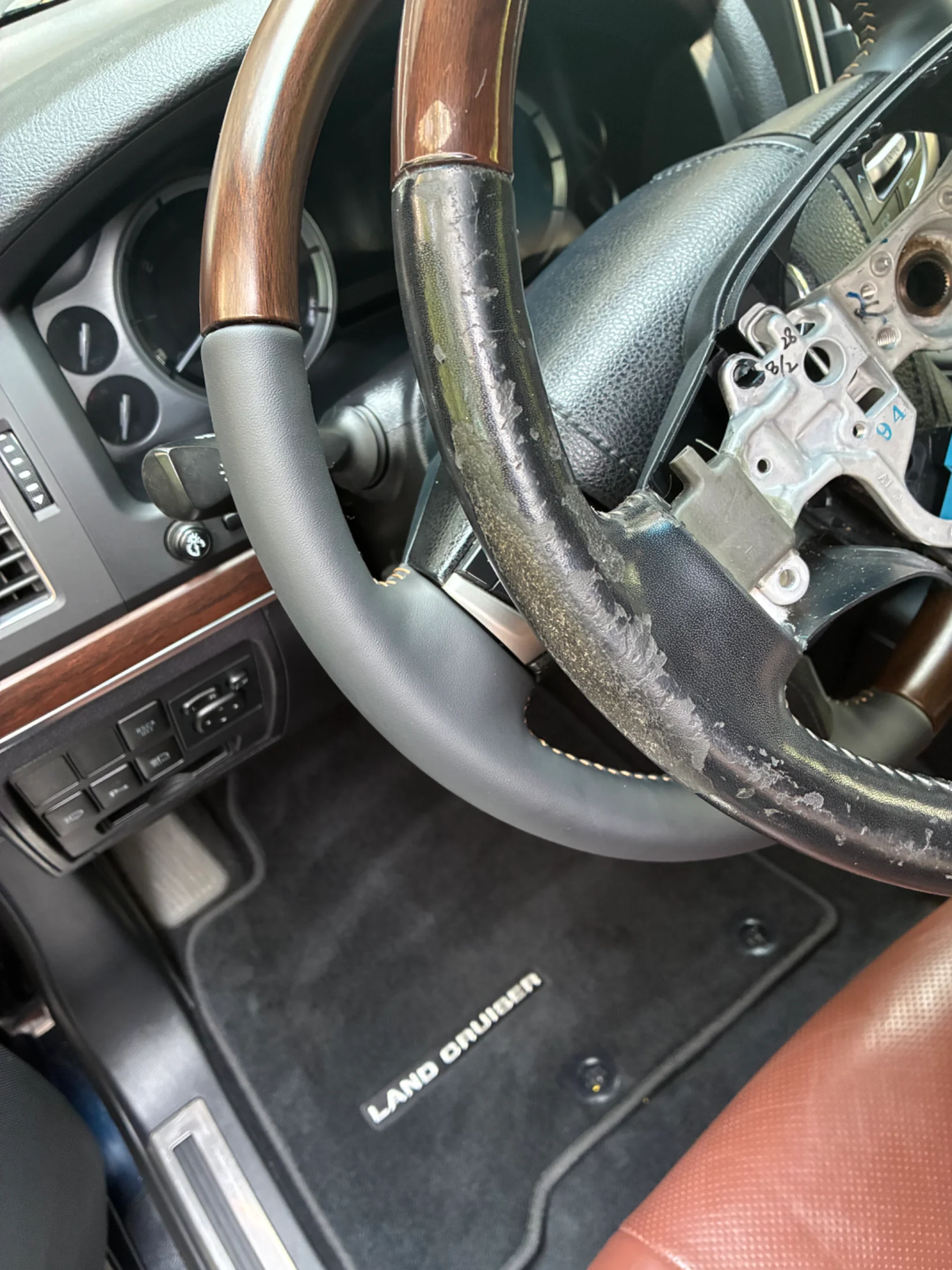

Maybe you’re right on the color change over time. The leather feels completely different (in a good way). So does the “wood”. Here’s the comparison. Look how trashed the old wheel is…I also don’t use lotion or sanitizer regularly.
Wowzers
Did they change the leather on different years?
My clapped out 2010 relic with 222k on it, the leather on the wheel is still flawless
