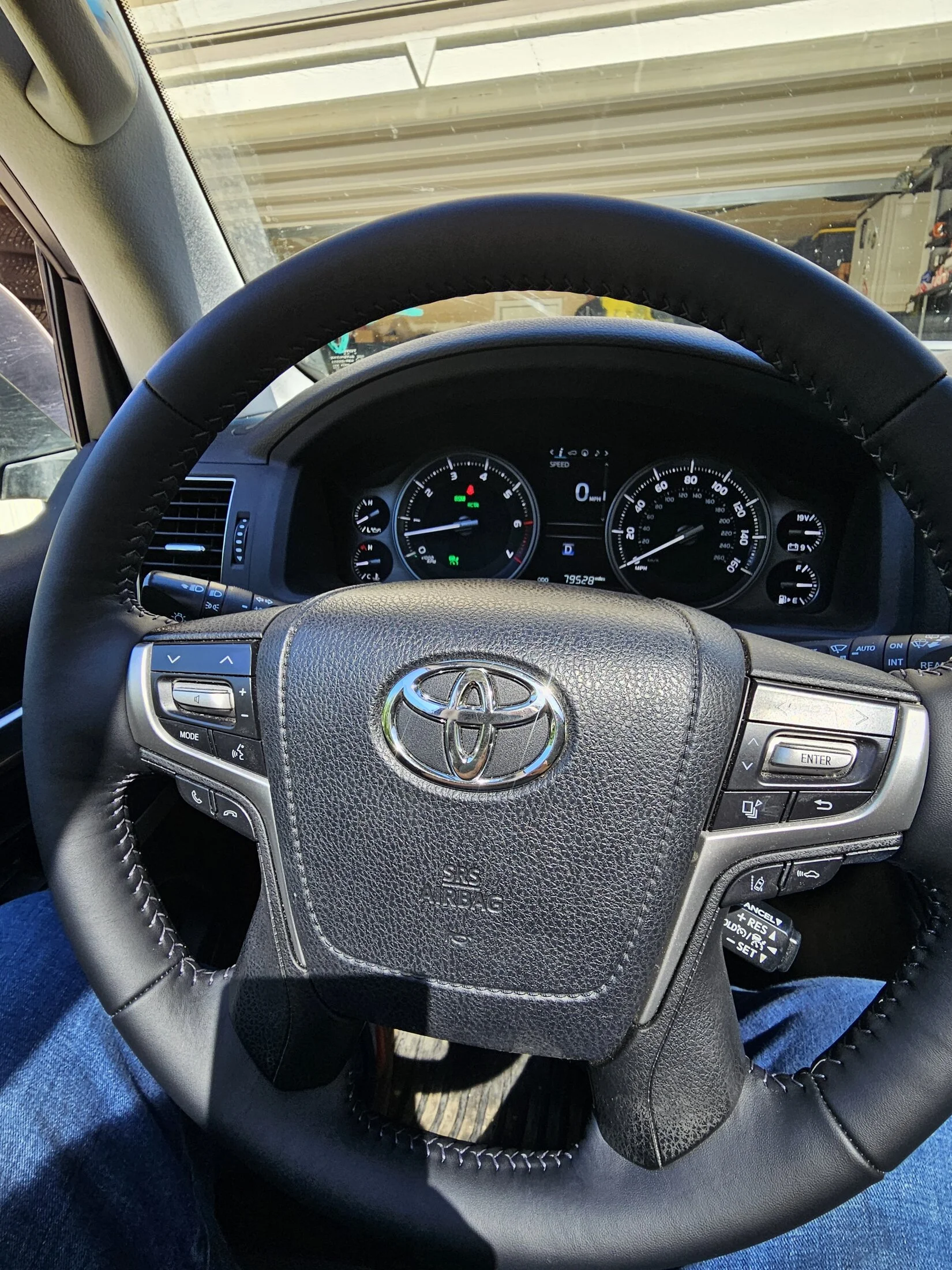

I purchased a 2016 land cruiser which had some nicks on the steering wheel from the previous user. It wasn't the infamous peeling problem found on the 16-17 wheels, but it appears to be some nicks from a wedding ring on the left hand. I did wrap the original wheel with a loncky steering wheel wrap, but I was not a fan of how thick it made the wheel feel.
Since the steering wheel is the one item you are constantly using while driving, I thought it was worth the $750 to purchase a new wheel. Turns out, it appears in 2020 Mr. T released a full leather wrapped wheel w/ a heating element.
Part: 45100-60A91-C0
The part is a plug and play item with no additional modifications being necessary, and boy, is it a treat with a HUGE upgrade in feel. This is the steering wheel Toyota should have shipped from the factory.
I was hoping the wheel would be heated all the way around, but it's only in the same area as the plastic wood wheel. Though, it appears the heat is MUCH better than the old 7 year old wheel, so I'll take the win on that one. I am unsure if it's due to the wheel being 7 years old or if it's a different heating element.
It does have gray stitching on the wheel (which honestly looks completely fine), but I could not find one that was fully leather wrapped with black/white stitching and had the heated function.
I used this video to help replace the wheel:
The guide is fairly helpful, but I would add some pointers which weren't covered in the video:
1: First step is to undo the battery to minimize the chance of an airbag deployment.
2. Ensure the steering wheel is straight up and down with your tires pointed straight forward.
3. After undoing the steering wheel nut (19 mm), turn the steering wheel to one side (1-2 degrees) to lock it and remove the slack in the wheel, then use a sharpie or paint marker to mark where the steering wheel shaft mates with the old steering wheel. After removing the wheel, do your best to eye ball and transfer the paint mark to the new wheel. Then simply turn the steering wheel to the same lock position and line up the paint lines while installing the new wheel. (this is to ensure the new wheel isn't cockeyed when going straight down the road)
4. I would advise getting a steering wheel puller to avoid damaging the expensive steering link assembly. I used a cheap harbor freight special which did the trick. Steering Wheel Remover Set - https://www.harborfreight.com/steering-wheel-remover-set-63685.html
This job took around 45 minutes and is a fairly easy install. I would not be intimidated about this job at all after doing it.

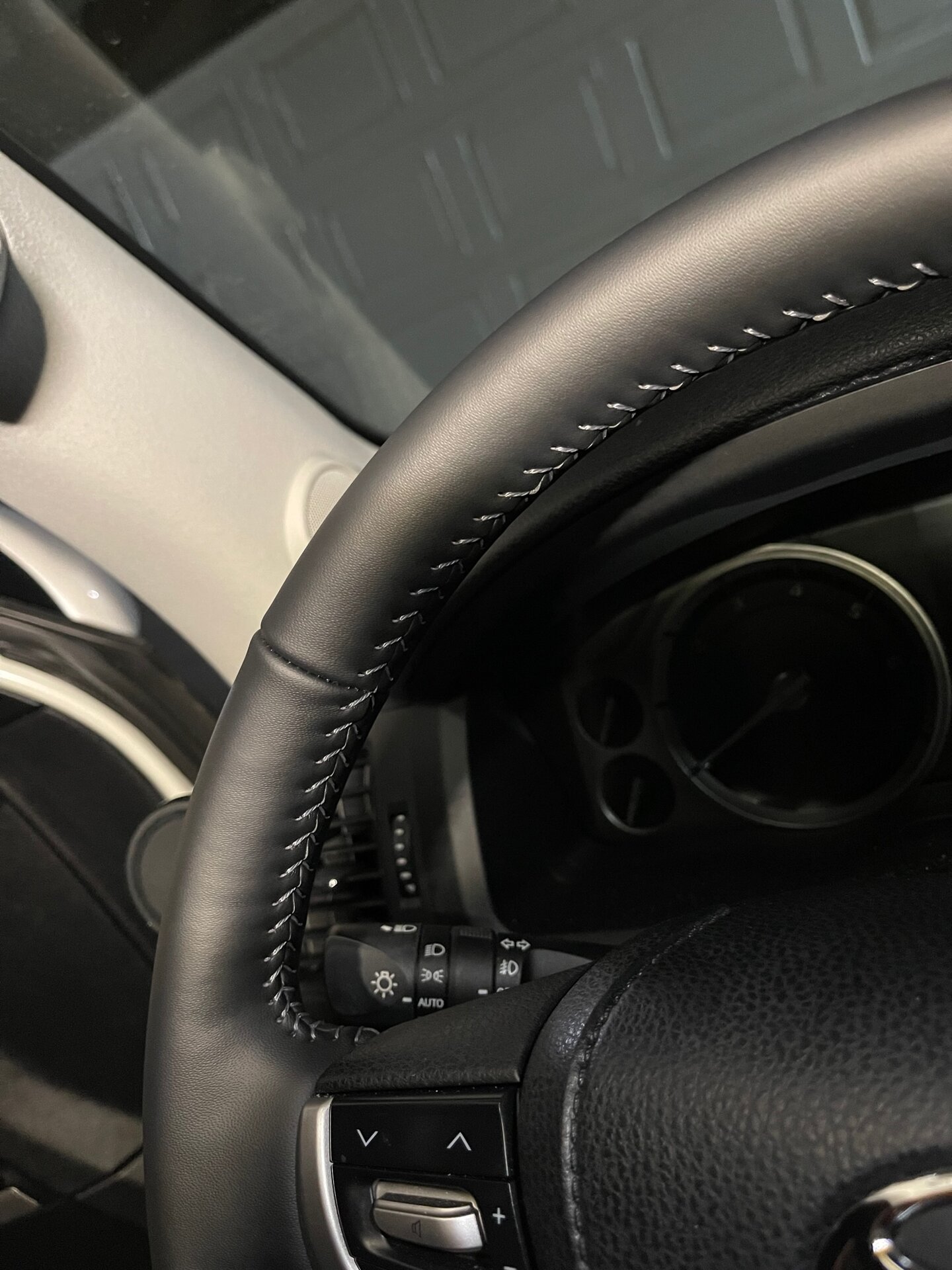

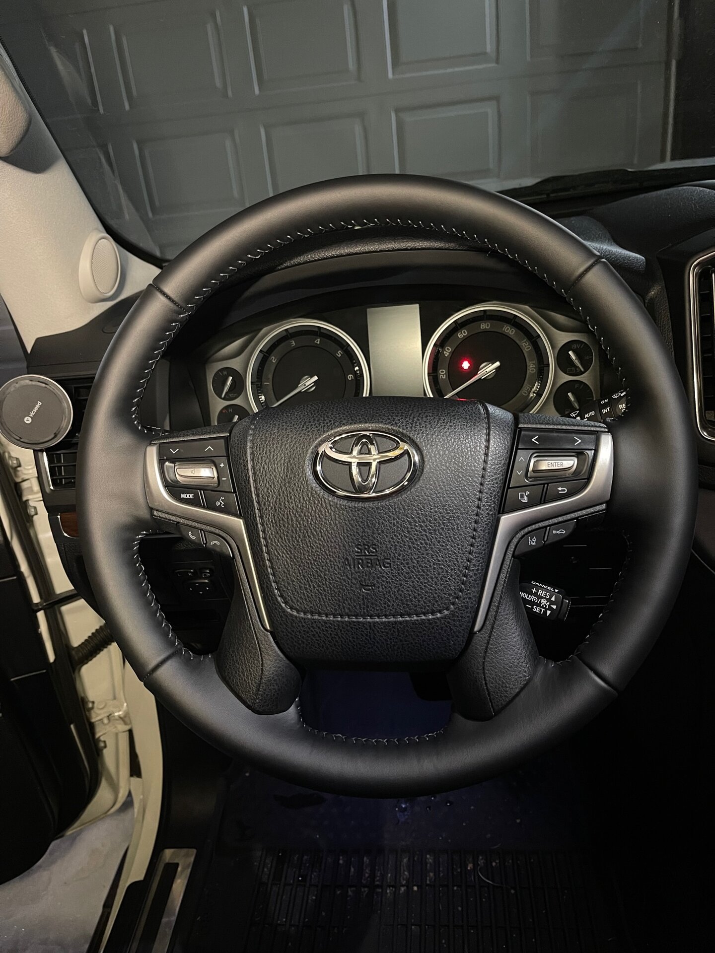

One of the best upgrades. Took a total of 20 minutes to R&R.
The leather on the new wheel feels more supple and high quality. It actually feels like leather. And getting rid of some of the faux wood is a bonus.
Love this look! I wonder what it would cost to have this wheel restitched with a bronze thread to match the HE stitching?
