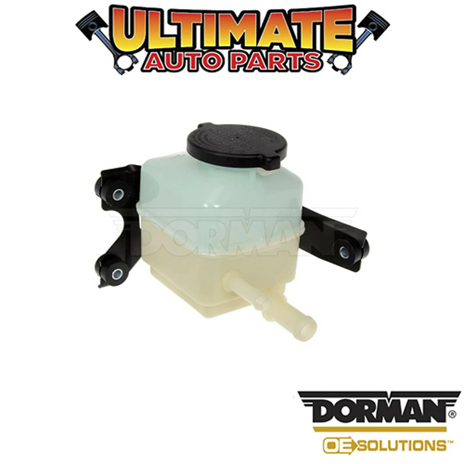

For those of us who are too lazy to clean these out, has anyone actually tried swapping the reservoir from a Camry (92-01) or RX300 (2000-2003 I think)? The actual reservoir looks identical and the bracket even looks like the same bracket, just in a different configuration. I can't imagine Toyota would make multiple different versions of this reservoir with each one being just a bit different.
There are a couple wrecked RX's and Camry's near me that I might go pull the reservoir out of to see if it fits. If it does, then you could probably order this Dorman off eBay for $86?

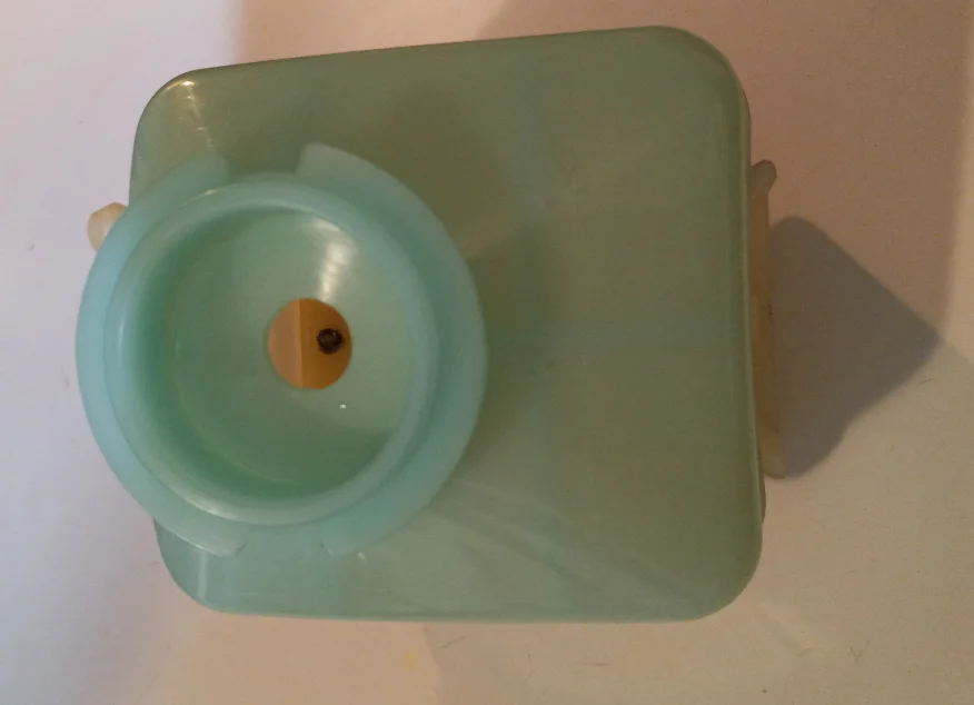

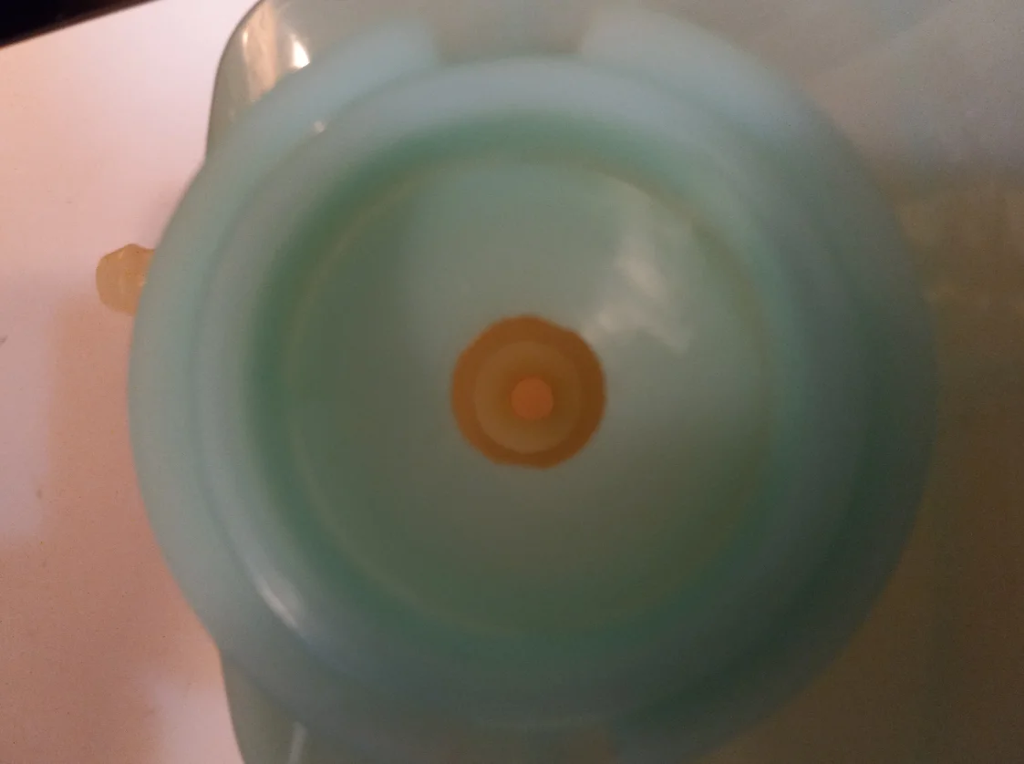

I may have found the issue. Need someone to confirm there is a micro screen in the reservoir that is less than the size of a dime. I can see how that screen would have been filled up with gunk.

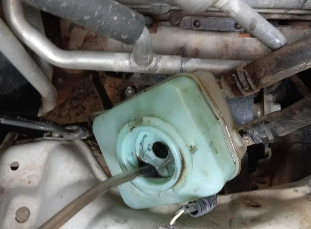

I evacuated fluid from the reservoir using my MitiVac extractor. That kept the mess to a minimum when I removed the hoses.
Some of the gunky fluid is shown in the reservior neck.
When I dumped out the fluid in the reservior bottom, it looks horrible. I can see why the pump is screaming.
Not pictured, I ran the extractor tube down inside the hoses to remove as much fluid as possible. I retreived a decent amount of fluid from each hose.

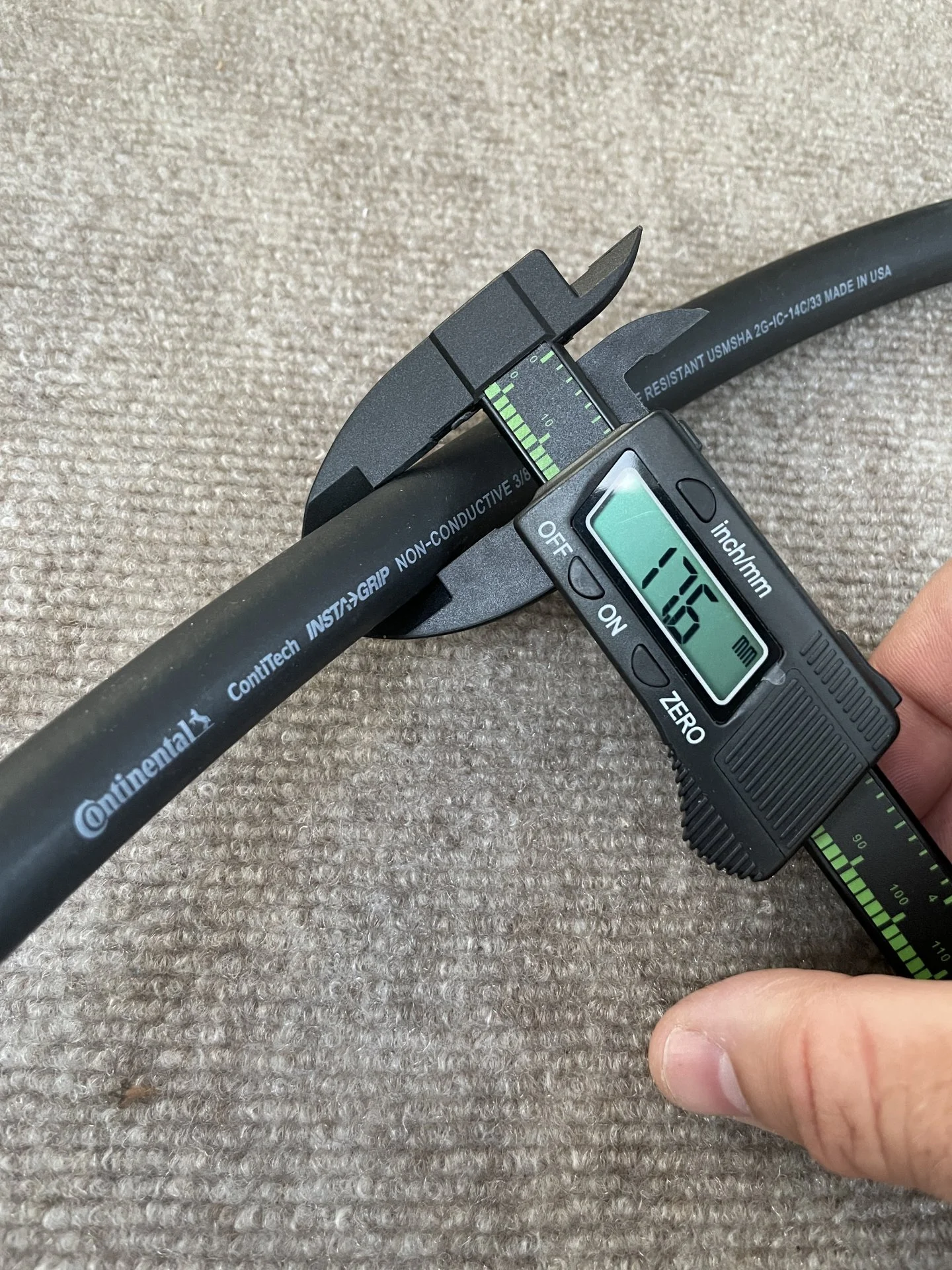

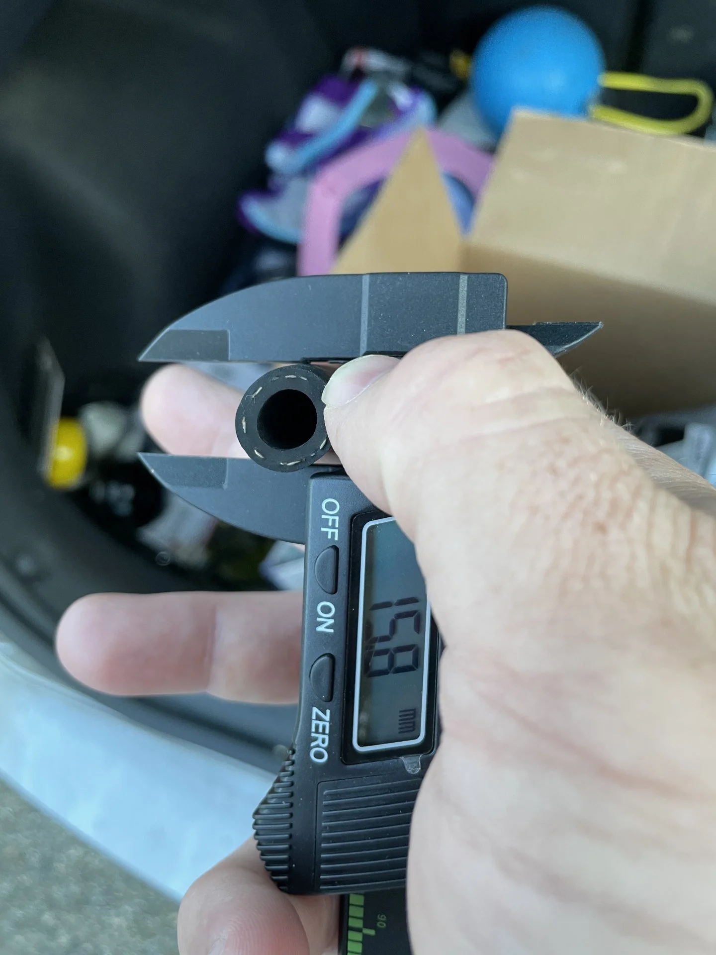

UPDATE! Don’t buy this hose from AutoZone. The outer diameter is too small.
I couldn’t find anywhere local to source the Continental 3/8 hose but I did find a source online that shipped me 3 feet for $17.
I would have bought from Wits End but he was out of stock. Going to hopefully get this replaced and flushed tonight or tomorrow.

After cleaning, I was able to photograph the inside of the reservior. I suspect the small round object inside contains the micro filter.
There is also a little black port on the front and side. Those appear to allow some level of fluid travel between the reservior and the hose.
