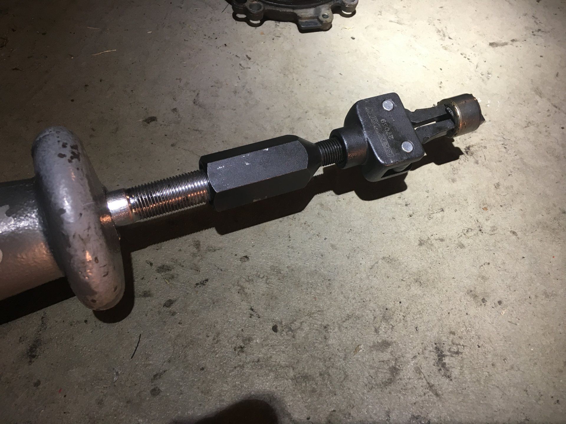

Right now I’m trying to get the clutch back in my Audi so I can pull the cruiser into the garage to wrench on it. Just got the old pilot bearing out.
