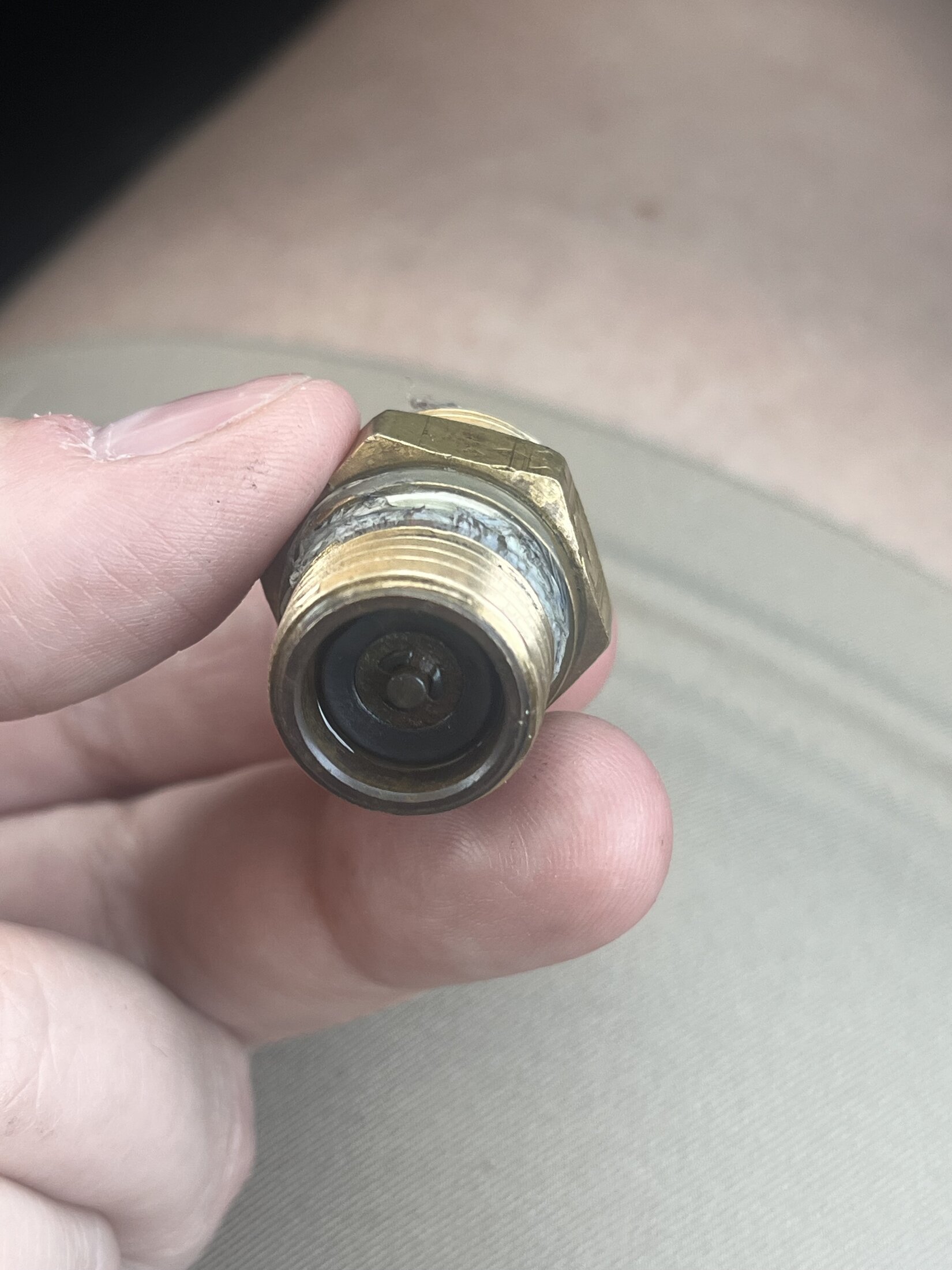

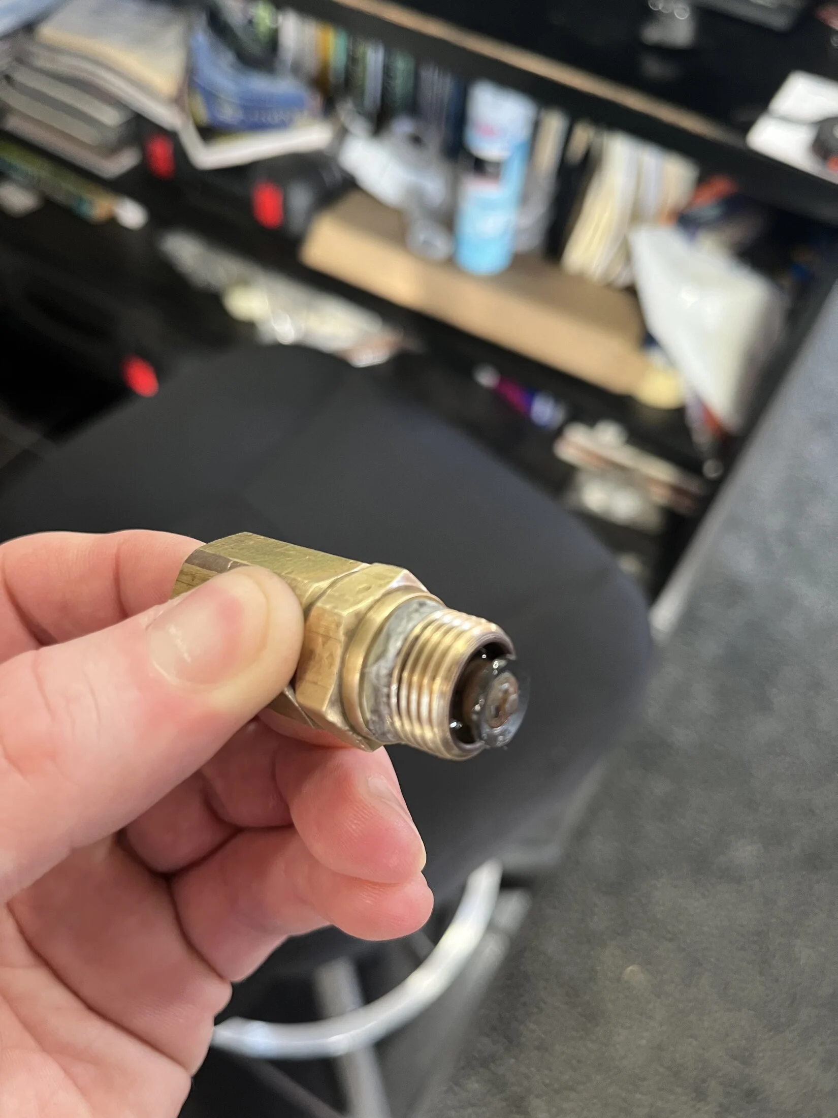

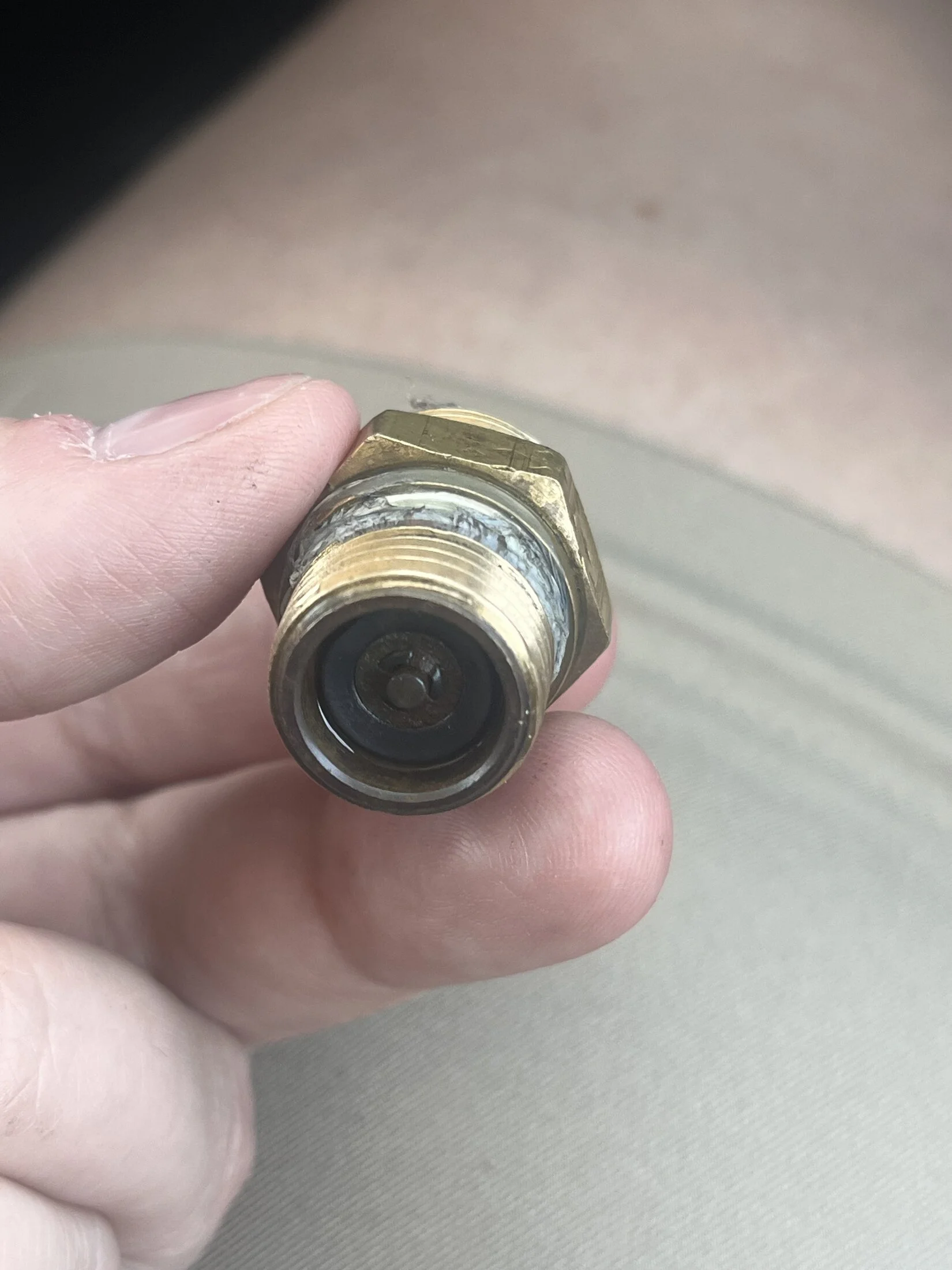

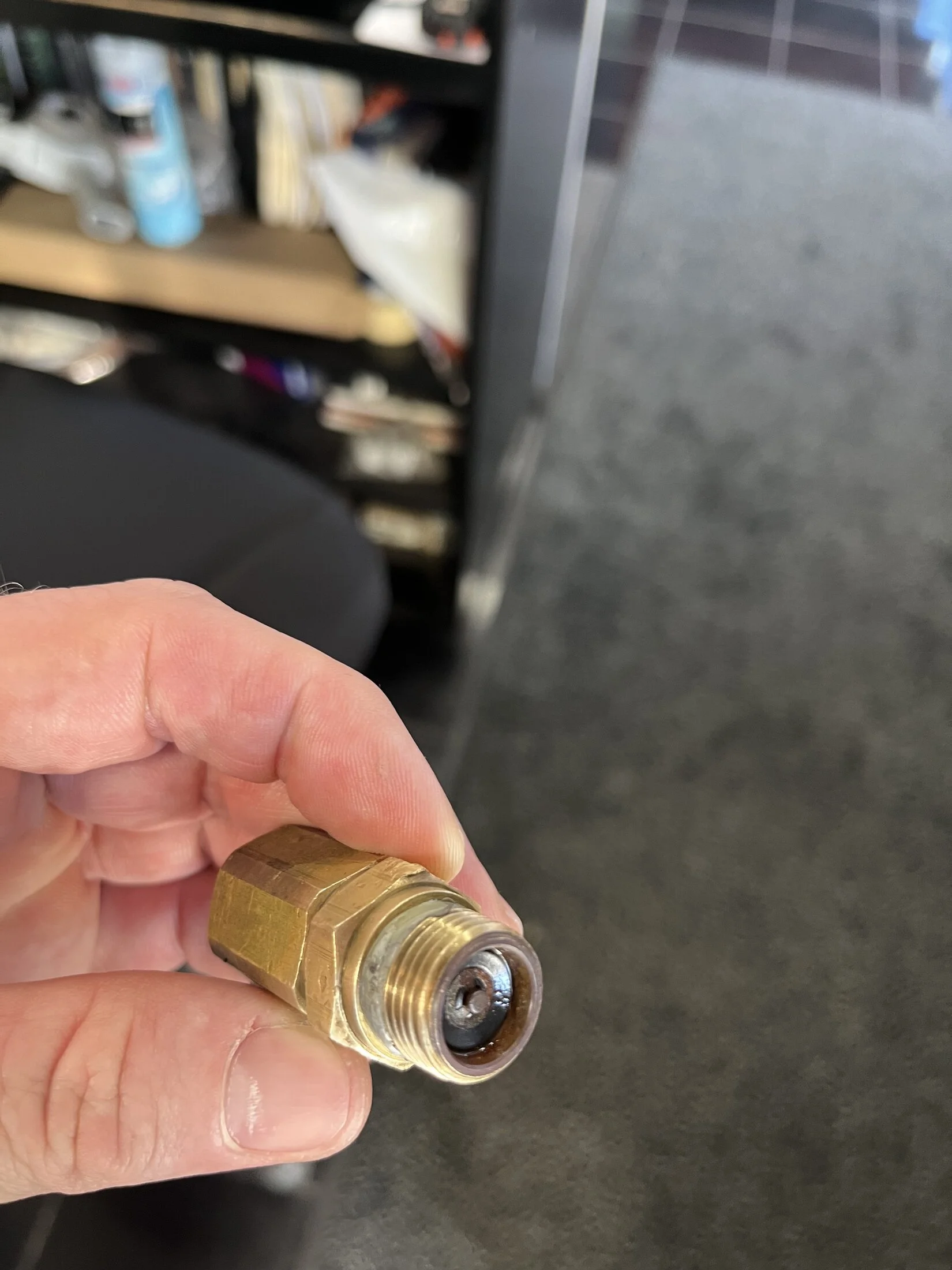

Came off the Wits End air system manifold.
It’s got a small pin hole on the main tightening facet that is constantly spewing air, not allowing my rear tank to fill.
Hopefully someone can help ID this part.

I used image search with Google Lens. It is a check valve for air compressors/ pneumatic systems.

I also google images it, numerous types of valves appeared, but nothing was specific.
If anyone knows for sure, a part number or link to a site would be amazing.

I would email those pictures to pneumatic part stores and see if they can ID it. They can help you better than a car enthusiast forum

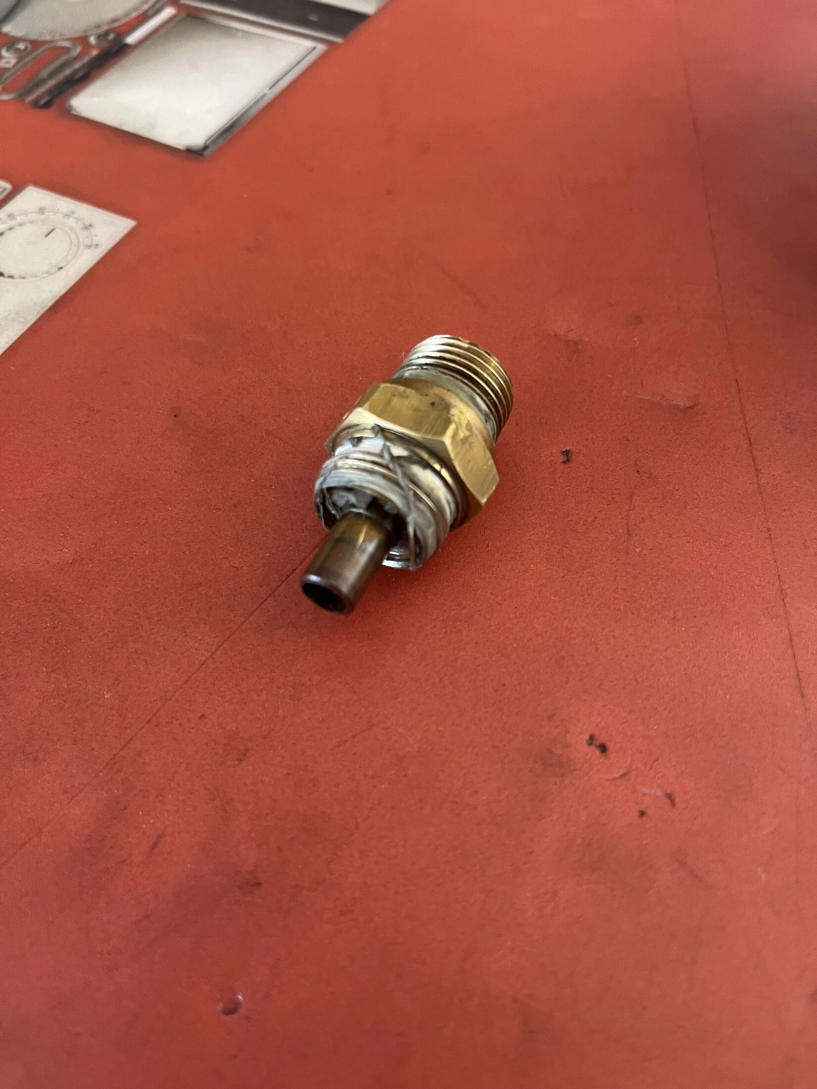

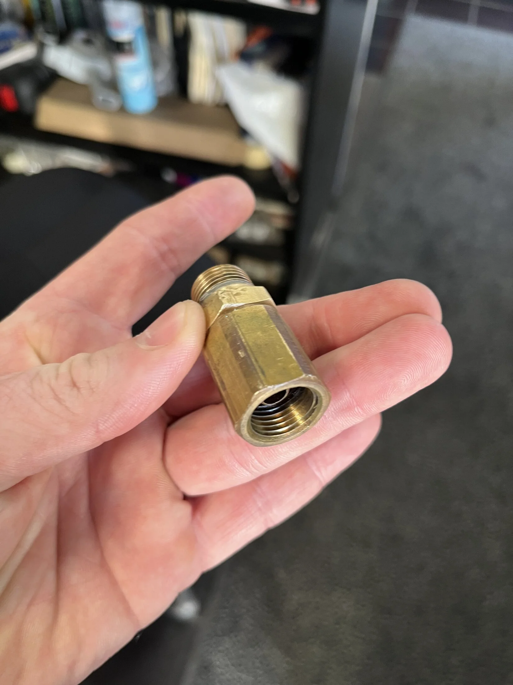

I got some better/more complete pics now that I’m back at the repair shop.
It threads directly to the inlet of the manifold. There is an AR adapter fitting to attach the inlet hose to the non vacate side of it.
Just by the above photo only, it’s hard to say 100%.

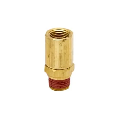

I do think I found it at McMasterr-Carr.
Part number 8549T16. $36.10.
I ordered it & will show up tomorrow to confirm.
