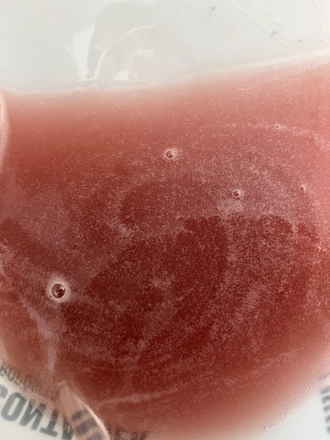

Thanks for the tips and encouragement; I did it, replaced all four globes and AHC fluid. Two front ones need drill and hammer, two rear ones quick and easy.
But I fear I have air in my lines:
1) When I bleed the fronts (both 2nd and 3rd/last time), the initial burst appears to be thick and darker pink, but quickly become clear and light pink as seen from the vinyl tube. But then looking at the tub, it seems to be more like air bubbles than anything else (sediments)
2) When pressuring up, I hear a quick and clearly audible, not necessarily loud, (air) discharge sound. It's like those buses release air pressure brakes.
PS. the fluid tank and initial bleed was terrible brown.
Any advice?
