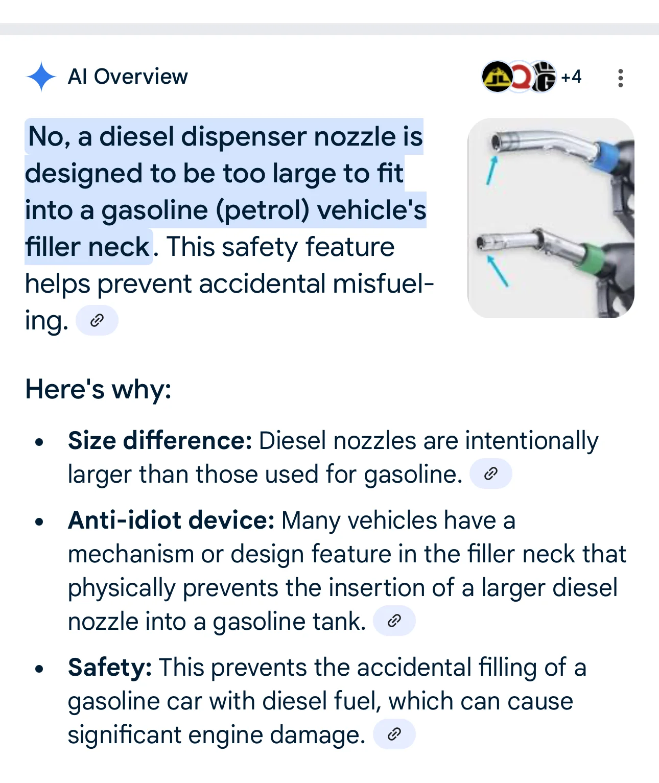

besides- i've always understood that vehicle filler necks for gasoline are too narrow for a proper diesel nozzle which is a larger diameter and cannot fit. how do you KNOW that diesel was filled, just by the color of the filler handle ? did the gas station have the wrong dispenser handle on the pump?

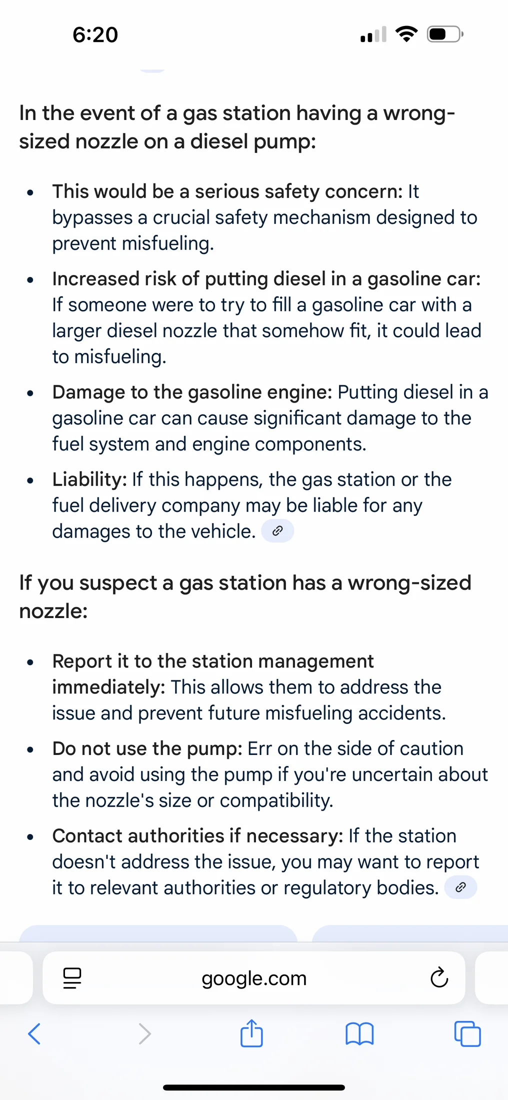

'hey google, can you accidentally fill an unleaded gasoline vehicle with diesel'...
i'm not necessarily jumping to conclusions yet, you have certain things to verify first but if the gas station had the wrong dispenser nozzle on the diesel pump, here are a few thoughts to consider:
