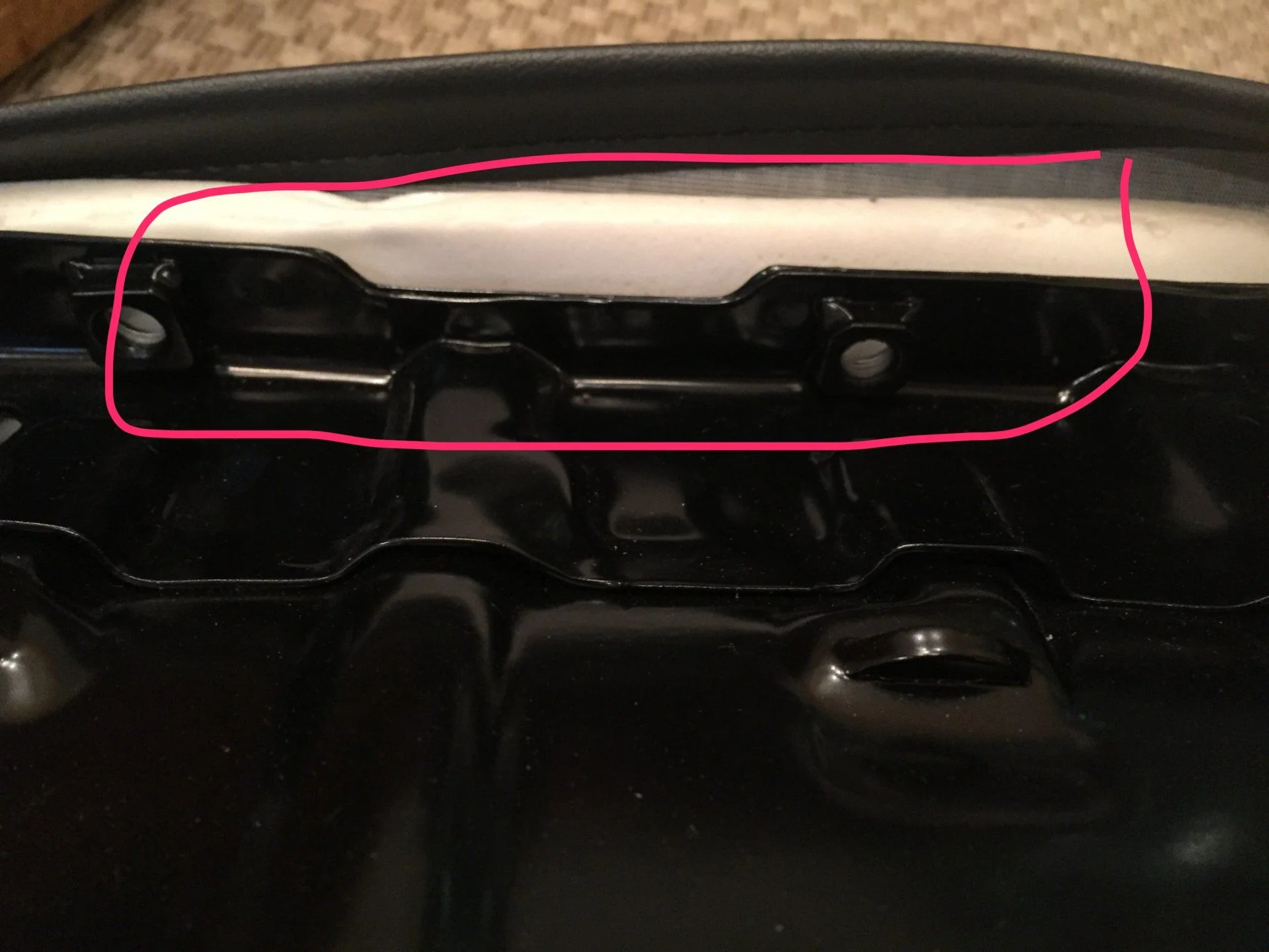

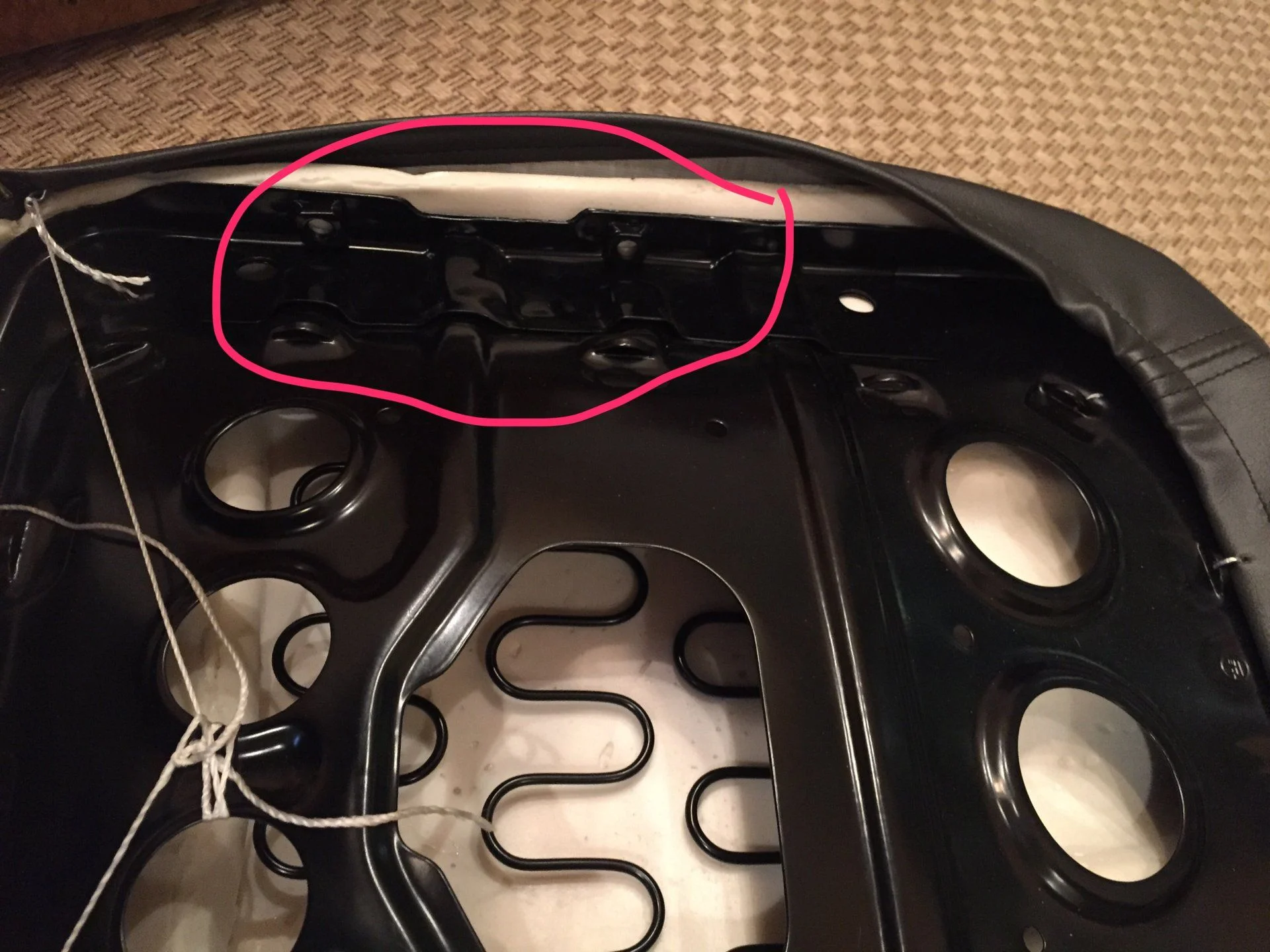

I'm recovering the bottom portion of my 1977 FJ40 front seats using SOR foam and seat covers. I have 2 question(note zip ties are temporarily in place of hog rings):
1. It seems like I need to trim the foam to be able to attach the seat track to the front seat bottom cushion/frame(2 bolts each side of frame)? Have others had to trim the SOR ?

Do not trim the foam, it is there to protect the vinyl from the sharpe edge of the sheet metal. I'm guessing that the zip ties are temporary? Yes?

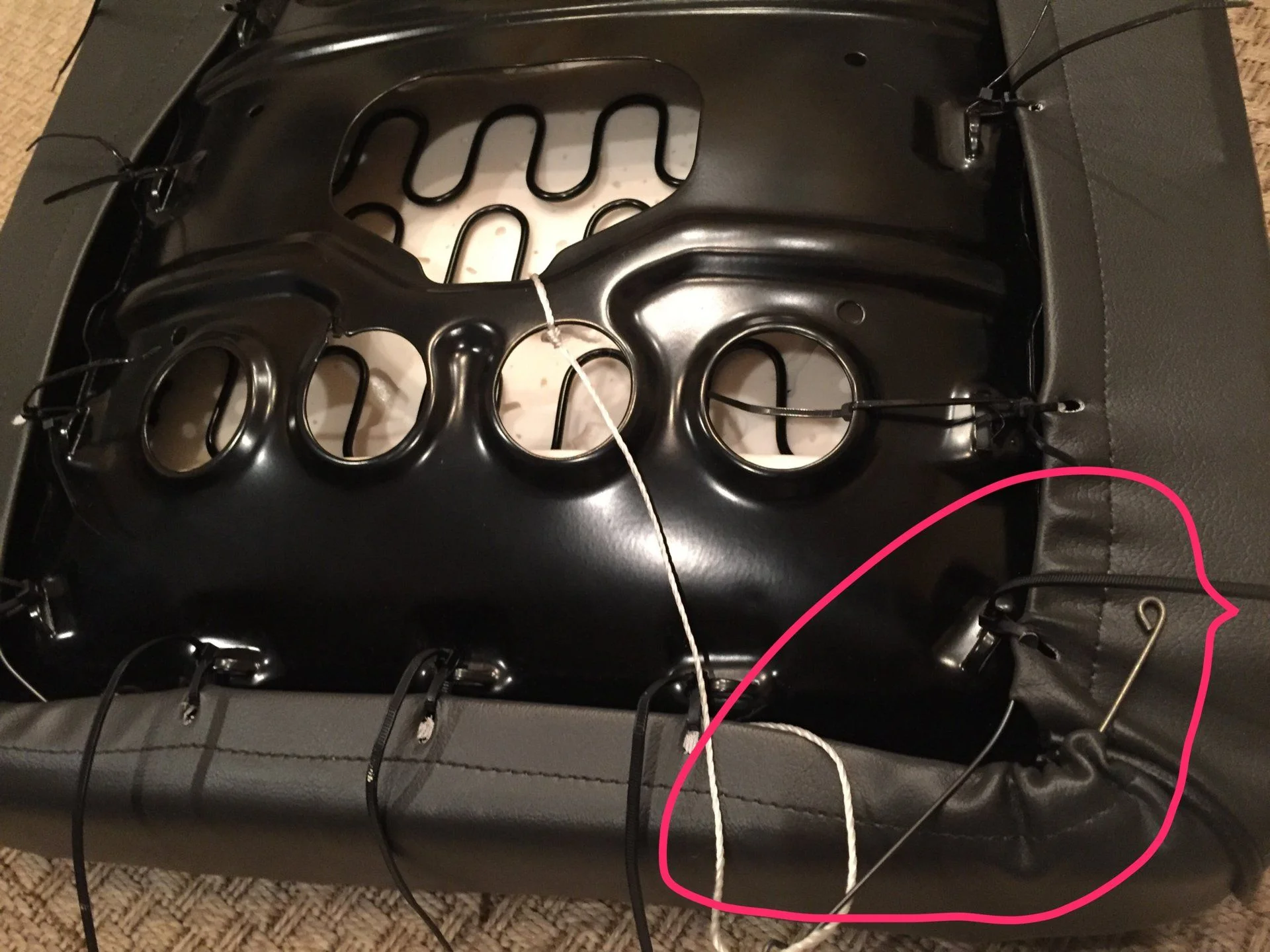

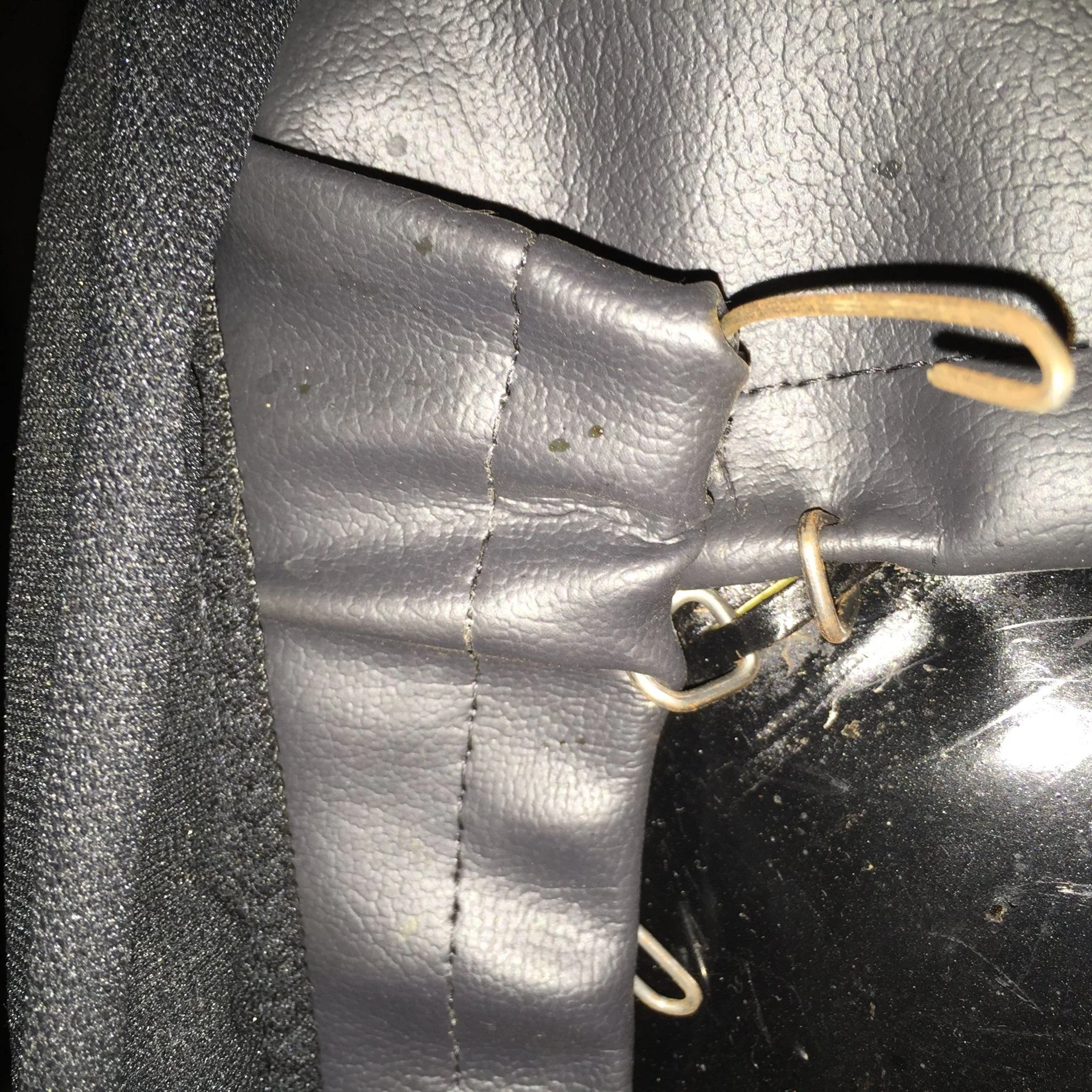

The seat bottoms only have two wires one long one that goes in one side across the front and out the other side and one in the back that's the width of the seat
Here is a picture of the underside rear of the seat. One long wire for the front and sides, looks like the rear wire is tucked under the sides, don't know how much extra of that wire there is.
