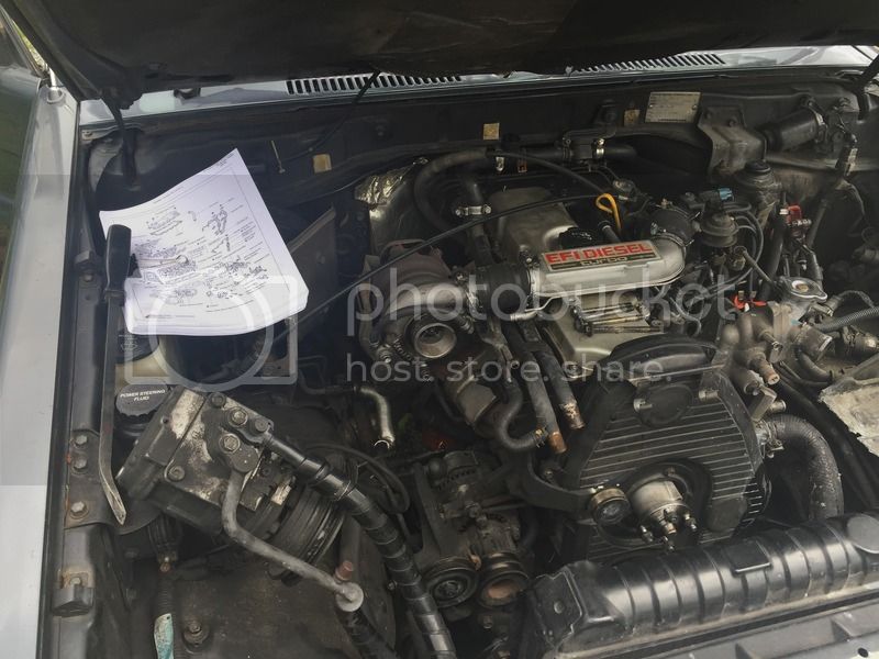

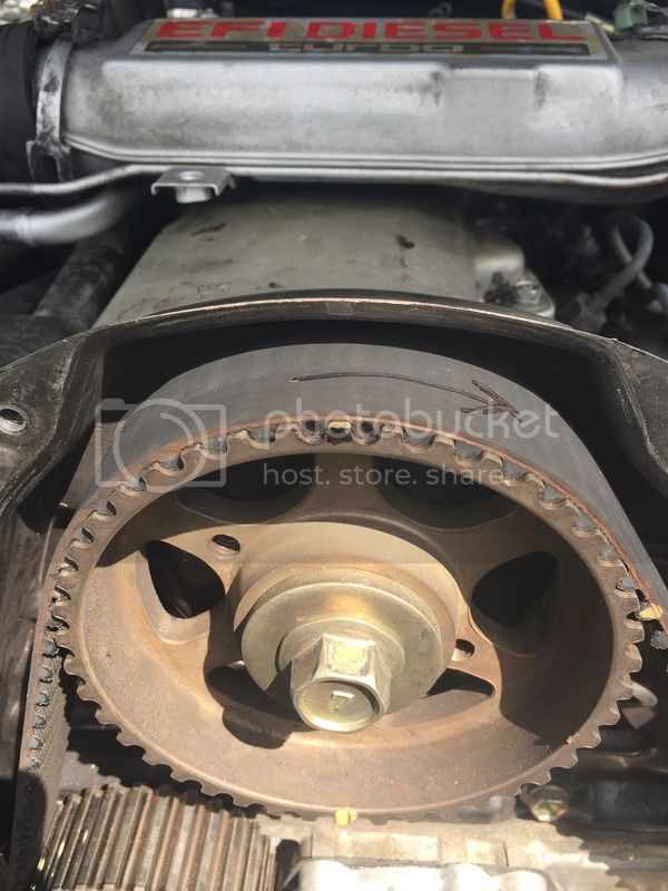

So I got around to pulling the head off today
Tried to mark things out as well as I could.

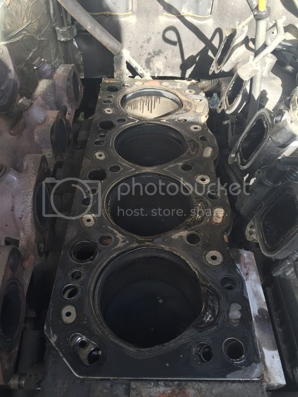

After removal it would seem the cylinders are in decent shape.

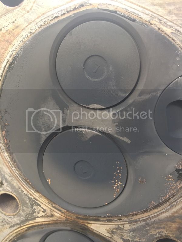

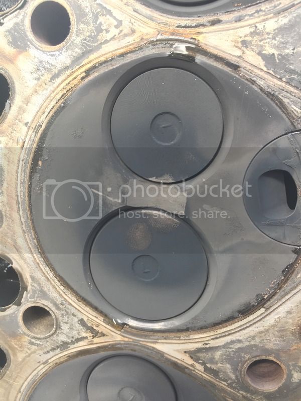

The head was another story...
4 cracks in total...
This is what I expected when I bought this truck. I do have a spare head that has been sitting for awhile under a tarp in my yard (Still attached to the block) I am going to pull that one soon and hopefully swap it.
Nice work. I'm glad the short block is in good shape. Maybe drop the other head off at a machine shop and get them to check all the valve clearances etc. before you put it on? I seem to remember you having some low compression on your old engine, and it could have been the valve clearances?

My big fear now is I take the old head off and find it hasn’t cracks too!

Not trying to high jack, but all this talk of cutting heads in half got me curious, and made me go yank my old 1st gen head to have a look. Not pretty. Looks like at least 6 cracks.

What's the cause of these common 2L head cracks? Cooling? Compression? Head design?
In an indirect injection diesel, the combustion starts in a precombustion chamber in the cylinder head. This works fine for non turbo diesels for the most part. Once they're turboed, there is way more heat in that precombustion chamber. This causes localized coolant boiling in the head around these chambers if the motor is run to hot. If this happens regularly, the metal gets fatigued to the point it cracks. The hottest area is between the valves and precombustion chamber. Many IDI turbo diesels have heat problems. Manufacturers have long since moved to direct injection motors where the combustion chamber is in the piston instead of the cylinder head. Now it's the pistons that fail if things get too hot.

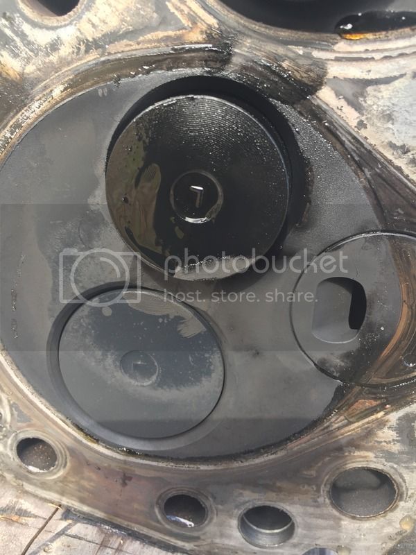

Pulled my old head off.
The number one cylinder was full of water but I think that is because the intake and exhaust manifold were off for a long time and I did not have the engine covered very well.
Visually everything looks good. I am going to drop it off at the machine shop today.
Nice! That looks like an "All Head" Australia head. I've seen a few of those around. I think they are the major alternative to the Toyota ones. They have a good reputation I believe.

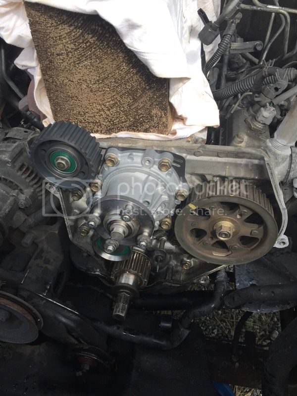

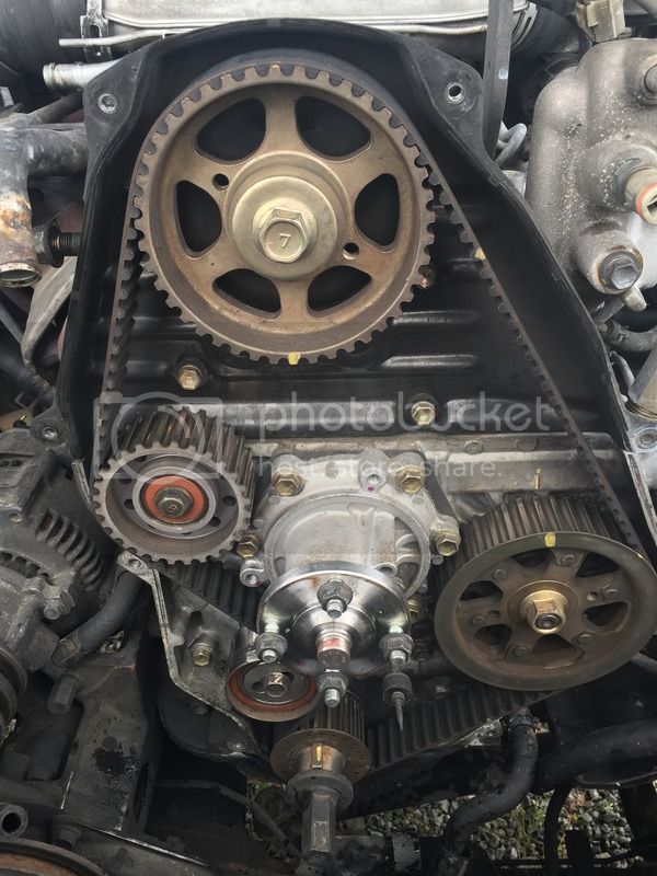

I am still waiting on the head from the shop, So while I wait I did a few things in prep.

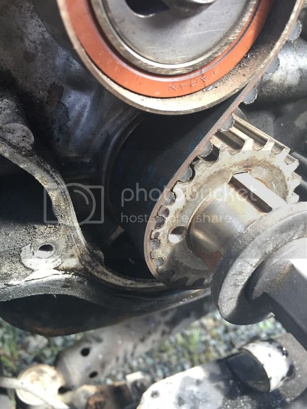

Installed new OE water pump, GMB t-belt idler pulley and tensioner.

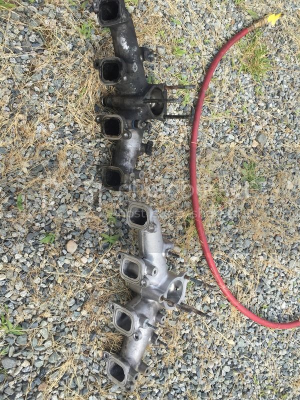

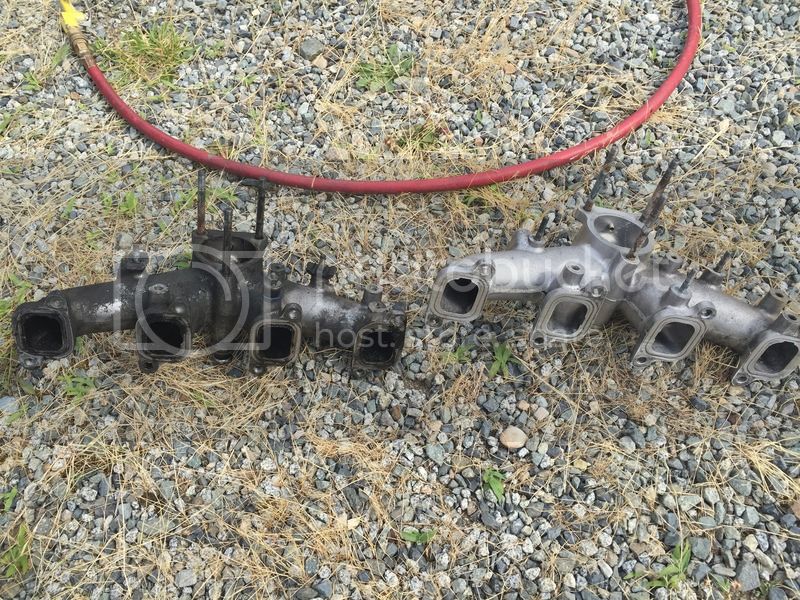

Made some block off plates for the egr valve and cleaned my spare intake.
