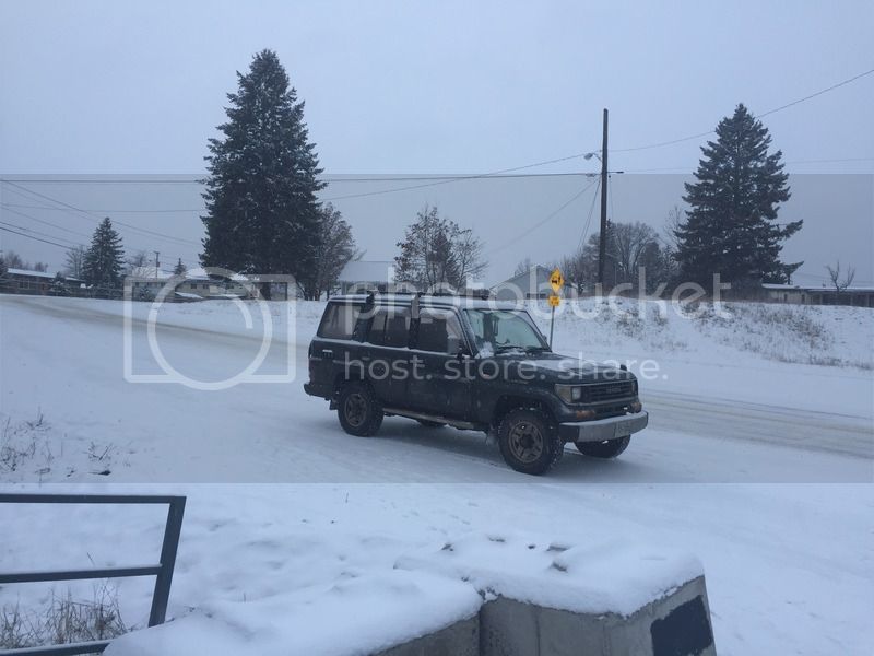

Been driving the truck now for a few months. Took it on it’s first long haul with my boy to see family over the holidays. The 1200 km round trip (chilliwack to grandforks BC) included some pretty decent hill climbs, the truck ran flawless!
Found some decent snow along the way as well.
