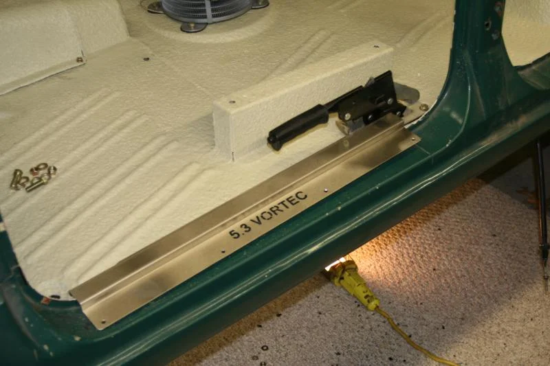

I've been really dreading today's work, cutting the hole for the E-brake. I'm using all FJ60 stuff, so the only place I had was next to the driver's seat. I know some of you have already done this, but what a bad feeling that was, cutting the hole.
Got it all mounted and then thought about Bob's scuff plates. Sorry Bob, but I have to trim alittle of the plate, to make it fit. One of many compromises of this build.
Ron, apology not necessary. Its all part of the game. PIGs looking good. Getting closer and closer. :)

Looking great Ron. Really loving the look of the bedliner on your interior

I know the feeling! I hated doing it to mine. Looking good.
