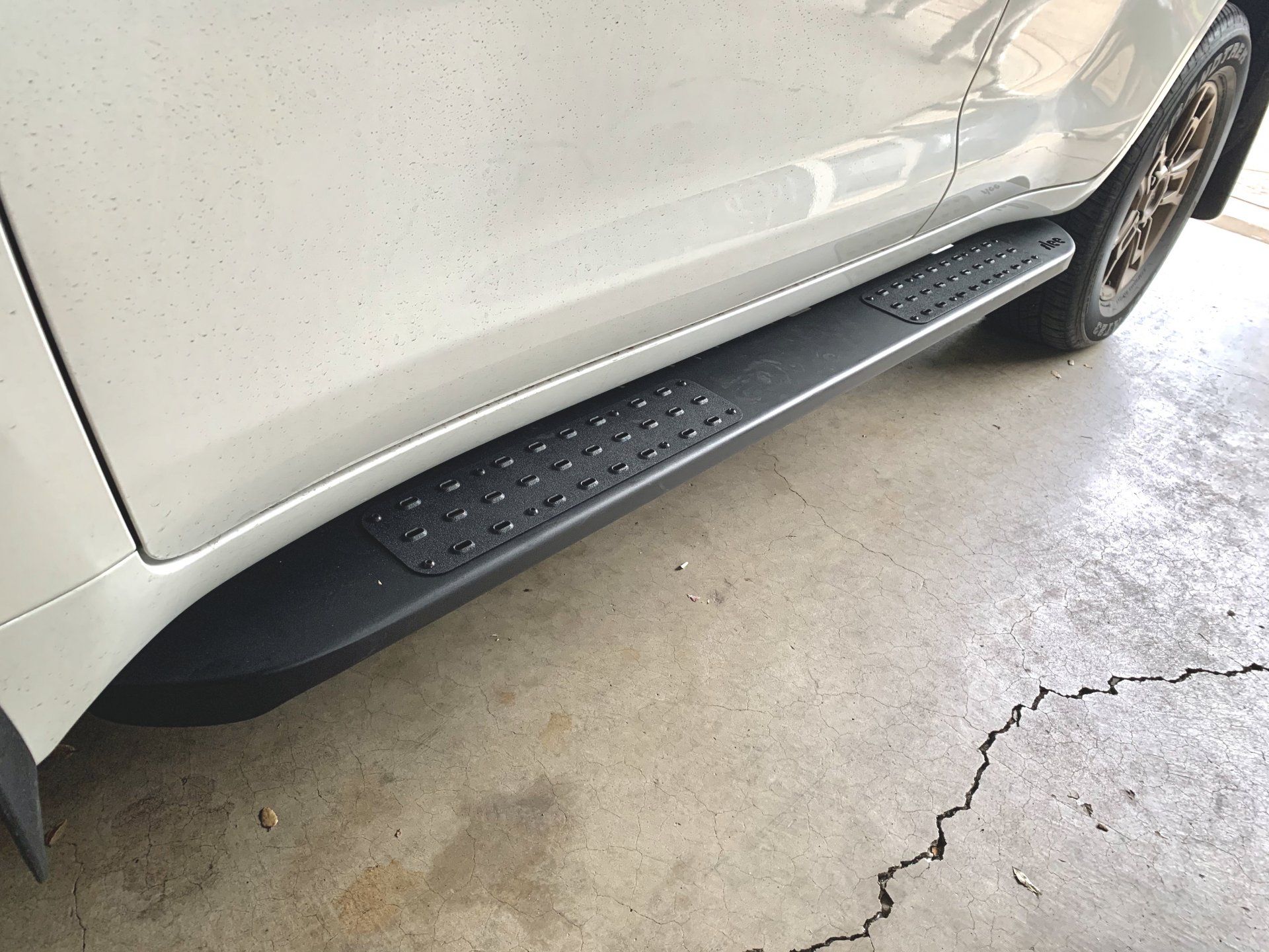

Before I get into more of the nitty-gritty install details, here are some obligatory before / after pictures. I really like how they mostly retain the stock look, but are actually more subdued than the stock running boards.

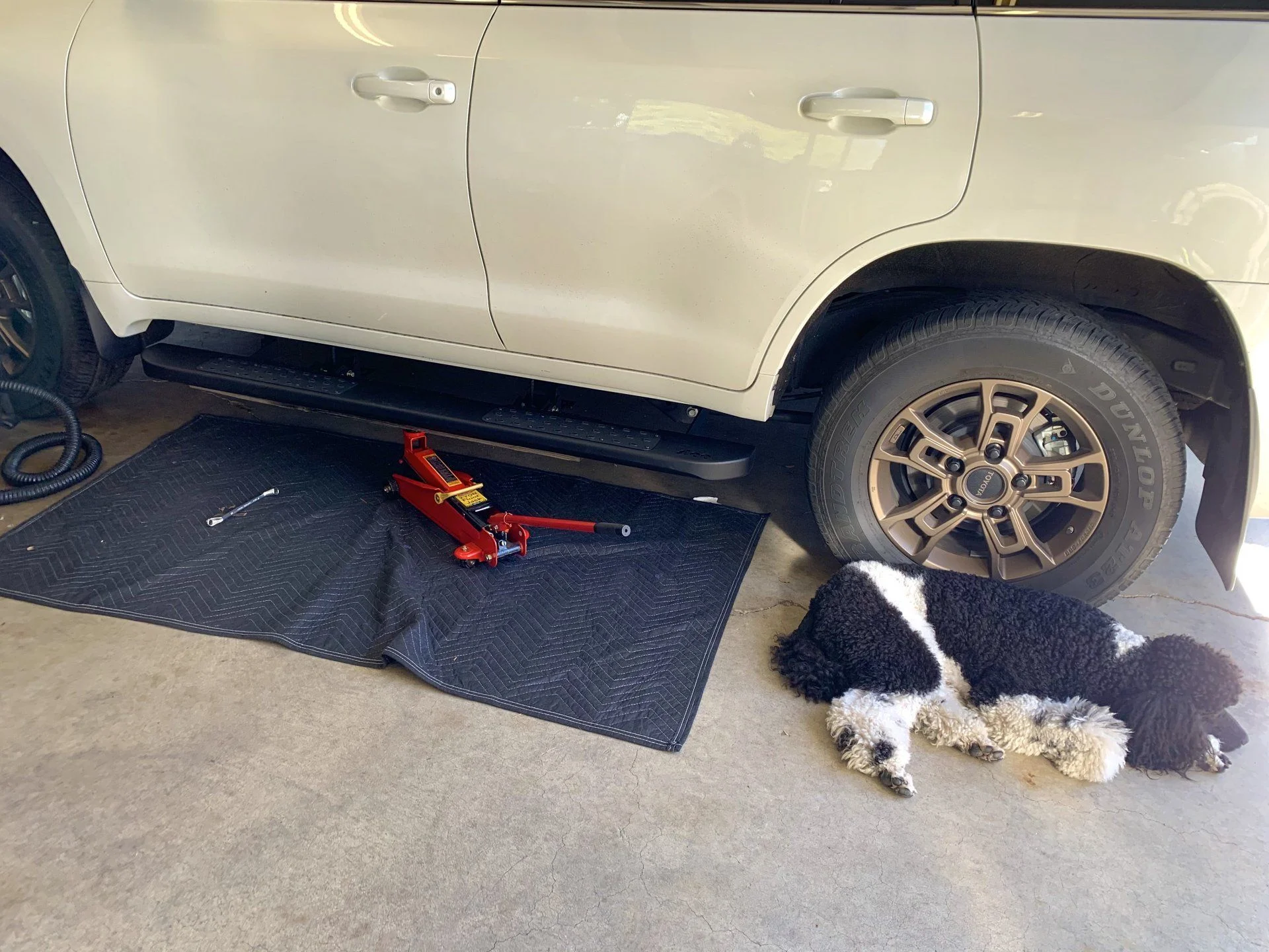

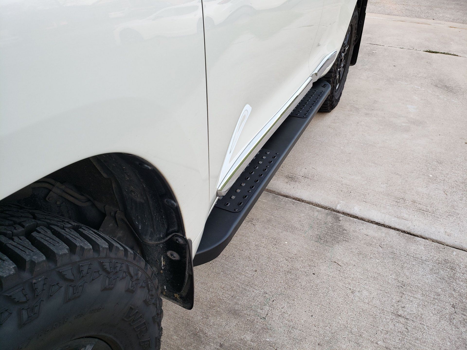

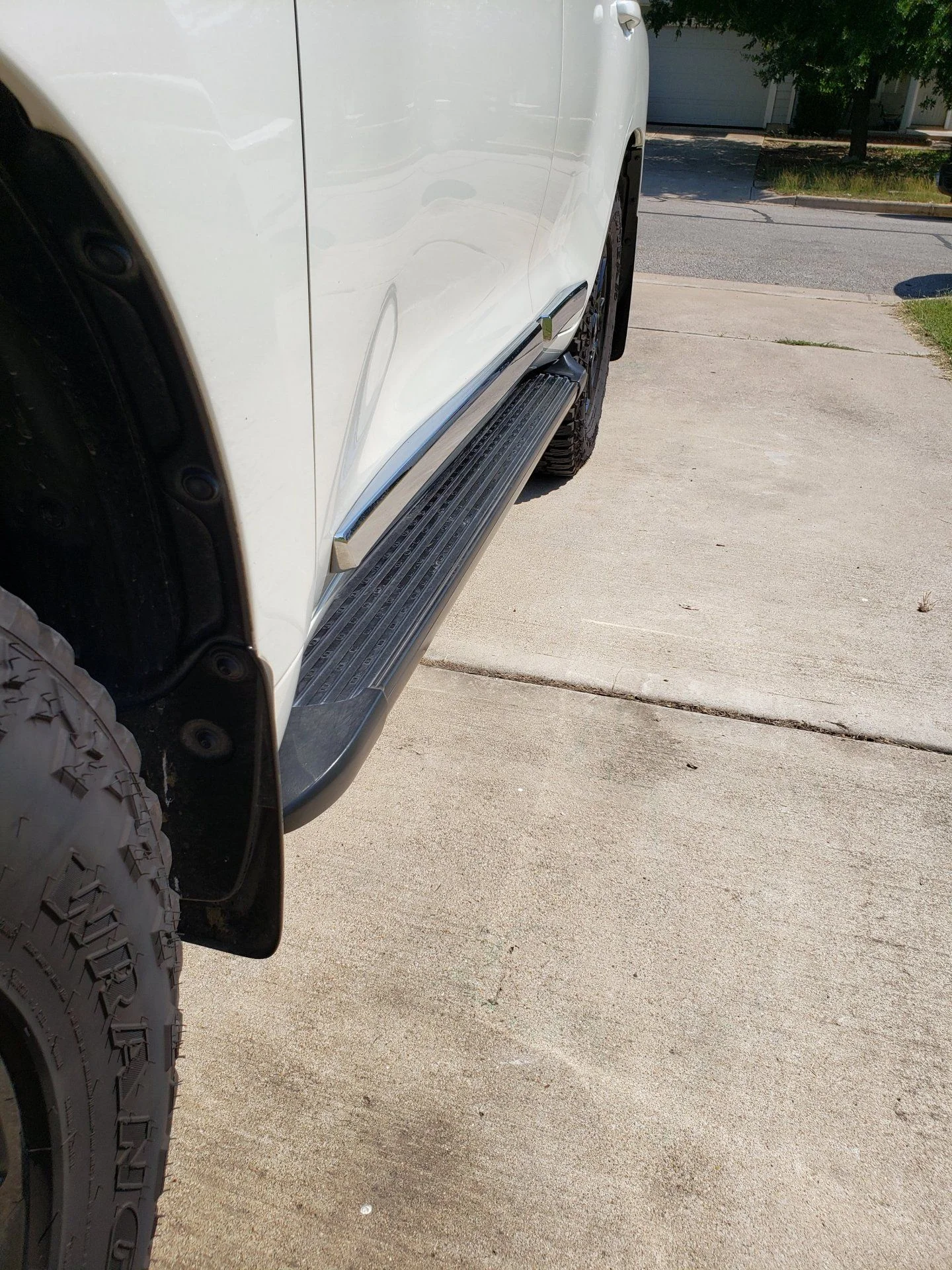

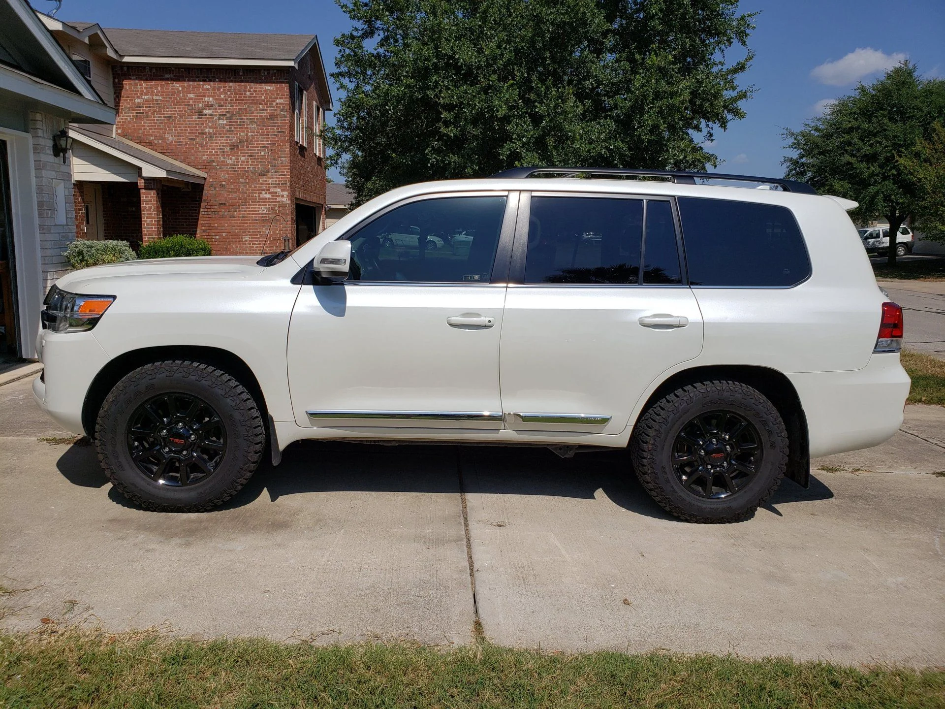

1st: original running boards.

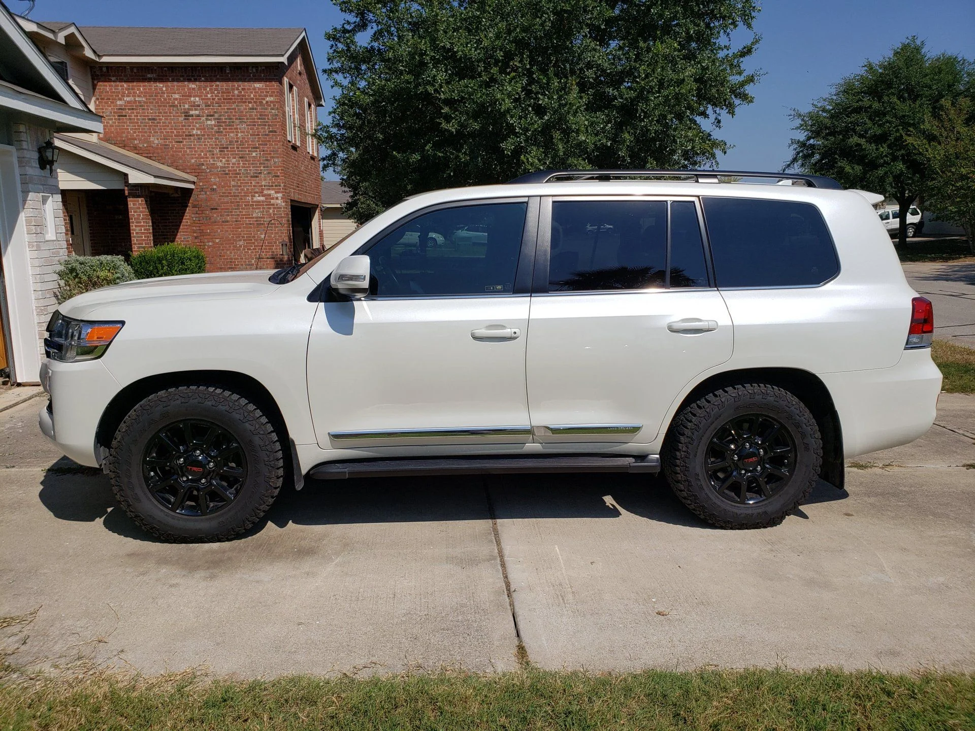

2nd: no running boards (this looks best in my opinion!)

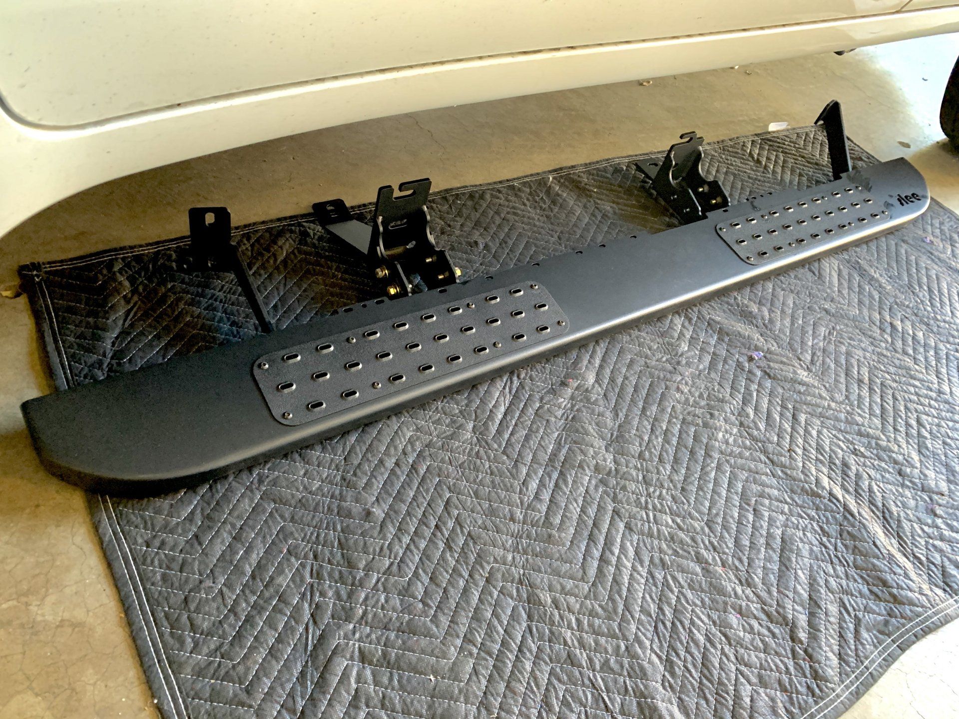

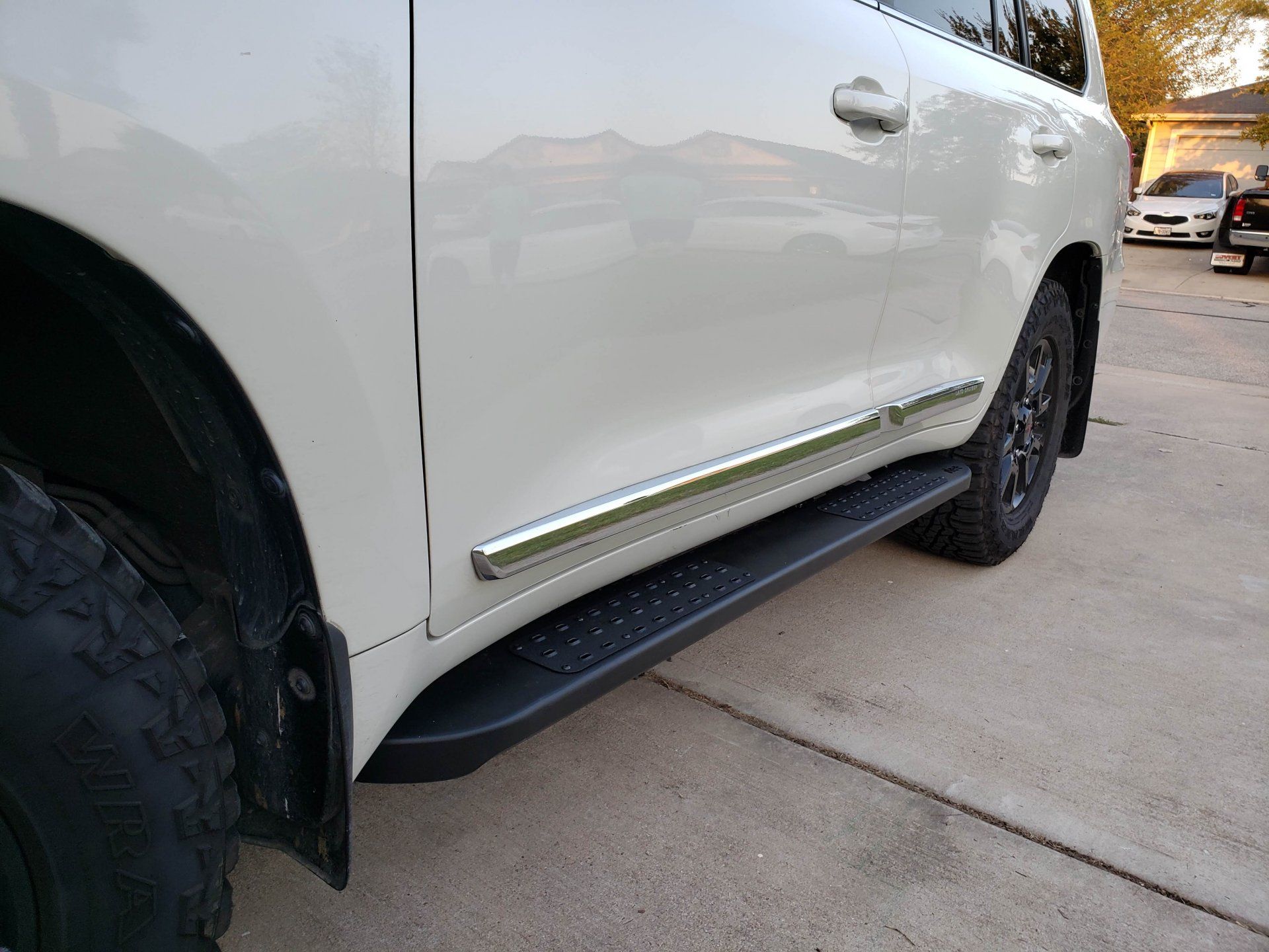

3rd: Slee sliders (best protection, and looks much better than the running boards!)
And here's a close-up of the original running boards vs Slee slider steps:

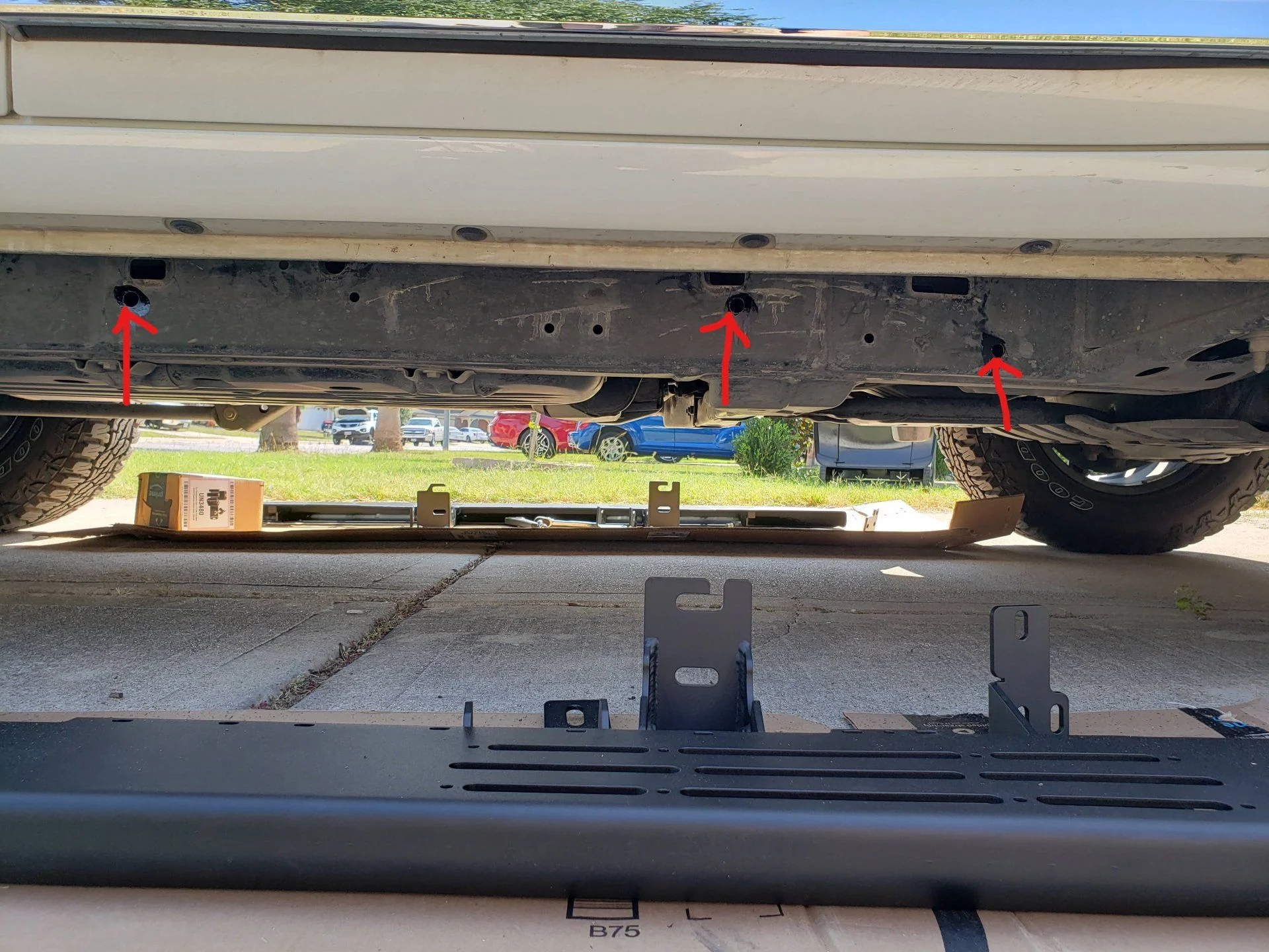

  3. Place all sliders pieces under LC to better visualize and get 100% sure what frame holes you will use.

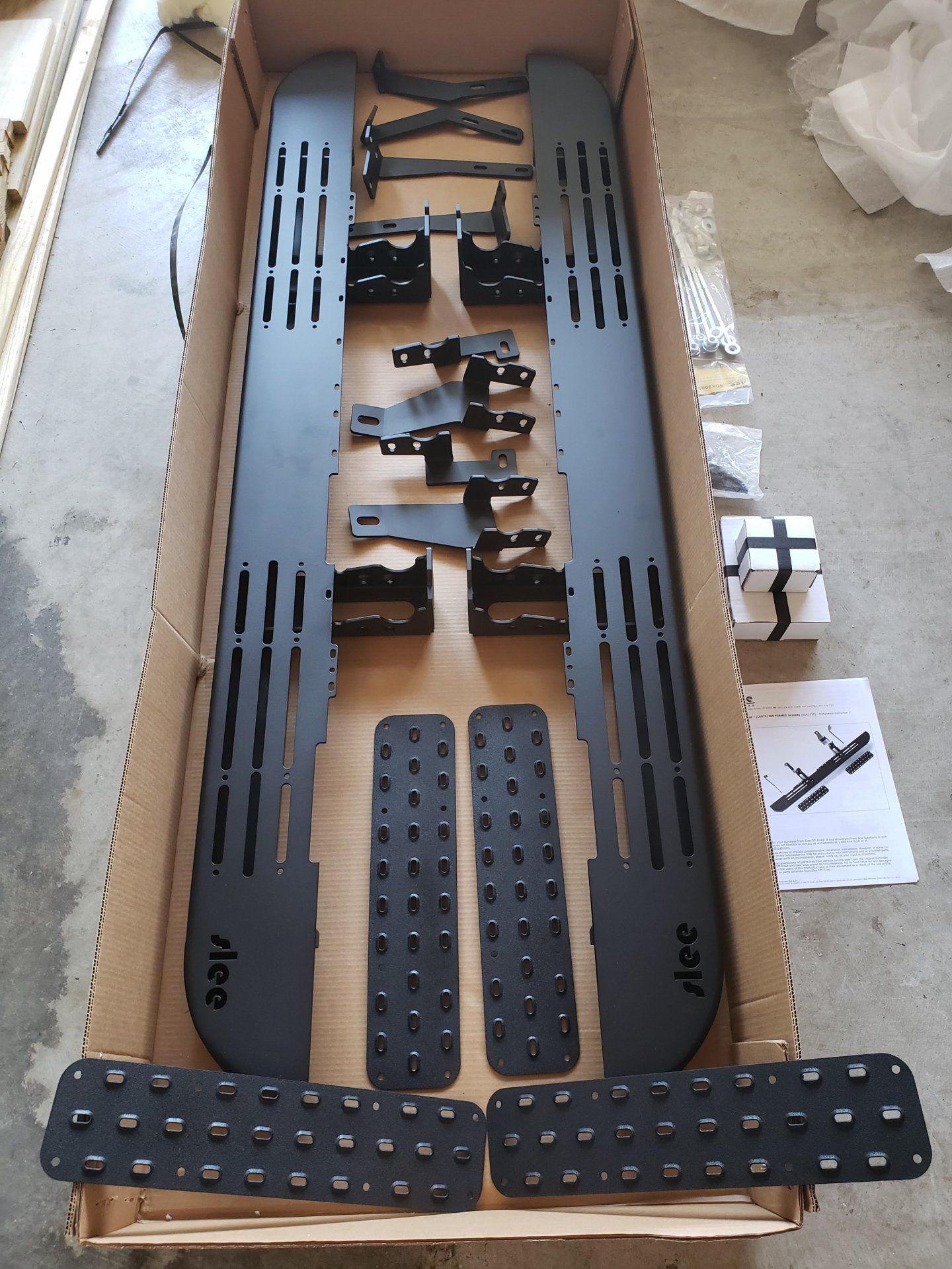

After I placed my order, Slee (an actual employee, not an automated system) emailed me with the expected shipping date. I knew the date would be a problem because I would be out of town when the sliders would arrive, so I emailed them back and asked them to delay the shipment by another week. Slee was very responsive and accommodating. They agreed to ship later, on the date I suggested.
Once the slider shipped, it only took about 3 business days to get them (from CO to TX).

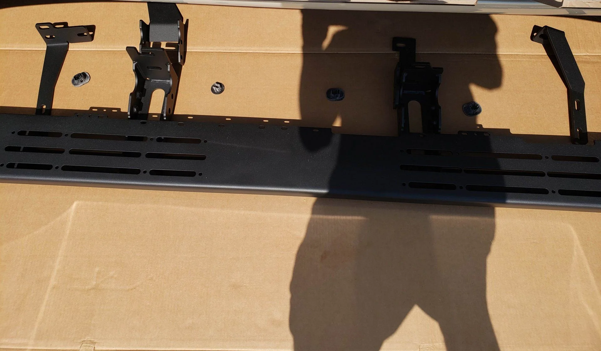

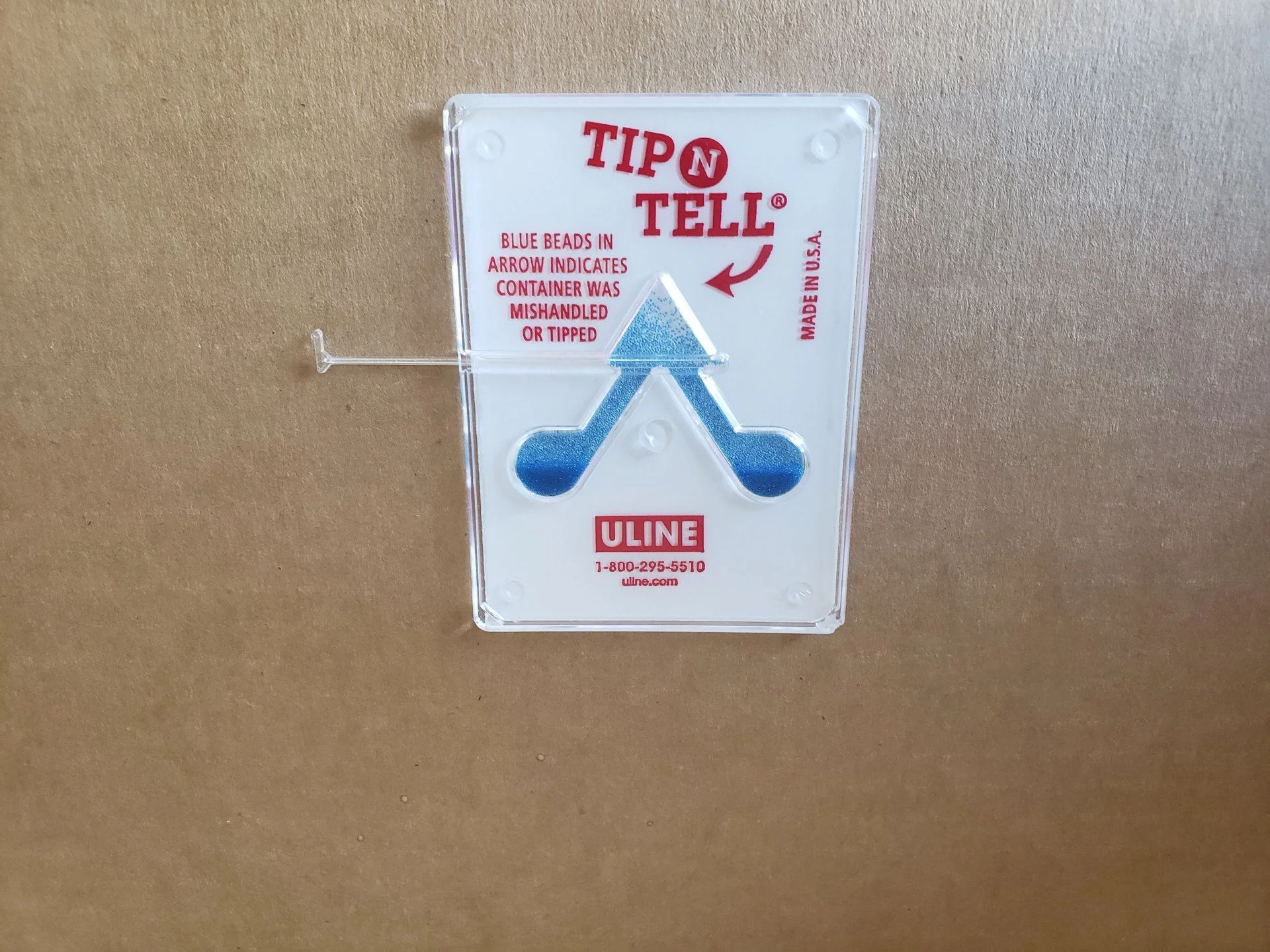

The packaging is rock solid. Slee includes tilt-detector devices inside the box so you can tell if it was mishandled (for insurance purposes in case of damage). Although it looks like the package was tilted more than it was supposed to be, it was also pretty clear that there was no way the contents were damaged. The foam they pour into the box conforms around the contents and keeps everything stuck in place to the bottom of the box.
You'll notice in the pictures that there is a small box inside. This contained things like the included hardware, the extra LC-specific hardware that you have to purchase along with the sliders, etc. I also opted to purchase the rivnut installer tool. I did not purchase the 17/32" drill bit from Slee (for drilling the frame holes), as I found a highly-reviewed equivalent on Amazon for much cheaper. I won't link to the Amazon drill bit I purchased, as it was only okay in my opinion.

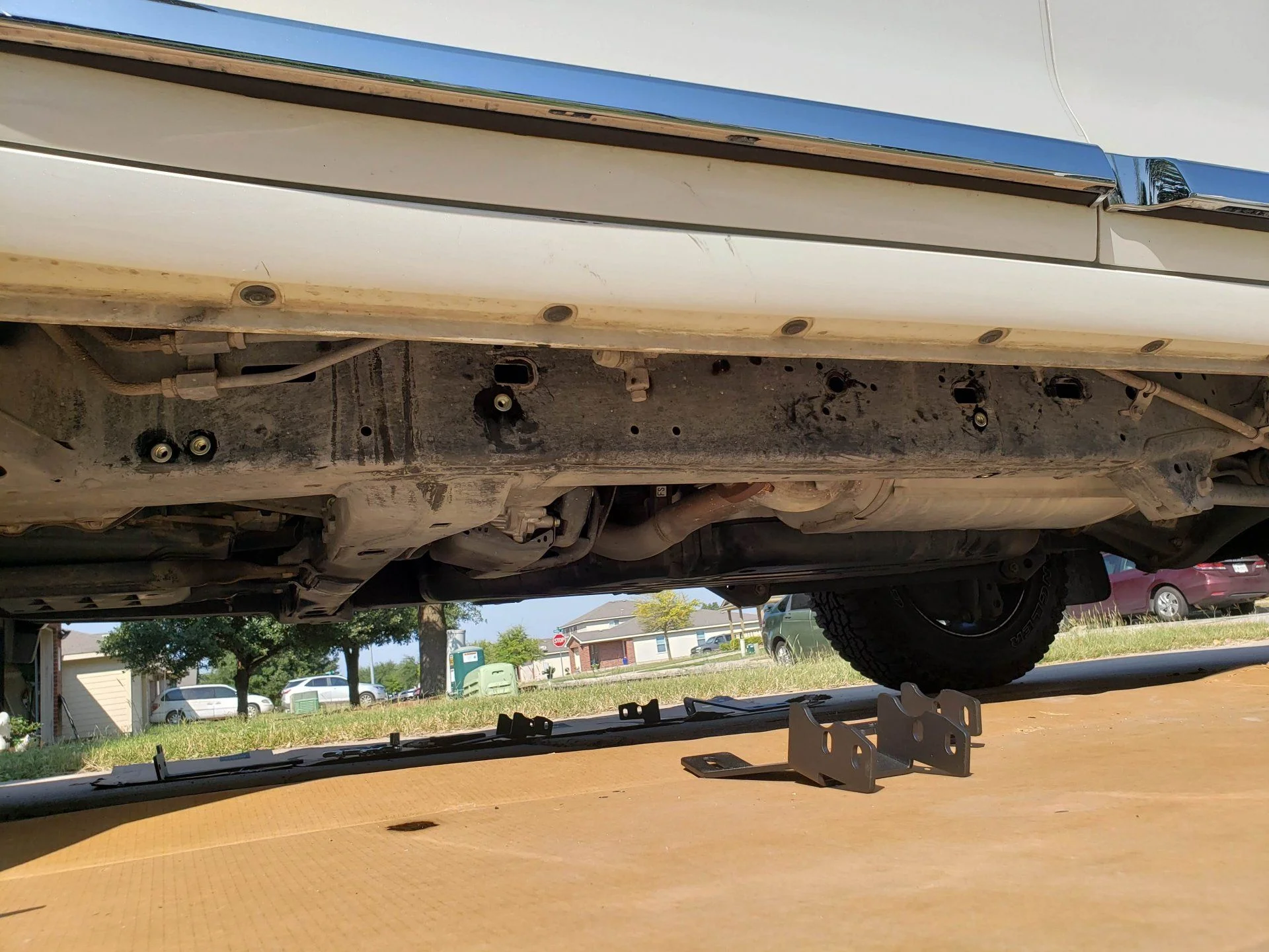

At this point I place some large cardboard pieces on the ground on either side of the LC, and then placed the Slee sliders and all their parts on the cardboard, lined up where they would be installed. There are so many holes in the LC frame, that this is the only way to really see which holes are the ones you will use for the install. Even then, it's unclear at the rear of the frame which holes will be used, since there are 4 right next to each other. That's okay, because as you keep going you become more oriented toward where things go with the help of the installation pictures in the Slee instructions.

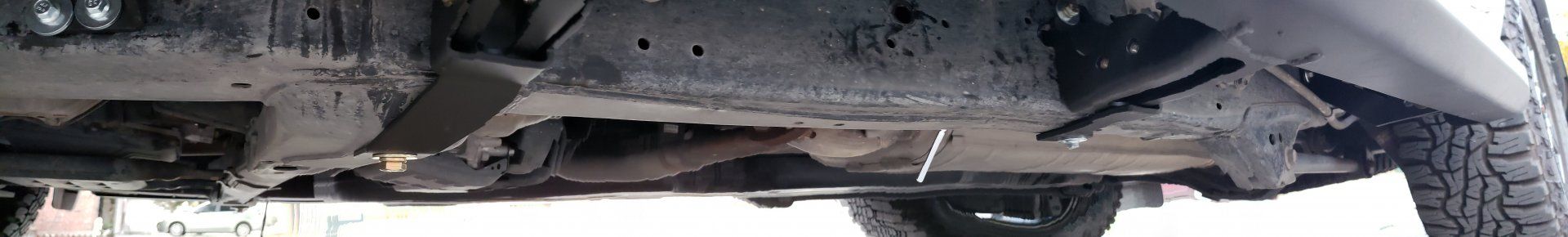

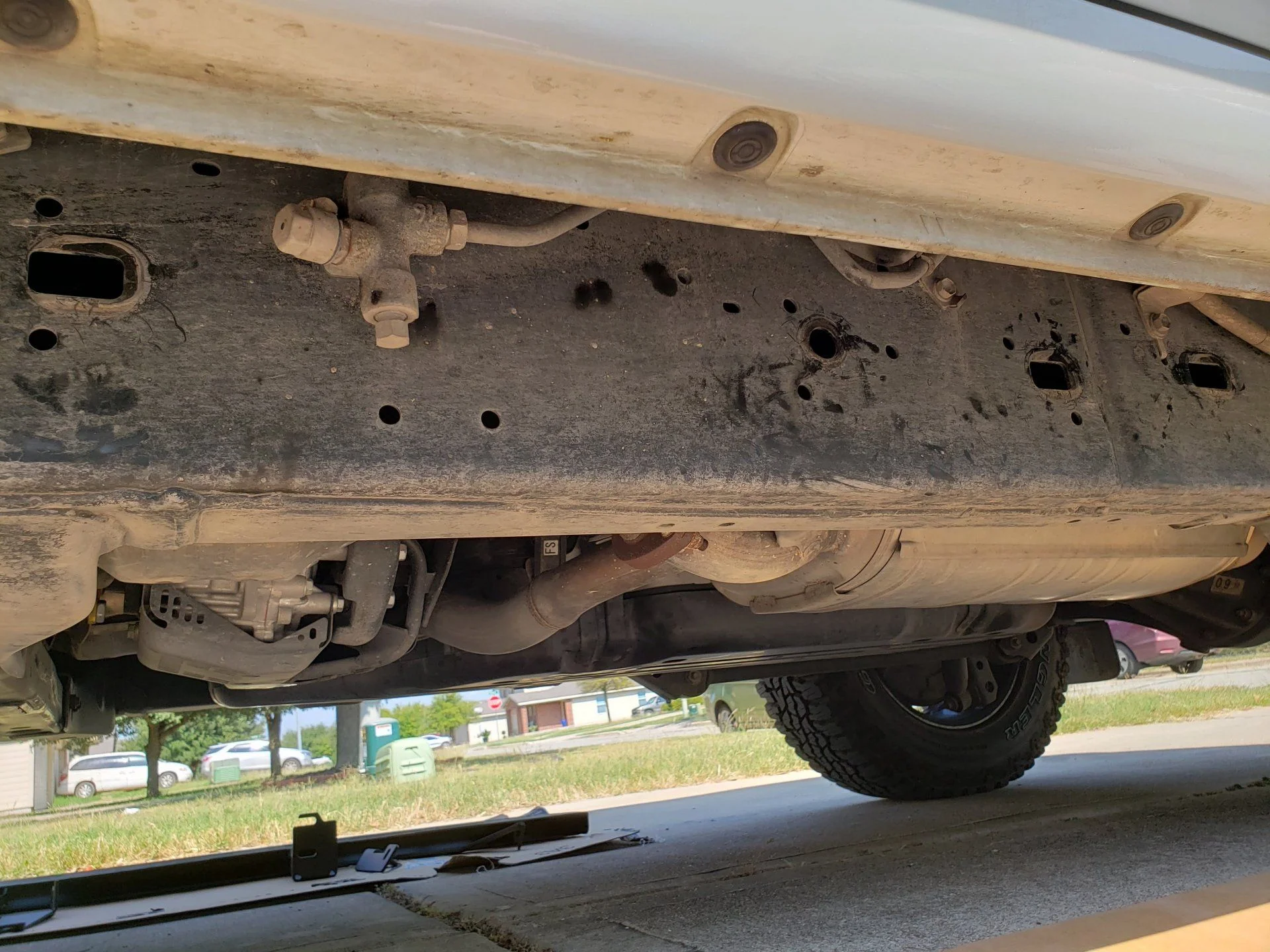

I also removed the frame hole-plugs per the Slee instructions to better visualize everything (shown on the cardboard with the slider components in the picture below). Note that Slee generically states something like "you might not need to remove all hole plugs, and some can be re-installed later". I removed all of them, and discovered after the fact that you don't need to remove the CIRCLE plugs, just remove the other oblong / rectangular plugs.
Here's a picture of where the frame plugs were that I removed. Remember, you actually don't need to remove the circle plug (one on each side), even though I removed it here.

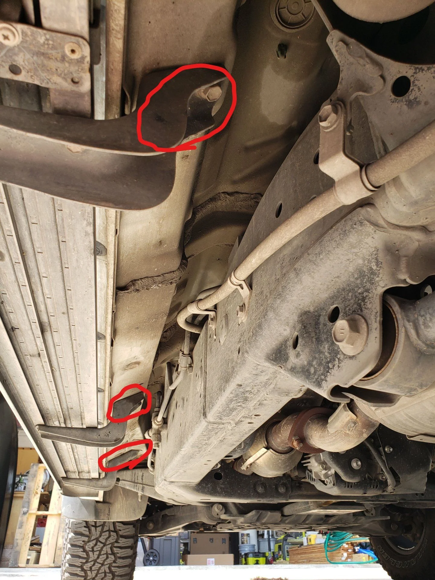

At this point I really noticed how many things Toyota has secured to the frame along these sides where the sliders will be installed. I began wondering how many of these would have to be loosened / shifted for the slider to fit correctly. The answer is NONE OF THEM need to be loosened or adjusted! Slee did an excellent job making sure the slider supports do not interfere with anything.

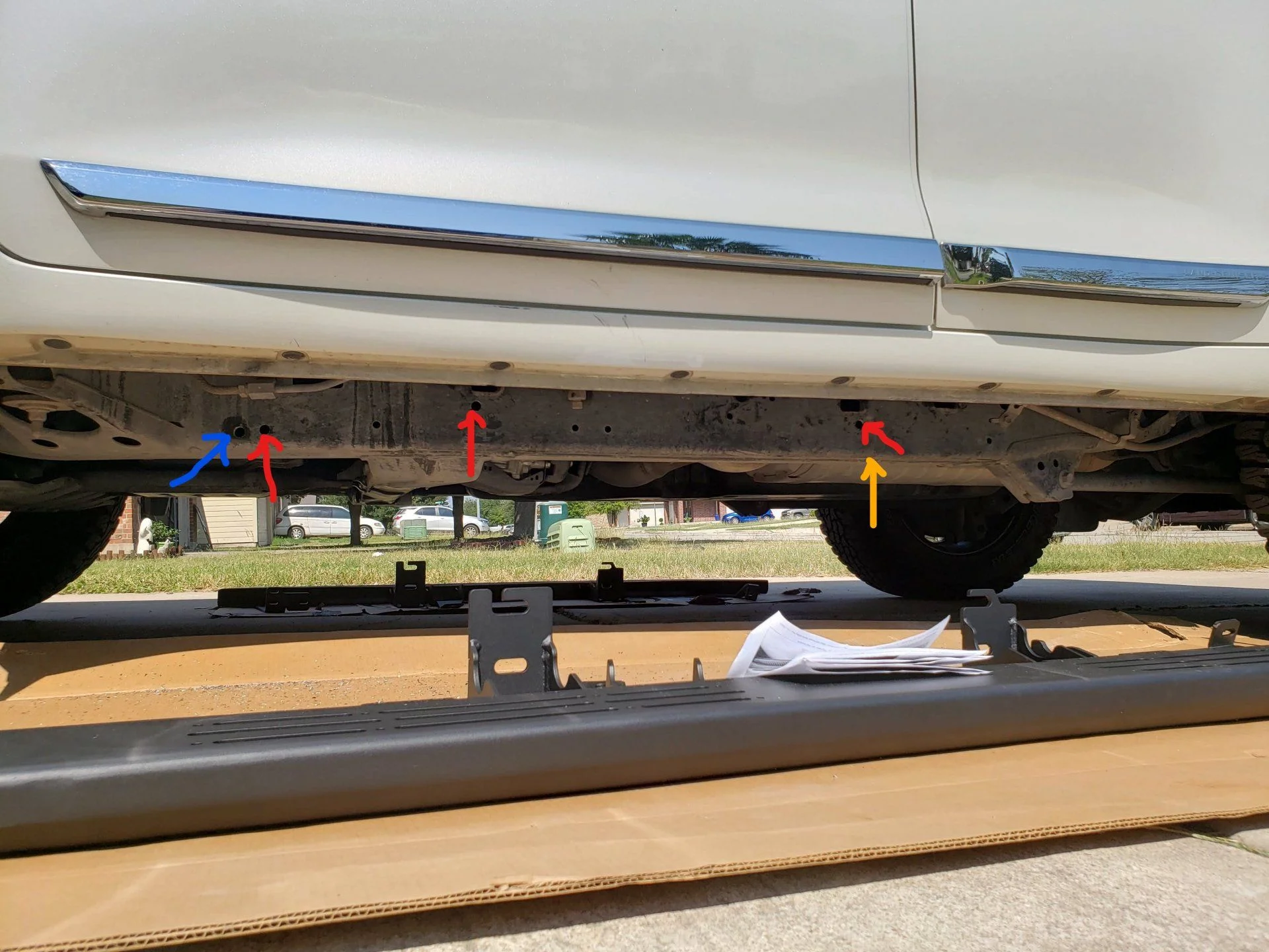

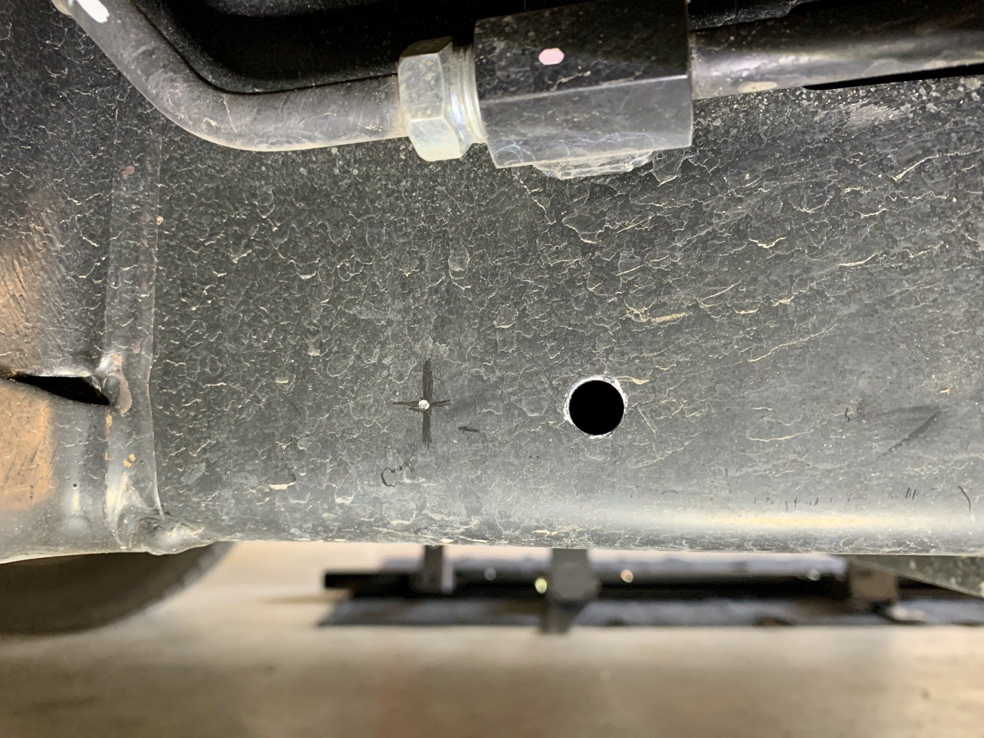

Now you get right into drilling the frame. It sounds intimidating / stomach-lurching. It actually isn't that bad, and I felt comfortable with it the entire time.

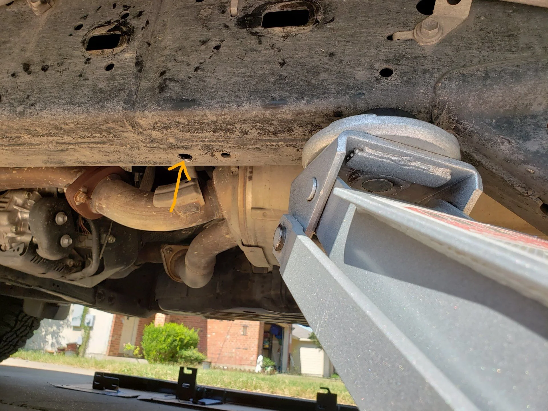

The first hole you drill is a brand new hole, on the driver's side, 1.25" forward from the existing front-most hole. I marked the point, and began drilling. The new hole ended up being slightly lower than the existing hole, but that's fine - the bracket that attached here has a very long slot that allows a pretty large range of height adjustment to make sure everything can line up correctly.
Next, enlarge 4 more holes on the driver side (still using the 17/32" drill bit). This picture shows the new hole (blue arrow), and the four other enlarged holes. The orange arrow shows the hole that is on the bottom of the frame instead of the side of the frame. The frame was actually too low to the ground for my drill + bit (which is very long) to fit between the ground and the one hole in the bottom of the frame that needed to be enlarged, so I had to slightly jack the frame up about an inch to get a good drilling angle.

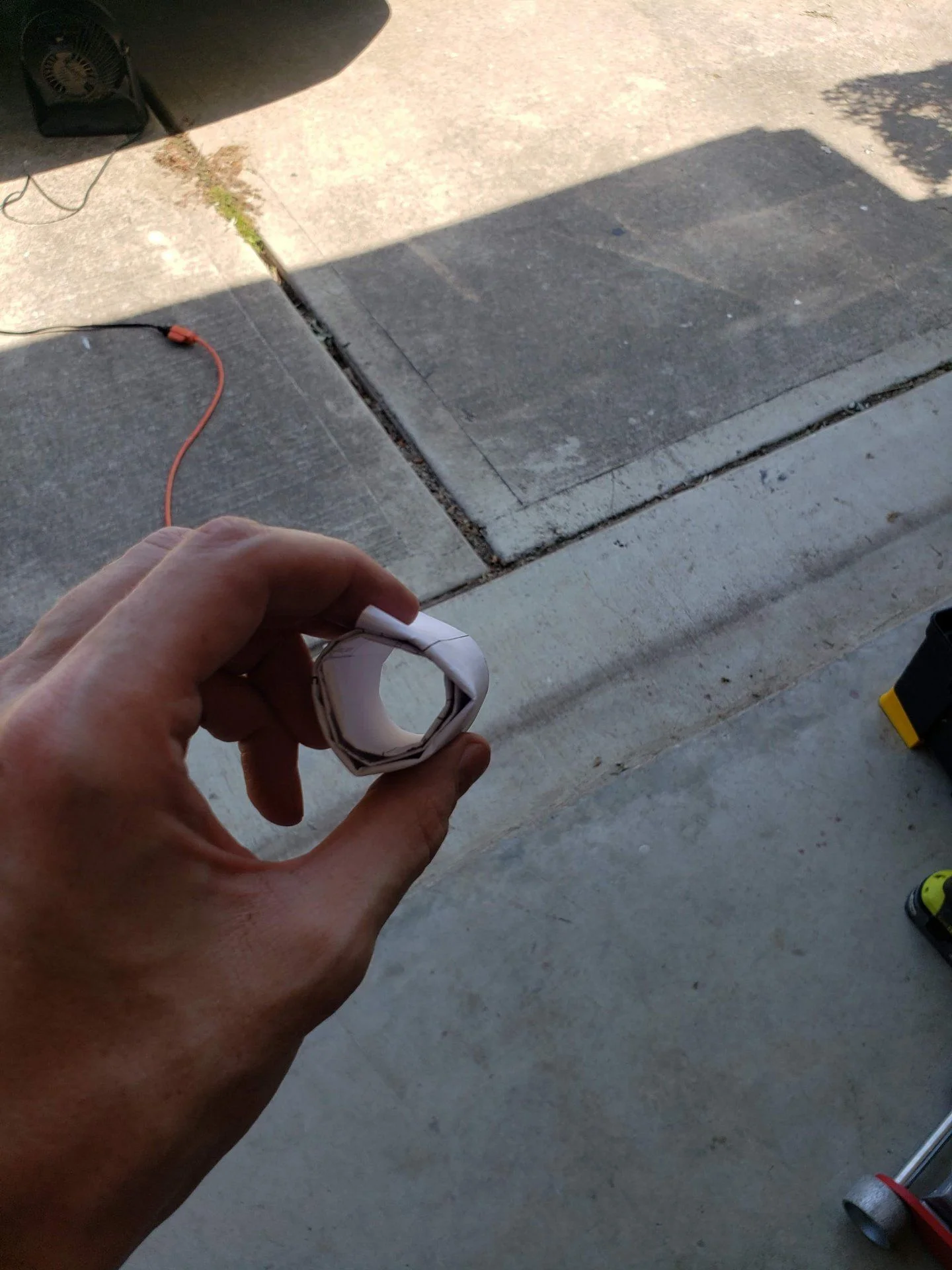

Have a couple paper towels next to you to wipe away any drips right after you spray each hole.
Makeshift paper funnel for spray paint:

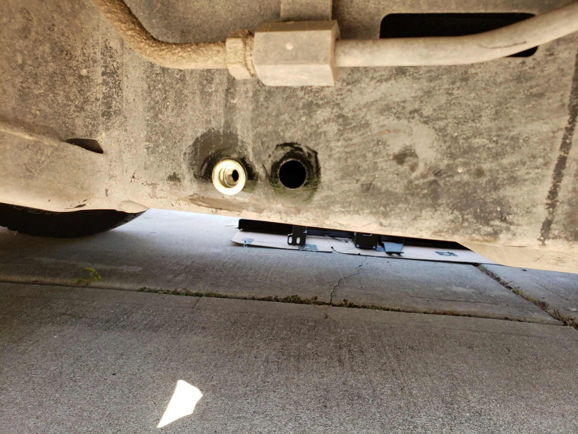

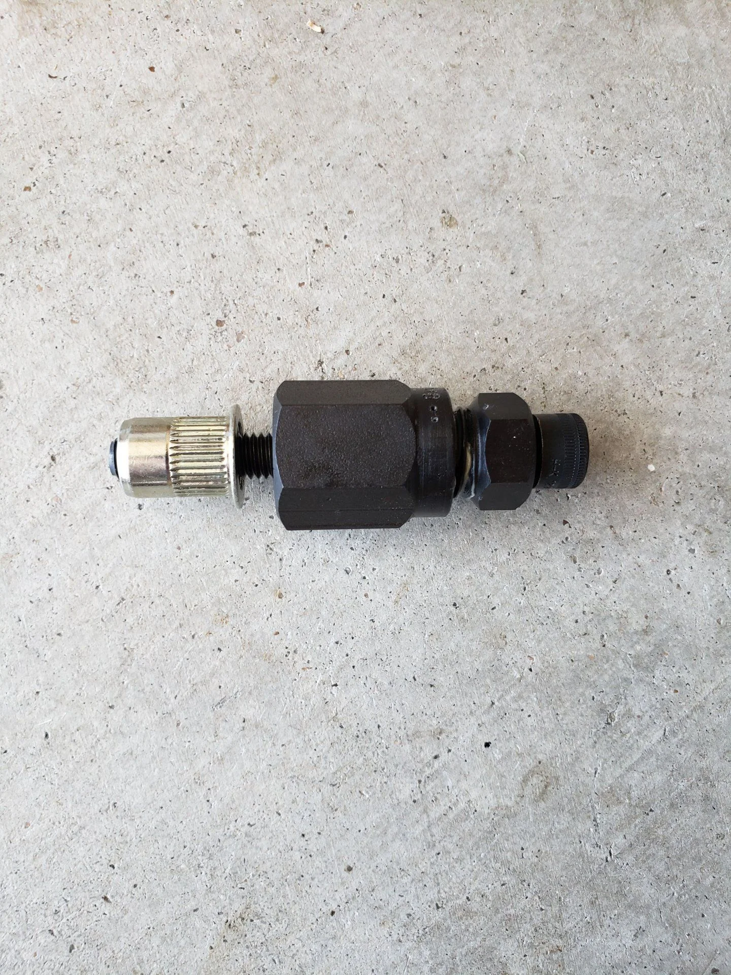

Install the 5 driver's side rivnuts. Thread the rivnut onto the rivnut tool like this, but keep threading it on until it touches the base nut on the tool.
Then push the rivnut (while threaded to the tool) into the first driver's side frame hole that you drilled. If it's too tight, you may need a hammer to help tap it in. Most of the rivnuts slid in no problem, and two needed some gentle taps with a hammer. Holding the rivnut + installer tool in place, use two wrenches to tighten / compress the rivnut. The wrench on the base nut closest to the frame should stay stationary, and the wrench / socket on the outside nut should be the one you turn (clockwise). It will resist turning quite a bit as the rivnut compresses, and you should keep tightening until it simply isn't possible to tighten it any further. You will definitely feel the difference when it's fully seated, it goes from having tight resistance to complete 100% resistance when it is fully seated.
Here's the 5 rivnuts installed on the driver's side:

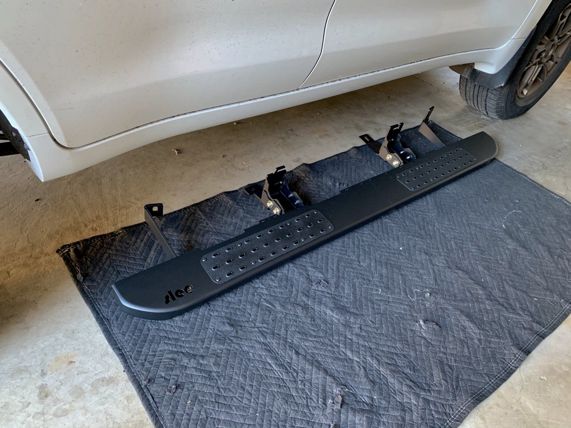

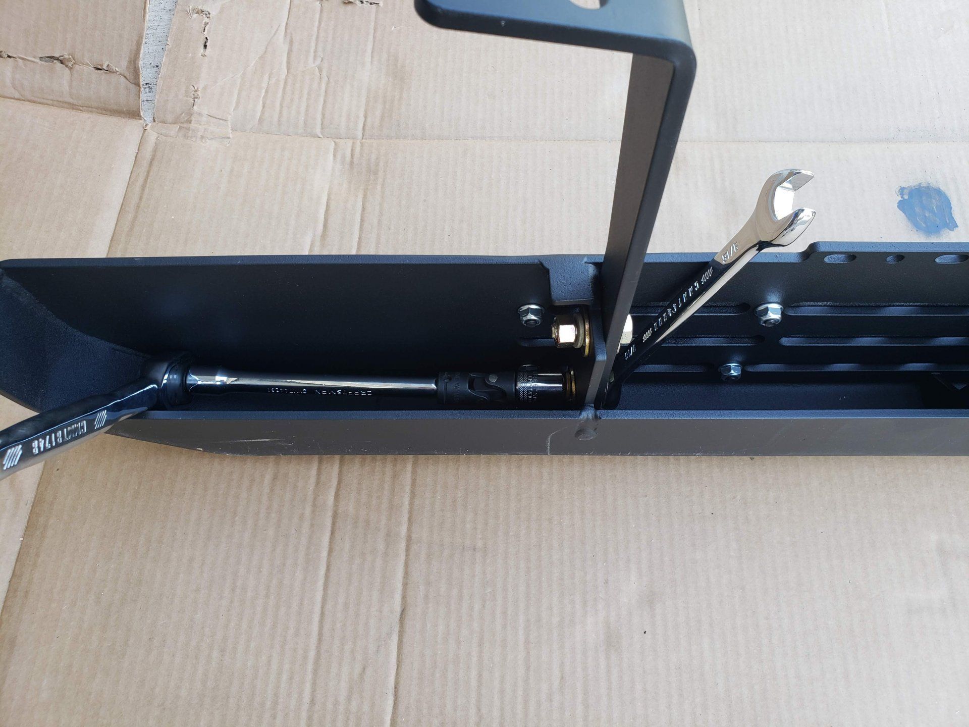

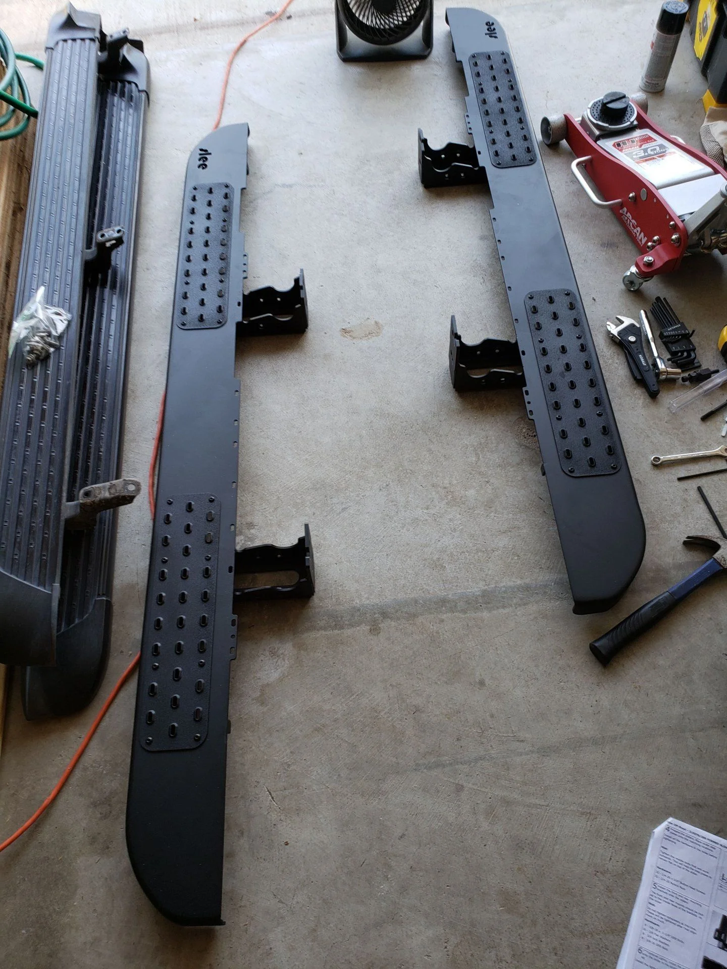

Now assemble the various pieces onto the sliders (this is slider assembly prior to the sliders going on the truck). Install the non-slip sections on the top, and the mounting arms at the front and back. Just follow Slee's instructions, it's straightforward. It's helpful to use a swivel socket and socket extension to get in some of the tight areas around the mounting arms. The hardware for the mounting arms should remain loose, you'll tighten them up later once the sliders are on the truck.
Next, you hand-thread the top main mounting bolts onto the LC frame. Keep them as loose as possible, while still having enough threads engaged to support the weight of the sliders. The sliders will slide onto these loose bolts and hang from it while you install all the other hardware. Don't forget the lock washers on these first set of mounting bolts, I missed that part in the instructions, and had to go back and add them after the fact once I realized my mistake. The Slee instructions are a little confusing at this point because you're constantly flipping back and forth between the main set of the instructions (which are for an LX) and the instructions in the appendix that are slightly different for the LC install. The hardware here is different for the LC than for the LX, so keep that in mind.
It's also going to be a bit tedious bending and winding all the stick-nuts to the appropriate places inside the frame for the bolts to mate with (these are carrying the bulk of the structural integrity, not the rivnuts).
Sorry, I missed getting a picture of just the loose hardware before mounting the sliders.

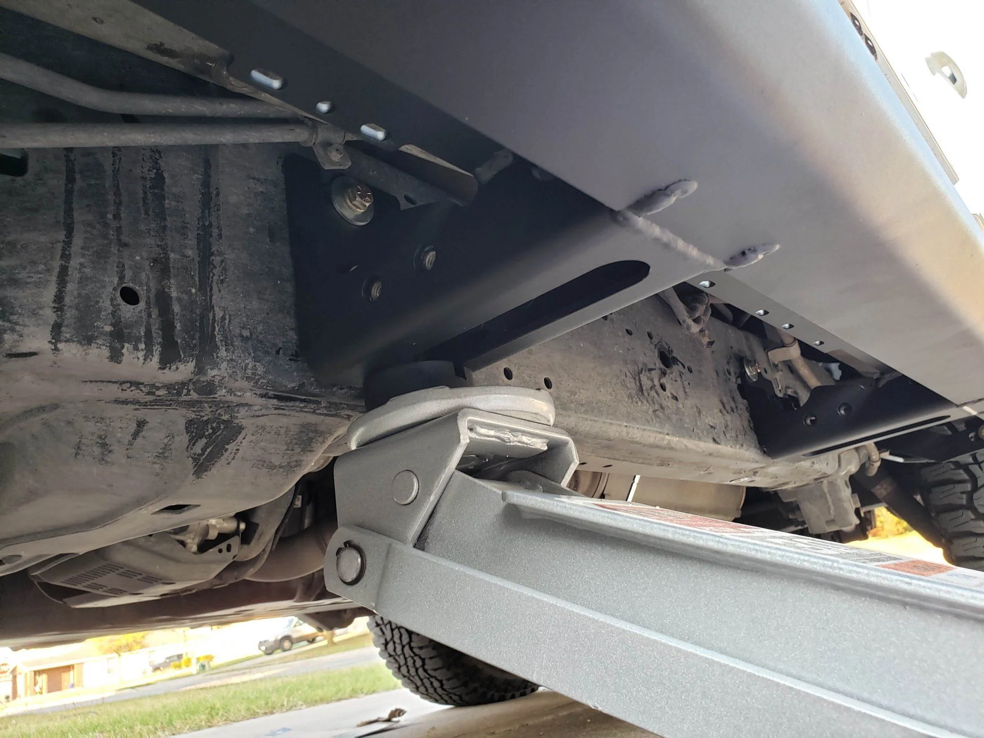

Now lift and slide the sliders onto those loosely-installed top bolts, keeping the washers on the outside of the slider mounting plate. The slider will just hang in place once you have it on there. It is too awkward trying to do this by yourself, trying to lift the slider, while trying to see and align with the loosely-installed bolts. I found it worked well to have my son lift the back end of the slider, then I laid on the ground and lifted the front end of the slider above me. That way I could see everything very well and get the slider mounting slots up and over the frame bolts.
Here's what it looks like with the slider hanging from the loose hardware. You can see the stick-end of one of the stick-nuts poking out from the rectangular hole to the right.

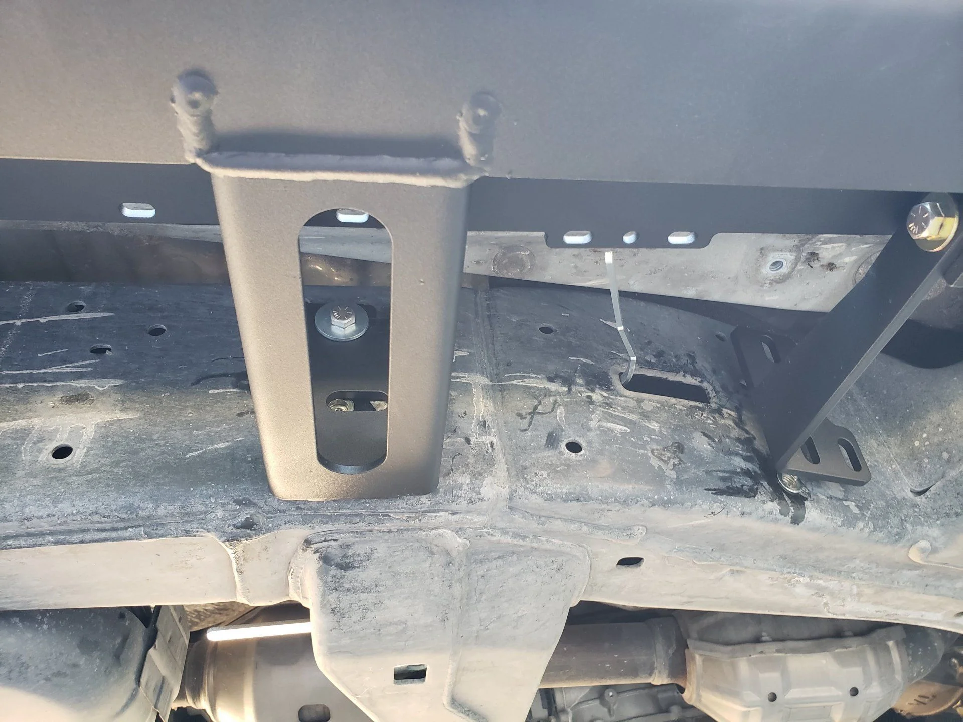

With the main supports tightened up, you now install the cross-member brackets. Instructions are straight-forward and install is easy. Note that on the passenger side, the rear support bracket goes at the rear mounting point for the gas tank skid plate (between the skid plate and the frame). You use the Slee bolt here instead of the stock bolt, which have the same thread pattern but the Slee bolt is longer. The instructions have you also remove the gas tank skid plate's front bolt, which might not be necessary, but I think makes installation easier. I also replaced that front bolt with one that Slee provided.
Now go through and tighten ALL hardware. This includes all the hardware between the mounting arms and the frame, and the hardware that connects the front and back brackets inside the sliders (again, use a swivel socket + extension).
Now go tighten all of it AGAIN!
All hardware installed, including the cross-member support brackets:

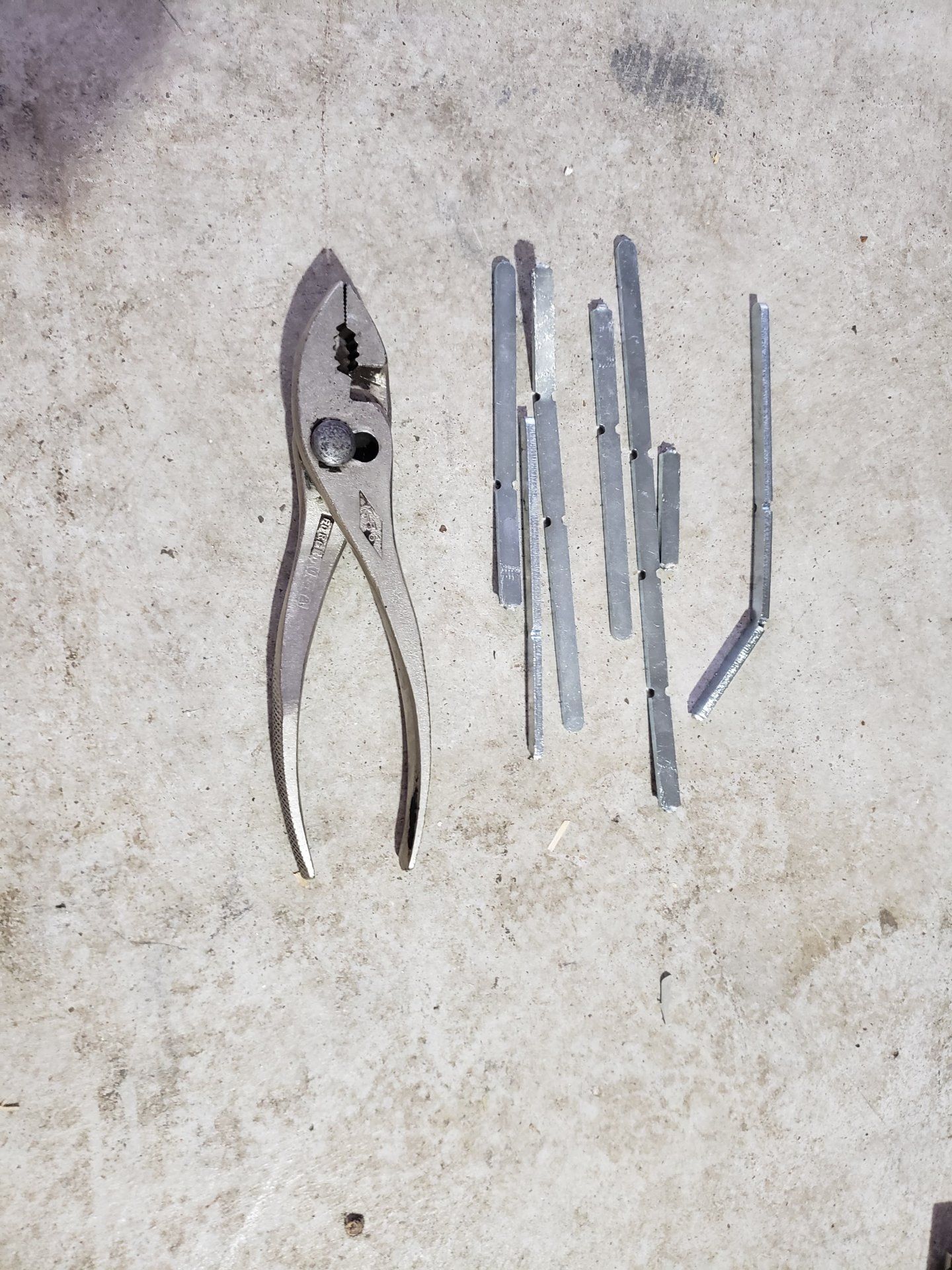

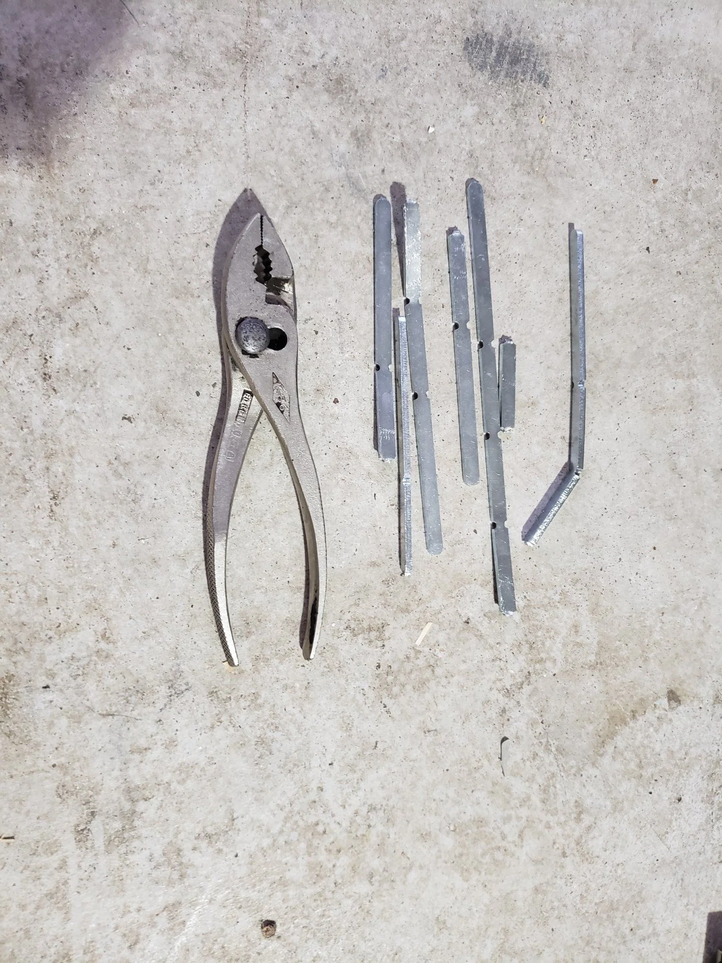

Don't forget to use some pliers to break off all the stick-nut pieces that are sticking out everywhere, or you're going to end up with weird scratches and damage to tires / brake lines / etc. at some point.
