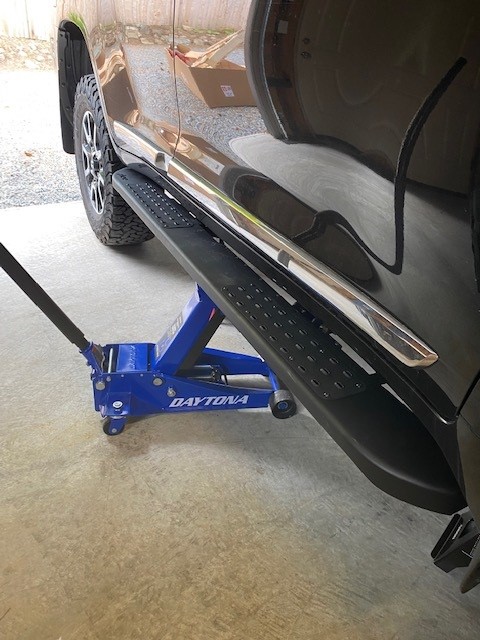

Slee slider steps install notes - 2018 LC
Need some help related to getting these installed on a 2015 LX. Want to go the route of replacing the rockers with 2015 LC ones BUT local dealers will not order the parts without a VIN, and of course a Lexus VIN does not work for most Toyota parts guys.

I just cut my LX rockers

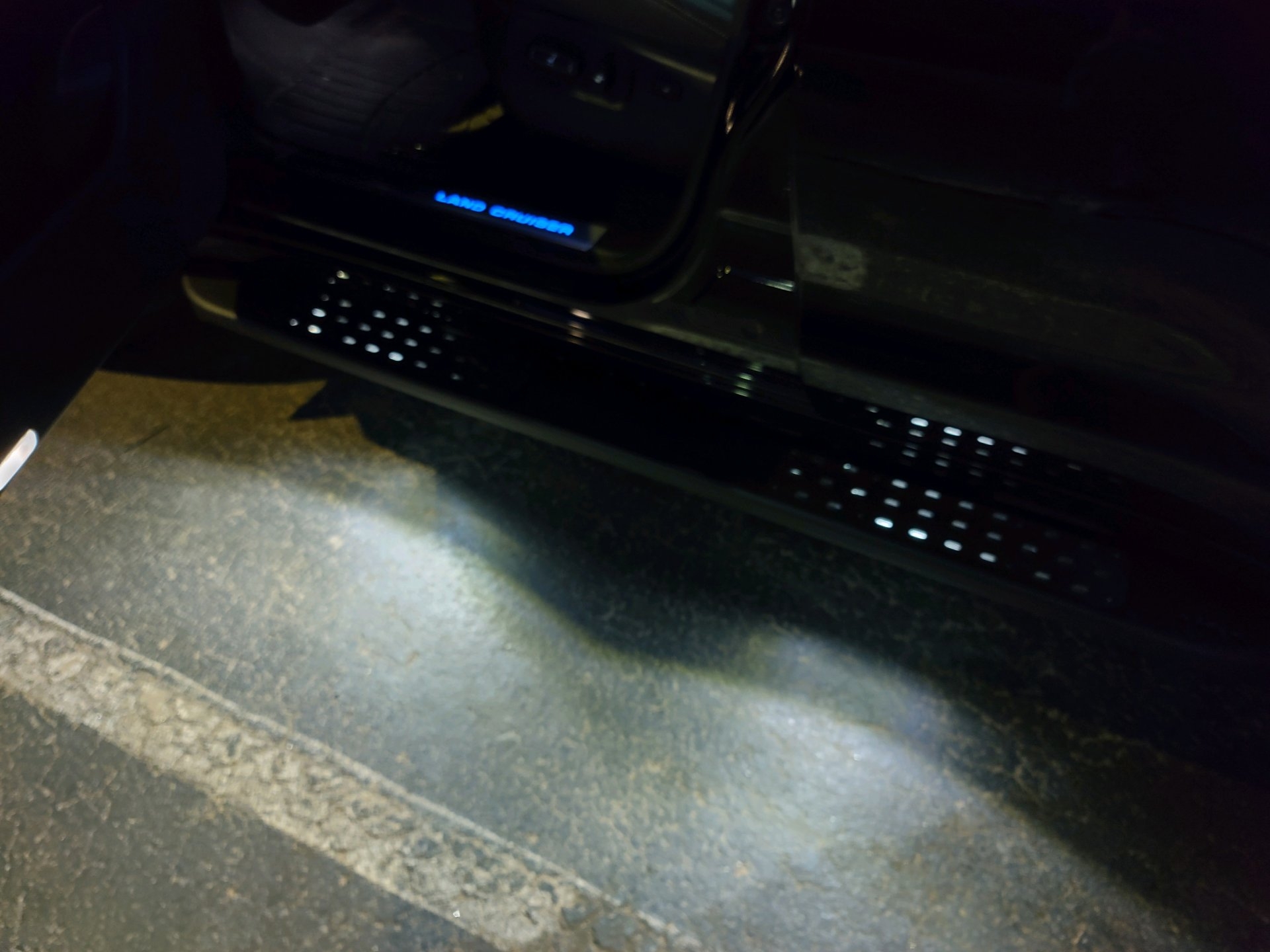

Excellent writeup! I took my 2020 HE up to SLEE this past April for installation of their sliders when they were ready. Figured a good reason to introduce myself and meet everyone there. I opted to purchase and have them install the LED light package while they were at it. I topped off the trip with them selling/installing the ARB drawer system. Worthwhile trip including some great hiking in CO.

any idea what fuse was tapped for the lights? currently, my slee lights will only turn on when my driver's door is open.

These slider steps use a combination of bolt+rivnut in some places AND bolt+nut in other locations. As I was installing, it was clear that the rivnuts are used to hold the slider's position, while the beefy bolts+nuts are used to secure the weight-bearing portions and take the impacts and vehicle weight (e.g., the huge main arms that attach the the frame). The big main arms actually use a combination of both.
Ah ok makes perfect sense. Thanks!

They aren't rivets, they are rivnuts, a threaded fastener installed in a hole using a compression sleeve that locks the female portion of the fastener (threaded hole) into place so a male fastener (threaded bolt or screw) can be installed.
Does anyone have input on what fuse to tap for the slider lights? my shop is closed for the holiday and I wanted to work on this over the weekend.
Many thanks for the write up here @FerrisBueller ! When I installed yesterday this was a clutch supplement to the Slee instructions, which were also great. Really appreciate the level of thought and effort that went into putting this together- it's what makes this little community great.
