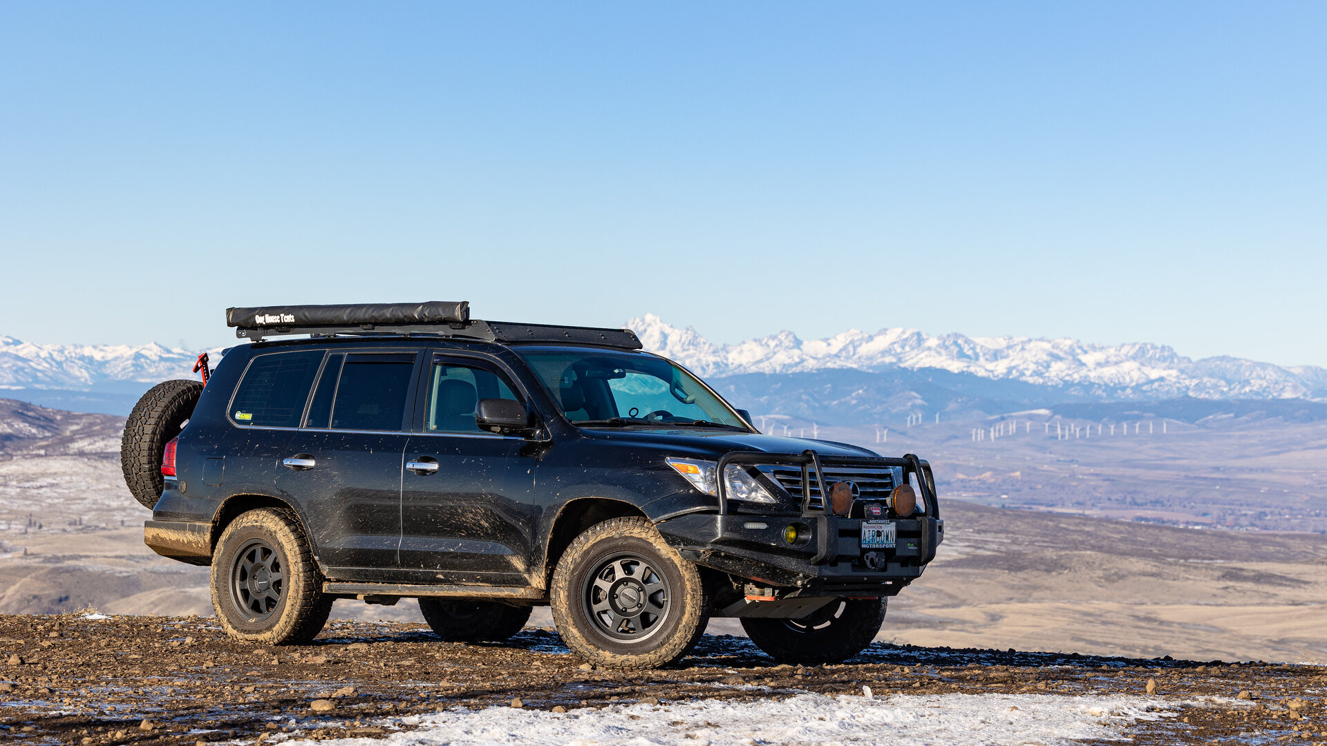

It is much easier to fit large wheels and tires on an LX compared to a LC200 due to the lack of KDSS. I barely had to modify mine to run 12.5" wide 35's. Can't say that with a Land Cruiser.
AHC is widely regarded as a reliable system and long-lasting as long as you keep the rust at bay. It requires a little periodic maintenance (flushing the fluid) ~60k miles. Otherwise, should actually last longer than a traditional shock absorber in most cases. And when it stops performing to par, you replace the accumulator globes for around $600 and keep on trucking. Similar ballpark price to replacing a good set of shocks. There are rare cases of more serious and expensive failures, but that is not the norm.
AHC for offroad is a matter of preference. I have run Hells Revenge, Wheeler Lake and some other pretty tough trails with completely bone stock AHC suspension. It works well, but can feel a little fickle and annoying at times depending on what you're used to. I intended to delete AHC and go with a traditional suspension lift (which is also totally possible), but after getting a little more used to it, I'm going to stick with AHC for the foreseeable future.
The main challenge of the lexus (particularly the '16+ models) is the giant plastic bumper limits approach angle quite a lot. Cut it up or install an aftermarket bumper and you're set.
