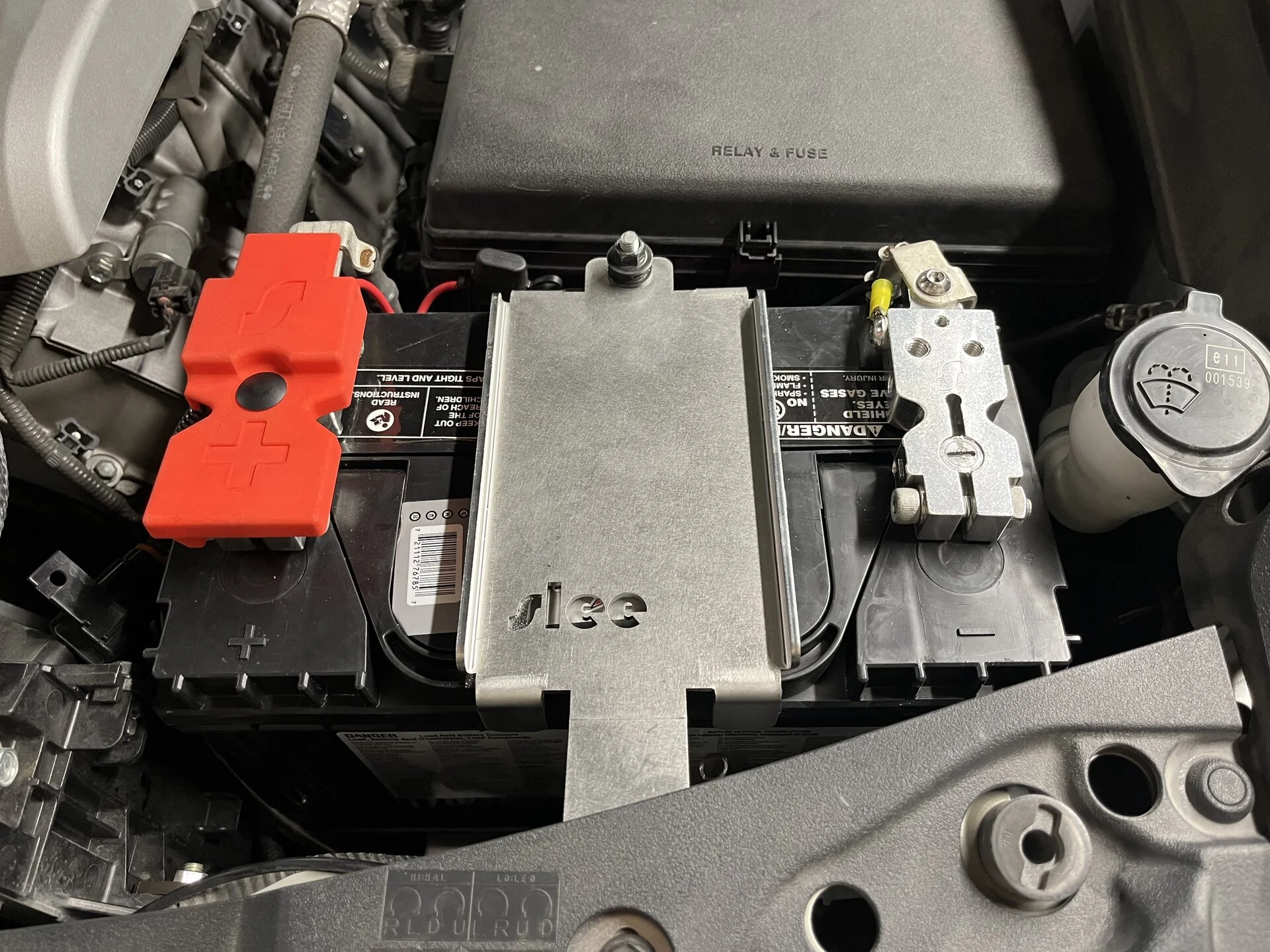

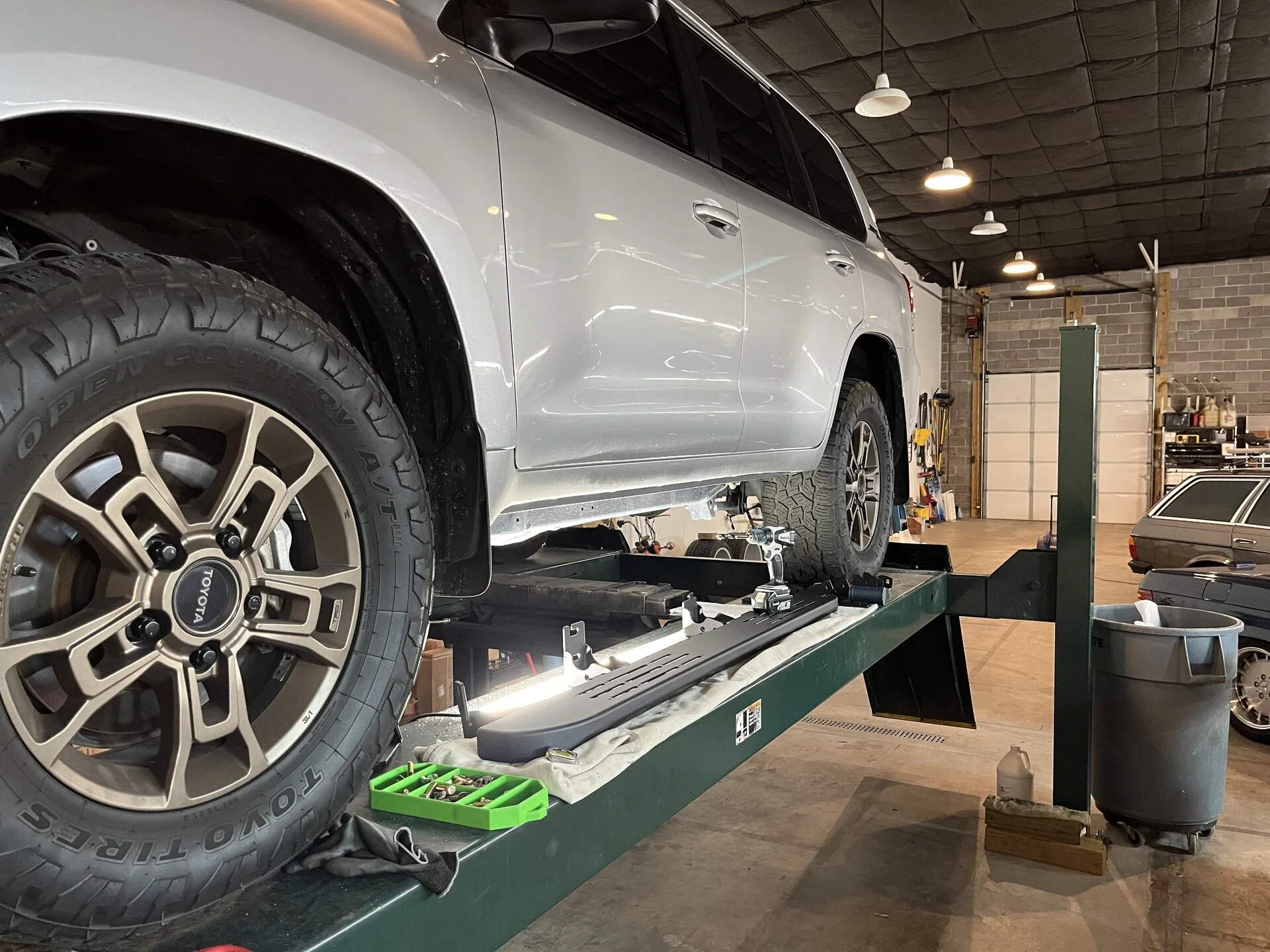

Yes @RET2 @FerrisBueller @Docwyte , my dumb ass did not order the hardware kit. Thanks for your response. And I had six hours set aside without family duties!!! Thanks to this thread, the holes are drilled and painted, and the steps are assembled and ready to hang. Had extra time to install a battery tray.
No worries! The steps are a lot easier to install if you have a second pair of hands helping. Once I got to the point where you are a friend of mine dropped by and helped me hang both step sliders into place.
