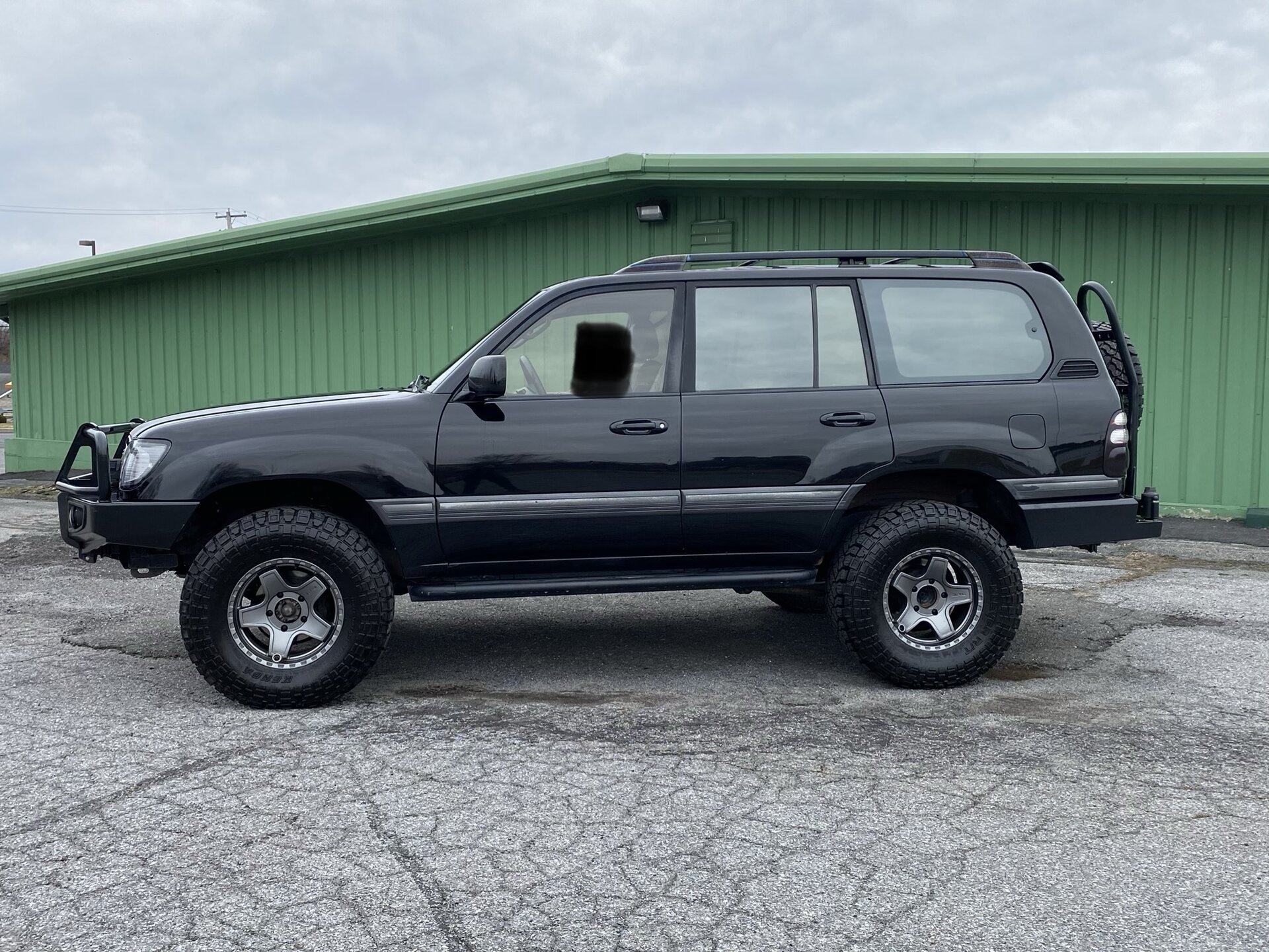

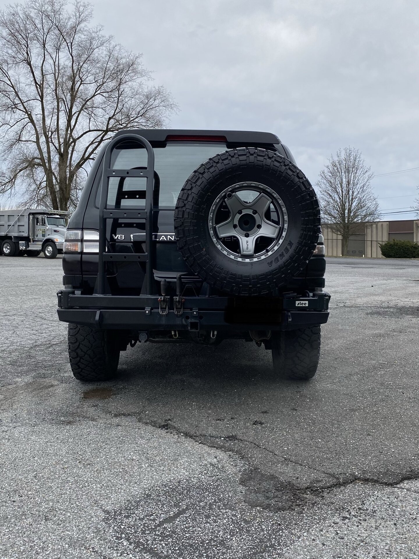

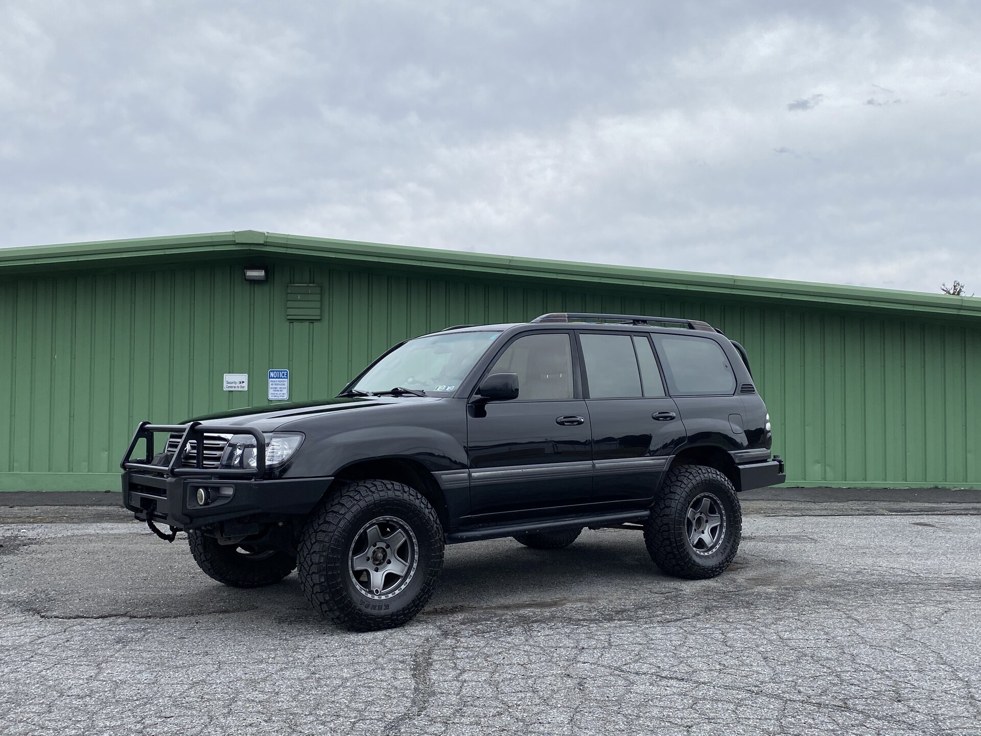

@Formerjeeper I run the traditional step slider that you linked first. I have them on a 100. They are a functional step and have a textured step plate that does its job. During winter the tube can be slippery (just like any running board) and I have seen several members run grip tape.
From an esthetic standpoint I prefer the look of the traditional tube slider as they compliment the tube work on my front ARB bullbar and the tube ladder on my Slee rear bumper.
Here are a few pics although when installed on a black truck they could be any brand slider and it’d be hard to tell them apart
I do like the new design and would certainly give them a try although in my opinion they look significantly more like running boards.
Hope any of this helps

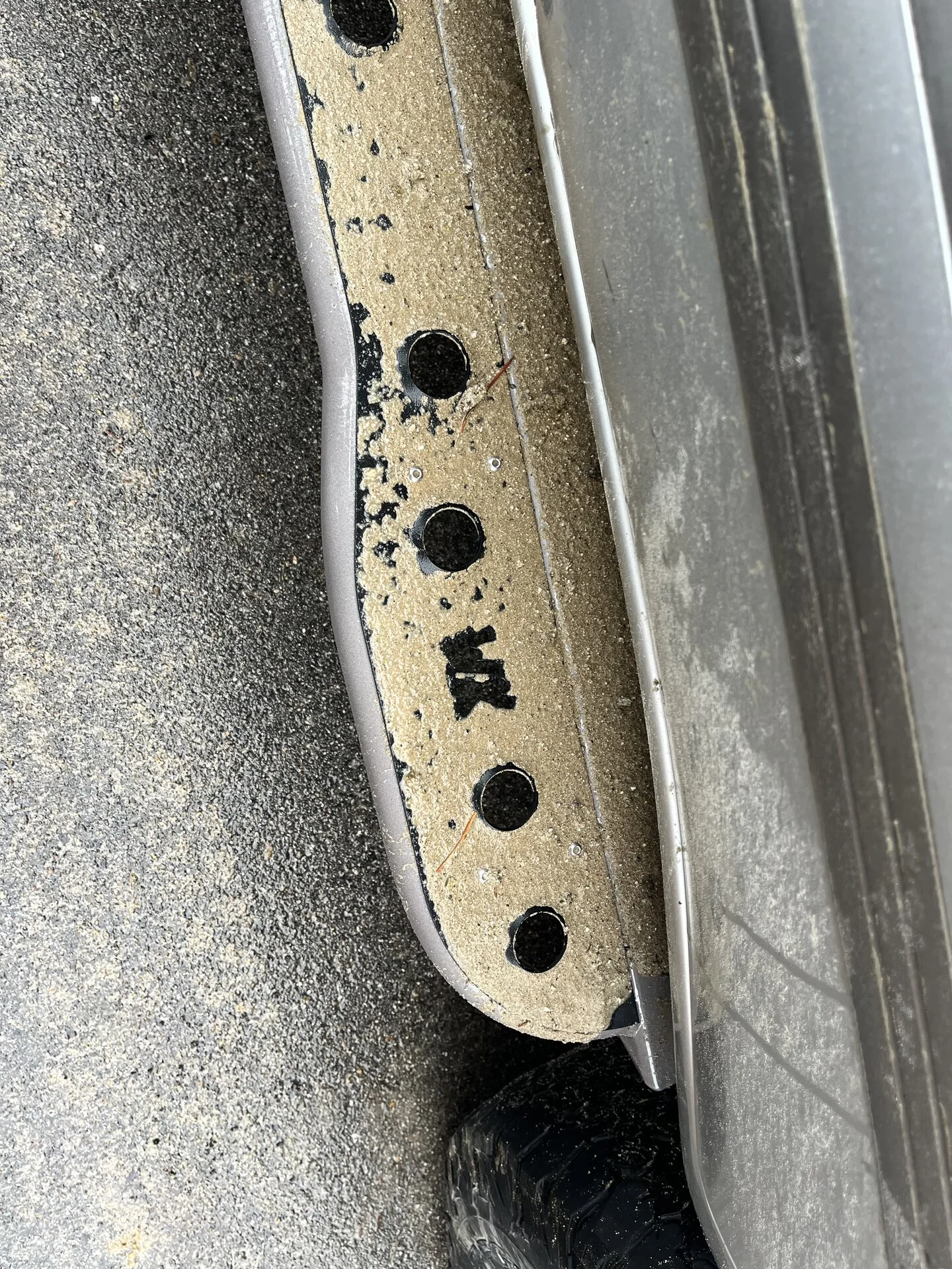

I have the traditional tube sliders on my 06 and had them on my 99 as well. I have grip tape on the outer rail which I consider a bit of a must have. They get SLICK without it and it's a serious concern, IMO. I slipped off it twice and those bruised shins motivated me real quick to jump on Amazon and grab some tape.
@Kyle Bell has the new formed style on his 200 (with AHC, FWIW) and it's a very good looking piece of metal and the outer lip is not nearly as rounded and slip-inducing as the older tube style.

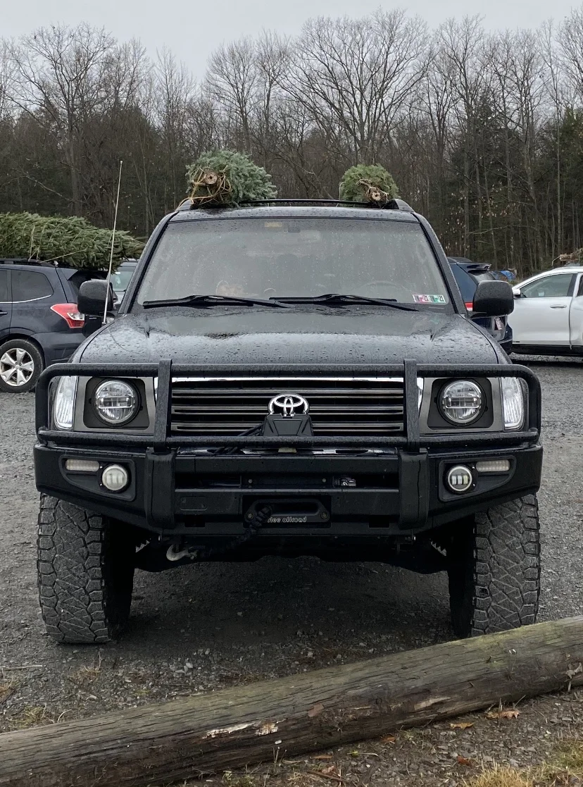

My point exactly, why would Slee develop a 200 series slider that works on both the traditional suspension TLC and AHC equipped LX570 but not provide the same offering for 100 series owners?
(Strength 2 supporting arms vs 3?)
Btw - those Braids do it for me! Never get tired of seeing your LX 😍

Thanks for the kind words! Those Braids were the first time I bought "not cheap" wheels and I've loved them.
