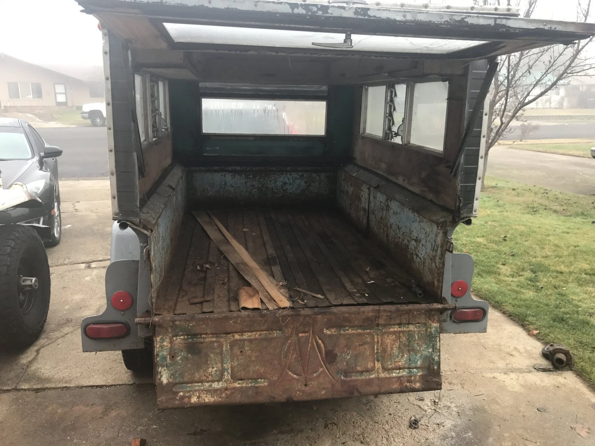

Posting this as I have been waffling about whether I should bother to put an effort into this as a "expedition" build:
It is a circa 1950 Willys truck bed with a funky 1960s camper shell. It's a little rougher in person than the pics show. It has a few rust holes on the floor.
My plans are to install a drawer with cooking/storage, a sleeping platform, and a rack on the front tongue to carry a small motorcycle like a TW200. Maybe a awning that rolls up. Basically keep it simple and cheap.
Should I bother? Is it too ghetto?
Thanks, Daner

That will be a cool build! What is the tank on the starboard side? Gas? Water?

Any idea’s for that fuel tank? Perhaps turn it into a mini Traegar smoker:cheers:
Will the roof hold much weight? If so, I’m thinking build a roof storage rack with tall rails. Make it so you can also sleep up top if you have kids. Build stake pockets into the rack. Fab up a simple collapseable ridge pole system that uses stake pockets. You could throw a tarp over in wet weather.
Do you have a welder?
Good ideas-keep them coming! The fuel tank on the side holds about 15 gallons-and as I run diesel should give me at least 700 miles of range. I like the idea of sleeping on top too. My wife and I don't mind sleeping outdoors, we just hate being on the ground with creepy-crawly things. I would need to reinforce the roof and install a ladder, though.

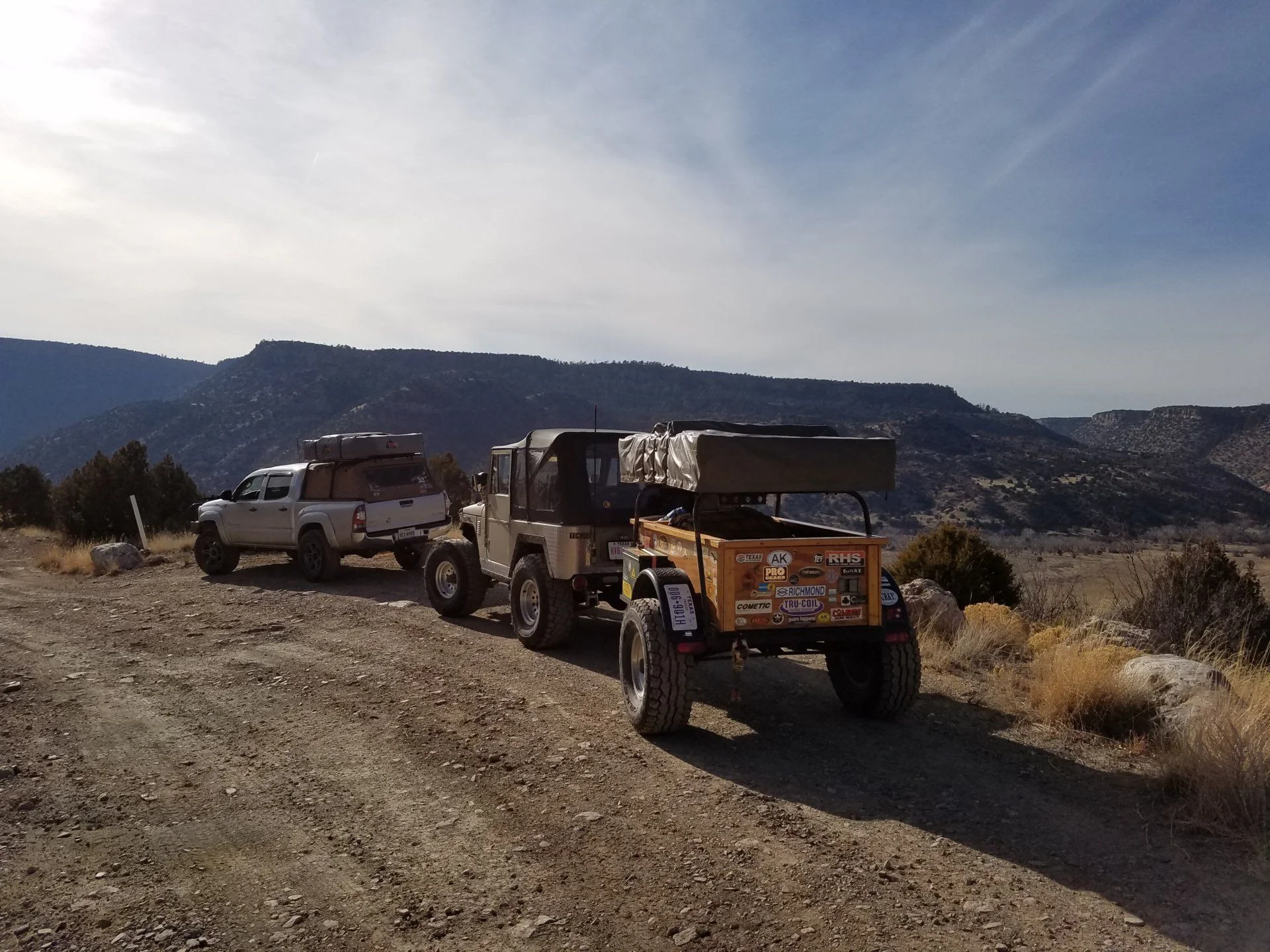

Front rack check... I don't see it as getto as long as you don't cut corners to make it getto. I would have kept the old school camper like ypur but needed the versatility of 3 bikes. Drz 400 across the front of the trailer in this pic just before 900 miles. To start COBDR

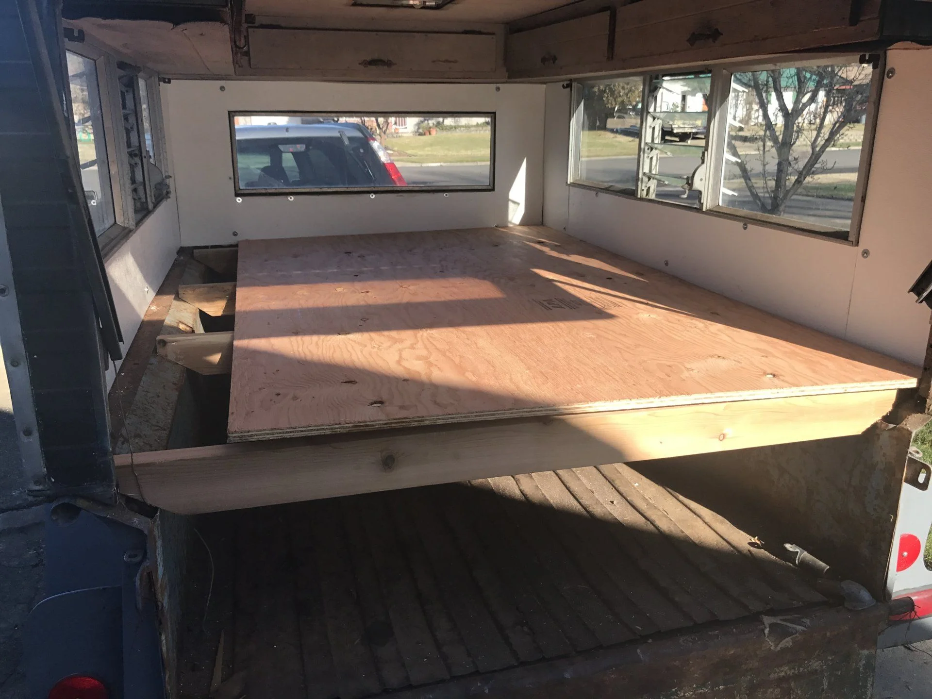

I played around with the sleeping platform and replaced the failing 1960s faux birch paneling with a fiberglass material that will be a bit more moisture and bug resistant:
The last pic shows the funky jalousie windows, which still work smoothly. I do have concerns about this thing being an oven in the summer.
I think so. The P.O. Welded a subframe under the camper shell out of angle iron. The weakest part is that lift door, which I think will need some help-or if I get ambitious I may fabricate some ambulance doors.
hey daner, have you given thought to insulating that shell with either a rigid foam product or urethane foam. a good guy on the gun should be able apply 1" without too much ado. i personally would do the urethane, but not until all seams n joints were resealed, any loose fasteners replaced, yeah pretty much rebuilt structurally
I would get one of those camper vents for the roof. that would get the heat out of the camper. If you can wire a 12V fan (or make it solar powered) to pull the air out of the camper.

I did stuff some insulation in the front, everything else was insulated. Not thick insulation, but hopefully better than nothing.
It does have a roof vent. I plan to install a fan in it and install a solar panel on the roof. More research needed-but this is kind of fun!
